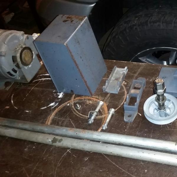

Been slowly setting up my old man with a wood shop over the last couple Christmas', birthdays & Fathers' Days now that he's retired. Includes a monster 3hp Delta table saw, scroll saw, drill press, grinder, clamps, router, compressor and pneumatic nailers. His shop is in his century-old grainery barn -- still has the 4' pulleys and bucket-belts in it!! Very cool. Now it's time for the 12" x 36" wood lathe. He's setup with the wood shop and I'm setting up my metal shop.
Now that my shop is finally insulated, I have a 350-sf clean, quiet, warm work space! :-)

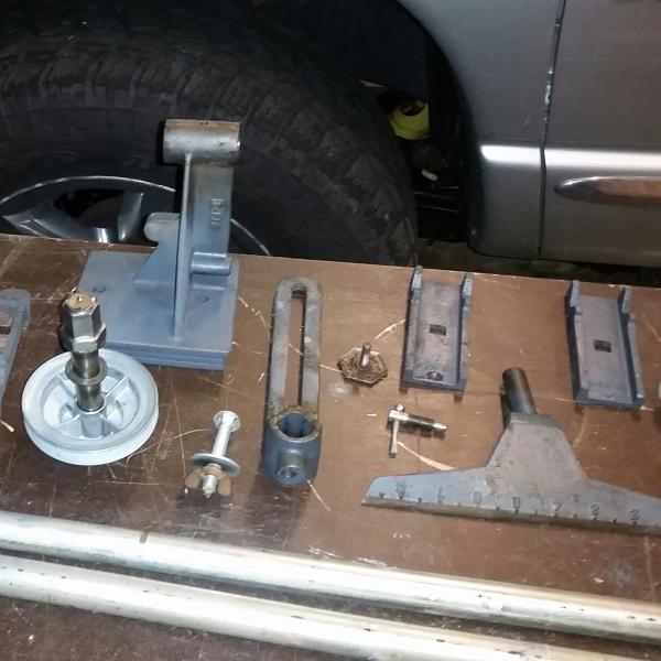

Bought this ol' 3-speed Sears lathe used for $75, but its hardly been used. Bought it from a guy in his late 60's / early 70's who inherited it from his father-in-law's shop. So its one of the "old & tough" models of the past with simple/logical construction & upkeep. motor (( Internal Combustion Engine ? )) is from my collection and is a cap-start 3/4hp Dayton that runs stealth quiet on 110. Had to buy a 3-step pulley for the motor (( Internal Combustion Engine ? )) ($17). Picked up the 54"wx24"dx35"t Homak work bench with 2" top & adj. feet & drawer for $40 off CL and the steel/paint is like-new, but the MDF top needs a coat of paint. I couldn't have stick-built a 2x4-timber bench with hardware for less, so this worked out perfectly. And the new 27" v-belt was $10. So I'll be right about $150 for the whole sha-bang.
Plans to be completed by end of Monday 12/21 include:
- Disassemble (done)
- Media blast
- P-coat
- Polish both rails
- Re-assemble
- Paint top of work bench
- Wire new switch, accessory outlet, motor (( Internal Combustion Engine ? )) & lead cord.
- Final assembly
- Test run!

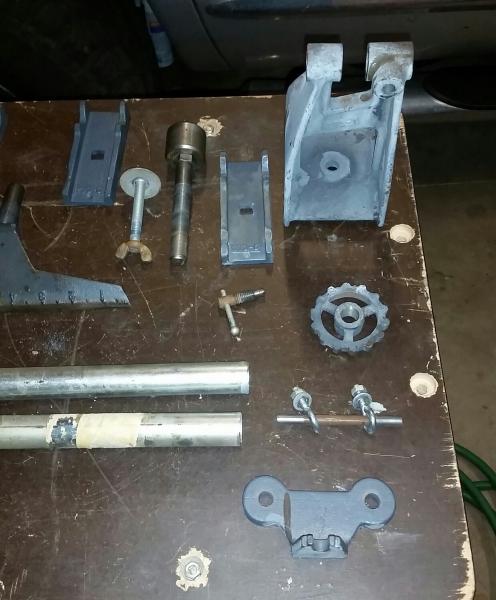

Blasting completed.
Time to see if the ol' shop oven still works. It's been 3.5yrs since I used it.
Update: added a couple more "before" pics.

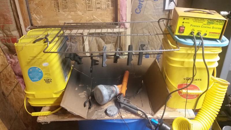

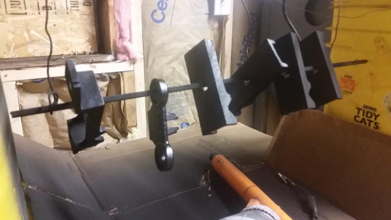

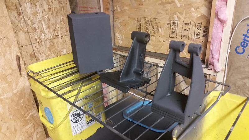

Progress...
Not too shabby for a $60 stove and the HF p-coat system.

File comment: Once the paint melts to gloss, it's another 12min at 415'F.

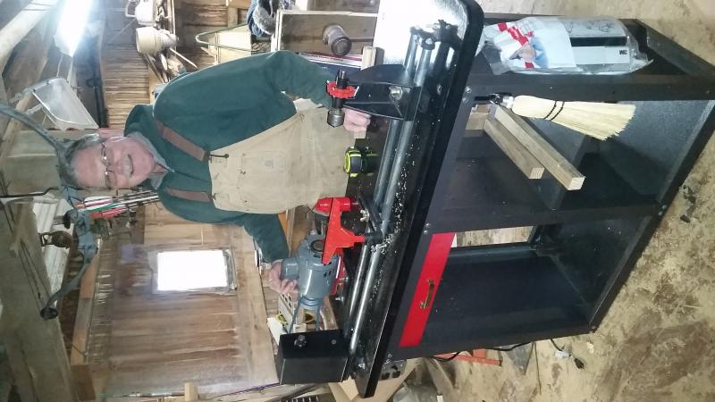

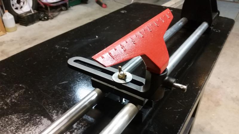

Completion! Turned out great and runs smooth & quiet. My mom said she'll have her camera ready because my dad will be in tears. He's wanted one of these for-friggin-ever!! Plus he finally retired this year. :-) :-)
Go figure, I thought I was all done and I snapped a bolt...the LAST effing bolt! Stupid Chinese crap cast bolt-screws. 2hrs later I got it extracted. Ugh.

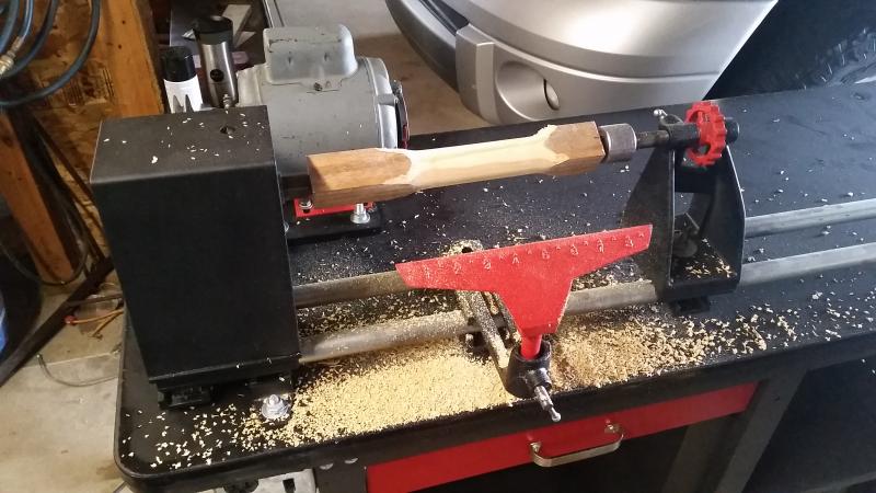

I had to try it out and...it's awesome. Quiet & powerful! I really like the black tabletop and black lathe pieces -- it really helps you focus on the workpiece. It stands out "like a yellow piece of wood on a black background", lol. Chips stay away from the motor (( Internal Combustion Engine ? )) vents, too.

PostPosted: Wed Dec 23, 2015 5:56 pm
I hope you had the tool rest in a whole lot closer when making those cuts! :-) A guy in my shop class back in High School embedded a gouge in this forehead by not keeping the tool rest close. :shock:

Rest assured, the tool rest was in its proper place. I backed it off when I was sanding. But I appreciate the safety observation. :-)
