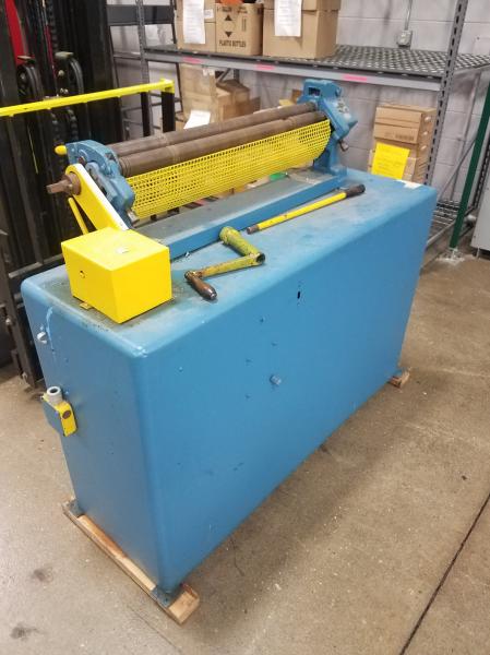

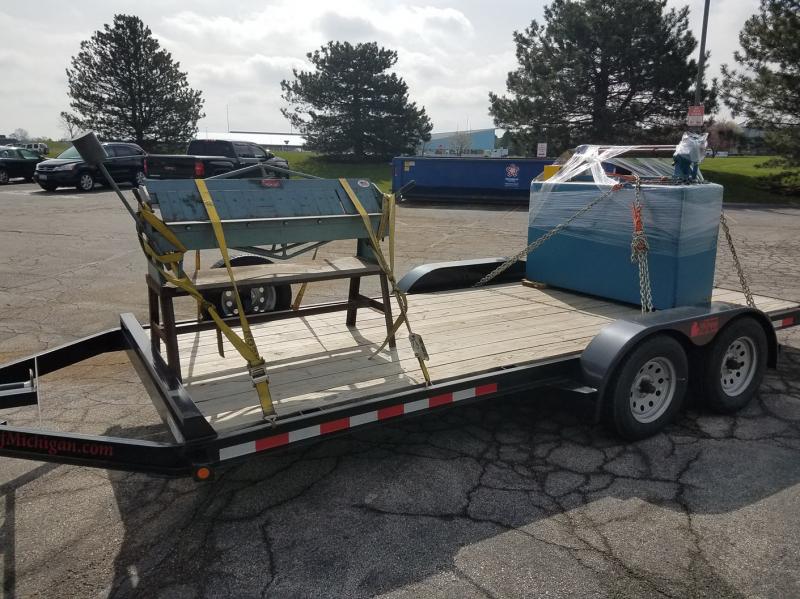

1. Bought a 16ga 48" finger brake for $800, USA-made Ropp-Whitney.
2. Got a Pexto 36" power slip roller for *FREE*. More USA stuff. Just needs a new speed controller, but it also has a manual-crank. Has 3 grooves for rod and 2 grooves for bar, too. Rated at 22ga@36" sheet, but it's capable of 18ga mild steel @24" and even thicker in smaller widths and smaller bend increments. Pays to know people who have WAAAAY to much equipment on their books. ;)
