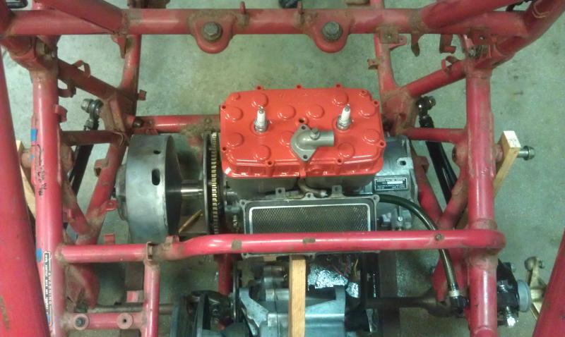

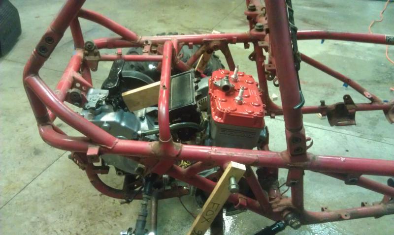

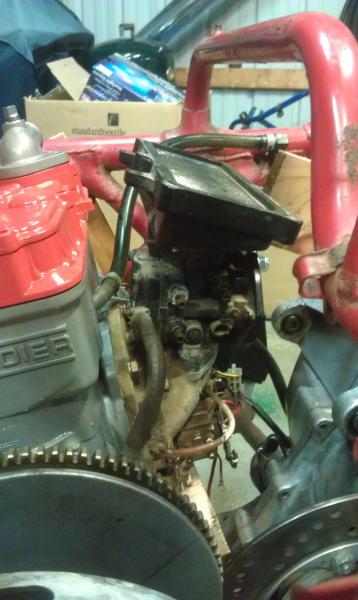

Well thanks to some good weather, good timing with the sled break down, and with getting my shop in order...I finally got to work on the Rotax Buggy this weekend. Will be a slow-go, but it's on the priority list! =)
Accomplishments:
1. Got the gearbox (from Nelly), axles, and rear suspension on (note the new Fox 9.0 shocks!).
2. Dropped the Engine in the cradle to see what I could see.
3. Swapped the 580 SeaDoo intake/carb onto my Engine. It's literally bolt off, and bolt on. Will need to be re-jetted, obviously.
Learned pretty much exactly what the previous folks learned when they dropped their 470 Rotax into their FL350R frame; nothing new here.....
- Amazing how much you can strip off the Engine. There's a lot of extra mass in mounts, etc for the sled that you don't need for a buggy.
- It doesn't fit! Will require some frame adjustments in order to fit the fatty TRA clutch and the pull starter. Will make my own Engine mount plate to fit the stock mounts. Will have to carve out at least one section of tube (both sides) and brace. This will be a combination of tubing and medium sheet (for armor). I can gain plenty of room on the clutch side by swapping the TRA with a 94c, to where I wouldn't have to modify any chassis on that side, but we'll see how it goes. Plan is to keep the Engine as low as possible in the chassis. The farr-offroad.com guy makes mounts for this swap, but his design lifts the Engine pretty high to get the dual-carbs above the gearbox. IMO...too high, plus I don't have the dual carbs!
- Electric start has to be re-located. Thought maybe I could fit-up an FL350R starter, but its made to sping the opposite direction. But since so much of the sled bolt-ons can be removed off the Engine, it'd be easy to relocate the starter to the exhaust side of the Engine. Seems the guy from Farr-Offroad.com did the same thing with his FL470. I shall do the same. But in order to get the starter where it needs to go and leave room for the y-pipe, I'll need to replace the coolant pump cover with a side hose barb instead of up/down barb. Found one for $8 and its on its way.
- The exhaust will have to be re-worked. The stock y-pipe is made for a sled chassis -- not a buggy. So it will need to be shortened and turned. Pipe will need to be reworked as well to accept the modified y-pipe as well as fit/mount in the buggy. Fortunately, I've read this Engine is very pipe-forgiving. Both the pipe and y-pipe are abundant and cheap, so chopping it up won't be a problem.
- Dual carbs take up a tremendous amount of space. The seadoo intake...God, I hope it works because it seems to be the exact thing the buggy swap needs! Not sure if I'll keep the oil pump or block it off and switch to mix (?).
As you can see, I've got my work cut-out for me for the Engine. That's my focus. Once the Engine fits, I'll get to the peripherals and then to front suspension. Front suspension will be either [1] LT500R a-arms/spindles/brakes/Fox-Air, or [2] custom from scratch.
Stay tuned...

When I was doing my 470 mock-up, I had the starter under the Engine. I was going to incorporate it's mount into the Engine mount. I never did the swap so I can't verify it's final position, but I thought I would mention it as the front mount starter on my 670 swap was a royal pain finding the right configuration of starter to clear the exhaust and coolant lines.
I'll be keeping watch on your progress.

There is ample room for using the stock starter on the front-side of the Engine below the exhaust plumbing. It just needs a bracket for holding and positioning. It's actually pretty simple, even with the giant piggyback actuator on it. Check this out...
http://www.farr-offroad.com/apps/photos ... =146659217
http://www.farr-offroad.com/apps/photos ... =146659220
http://www.farr-offroad.com/apps/photos ... =146659210
Just not sure how close is "too close" to place a starter in the close-proximity of the head pipe (?).
The guy at FARR had a cool build going, just appears to have disappeared.

I'll likely have to carve out some of the triangulation below the upper rear shock mounts to make room for the TRA clutch and recoil starter, and then add bracing where I can. But not sure...looking at how the Farr-Offroad guy set his up...it looks like his Engine is shifted over pretty far to the stator-side (see ~2" gap between clutch and frame), and the clutches are aligned funky. At least compared to how my 94c and driven clutch line-up on my FL350R. On the drive clutch, the inner sheave is fixed. On the driven clutch, the outer sheave is fixed.
And given the difficulty in finding an alternative rear shock, I'll likely move the upper mount higher to accommodate a very popular, cheaper & easy-to-find option that is better than stock. Suggestions?

You cant block off the oil, run a clear hose from top to the one on the bottom and make sure you keep it full of oil or it will burn up the bronze gear inside.
You wont need different shocks, you will just modify the side with the pull start. The starter works, just gets the solenoid tight to the mount. Farr is selling the mount as weld together on fleebay, you modify it to do everything you want with little effort.

Not that I need different shocks, more that I want something other than stock.
Farr will sell the mount unwelded for $125 + s/h. Not bad. Seeing if they have the starter bracket as well.

I'd try to add in some sort of heat shield if your running the starter below the headpipe. Nothing kills a starter faster than a hot header.

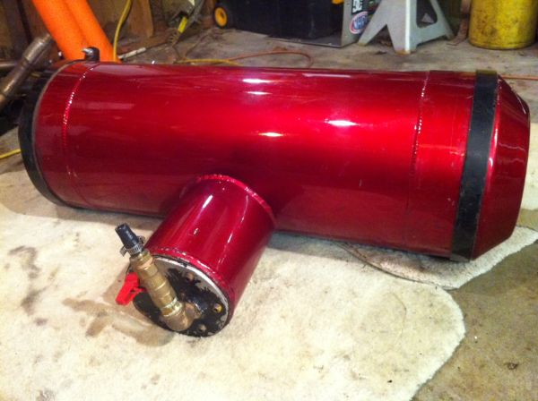

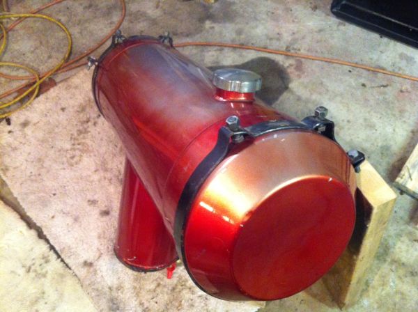

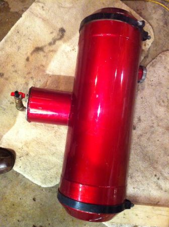

Picked up a spun aluminum fuel tank today. It's 10" round x 30" long, offset fill cap, and has the petcock in a 7" deep "sump" to avoid sloshing. Unique and functional. Roughly 9.5gal capacity. Found her on CL for $75, but paying the guy $85 + FedEx so he'd ship it to me (it's a 2-hr drive and would cost me more in gas$ than it cost to ship it, and will arrive next day). Been eyeballing them on evilBay, and just the little 3-gal guys are like $144!!
With the Rotax sitting where it will sit, I should be able to mount this tank behind the seat/headrest with still enough room for the radiator above and enough gap above the exhaust exit. We'll see!
I always hate this part of a build...THE HOARDING PART. Shopping is fun, but damned expensive!! :shock: And shopping is easy when I'm inside, isolated from the frigid outdoors, and it's PAY WEEK. :-)
Update...added tank pics. It wall overhang by about 1" either side if the cage, so I'm planning on welding in an extra tube flare on either side.

Ok, just got my tank a mere 17-hrs after it was dropped off. Thank you FedEx! =)
But I think this tank will be too big after all. 10" round x 30" long with a 7" long sump neck. It will sit about 3/4" outside the frame if it were sitting between the center hoop cross-brace and the fuel-tank support bar on the Oddy. But I'll have to set it on the buggy frame and see. I do love the anti-slosh sump.
If all else fails, the tank is in a FedEx box, I know the dimensions/weight, and I have pics...so...I could easily list this on evilBay and sell 'er for $150. No other tank like it on there with a sump!

Big red fuel tank isn't going to cut it. It's just too big. WTH was I thinking???? lol Onto evilBay it goes! I'll snap a pic of it sitting on the buggy chassis before I box it back up...it's UBER HUGE. Going to opt for a smaller 5-gal spun tank that fits inside the tubing, and maybe pick-up a remote fill neck to make it easier to fuel up.

Try finding a center fill also. The side fill ones tend to end up right below the rear down tubes and can be a bitch to fill
