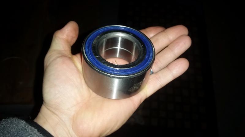

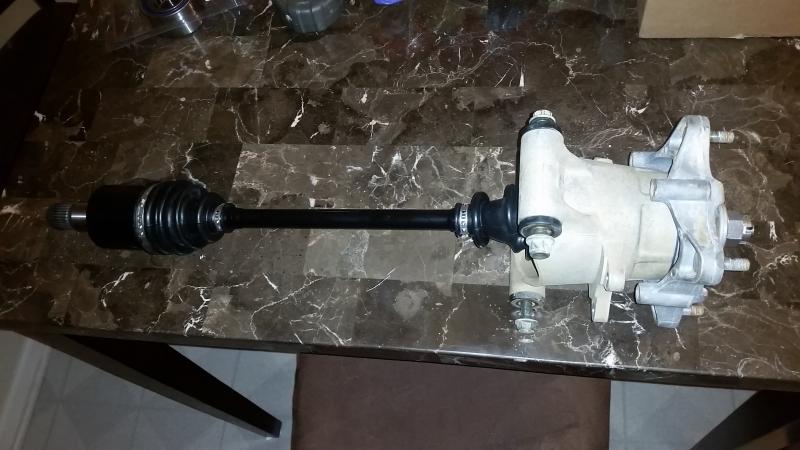

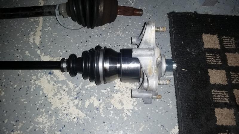

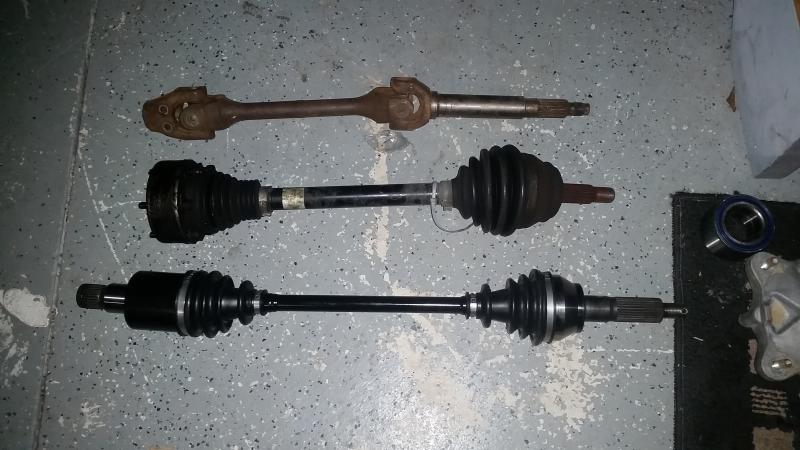

PostPosted: Wed Feb 04, 2015 2:29 pm
Here are the axles I've got on hand.
  • 09+ RZR S / RZR 4 rear axle
  • late model VW/Audi front axle
  • stock FL350R axle
And for reference, the non-S / non-4 RZR and Ranger rear axles are 5" shorter (according to the info on the RZR Forums).
The 40x74x40 axle/hub bearings are indeed HUGE. The Sportsman/Ranger/Razor all use this size rear bearing in the same style of aluminum knuckle. Very simple but the knuckle is designed for a-arms. I wish Honda would've went with a longer axle and then used only one bigger carrier bearing with a shorter outer stub -- the stock axle stub is mega huge.
My first plan of attack is to take the stock FL350 rear hub and work it a little bit. OD of the RZR axle plunge cup is 2-5/8" while the OD of the center section of the Oddy hub is just under 3". I want to hack off the hub's ears, turn the OD smooth, and then turn out the 4 pockets so there's a smooth ring in between an outer OD lip and a spline center OD. The plunge cup will get turned on the lathe with reverse geometry so the pieces will fit together and self center (I'll have to be careful and patient here). Will also turn down the cup OD just to remove the coating and create a smooth surface.
The parts will get thoroughly degreased with acetone, clamped slightly to keep the parts seated, heated to 350F in the oven (stress reliefs the chromoly & will burn off any grease), then tack welded in 3 places, and then allowed to cool slowly in the oven.
Once cooled, I want to check the run-out with the lathe and dial-indicator at hand-speed to check run-out across both parts.
If all is well, the parts go back in the oven and will get MIG welded (ER80S-D2 wire + 98%/2% Ar/O2 shield) about 3/4" at a time on opposing sides to prevent any HEZ warpage (don't want to mess up the cup geometry). Repeat the heat & weld process until done, and then allow the whole assembly to cool slowly in the oven. Per some other "experts" online, that spec wire is what you want for mild steel & chromoly joints. I hope 180A of welder is enough. Also considering a set of 3/8" OD holes in the cup sphere to get some more plug welds on the interior, then smooth out the cup with the die grinder. If needed I can always add more weld. Weld will get slightly turned on the lathe to even out weld buildup and to check for voids/cracks just under the surface.
To hold the "adapter" on the trans output shaft, I'll drill and tap 2 opposing holes in the hub for 2 set screws (will get loctite'd in place). Prob like 3/16". I don't want to do the pair of thru-holes like the stock inner yoke has simply to retain strength.
If it turns out to be a success, I will move focus onto the hub/carrier assembly and the frame mods required for the link mounts. Would like to use a bulkhead for the mounts, but there just isn't room. So likely some additional tubing around the trans with a one-sided bulkhead that connects to two frame tubes. Also...if a success, the same could be done to pretty much any similar UTV/ATV CV axle.
If it doesn't work...back to the drawing board.
File comment: Big'un
File comment: Sportsman 700 hub, 40x74x40 bearing, and Rzr-S axle

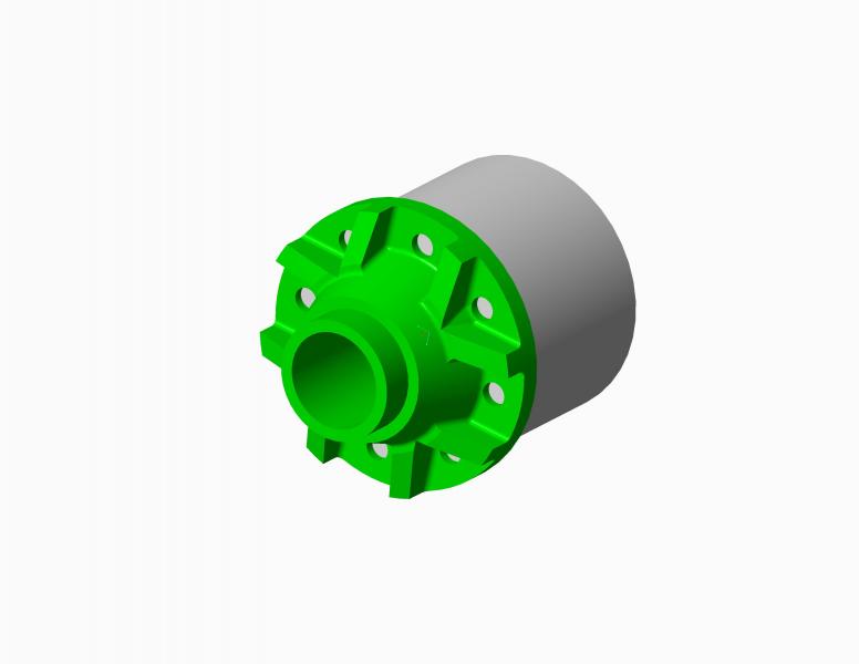

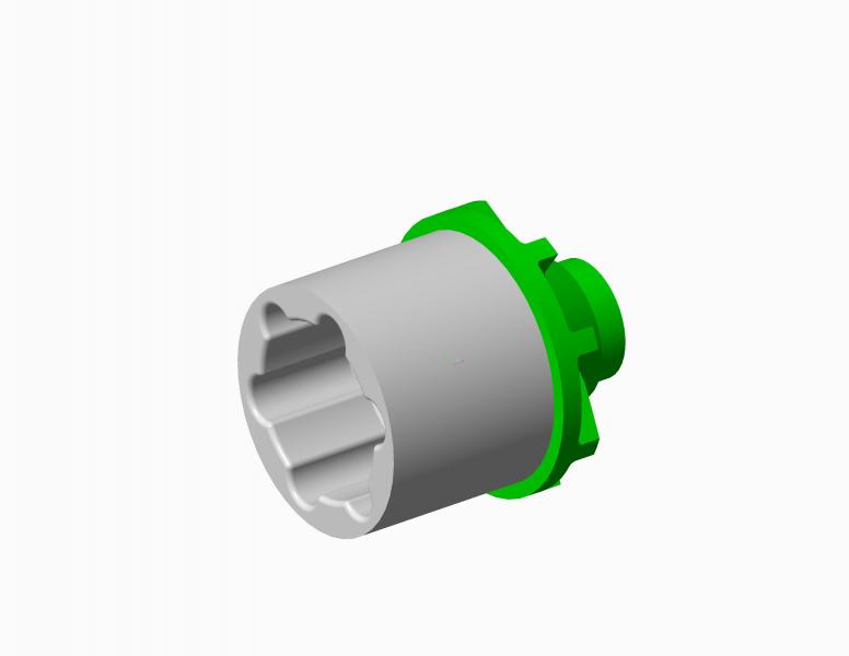

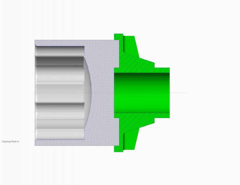

PostPosted: Wed Feb 04, 2015 4:18 pm
The adapter concept...
Would make more sense to run the plug welds from the hub side. So drill a hole in the hub (green) every 90 or 45deg and then plug weld to the CV cup. Then there would be the OD weld + 4 or 8 plug welds.
More to come later. This is from my lunch hour.

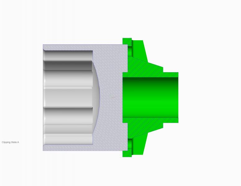

PostPosted: Wed Feb 04, 2015 4:31 pm
With (8) plug welds...
PostPosted: Wed Feb 04, 2015 5:09 pm
Cool, glad to see your doing this.
I still like the sportsman outers though :-) ,just too easy to make a five link out of it.
Your going to need to think ahead here a little bit. I do agree with starting on the inner CV, but keep in mind where its pivot will be in relation to where your links CAN mount to the frame and the relation of the links and your outer carrier/CV/pivot location, its all related in order to keep axle plunge down.
PostPosted: Wed Feb 04, 2015 5:13 pm
Or hack off more hub and minimize OD, no plug welds...
Another idea (not modeled)...what about drilling 4 or 8 holes through the rear of the hub with matching threaded holes in the cv cup? Would result in a slightly taller adapter since the threads need more meat.

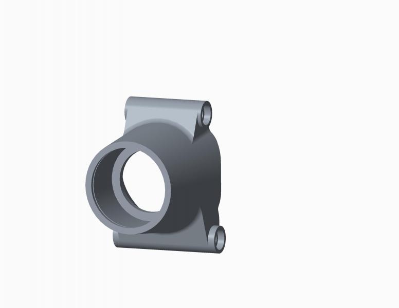

Almost missed this in my CAD model image escapade! :-)
Yes, you are indeed right B. I haven't taken my measurements and applied them to the output shaft / gearbox housing yet. With the fuel tank and battery box gone, I do have room for material. But heck...it may turn out I don't even have to remove any meat off the cup simply to get the cup out there far enough to satisfy the pivot Gods. Won't help width, but it needs to pivot perfect. Bad pivot points is the general failure mode.
I also really do like the Polaris outer. Only concern I have is the affects of dynamic forces the links would put on the upper and lower thru-holes of the aluminum carrier. The a-arms really only swung up and down and the arms transmitted the loads in two big rigid arms. Whereas the 5 link will be theoretically pulling/pushing in 2 directions from very different origins. Hence...I had sketched up some ideas for a bracket weldment that would mount to the Polaris outer. In the end its almost like making the "Gene 5-link" but using the Polaris outer as the carrier only. The Polaris outer also puts the 3 rear links in very close proximity of each other...not sure if its too close. Hence my sketch spread them out a bit.
If I actually stay awake past 8:30pm for once (I've gotten old since turning 39), I'll throw together the 5-link idea using the Polaris outer. Already got all the rod end, m/a spacer, and bung cad models from Midwest Controls.
File comment: Model awaiting deployment...

bullnerd wrote:
Just now saw those links. Not sure I'd use the clevis or the pre-made double-shear tab.
For the frame, I want to try to use bulkhead type plate pairs wherever/whenever possible to transfer the load to the frame and not just to the welded tabs. The tabs welded to the tubing...I've seen a lot of those break off. Right behind the trans/caliper there is room where I could run the rear half of a bulkhead plate all the way across with an upper and lower tab for the 1t & 2nd rear links. And then a partial plate for the front half of that bulkhead with upper and lower (separate plate left & right). And for the front/lower link (3rd) I would just have a pair of plates welded to the frame for each side.
Front bracket for the Polaris knuckle is my next CAD task. Has to allow the 2 trailing links to mount forward plus the 3rd rear link to mount inward.

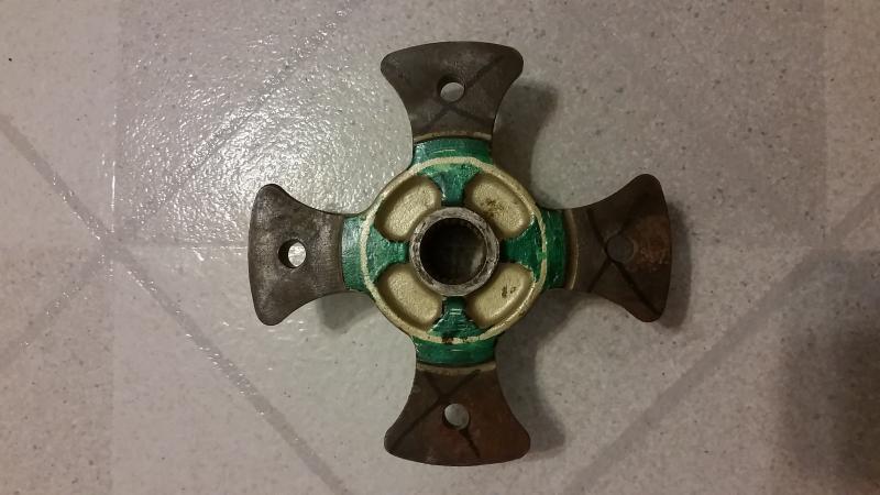

PostPosted: Thu Feb 05, 2015 5:20 pm
Here is the Protodie rear carrier, which looks like a biggie-sized version of the Polaris unit.

Shoot, I didn't know your an engineer, that's good, now you'll be able to understand me ! Ha! :-)
Yeah, I don't have the Polaris parts, I always wanted to do this, but never found a cheap frame nearby. I meant dimensions from the B-B cars.
I agree, through bolt, but theres two ways to go about it. 3/8" bolt with spacers(don't have to mod the housing) in the 1/2" heims, good because you can place the heim load right into the housing with a shoulder on each end. Or 1/2" bolt, good because you don't need any spacers inside the heims. Either way I would try to find a stock, high strength bolt and put the head towards the front, under the trailing links heims.
Also, I don't think you'll need it if you make the upper trailing arm mount the right way, but you could tie the upper and lowers mount together with sheetmetal to share the load.

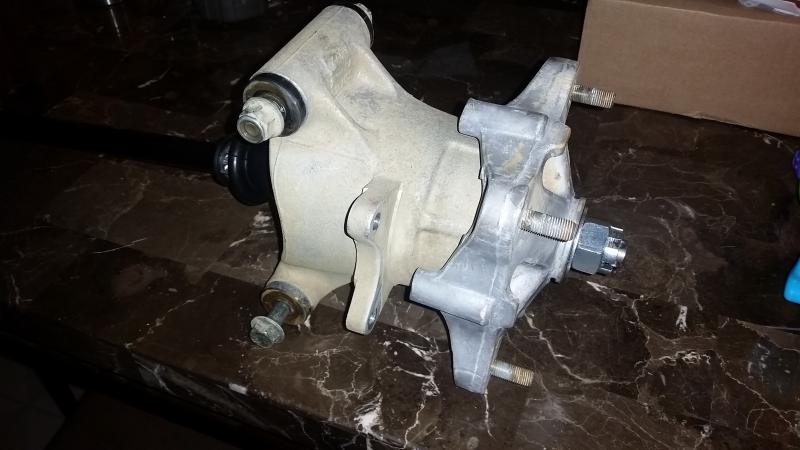

PostPosted: Mon Feb 09, 2015 11:40 am
"I have to have a mild surgery tomorrow"
Still with us? :-)
Hope the surgery went well.
PostPosted: Mon Feb 09, 2015 9:50 pm
Ha, yes. Let's just say I spent Friday thru Sunday with a bag of frozen peas! lol
Got the knuckle today. It's beefier and about 1" taller than I thought. The assembly is a nice tight package. Anxious to lay it out next to the stock suspension on the buggy for a comparison.
The holes are 5.25" apart ctr to ctr. The top hole is 3" wide with 1/4" spacer on each side. Bottom is 4" wide plus a 1/4c spacer on each side.
