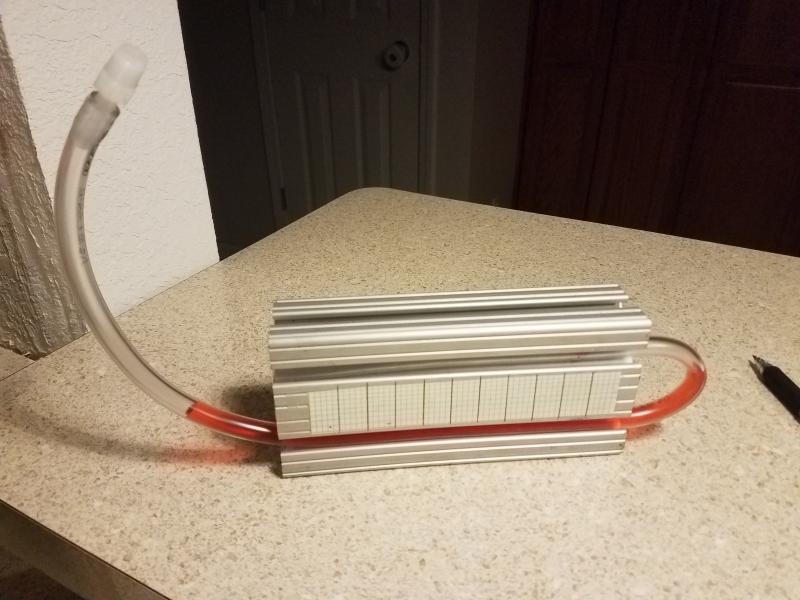

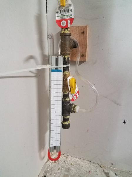

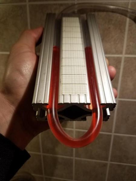

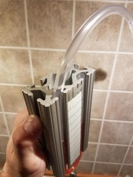

So I recently (finally!) setup a my shop with its own dedicated heat source -- a ProCom 75k btu unit with thermostat. One of the last tasks was to install the LP conversion kit and then adjust the gas valve to 1.0-1.5" WC. Tool for the job is a manometer. Not exactly something i keep around, but also something simple to build out of some basic stuff lying around my shop. I used a piece of leftover 8020 extruded aluminum, some 5/16" clear tube, a hose barb with 1/8" thread, a piece of 1/2" ruled log paper, double sided tape, and some dyed water (food coloring). I couldn't find another one on the web with 8020, so thought I'd share. It also stores neatly on its side. =)
1st four pics are rotated (stupid phone).
-Dan A.
PS: AT THIS POINT, I HAD NO IDEA WHAT THE MANIFOLD PRESSURE SHOULD BE. UNDERSTAND I AM NOT A TRAINED HVAC PROFESSIONAL, LOL.

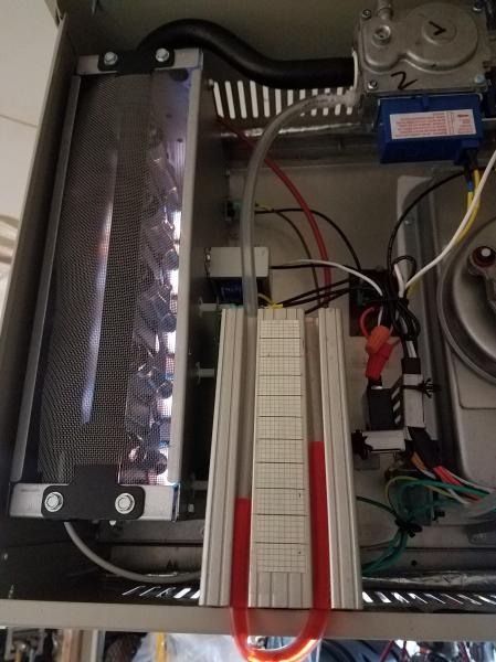

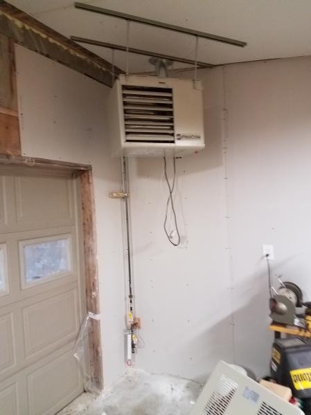

Made a 2nd larger gage for the incoming LP pressure. Thought I had an issue but ended up just needing to bleed out the air more/longer out of the lines.
11" WC coming in from the regulator, and 2" WC flame adjustment on the gas valve (for efficiency and heat exchanger lifespan).

My heater was making a high pitch whistle-sound at the flame and flame seamed pretty orange.
So in re-reading my gas conversion kit instructions, I believe I made an error. The recommended incoming gas pressure is 11-14" WC and then no more than a 2" WC DROP at the manifold (not 2" WC pressure). The target pressure at the manifold is 9.5" WC at my altitude in 0-3500'.
When I re-measured everything I'm consistently getting 11.5-12" WC line pressure and 9-9.5" WC at the manifold. No more whistle + she blows more heat.
Also the heater fan (not exhaust) never shuts off. I've got 4 connections on my tstat when I should only have 3, hence the extra connection is triggering the fan to run constantly. Need to get a roll of 3-wire tstat wire to mount the tstat where I want it (not hanging off the heater with stereo wire like in the pic) and then will have this thing purring on its own. Gonna be 50's-60's next few days, so no hurry.
