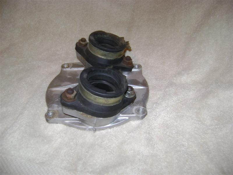

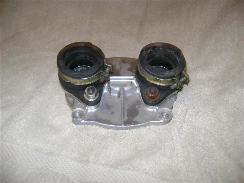

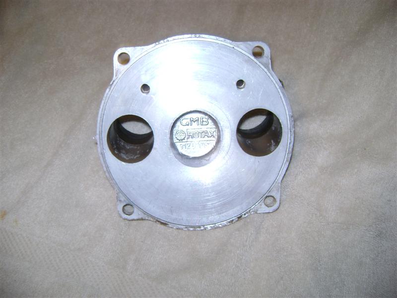

You tried the PWC sites their has to be a carb guru that can tell you whats up with your setup?
You mean one of these manifolds? ROTAX part number 912 570575 ? Dunno how big of carb this will accept without modifications it was used for 38mm carbs but I could send to you and you can see if their is anything you can do with it at least use it for mock up to see if carbs could clear the trans.
Personally I would search the web looking for super BN idle problems find a super BN guru I would think the 38mm carb would work on a 335cc cylinder just fine especially at low RPMs .
You still have the choke plates installed and can cut off some air at idle see if it helps? if not pull the filters and use your hands over the inlets of the carbs.
Tried a couple PWC sites but ive not gotten anything from them other than what the factory settings/jetting should be for the seadoo that the carbs came off of. That is really tons of help....
Hoser, i may take you up on borrowing that plate and see if it will work for me. I think it is exactly what i need but, i still don't think the carbs will clear the trans. I will go try and find a good pwc site that someone can maybe help me. Hell if i have to i wont say its on a sled Engine. shouldn't really matter either way. Im sure the Engine construction is the same basic setup from pwc/ski just different output shafts.
I do not have a choke plate, but cutting off the air does not seem to help. i will keep trying for a bit with these carbs. it is just extremely frustrating.

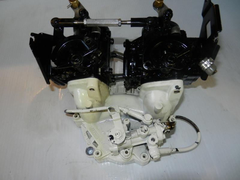

PostPosted: Fri Sep 14, 2012 4:32 pm
well these showed up today. they are from a 96 SEADOO SPX 717 . these carbs are CLEAN, they don't even appear to ever have been opened up. Still have the choke plates. My current carbs have been converted to primer, and have had someones grimey hands all over them.
picked this setup up for $100. I am not going to touch them. Bolt them on and see how far that gets me. hey are from a 717/720 so the jetting should be fairly close... Tomorrow i will see if they work. Just tired of my current carbs settings getting me nowhere. wish me luck... lol
PostPosted: Sat Sep 15, 2012 12:49 pm
Cant really see what you have their 38mm 44mm 48mm carbs? round or square bodied?
38 square pump carb. its a BNi38. bolted em on she Runs Okay. just won't start. hot or cold. I got it started and made it idle, but as soon as I shut it off and try to start it it will fire one time, then I have to crank other for a bit, then it will sputter and almost start then die. thos is fustrating. i don't know where to go from here. seadoo forums are no help, guus tell me the factory settings of a seadoo close to same size bit i can find that shit on my own. so back to square one. maybe i should find a different Engine to use..
