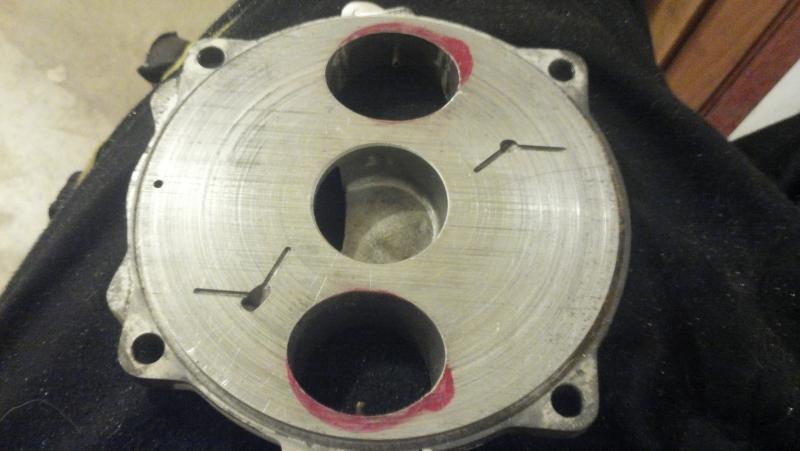

thanks hoser. Ive got a question maybe you can answer.
What bits am i going to want to purchase in order to port match my Seadoo intake to my Skidoo Engine? you can see in the picture below i kinda half-assed sharpied where the skidoo Engine had a larger intake port than the seadoo. I could leave it but i feel that it would be much more efficient to make the ports on each part line up. Am i correct? ANd do you use a dremel for most of your port work? or an air grinder? Im not looking to change the porting on the Engine at all, just hoping to match the intake and case up just a little better.
I don't see the pics with the miss matched porting can you post them?
DOH! i forgot to attach the picture.. haha!

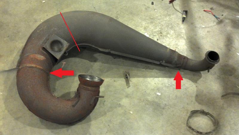

And to contunue with updates, i finally got the pipe that i am going to be using. Its from a 03 Arctic Cat F7. Its about the same size as the stock pipe, just slightly different in the way that it routes. My plan is to cut it apart at the 2 arrow. Make the 90* turn to the muffler face the opposite way, and then make the lower part route more like a stock pipe. And then if needed, i am going to cut it at the line and strech the angle there slightly while trying to keep the size of the pipe the best i can.

Nitro,
Definately the best pipe I found to work with, already has the tight bends needed.
A few suggestions if I may:
1. Keep the F7 attachment point to the Y pipe, those graphite donuts work really well. Just take a tube the inside diameter of the donut and weld that on the Y pipe end. The donut also allows for more misalignment than the old Skidoo pipe. I took two hole saws to make the flat backing plate needed for the donut. Cut half way through with the small hole saw, switch to the large and cut through, then finish off the small hole while holding with vice grips.
2. I cut a small pie shape out of the Y and welded it to the other side to start the curve at the pipe, also at the exhaust flanges cut Pie shapes out to keep closer to the Engine. Pie slivers keeps the length the same.
3. Take length measurements of the stock pipe and make this pipe match. You don't want the exhaust wave back to the Engine to be early (shorter pipe distance) or late (longer pipe distance). Measure both of the welded seams of the two pipes divide by two and make them match - either add or subtract to the F7 pipe to match your stock pipe. I also measured circumfrance at one inch intervals and made the pipes match. I would think the 670 pipe is fatter than the F7 pipe as it is a rotary valve Engine, match if you can but I think it is a secondary concideration to the length.
4. Keep stinger the same size as stock (end opening) If too small then it will build too much heat in the motor (( Internal Combustion Engine ? )), two large then not enough back pressure.
While cutting the pipe you won't get a perfect fit, don't worry, sand down to get best fit and don't feel bad with gaps, transfer gap to paper for a pattern then fill with steel. If gap is too small make it bigger, and fill with bigger patch. On my second pipe I tried to cut too perfect and after sanding I ended up with a 1" too short pipe. I wraped my final pipe so no-one but me (and now anyone reading) will know. :shock:

Thanks ak! I will keep all that in mind when i start fabbing the pipe. Right now i am working on mounting the radiator, and some of the dash wiring.

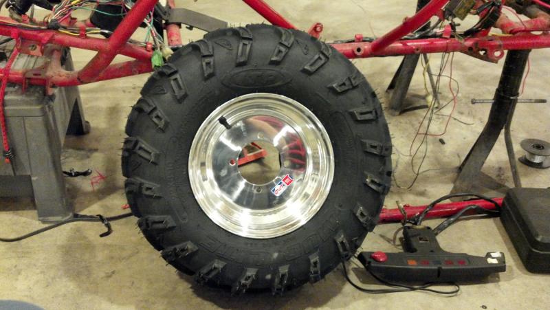

PostPosted: Thu Feb 09, 2012 4:26 am
Got my front wheels/tires today. Back tires should ship soon, only had 1 tire in stock so they are holding both of them until it gets there.. bummer!
Also installed both grip warmers and thumb warmers for the rides that are a bit cold. definately looking forward to those! Will make winter riding much more enjoyable.
Fuel tank will be here tomarrow. Hopefully get that mounted Sunday. Ordered some metal to fix the frame front and rear. almost done. not much stuff left to do. as soon as i fix the frame, and mount both the fuel and oil tank i am going to get the frame sandblasted and powder coated. awesome!

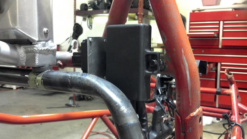

Made mounts for my CDI (Capacitor Discharge Ignition), fan controller, and coil.
File comment: CDI (Capacitor Discharge Ignition) / Fan Controller

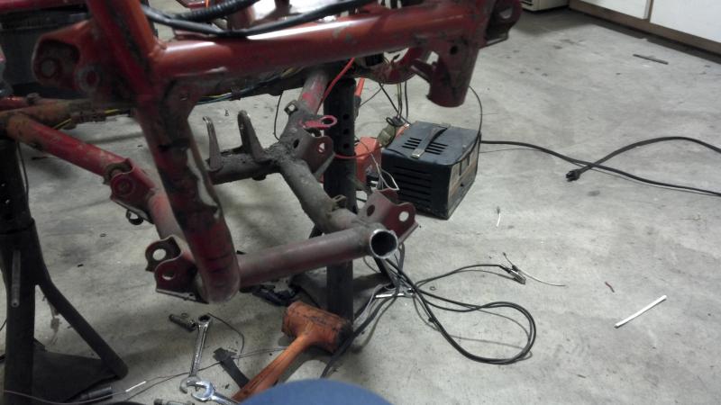

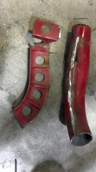

also started cutting the rear of my frame to replace the bent bars. Boy its hard to start cutting apart a frame
File comment: Cut frame!
Here i carefully cut the welds with a cut off wheel to remove this guard. I am going to weld it back onto the new bars

Will you be able to just weld in a new tube there or will you have to reinforce it there somehow. That was where I€ wasn't sure how to fix mine.

the plan is to chamfer the edges of the 2 pieces of tubing and weld them in. I would assume it should be plenty strong as long as i have good welds. I also thought about making a sleeve that fit snug inside of the pipe. that way would make it just as strong or stronger than the original.

I was thinking of a sleeve also. I wouldn't trust my butt welding,, lol

I will let you know how it goes. Tubing should be in tomorrow, and then i am going to take the peices to the local muffler shop to see if maybe they can bend them to match the old ones.

what kind of fan is that your running on the rad and where did the shroud for it come from..looks good but i don't know if its a good idea to have the whole back covered like that, with only a opening where the fan is, i think i would be better to get rid of the shroud and just mount the fan on the rad

It will pull alot more air with the shroud than without.

The radiator is an aftermarket Honda Civic radiator. The shroud is custom made. There is a guy on minibuggy that sells the shroud/fan and rubber gromets to mount the rad. As it is, i think this radiator is much larger than the Engine actually needs. I don't think the shroud will hurt the airflow at all, it will just direct it through the fan, and then once the fan does kick on it will pull air throiugh the entire rad instead of just a round spot.

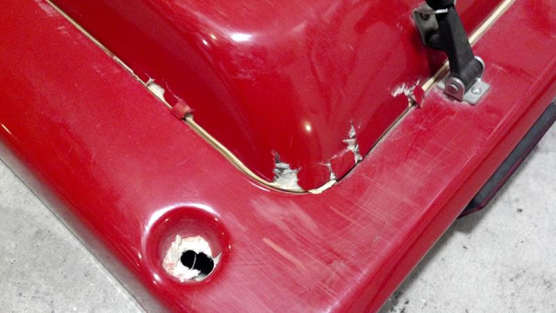

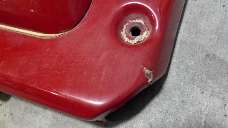

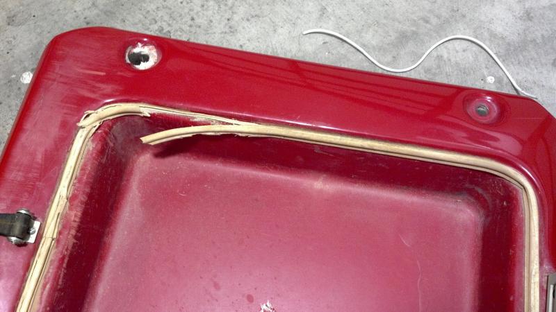

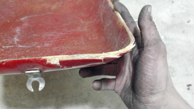

I picked this up the other day on ebay. a Proto-Glas roof pannel. Only downside is that it was involved in a roll over. it isnt broken up too bad. How should i go about fixing this? I have never worked with fiberglass before. Also, what is it painted with? is that stuff still availible? The thing isnt really broken its more just the paint has chipped off.
PostPosted: Thu Feb 16, 2012 5:51 pm
Nice score on the roof storage...
I have no idea how to fix glass though...
