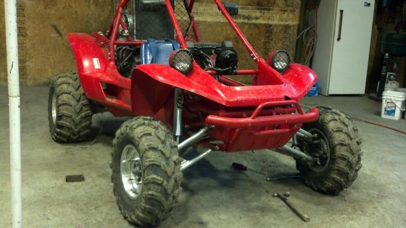

well to update this thread, a couple weeks ago i finally installed a set of FOX 2.0 shocks for the yoda front end kit. changed the entire look of the machine. The picture is right after i installed them. they had too much pressure in them. Dropped to 150PSI and it is much better.

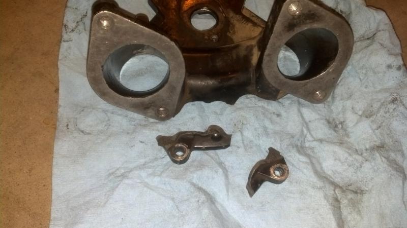

So, still having a nightmare tuning these carbs, i had them close, but it was just not runing consistent at all. So i brought it into the shop and decided to start looking for air leaks again. Started a leakdown test and it would not build pressure at all. Sprayed some soapy water around the intake area, crank seal area, base gasket ect. Started getting some bubbles coming from the intake, about where the 2 pieces come together. Took a cloer look, noticed a crack.
I have a different intake as a spare, so i got it out. I put the new piece ontop of the old intake base and noticed it did not sit flat. Grabbed the new intake base and it would sit flat on there no problems. So, looks like the old intake base was warped, causing excess pressure on this piece. Probably never has sealed well at all either.....
Here is a picture of the crack. It is very small hairline crack, hope you will be able to see it.

PostPosted: Mon Aug 19, 2013 3:10 am
very small ha ha :-) :-)
