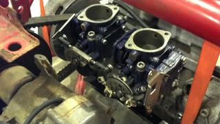

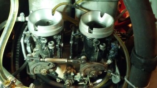

I do need one pic as i think i may be missing a part. I need a pic of the throttle cable where it connects the carb. I don't think think i have the bracket where the cable/ adjustment nut mount.
PostPosted: Tue Apr 01, 2014 11:33 am
This help? I ended up making my own from a piece of flat aluminum to get the cable in a slightly different spot than the stock cable bracked allowed.
Here is a link to my pilot picture album http://s23.photobucket.com/user/nitrosp ... ma%20Pilot
File comment: Seadoo
tmp_2011-12-30_19-54-29_26.jpg~320x480104403484.jpeg [ 25.19 KiB | Viewed 3472 times ]
File comment: Mine. Simple flat aluminum piece with a slight twist. Needed it to come from bottom to clear oil tank
tmp_2012-12-16_22-08-27_688.jpg~320x4802064148558.jpeg [ 23.1 KiB | Viewed 3472 times ]
