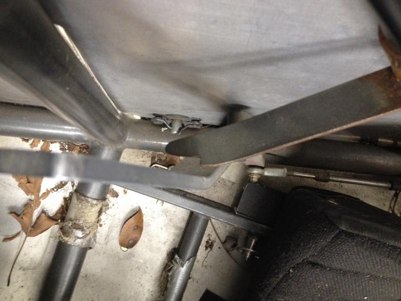

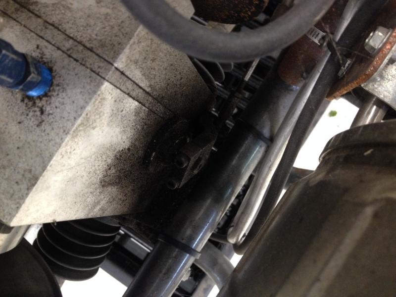

This trans does have a detent but it’s on the inside of the transmission where the shift arm/fork are. Evidently it didn’t work as planned or it’s just worn out. I have tried different strength springs with no real luck. I generally just leave it in drive and try not to get stuck or find my self short of room to turn around. There are no parts for these and one gear here or there is way to expensive. When it does die I will be getting an RPM box as well.

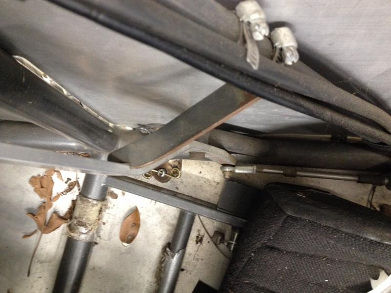

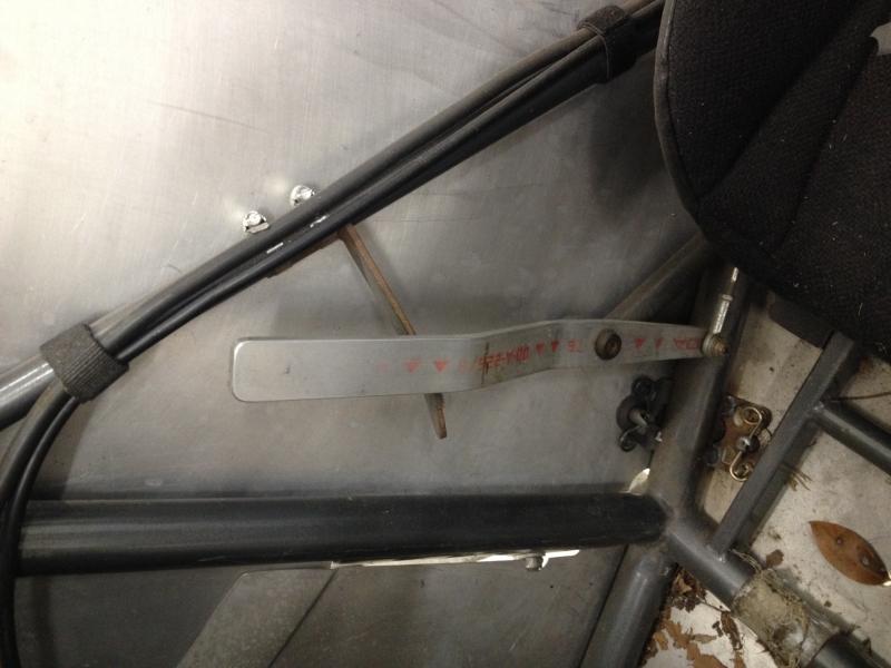

The Briggs shifter is just a piece of bar stock aluminum on a shoulder bolt. The stop just swings over on hose clamps. Does not pop out of gear when the stop is not used. Has pretty decent detents in trans. Single cable, looks like about a 10-32 thread. Looks like the cable that comes with an old B&M auto shifter.

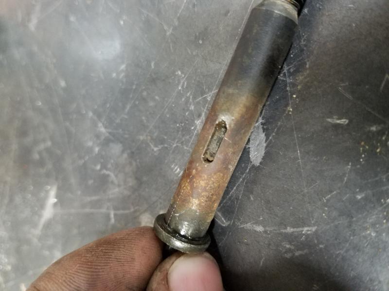

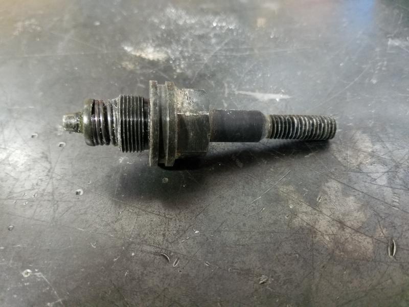

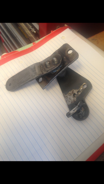

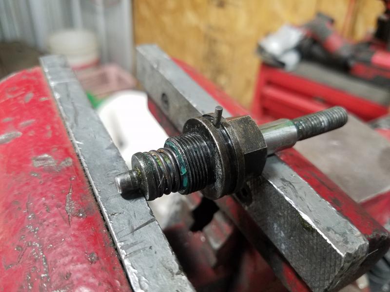

I finally had a couple minutes to spare today between waiting for parts for everyone elses junk, so i decided to tackle my shifter. Its been froze in the 'up' position as long as i have owned this machine. Here is how i got everything freed up.

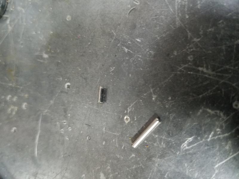

This shifter shaft is not meant to be tore apart. There is a small 2mm pin that keeps the shaft from spinning and only allows the shifter to move so far. Brute force was the solution for this, i screwed a nut on flush with the top of the shaft and gave it a few good whacks and it sheered the pin and drove the shaft out the bottom. After it was apart i cleaned the rust and burrs off of everything so it would move freely like it was supposed to. Now for a replacement pin i resorted to my stash of small parts and pieces from my RC car days. There was a 2x12mm pin i had from some old car that turned out to be the perfect diameter. Its a little long, but once this is a proven repair and im certain that it doesnt need to come apart again i will probably trim it off. I still need to get a replacement seal, it measures out to 10x16x4.5 if anyone ever needs one, its probably the same as a motorcycle clutch arm pivot. If i look in my hoard i may even have one on the shelf, otherwise im going to order one from Feebay and see how that works. I would love to find a NOS shift boot as mine is in pretty rough shape, i may be searching a while for that piece. For now its just smeared with some black RTV, better than nothing.
While i was in there, i also tried drilling an extra lock position for FWD gear as CO suggested. There is not enough room to drill a second hole for the shifter to lock without creating one large hole. So to do this, i had to fill the stock neutral lock hole before i could make a forward lock hole. I took it for a ride this afternoon and this does seem to fix my jumping out of gear issue. Going to go camping this weekend so i will really get to put it to the test. Once its proven ill show how i did it, all in all between freeing up the shifter and drilling the new hole i have about an hour into it. Pretty straightforward to do if you think about it a bit.

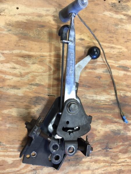

As for you other guys not using the stock shifter for your transmissions that pop out of gear, I have a question. Why don't you guys use a style of shifter that was on my dad's 1969 396 chevelle ss that he had back in the 70's when I was a kid ?? It had a 4 speed Muncie in it. The shifter had a "T" handle on it for when you wanted to put it into reverse. This T lockout handle prevented you from nailing reverse by accident. Below is a random pic of what I am talking about. It's that little "T" in front of the main stick.
We could do similar here but it would hold your transmission in gear by locking your shifter in the foreword and may be even reverse position. Just a thought.
CO

canadian oddy wrote:
Baahahahaha good one.
I never thought about that when I took one of mine apart.
I F'd around for hours.
What was your solution to get it apart? I have a couple spare shifters from my fl350 days so I wasn't too afraid to mess it up.
Lube, fooling around, a sharpened set of needle nose vise grips and blind luck it came loose.
I was actually almost ready to grind out around the pin and grab it with the needle nose.
Never even thought about getting violent even though that is my trade a lot of the time.

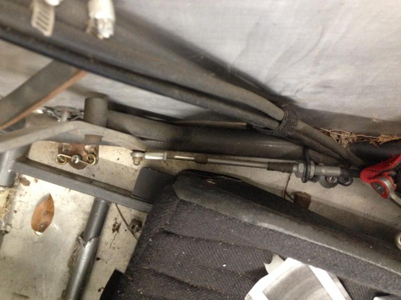

Now that I finally have a bit of seat time on this setup, there are a few things that worked exactly as planned, and a few things I'm going to have to change.
First off, the popping out of gear issue is solved. I think my problem was the stock cables were unsupported and stretched a little further than they should have been, so everytime I'd hit a bump it would pull itself out of gear. I made the stock shifter latch in gear as a safety, but there is no tension on the cables, so it's not holding it in gear just not allowing the shifter to pull it out of gear.

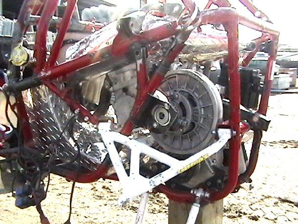

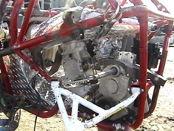

Hey Matty,just a few ol quick FL800 pics I found on my PC for ya.I'll take some more diff angle ones later on when I can.
That is exactly what i want to do, thanks Baz. That will make servicing the clutch so much easier.
Found some tubing couplers at kartek, that may be the way to go if I can get the right size.

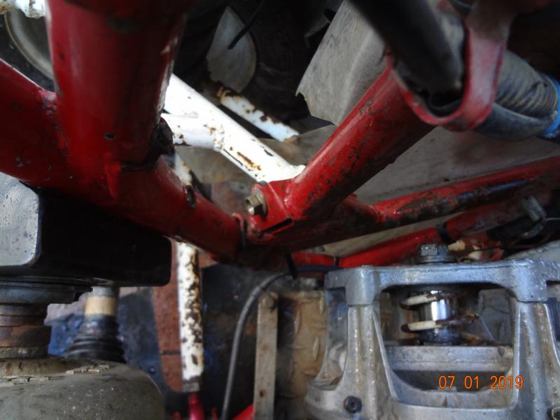

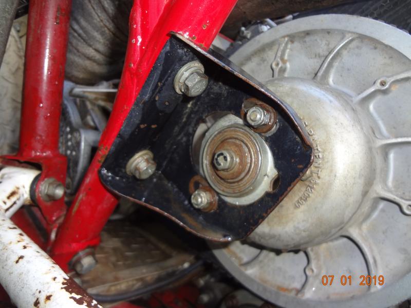

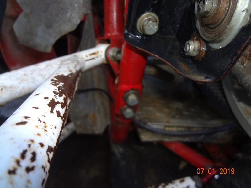

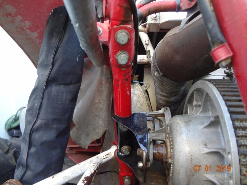

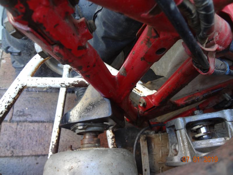

Took these pics this arvo,before going back to work Matty.
The OEM Pilot joiners are easy to replicate,and remember to include the small tube anti-crush tubes internally for the bolts.
Also remember to orientate your joiners so that they allow the member to come-away so long as they are in sync.
This will avoid you getting your Knickers in a Twist! :shock: :-)

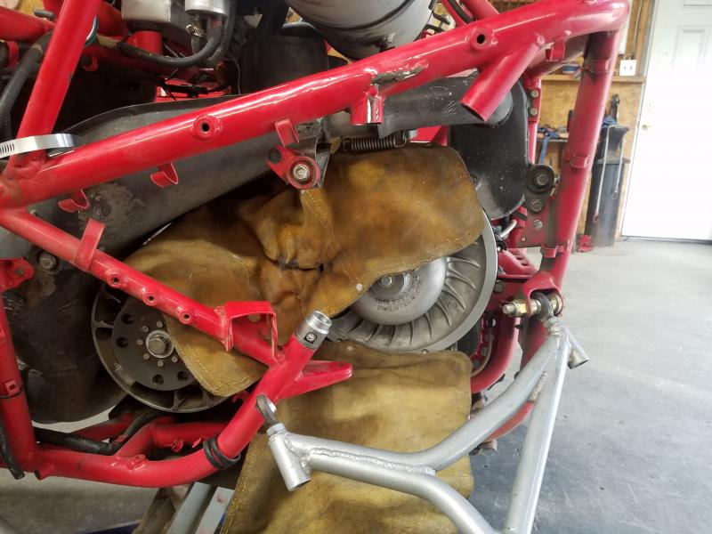

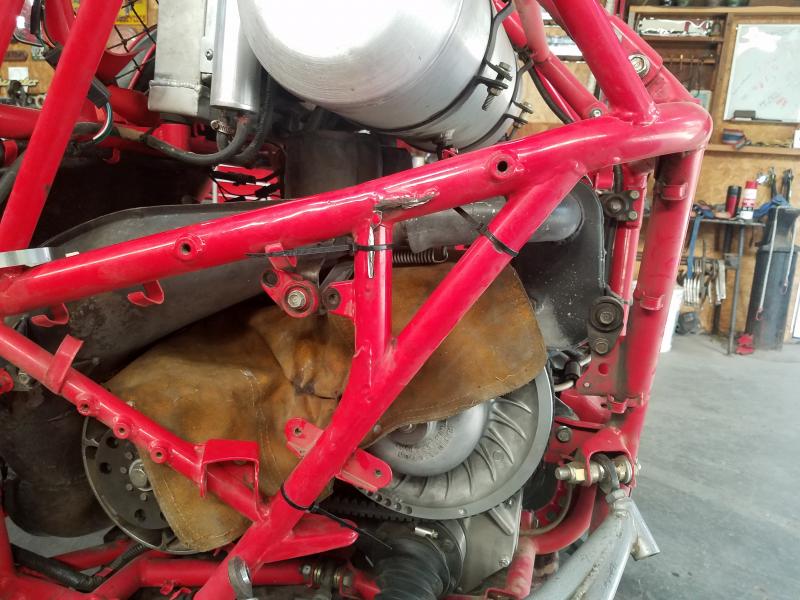

Made a couple more changes to the clutching on the pilot today, and I cant believe the difference that it made. From the first ride I took with the new gearbox setup the pilot just didnt seem as quick as it used to be. The power was there, but it just didnt feel quite right. So after talking with the guys at Venom Products (place I purchased the driven clutch) I pulled the primary to see what the setup was. Like I thought, the clutch I was running was stock for 99 Summit X 670 sled. I had a spare clutch I pulled off of a 98 Summit X 670 that was long tracked by someone and it was setup with a heavier spring and heavier pins in the rollers. Evidently that's just what I needed because this thing pulls like a monster now, the front end is awful light :-) . It pulls right to 76-7800 and maxes out at 8000. Going to leave it here for now and do some more reading on tuning the Skidoo TRA clutch, I must be awful close to what it wants.
I also started on making my frame section removable. Got everything cut out and fitted, just need to weld it up in the morning. Welding tubing is no fun.
File comment: Used zip ties to try and get as straight of a cut as I could.... it worked....kinda

 Post subject: Re: RPM Gearbox
PostPosted: Wed Jul 10, 2019 11:53 pm
Before you go crazy with the welding you better verify the orientation of the cam locks.
Just one small tac on each and then try to take it off.
Just my opinion.
CO

Yes I was thinking the same thing. It wouldn't be cool if it was finish welded and non removable again.

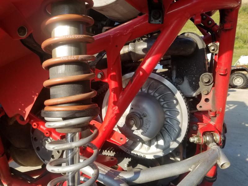

Thanks for the input, i was hoping you would chime in eventually. Your FL800 pilot was kinda the inspiration throughout my pilot sled swap endeavors.
The roll bar pieces that i bought don't actually lock together, they just sit on top of each other so it comes on and off fairly easy with no bind. My input shaft is short enough that i can get the clutch off with the cutting that i did. If i had to order the gearbox again, i definitely would have had a longer input shaft installed to do the outboard bearing support much like you did. i was thinking about seeing if Dan would make me a longer input shaft so if i ever have to take the box apart in the future i can upgrade my bearing supports even more.
I think i finally got the clutching figured out, or at least very close. Ive got heavier weights in the primary and a stiffer spring and it will bite and take off like i wanted it to. It was pretty lazy with the lighter stock spring and weights. The starting setup for the secondary from the guys at Venom is a 38 / 42 straight helix with a 140-240 red/black spring. Im quite happy with how it is shifting out at the moment and my belt doesnt seem to get very hot, so i will run with it like this for a while.
I pulled the pilot out of the shop today to get my moms car up on the lift, so i had to take it for a spin. Didnt realize she was filming or i would have tried to get a better video. at least it wheelies again ;)
