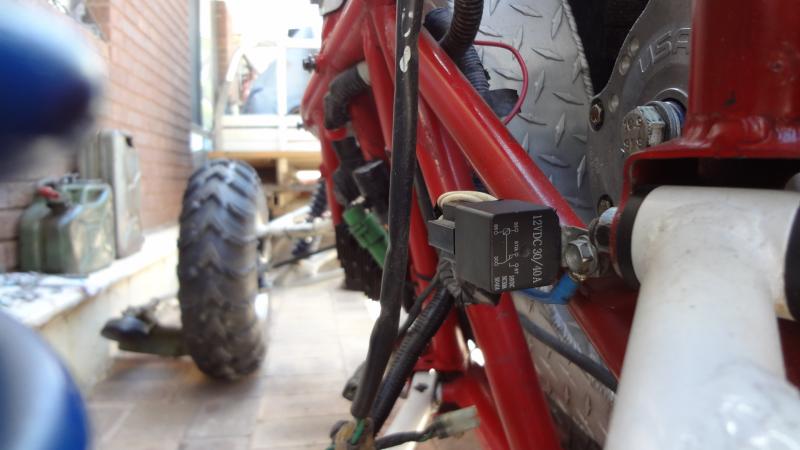

I am having trouble figuring out exactly how to wire up the relay. I know how you wire a standard relay on a car for say a set of headlights that draw lots of amps, it would be like this diagram. But if i wanted to use it for the killswitch, how exactly would i go about that? thanks

Nytro,
Like I said it has been a long time, but... Look at the relay Bazz has posted, when the relay is powered then you can have a open circut and when not powered it is open. Diagram on back of relay.
Take the Honda switch make it control the Relay (primary side). When the Honda switch is on (Honda CDI (Capacitor Discharge Ignition) is grounded) then you want the Skidoo ungrounded. Then run the ground wire of the Skidoo CDI (Capacitor Discharge Ignition) to the other side of the relay (secondary side) at the bottom and then ground one at the top, leaving the other pole open. This make them reverse from each other, this is kindof a poor mans reversing relay. Then just test with continiuity that the Skidoo is grounded in the off position and open in the on position.
Ak

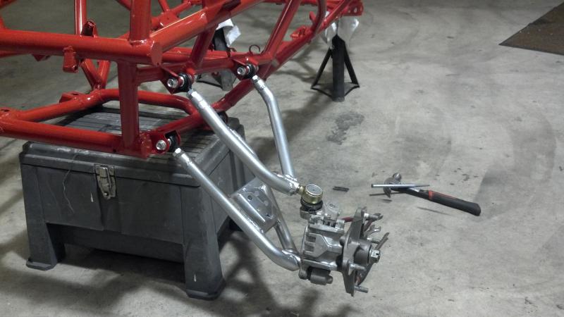

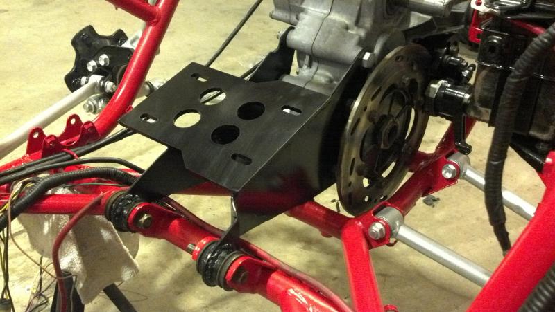

PostPosted: Tue Apr 10, 2012 11:11 pm

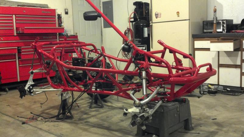

Got a little done this weekend. Put my front arms on, and some of the rear suspention. Also put trans in but it is not pictured. This upcoming weekend i think i will set the Engine in and start working on getting my pipe fitted. Going to be using the arctic cat f7 pipe.

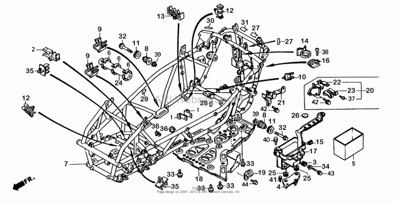

PostPosted: Wed Apr 11, 2012 5:26 pm
Parts 32 and 39 ?
90101-727-000 BOLT, FLANGE (10X55)
94050-10000 NUT, FLANGE (10MM)
PostPosted: Wed Apr 11, 2012 5:31 pm
Yes, 39 is what i am specifically looking for. I found the part numbers and all but i cant find anywhere what they look like. now that i think about it, i know what the suspention nuts look like and know what the roll cage nuts look like, i shoulda just compared part numbers
PostPosted: Wed Apr 11, 2012 5:48 pm
They are a flanged nut and bolt look at your upper rear A arm bolt and nut...
PostPosted: Wed Apr 11, 2012 5:54 pm
Thanks. Are they the ones that are sorta crimped at the end to make them a lock nut? Im assuming they are

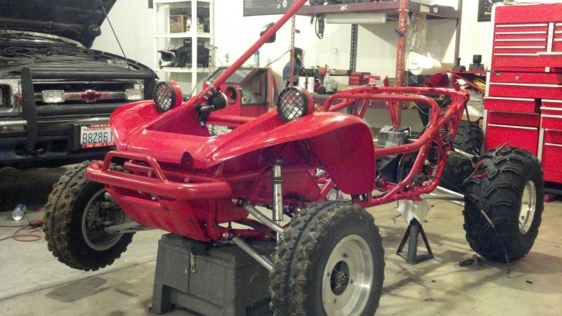

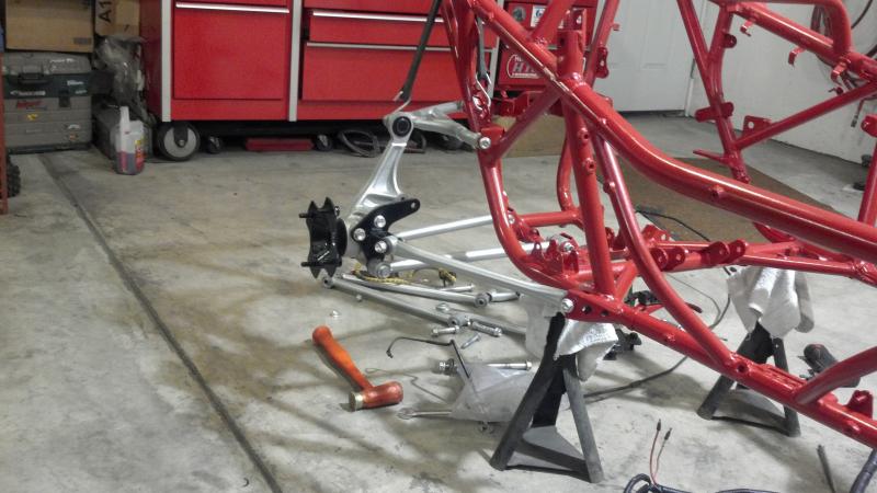

PostPosted: Mon Apr 16, 2012 2:46 pm
Worked on it a bit more this weekend. Working on building my pipe right now. I am using the arctic cat f7 pipe and i should be able to fit it in there without altering the tuned length of the pipe. We just cut it apart where the factory had welded it, and will be spinning it around slightly. It should fit pretty well. I am using the stock 670 header, with the Arctic Cat dounut on it as suggested by others. It should turn out pretty good. here are some pics. my fenders /front wheels are just hanging there in the picture
I need a new foot tub, the missing chunk is driving me nuts lol

Well, i feel kinda stupid because i still have yet to figure this out. I have the relay controled by the honda switch. when i move the switch to "run" power runs through the switch and switches the relay on. I have one side of the relay grounded and then the other side is run to the Skidoo. this makes the switch work the same way that it does without the relay. when the switch is in run the ground runs through to the CDI (Capacitor Discharge Ignition). if it is off it is a closed circut. Am i doing somthing wrong? this is how i have it wired.
30 - to CDI (Capacitor Discharge Ignition)
85 - ground
87 - ground
86 - hot from honda switch
I have one side of the honda switch hot with power from the key, and the other side i have run to '86' on the relay. So once i move the switch to the on position it alows current to flow through to the relay, turning it on in "run" and off in "off" position. SO with 87 and 30, they are open grounding the skidoo when the switch is in "run" and ungrounded in off. this is opposite of what i want and works the same way as if i were to hook the skidoo to one side of the honda switch and ground on the other.
PostPosted: Fri Apr 20, 2012 8:37 pm
Posts: 185
Location: Anchorage Ak
Nytro,
You can't use that relay, you must use a relay that has one like in the picture. Your using a relay that the primary and secondary circuts mirror each other. That relay is for having larger amperage going through the secondary circut so your primary circut can much smaller. Typical horn relay.
The relay your looking for is the secondary circut comming in and being able to go one direction or another. Once the primary circut is activated then continuity is changed. Bring the CDI (Capacitor Discharge Ignition) from the 670 into the common pole (lower left on relay) and the ground and open into the opposing poles (lower right). If it works oppsite then switch these to around. Honda switch controls the primary circut (top two in Picture). Sorry I can't see what the number are in the picture or it would be easier.
Ak
