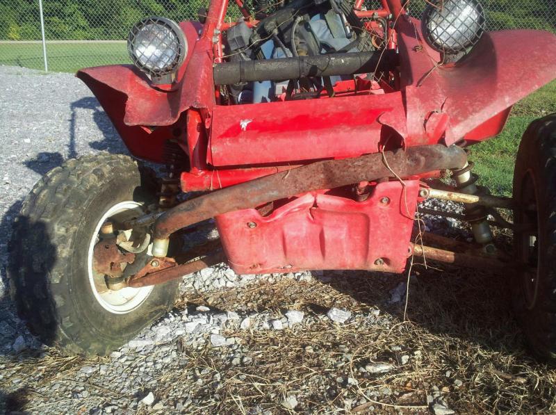

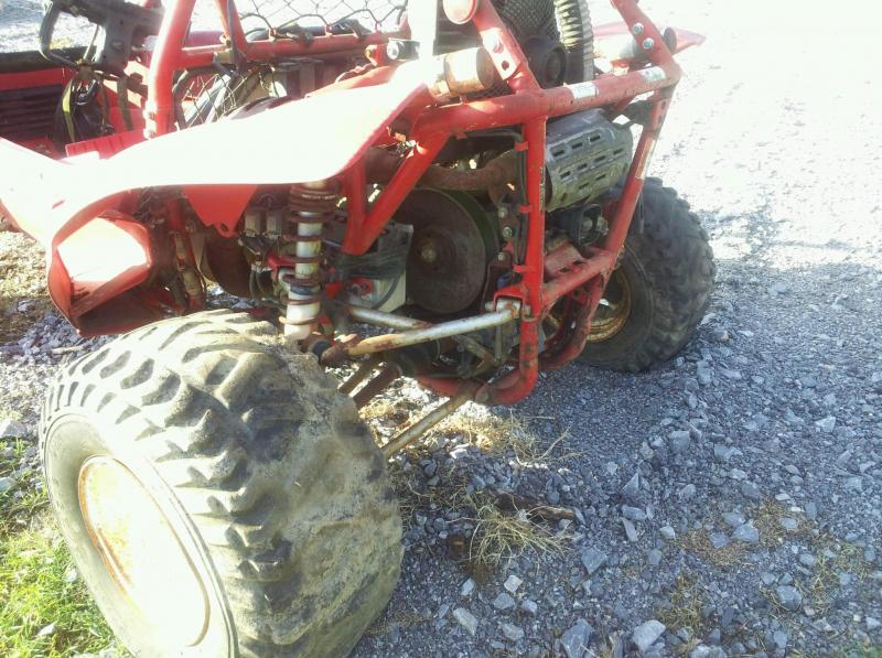

I am going to go ahead and bring this thread back to life the best that i can.

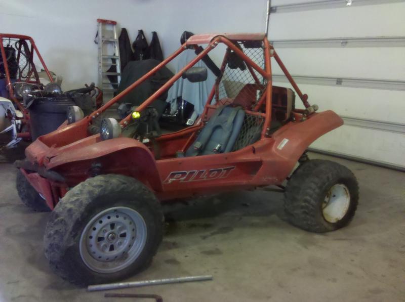

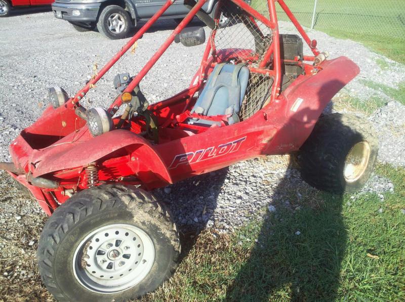

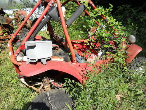

I first ran across this pilot on eBay and decided that i would watch it. Never really had intentions of winning it because i figured the price would climb well beyond my budget since i would also have to pay for shipping clear across the country (Alabama to Washington). As it neared the end it hadn't gotten bid up way out of control so i decided to place my bid, and i won it at my max bid. One more bid and i would have been out. $657. The description didn't know much about it and the only pictures that were there were the 2 attached below. The seller was selling it to help clear out an estate.
File comment: Ebay Photo
After i won the auction and began making arrangements for shipping the seller contacted me saying that the pilot was in much worse shape than he though. These were the pictures i received. he told me that if i did not want it after these pictures that he would understand. It really was not anything i did not expect, it had been sitting out where it was for 10 years or more.

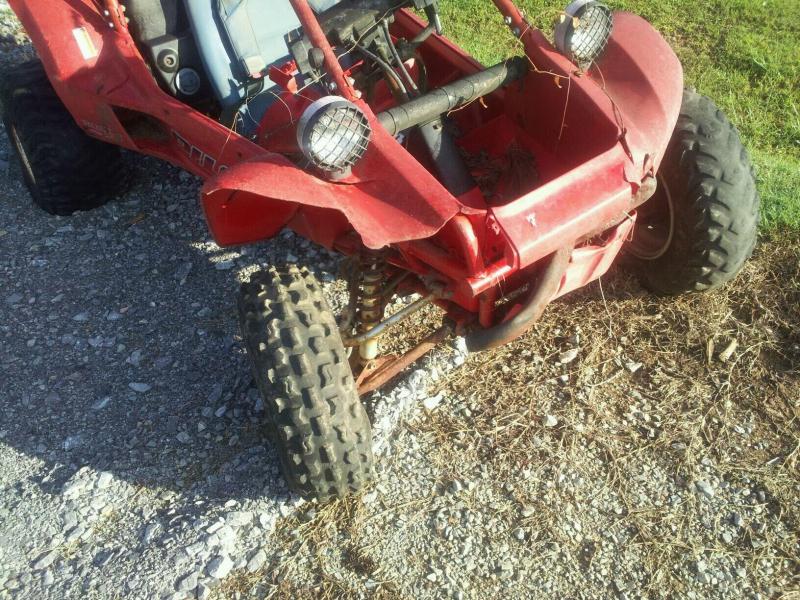

After weeks of dicking around with the shipping company, and having it not arrive on the date that was agreed upon it finally arrived. These pictures are of it fresh off of the shipping truck. Still filled with leaves from Alabama!
File comment: Finally Home

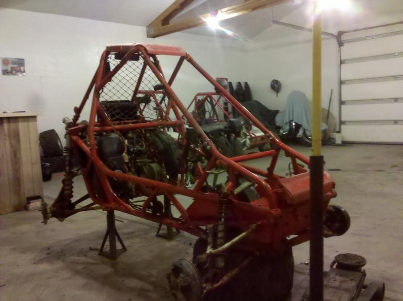

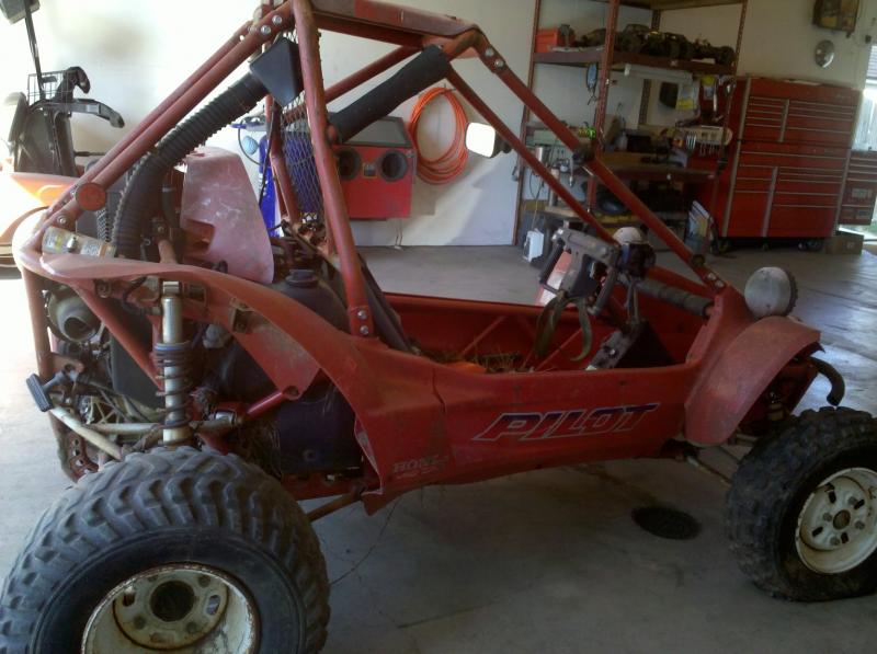

It only took me about 10 minutes before i started tearing into it haha! First i had to get the fenders off of it to make it easier to pressure wash. The side panels were a B**** to get off but finally with my impact gun they came off. This is after its first bath in 10+ Years! And i had to add a family photo of the pilot with its older siblings haha
File comment: After its first bath
File comment: After its First Bath
File comment: Family Photo
So the tear down began, and it did not take me long at all to have a stripped pilot. My initial plans were to use the factory Engine, but when it had a twisted crank my plans changed. I began looking for a good organ donor. I ran across a 1998 Skidoo Summit X 670 that had the crank bearing let go and twisted the crank. The only reason that i purchased it was because it was the entire sled cheap enough that i could part it out and have money ahead plus free Rotax 670HO parts.. a win win!

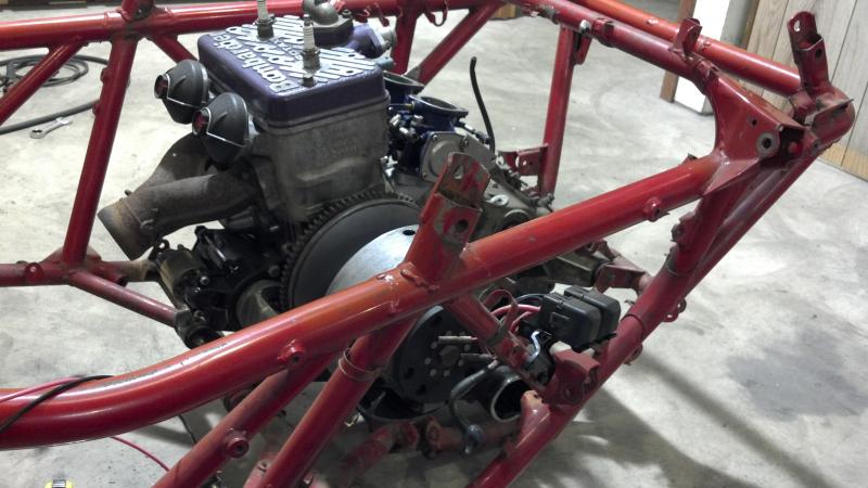

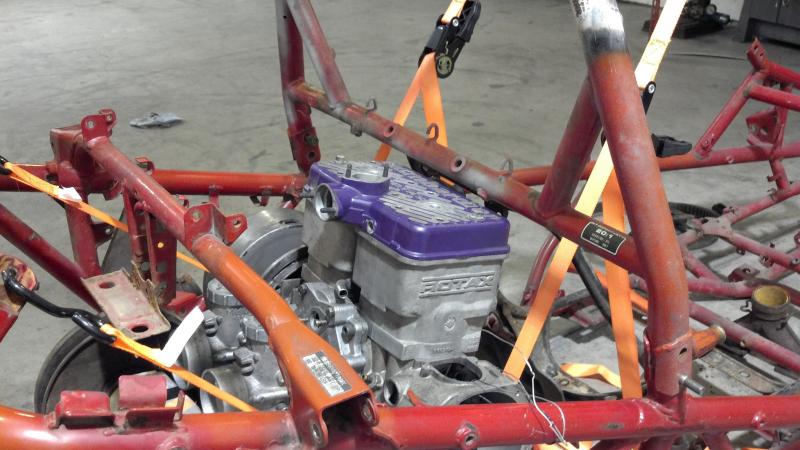

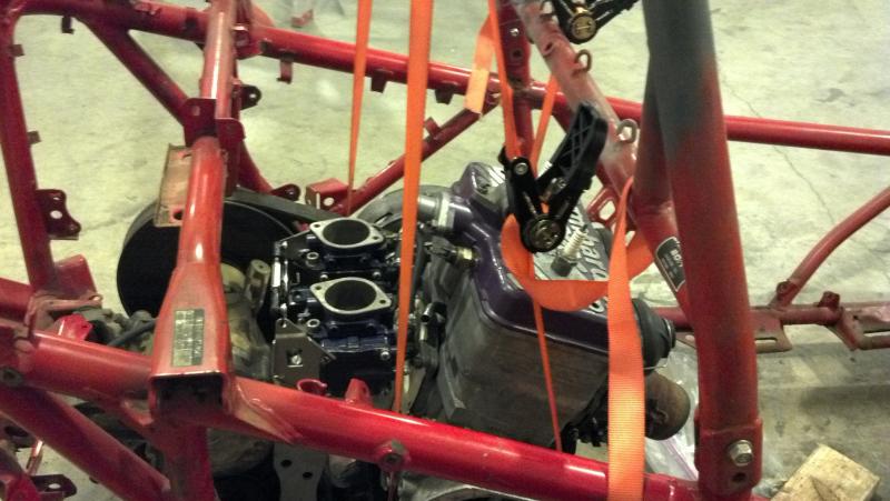

Now that i had the Engine that i was going to use, it was time to start figuring out an Engine mount. I ran into a delema when it came to mounting positions. Do i mount the Engine high and retain the use of the stock slide mikuni carburetors? Several people here recommended that i use SeaDoo downdraft carburetors because they take up much less room and would alow my Engine to sit down lower in the frame - witch i really liked.
File comment: Do i go high?
Much Better Position
File comment: Ahhh much better
File comment: The lower the better!

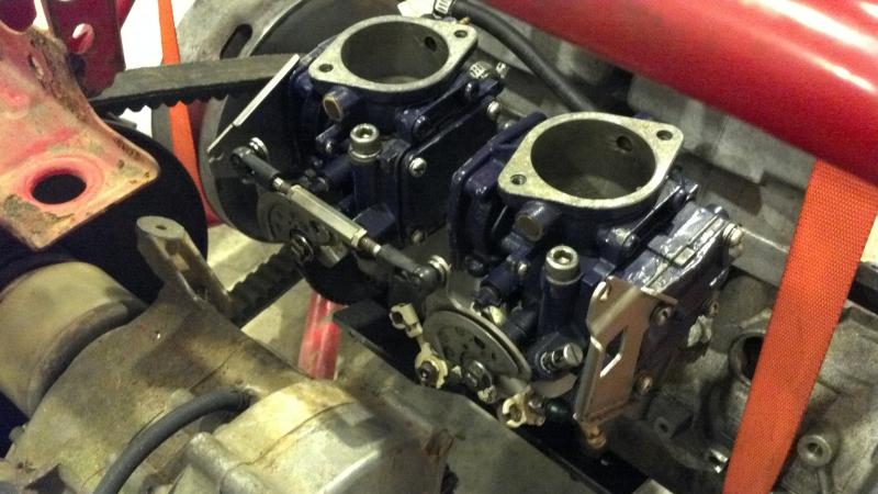

File comment: Downdraft 38mm Mikunis and Seadoo Intake

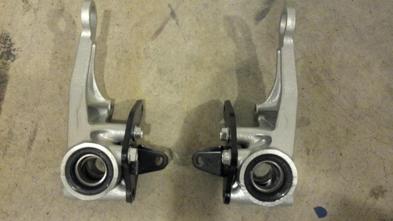

File comment: Fresh Hubs!

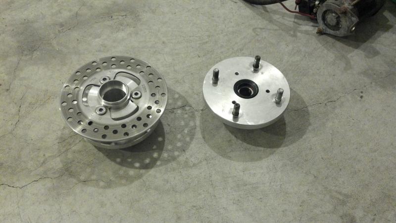

Here are a couple of special parts that i acquired. The first is a disk brake kit. Should help stop this beast! the second is my rear DC shock brackets! should help tame the beast's ride!
File comment: Disk Brakes

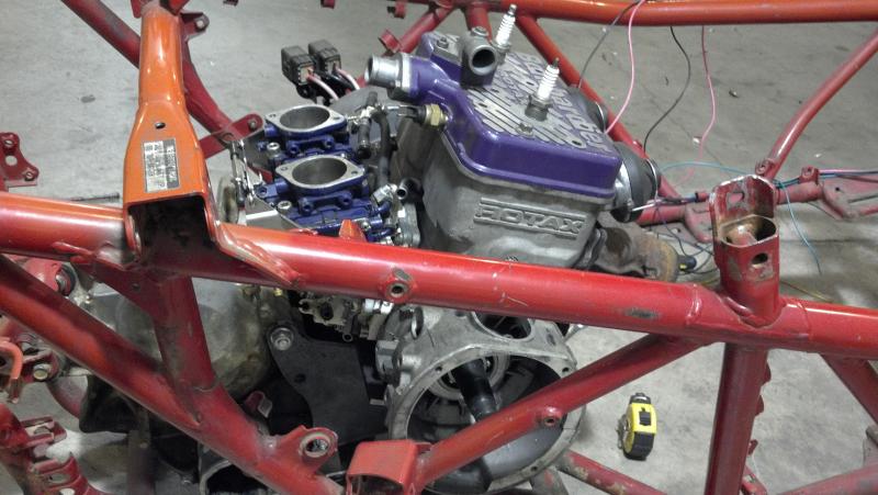

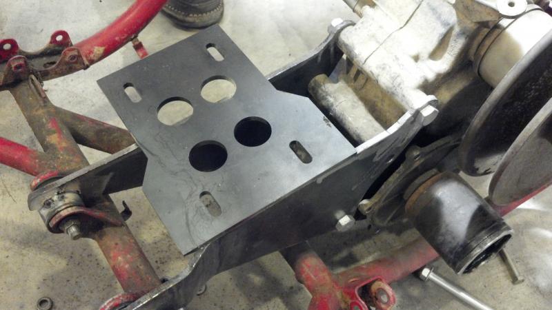

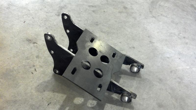

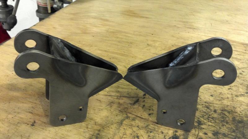

Got my Engine mount tacked together today. Will finish welding it and adding in a few braces for any side to side movement it may have tonight or tomarrow. I think it turned out pretty damn good. Im happy with it
PostPosted: Sun Jan 15, 2012 10:10 pm
Posts: 224
Location: Ontario Canada
I like those carbs on there. I wish I had known about them when I did mine, would have saved alot of greif positioning the Engine.
keep at it.

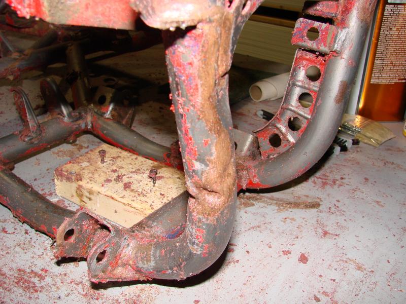

Finished removing the mounts for the stock radiator on the frame today. I have no need for them so i sliced them off to make room for whatever the hell else i feel the need to put there.
While working on my frame, i got to thinking about the smashed up rear of the frame. What would be the best way to go about replacing this piece? the one side should be fairly straight forward but the other side has a bunch of guards and stuff on it. Im also afraid that once i cut that frame bar the whole frame is going to stretch and bend and become not square.
Last night when ahead and ordered my temp gauge and an adjustable radiator fan thermal switch. tomarrow i am going to order the rebuilt crank for the 670, a gasket kit, and a new set of rings.
I also had a question on what people have done to mount the sled tach. part of me wants to keep the tach. I would love to mount it with somthing like http://www.summitracing.com/parts/ATM-3202/ (i realize that isnt even close to being right size, but its what i orderd with my temp gauge. i think the tach from the skidoo may be an odd size. do i just measure it across from one side to the other where it would slide through the cup? im guessing i will have to do some custom fabrication for a mount.
File comment: smashed frame :(

I have a frame that needs that same type of repair and had no idea how to go about it. I would like to see how you do it, Then I will have number 2 ready to put back together.
PostPosted: Tue Jan 17, 2012 8:01 pm
David when i go to tackle it i will make sure and document the progress. I don't know how the hell these things get so smashed up. I would be pissed if someone was ramming into me. Im thinking my pilot had a rough life. that explains why it was sitting outside in the weeds. Luckly it met me and is being resurrected!

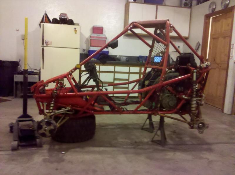

This weekend i worked on getting some smaller things done. Engine mount is complete and installed, it looks good. figured out kinda what we want to do to mount the radiator, so i will get some tubing ordered for that. started thinking about how the exhaust is going to work... I really don't want to use the stock sled silencer, its a huge ugly square that weighs probably a ton, or two. Would a silencer like this be enough? www.motorcycle-superstore.com/4/22/258/ ... estor.aspx or would it be too restrictive? Is there somthing better out there?
