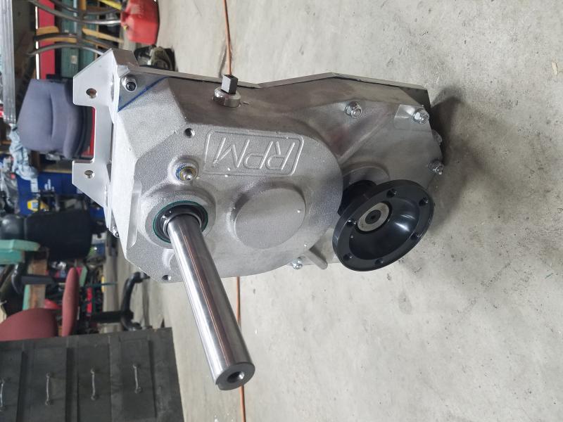

Well, I finally bit the bullet and bought an rpm gearbox for my LT 670 Pilot. I've wanted one of these ever since watching AKPilot build the infamous fl800 and I finally have one. I decided on a 9:1 gear ratio with 930CV joints. It should be an animal once all is finished.
The next piece of the puzzle is building the adapters for the outboard cv joints. I thought of many different ways of doing this, my first idea was to use VW sandrail micro stub axles and bearing carriers and build a ncomplete new rear knuckle. After pricing those parts I wanted to try a bit more simple and cheaper option first, building an adapter ring to bolt the 930 cv to the stock fl400 outboard joint.
Weeks before I bought the gearbox, my stepfather had ran into an old family friend that's father had an atlas lathe he remembered from back in the day. Long story short $500 later I had a lathe! This will be my first project on a lathe and I'm no machinist. I'm learning as I go with some pointers from the neighbor up the road In his 80s.

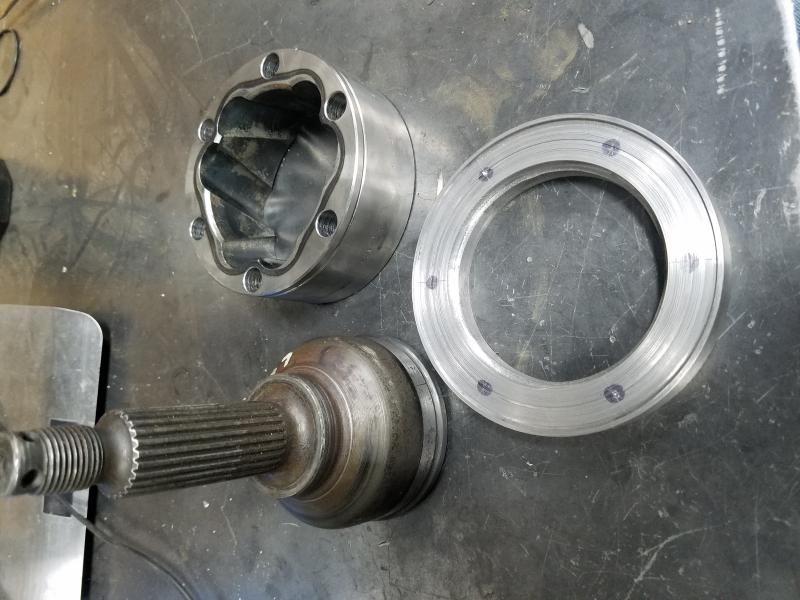

PostPosted: Mon Jan 21, 2019 8:03 pm

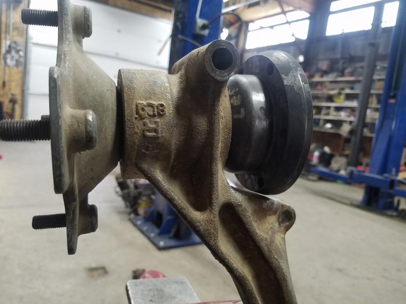

Here is where I am at. I built the first proof of concept adapter ring. The ID is .003" smaller than the OD of the outboard pilot joint. The plan is to heat the ring and press fit it over the pilot CV and weld as needed. I think with minimal clearancing I can get it to clear the pilot knuckle.
Again I'm mo machinist so it's not the smoothest work ever but for my first project I don't think it's too bad. If you do not think this will work, please let me know and tell me how you would have done it. I'm open to suggestions.
Once I have the adapter figured out and proven to bolt up to a pilot knuckle I will begin the teardown of my pilot to install the gearbox. I'm really not in a huge hurry to finish this project since I cant seem to kill a pilot gearbox even if I sorta try!

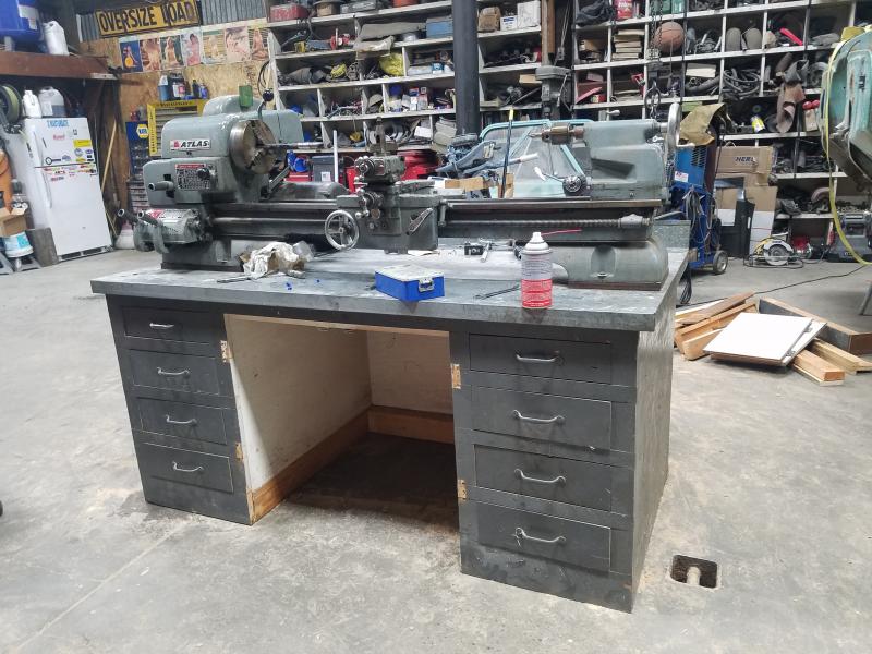

Nice gearbox and lathe. Congrats.
My first lathe was the same as that one but I had the Southbend.
You can build a lot of stuff with that. Get the old guy neighbour over as often as you can to learn. The old guy will have lots of knowledge and we don't know how long he will be around. You probably make his day every time you ask him to come over. Old people are very very lonely and don't get many visitors or are asked for advice, even though they have lots of it. I make it a point to go to my parents place every day. They are in they're mid 80's now.

PostPosted: Mon Jan 21, 2019 8:16 pm
Yes sir I think that's the way to go.
With .003" interference fit you should be able to freeze one part and heat the adapter ring in a toaster oven. It should fit on by hand. One thing to remember is that when ever you do a shrink fit, you only have one shot at it, so make sure EVERYTHING is ready to go. You need a plan and a back up plan. Also all of your tools need to be layed out and ready to go.
The rule of thumb is .001" to .003 is correct and .005" to .007" is extreme.

If I can offer a bit of advice, make sure you don't get the work too hot while machining it. It can throw off your interference fit. Ask me how I know..lol

PostPosted: Mon Jan 21, 2019 11:48 pm
canadian oddy wrote:
That is my plan, i will freeze the stub axle and get the ring red hot, and if all goes as planned it will slip right over. If not i will be cutting it back apart!

PostPosted: Mon Jan 21, 2019 11:54 pm
I am not sure if I like that whole plan.
That ring might warp if you get it cherry red hot. There is not enough meat on that ring. You can get it hot with a torch if you want but not cherry hot. Use a heat gun if you have one.

 Post subject: Re: RPM Gearbox
PostPosted: Mon Jan 21, 2019 11:58 pm
Yes good call, the old timer wants to bury it in the coals of the fire. a toaster oven sounds much more controllable. I have one i use for powder coating small parts already, so i may just use that.
PostPosted: Tue Jan 22, 2019 12:10 am
If I remember my millwright school stuff, the expansion rate of steel is decimal-five zeros-seven (.000007)
So that means you take .003 and divide by .000007 equals temperature.
It looks like you need 500'F to get there. You want a bit more to make sure it goes first try because it will cool rapidly because it is so small and because you need a few seconds to get the part home.
Edit: that is assuming you got an accurate .003
PostPosted: Tue Jan 22, 2019 12:22 am
When you put it on it should go all the way smooth and do it fast. If it even "tries" to stick -- pull it off fast.
If you do screw it up all is not lost. If the torch was handy and ready like I suggested earlier then you can spark it up and tap the ring off "gently" so you don't deform it. Two guys with hammer taps opposites will do it. Don't go wild and deform it.
Set up, speed and temperature is the key here.

I finally got a chance to get one adapter ring fitted onto a pilot stub shaft. Left the stub in the freezer overnight and once I had a hot fire going in the shop I put the ring in there for about 10 minutes and it fell right together. Once I knocked the casting mark off of the hub I had clearance to tighten the axle nut and let everything spin freely. I may give it a little more clearance later on, but um happy with the way it turned out so far.
The gearbox is mounted in the frame and I'm currently waiting on a driven clutch before I make my motor (( Internal Combustion Engine ? )) mounts. I was going to try and find a random sled clutch to use, but after not finding what I wanted I broke down and purchased a new Team Industries tss-04. This will give me almost infinite tuning possibilities and is probably the piece I'm the most excited for. The stock pilot driven was never quite right with the 670 IMO.

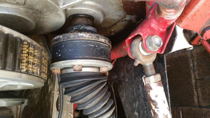

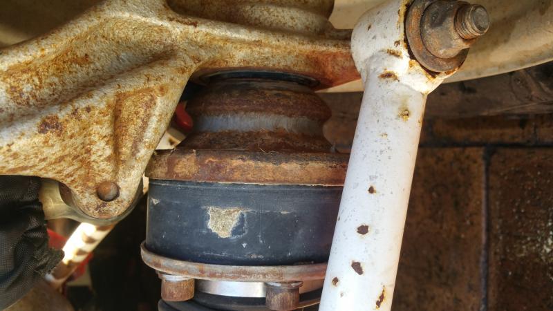

PostPosted: Sat Mar 16, 2019 2:30 am

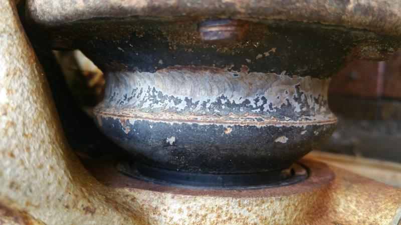

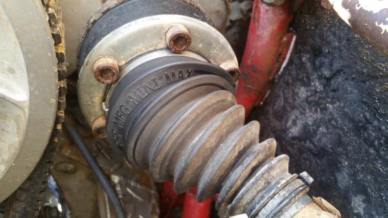

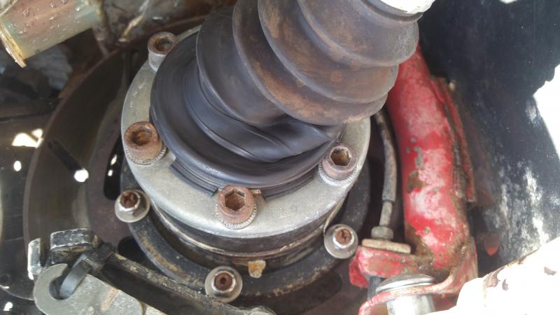

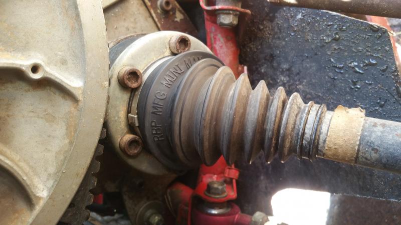

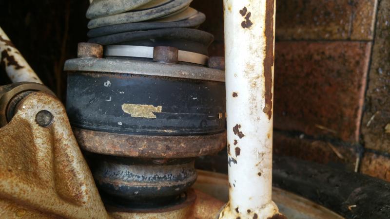

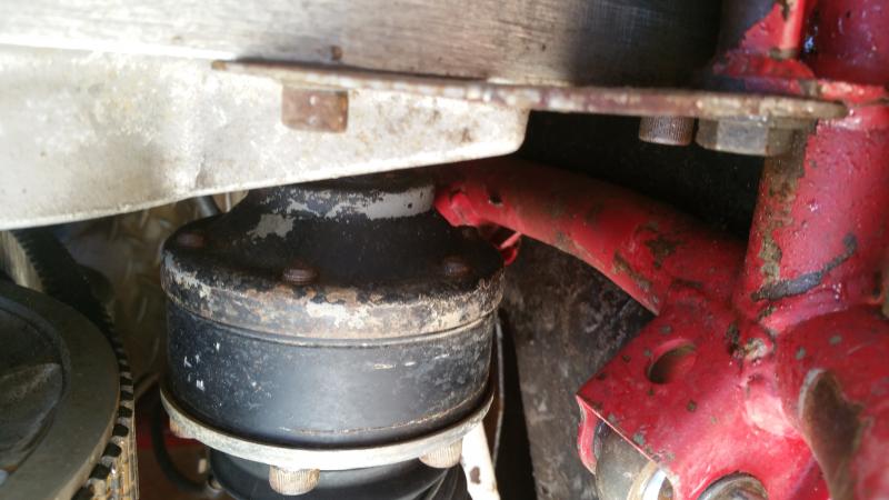

Sorry for being so late Matty.Just took these pics now Sat arvo 2:22pm nice and sunny around 30c.
Let me know if need any other angle pics.
You'll notice these have the PBR mimimax boots flange setup.
This way you can get to the bolts plus I use the 2 part Nordlock washers after constantly tightening the std spring washers don't work.

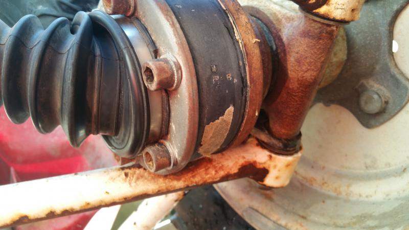

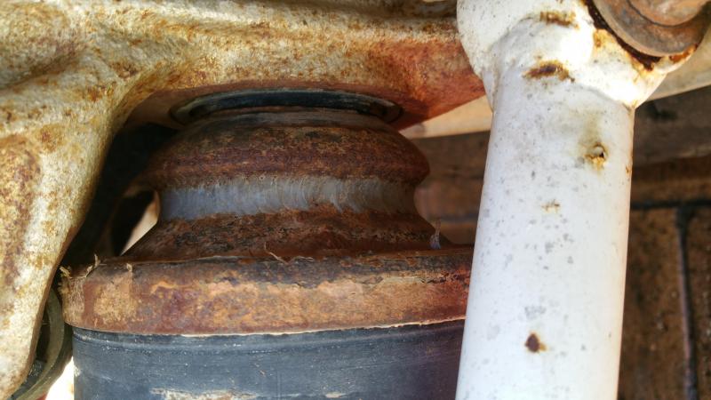

PostPosted: Sat Mar 16, 2019 2:34 am
More pics
