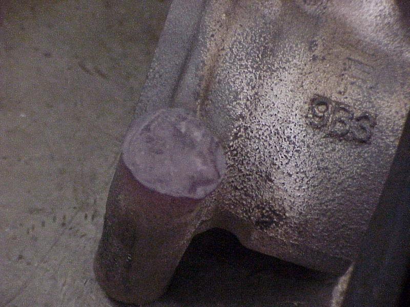

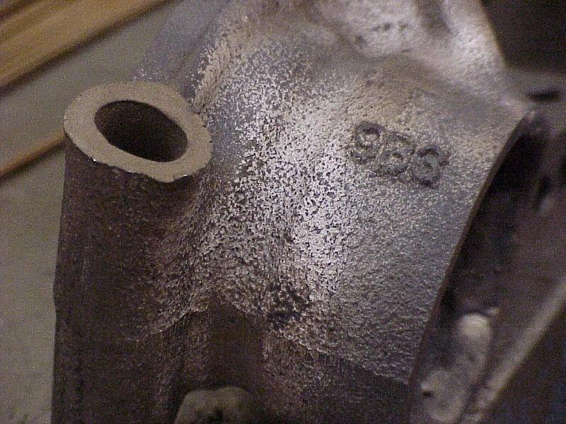

Hello All

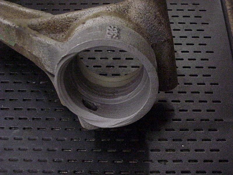

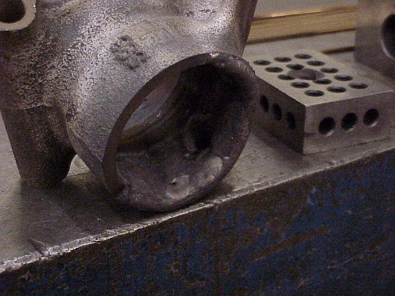

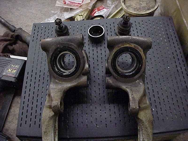

Well this project will be about rebuilding the rear bearing housing or Knuckle
Step 1 we will start by looking at the bearing area and how bad it is

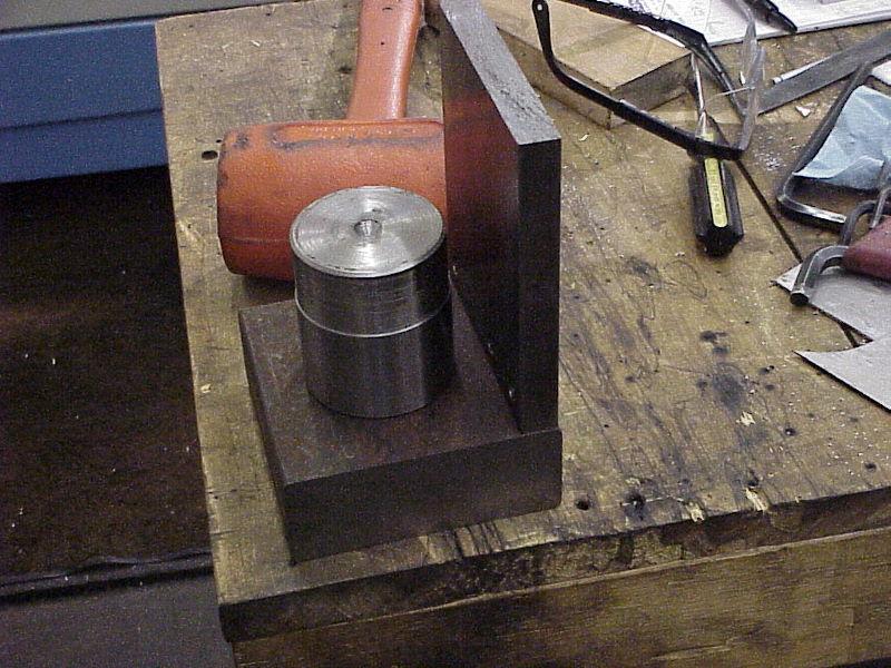

Step 2 will be making a maching fixture to recut the bearing area
Step 3 will go through the welding process on the Knuckle
Step 4 will go through the machining process and assembly
Thanks for Looking
SpeedChaser :-)
File comment: slip gage to show ware right arm
File comment: side view right arm
File comment: right arm
File comment: center post for fixture
File comment: bottom plate and side support

next finishing up fixture
the fixture will gage off one side of bearing
so we can recut one side at a time

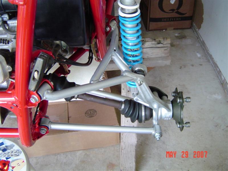

PostPosted: Thu Jul 10, 2008 8:42 pm

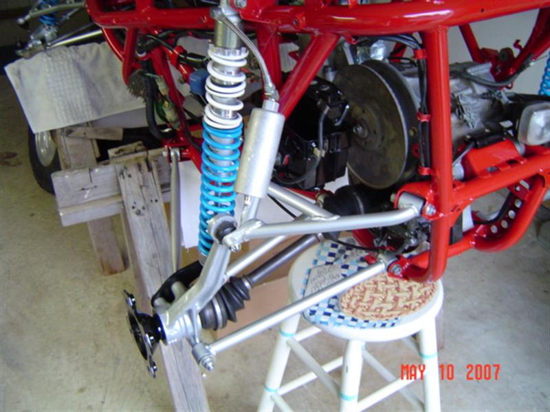

Speed-on the outer edge of each carreir the hub slides onto the axle and into the seal, you do not need the dimensions on the axle, hub, etc for anything correct, the seal itself should be enough since the hub itself slides into it correct?Heres a view of what I am speaking of from the rear of my PROJECT PILOT.I have a spare hub I can send over to you for fitment if needed.

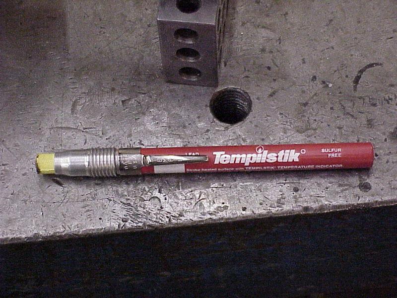

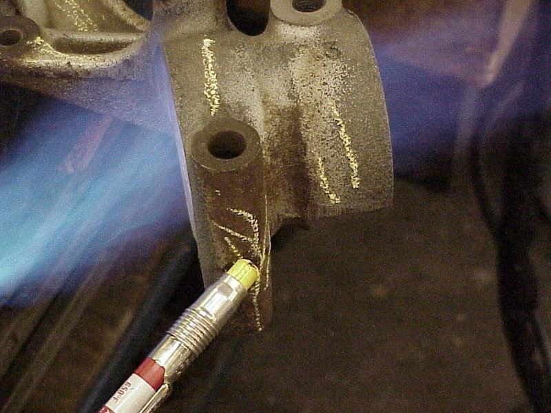

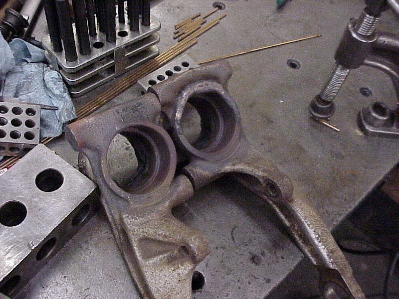

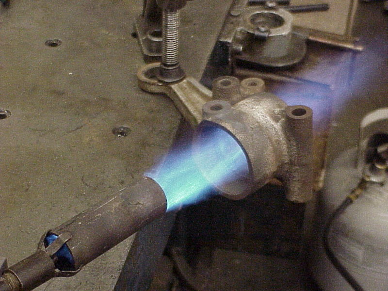

Had some time this last week end
clean up pre heat and weld
File comment: blast up area to be welded

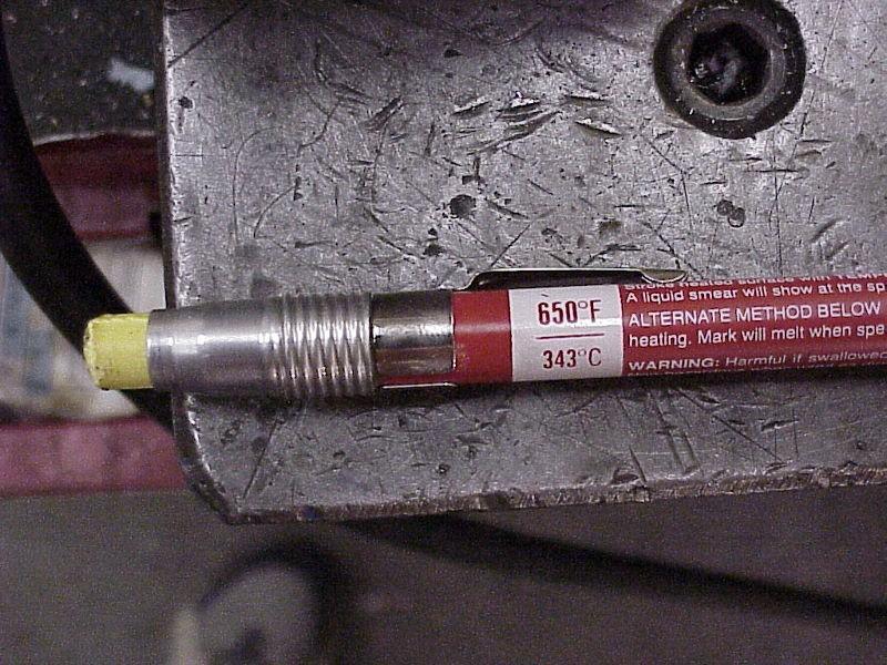

File comment: temp stick it melts at the temp stated
File comment: For this application I use 650 deg. temp stick
PostPosted: Mon Jul 14, 2008 10:17 pm
Posts: 1040
Location: hole above ground

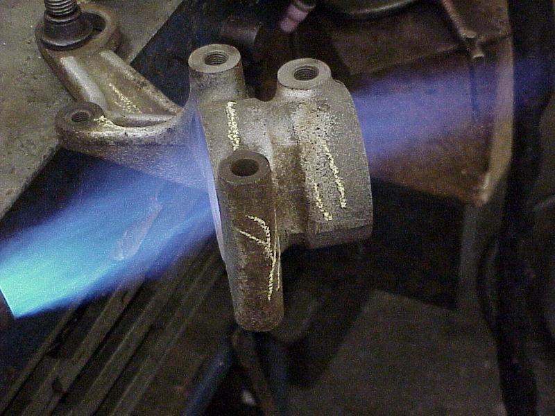

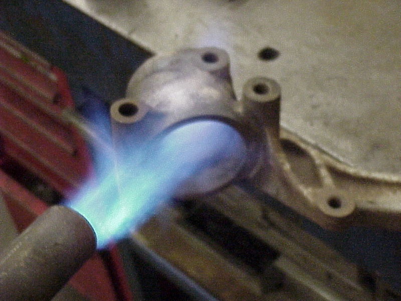

Time to get thing hot hot
File comment: You can draw with the temp stick like a crayon it will melt when hot

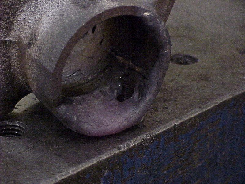

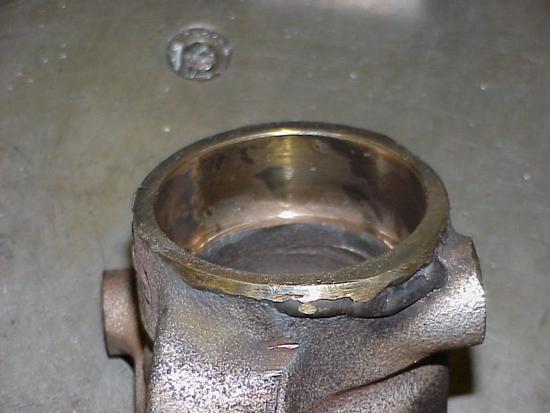

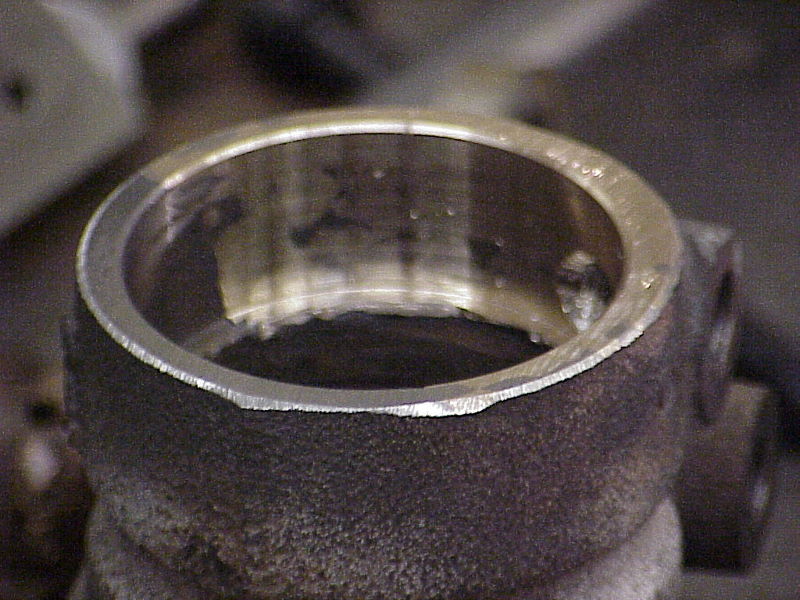

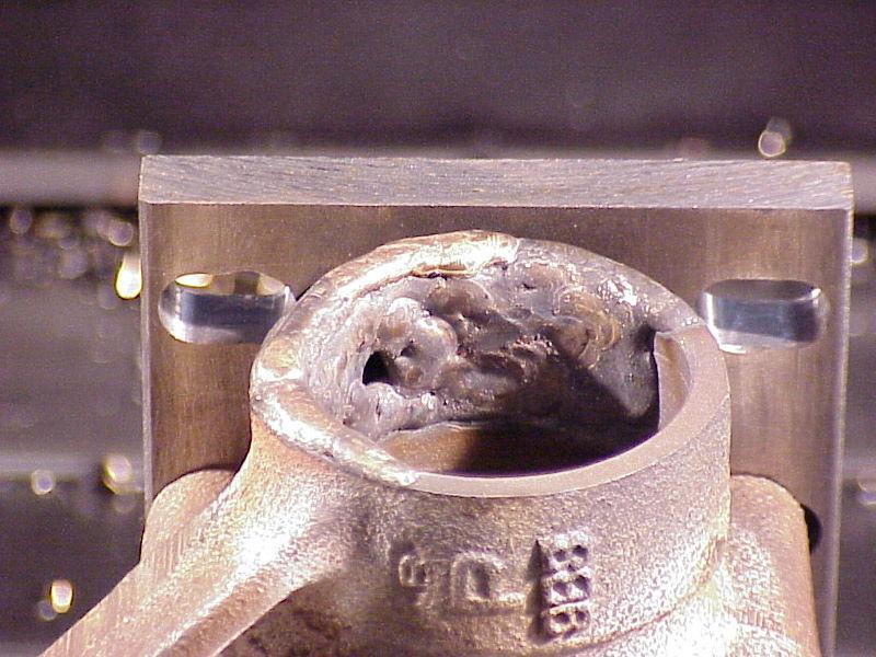

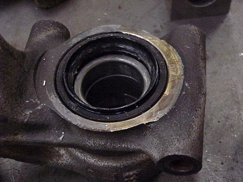

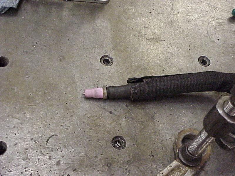

Well time to weld for this application
I am using silicon bronze filler rod for the build up of the bearing area.
It will mix with the cast steel housing and should not cause hard spots in the casting
File comment: 180 deg tig tourch
PostPosted: Mon Jul 14, 2008 10:38 pm
Posts: 1040

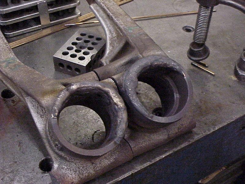

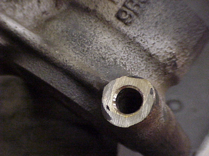

fixing the sloted bolt hole
File comment: hole all gone now
File comment: all welded up let them cool down slow
File comment: next
time to machine

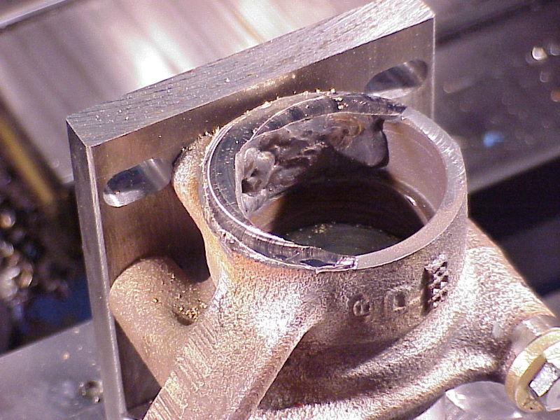

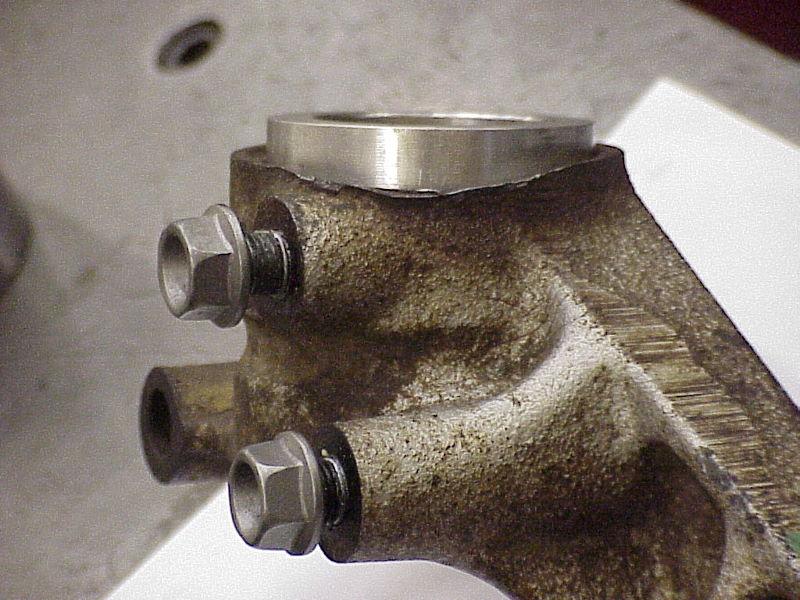

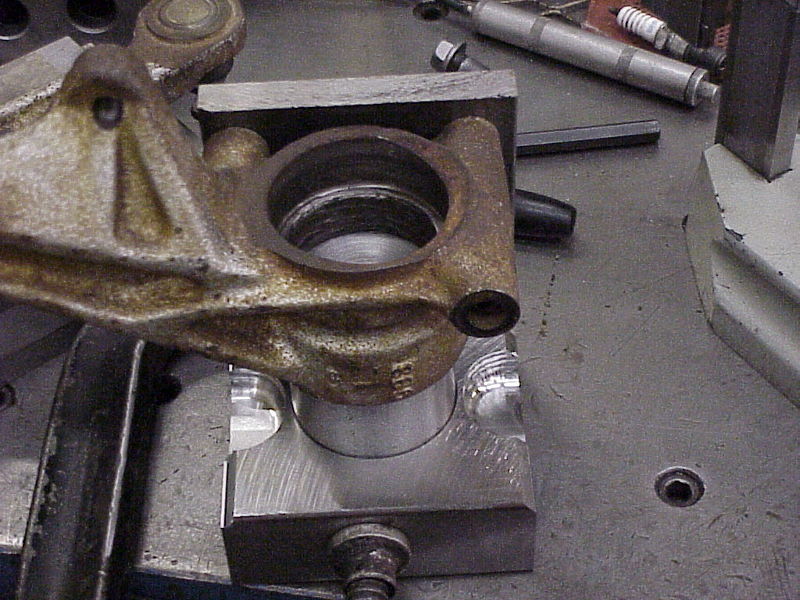

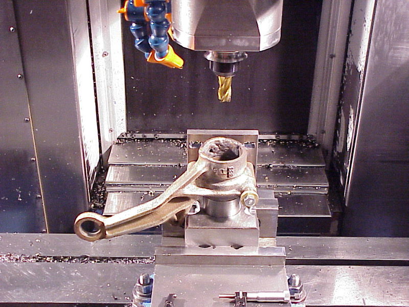

Hello maching pic's
File comment: hole redrilled from other side

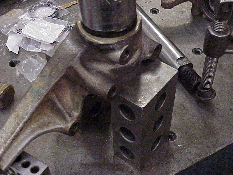

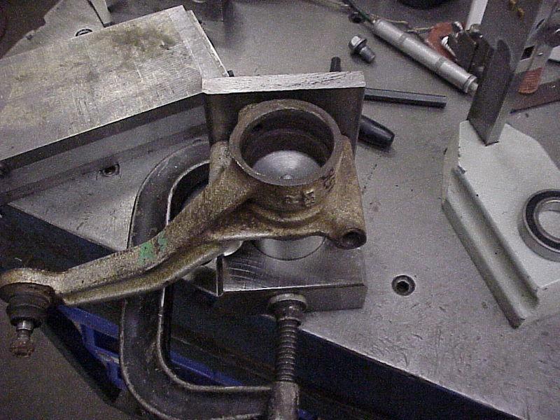

File comment: knuckel in fixture geting ready to be machined
File comment: close up

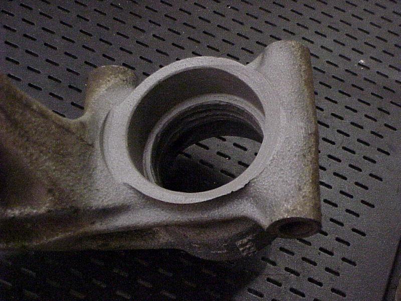

File comment: top surface cleaned up

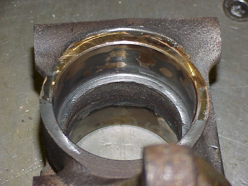

File comment: first cut on bore

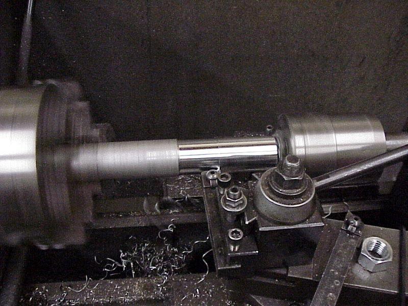

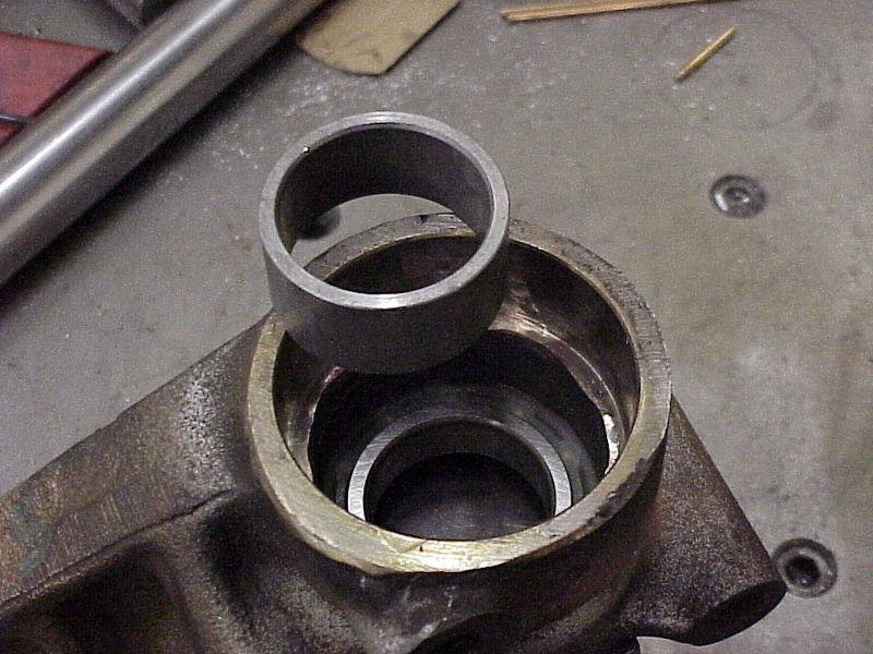

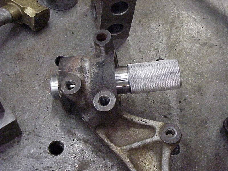

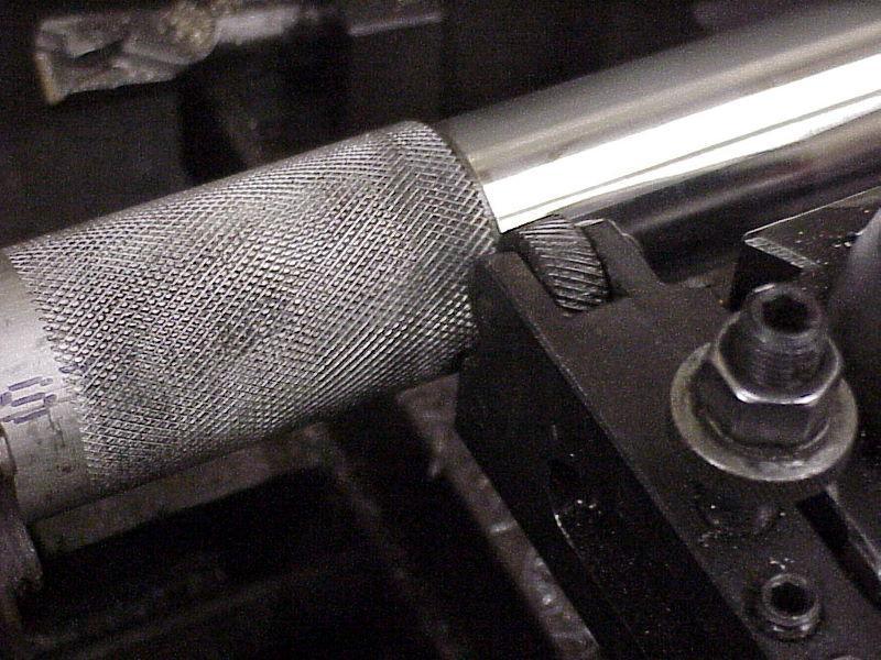

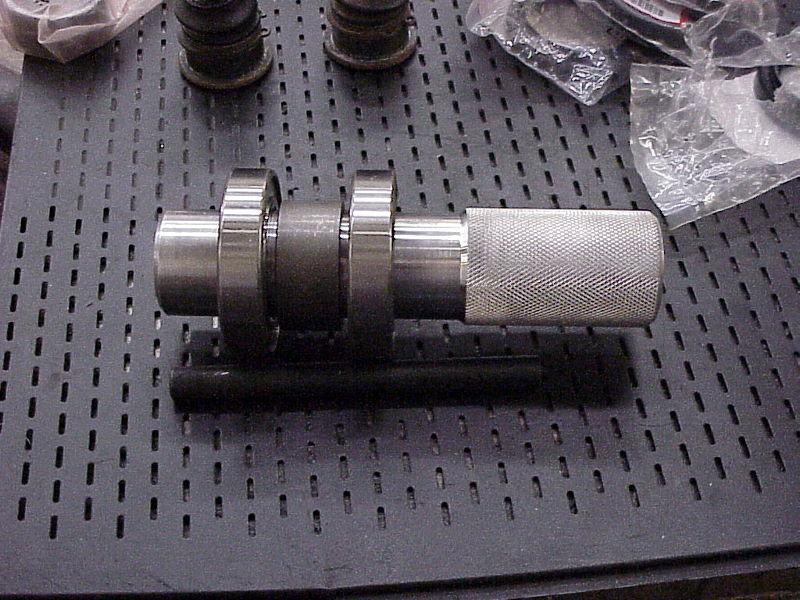

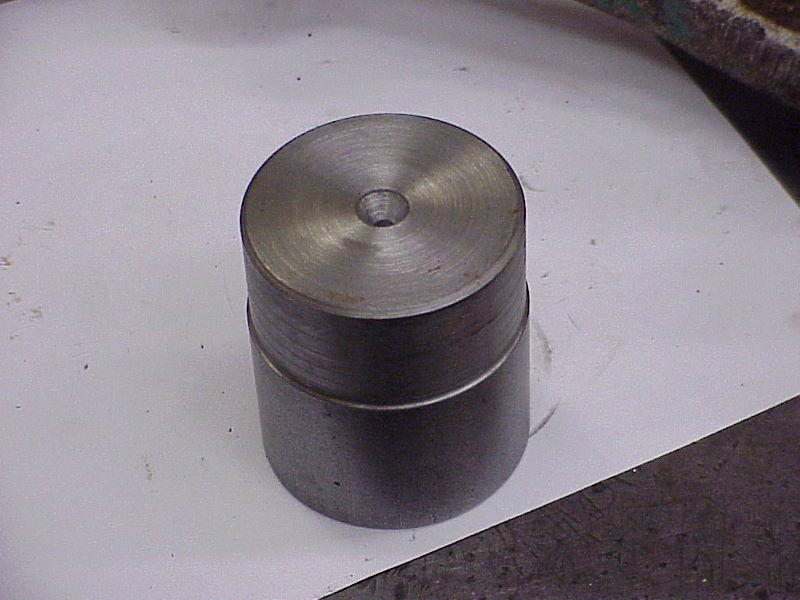

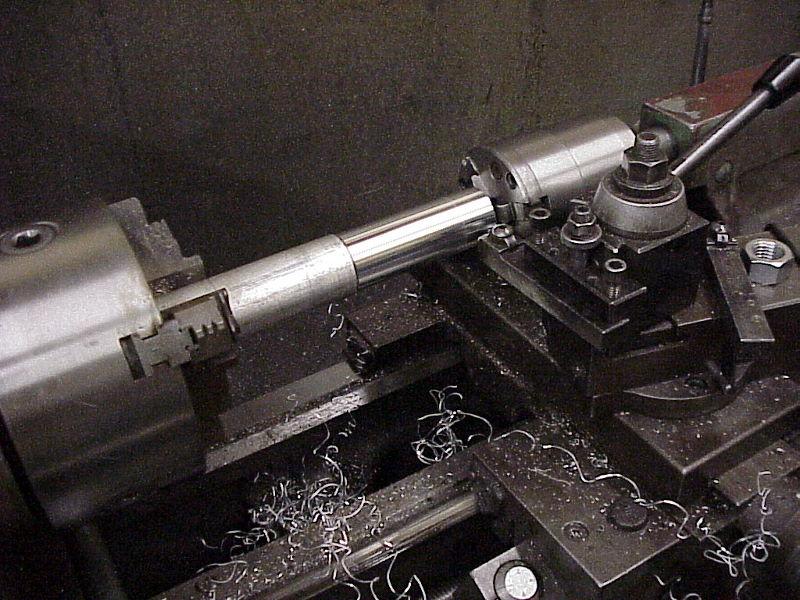

bearing alignment tool
File comment: time to make a bearing alignment tool
File comment: cutting tool on lathe
File comment: finsh cutt
File comment: Knurl the handel
File comment: finshed with bearing tool
the tool is a slide fit to the bearing

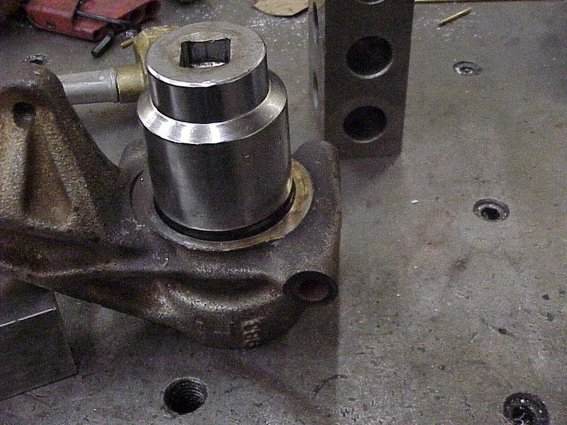

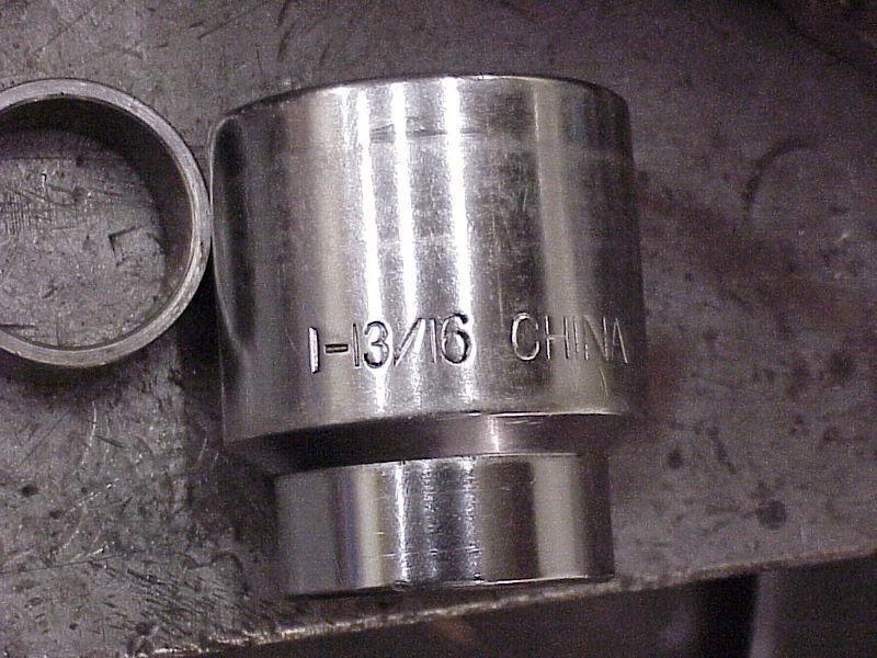

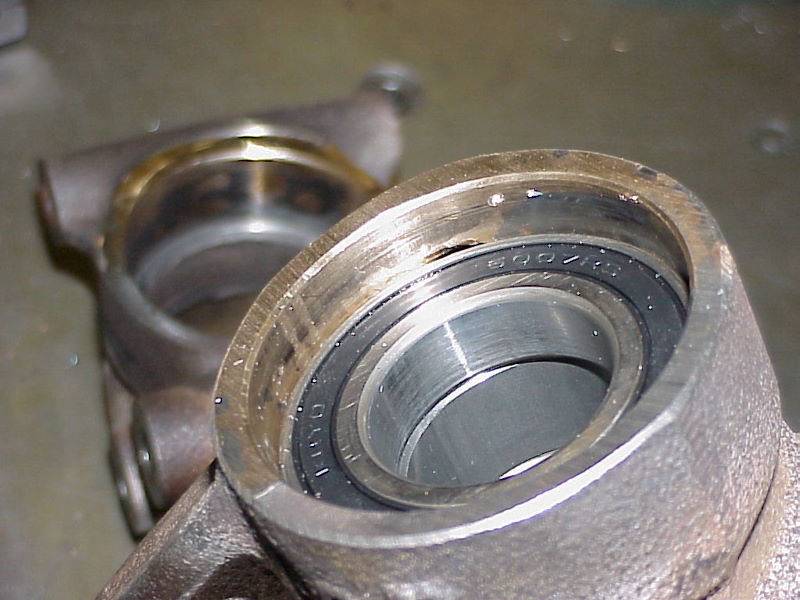

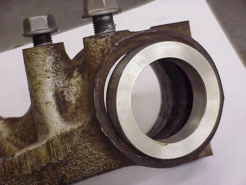

assembly of bearing and seals
File comment: tap fit on the bearing

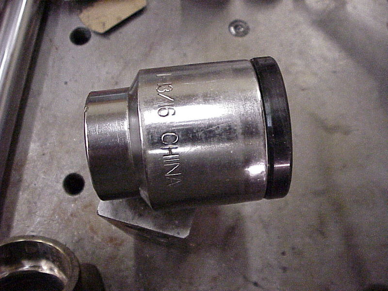

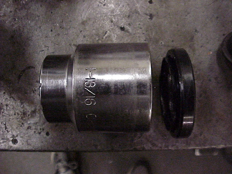

File comment: found the bearing driver and seal driver 1-13/16 socket
File comment: fits the seal nice
File comment: next
File comment: tap one side bearing in to the bottom
File comment: don't forget the spacer

next
File comment: Checking ailment
File comment: installing seals
File comment: next
File comment: other side

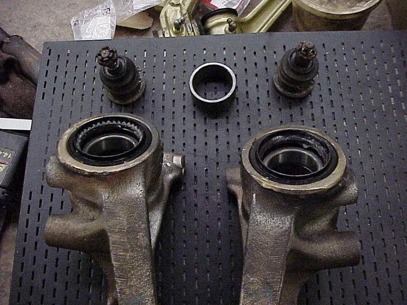

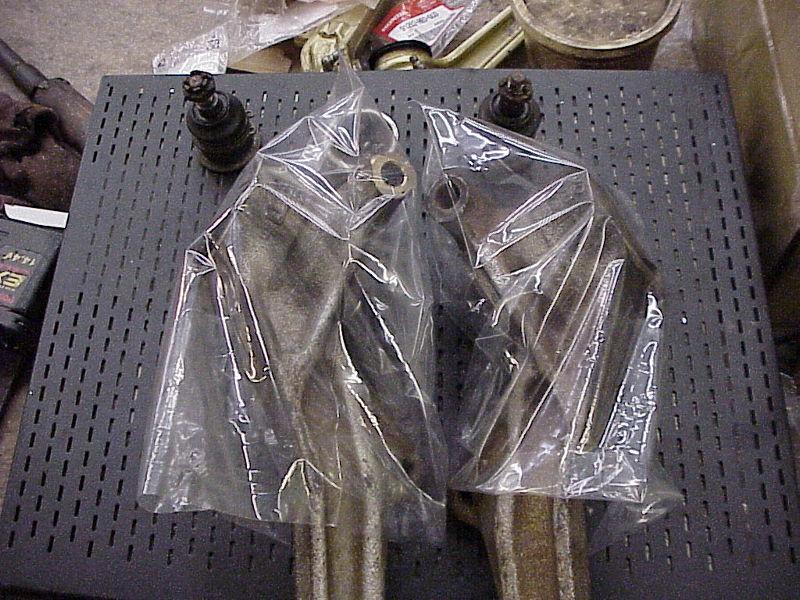

all done and Ready to ship
File comment: all bag up
