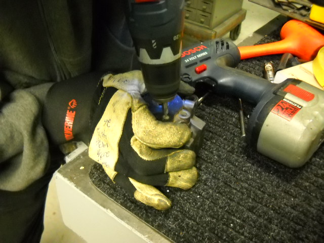

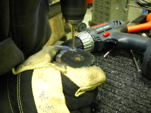

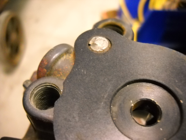

davidafco sent me a rear caliper to rework

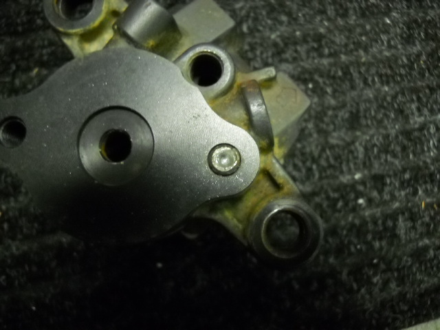

that bolt was buried in that hole
speed
File comment: broken bolt
File comment: trying to center drill center

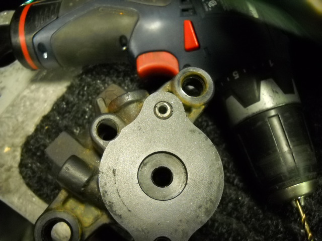

File comment: got it close
File comment: time to drill for ez-out
like my new scratch pad :)

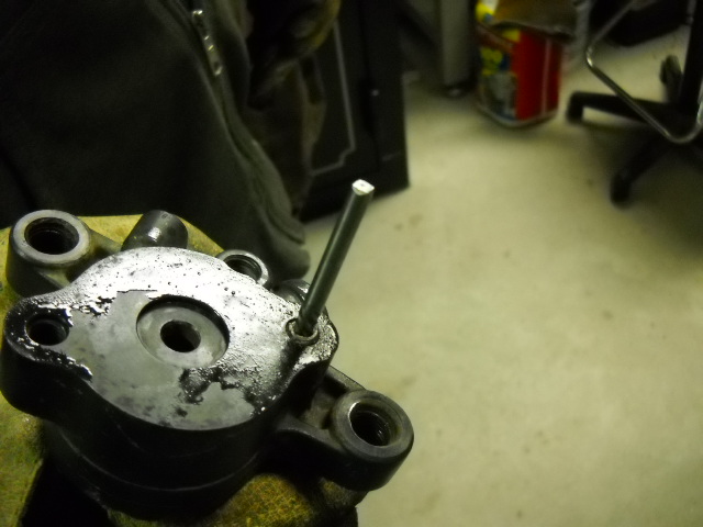

File comment: one hole thru the bolt

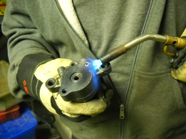

File comment: I tried heating also but that darn thing was in there
File comment: even snapped the top of the ez out off

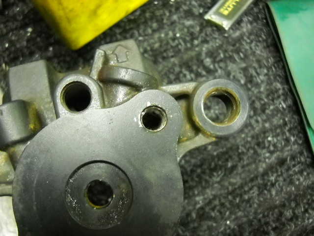

File comment: ended up grinding it out with a carbide bur
File comment: got it thin enough where i could pull the threads out with pliers
File comment: after that ran a tap down the hole and looks like new :)

I really thank you Speed for getting that damn thing out. Now I can get busy making a spare good caliper. :-)
