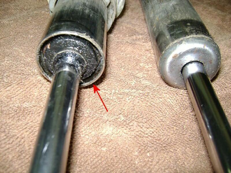

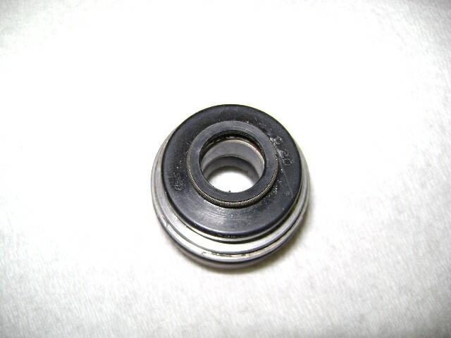

Here is the assembly that is below the dust cap, you remove the dust cap then a snap ring.
First pic is the outer most seal I assume it cleans the shaft to protect the other seal?
Writing on the top outer seal is C 20

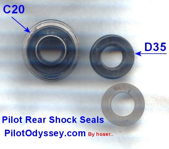

PostPosted: Thu May 31, 2007 2:25 pm
Ok I design and fabricated a tool to remove the old seal without damaging it.
The numbers on the seals are next to the seals in the picture.
The dimensions are as follows
For seal D35 the hole or recess the seal presses into measures .945
the seal is about .200 thick, its soft rubber so 'about'
the ID I didnt measure we know what size shaft it fits over.
For seal C20 the part it presses on to is .985 the seal is about .200 thick.
The O ring groove in the body of the seal holder is .185 wide the bottom of the groove or the part the O ring goes around is 1.160 OD
Sick em Stoneman

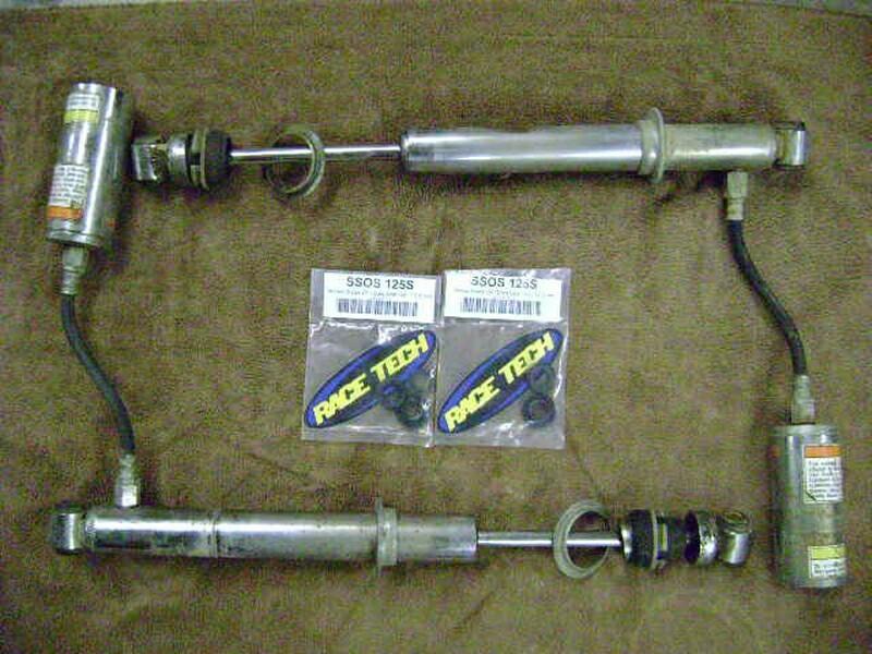

PostPosted: Tue Sep 11, 2007 9:01 pm
Ok Stoneman sent me the seal kits

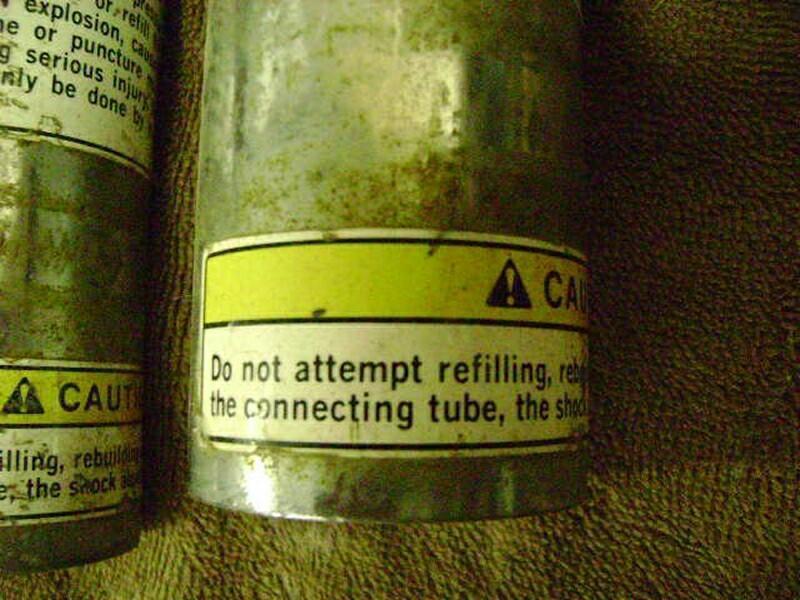

PostPosted: Tue Sep 11, 2007 9:02 pm
Their warning sticker lol

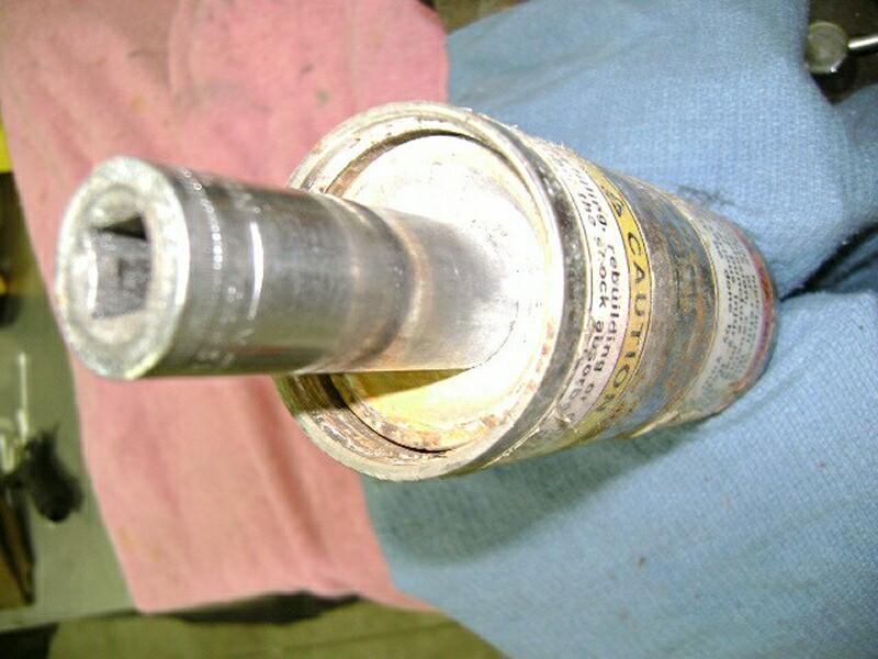

Once the pressure is out put the can in a vice to support it then I take a deep socket and a small hammer to tap the bladder down to expose the snap ring that retains the bladder when under pressure .

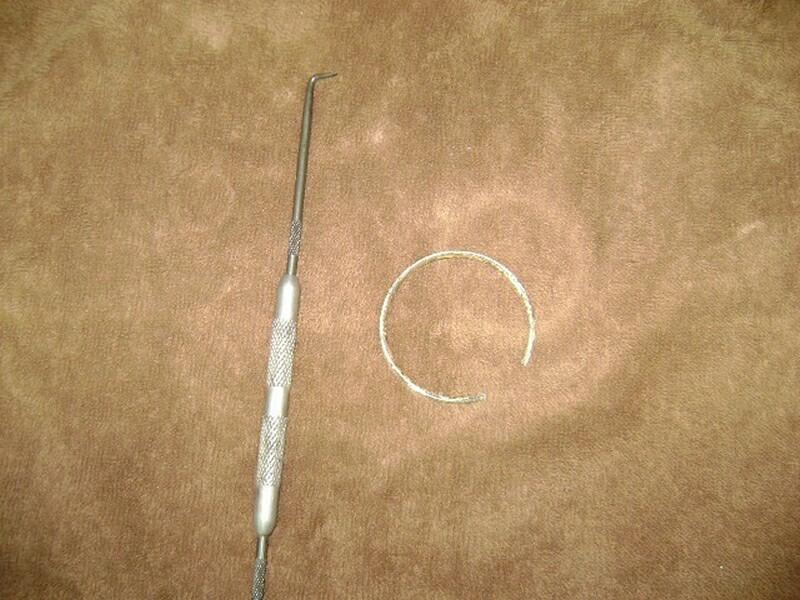

PostPosted: Tue Sep 11, 2007 9:04 pm
I use a pick to get the ring out.

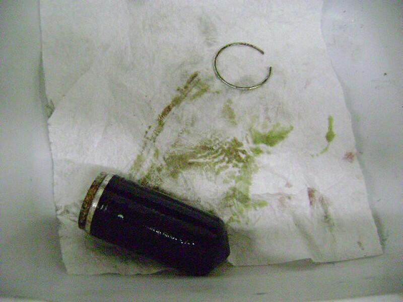

PostPosted: Tue Sep 11, 2007 9:06 pm
Once the ring is out its time to remove the bladder I just screw the cap back on then gently grasp with a pliers and pull it out, you need to have control here squeeze too hard you damage the vale stem and turn the shock into junk, you can buy a valve stem installing tool for car tires to screw on and pull if your worried about damaging.

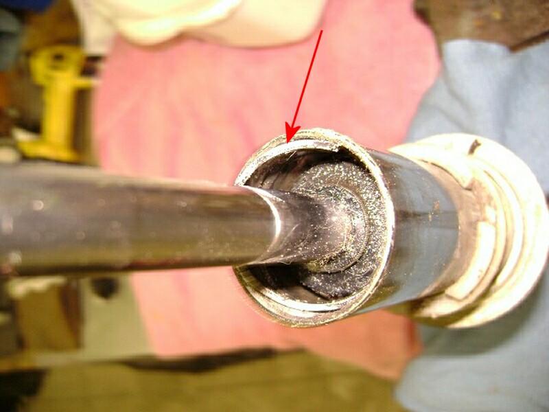

PostPosted: Tue Sep 11, 2007 9:09 pm

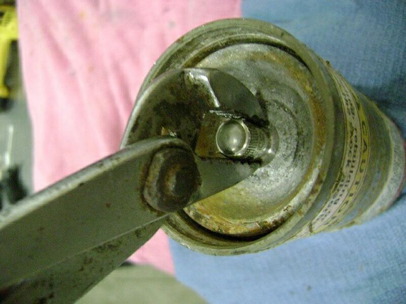

Carefully take something soft and tap the seal down to expose the retainer ring.
Use the pick again to remove the ring.

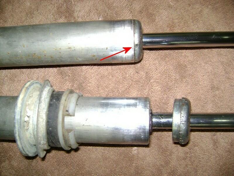

PostPosted: Tue Sep 11, 2007 9:10 pm

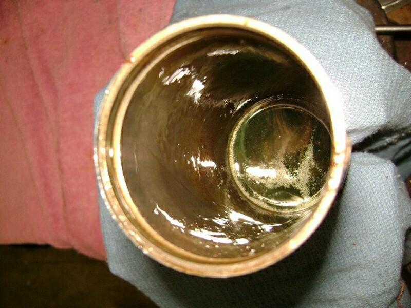

You can then remove the guts of the shock, watch out for OIL

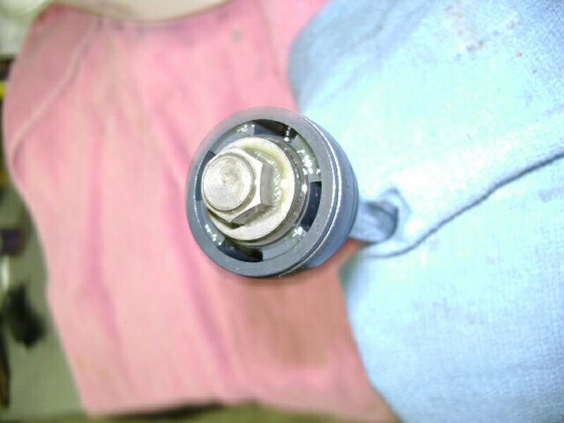

Next we need to remove the valve stack so we can remove the old seals.

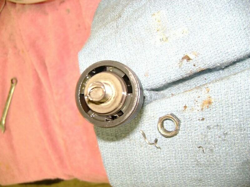

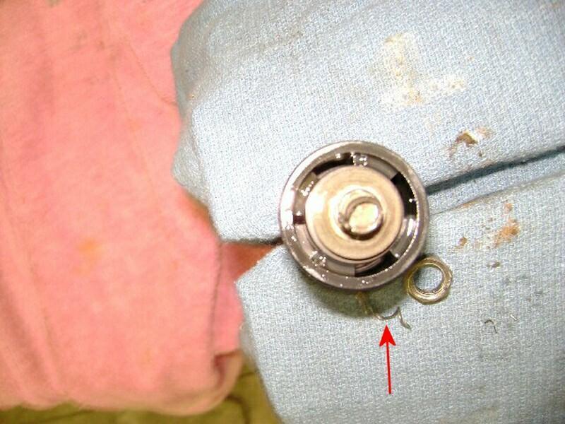

PostPosted: Tue Sep 11, 2007 9:12 pm
As you remove the nut you will notice at the factory they use what looks like lead to lock the nut onto the shaft, it will peel off as you remove the nut.
PostPosted: Tue Sep 11, 2007 9:16 pm
Before you remove the valve stack have wire ready so you can maintain the order of all the shims you have to reassemble the way it came apart if you want it to work.

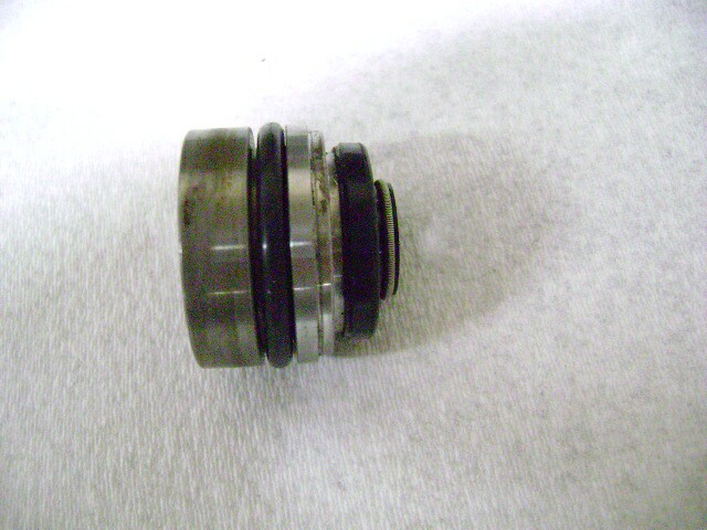

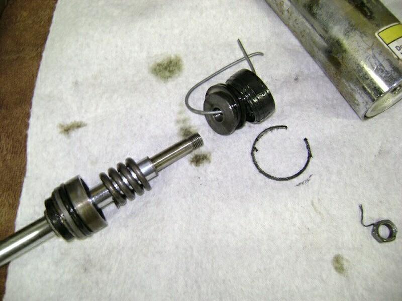

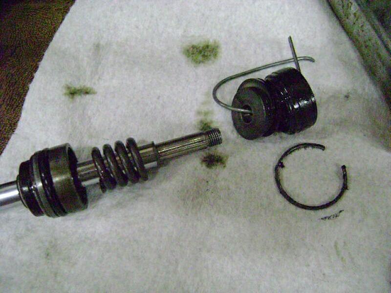

Next slide the seal assembly off the end of the shock shaft.

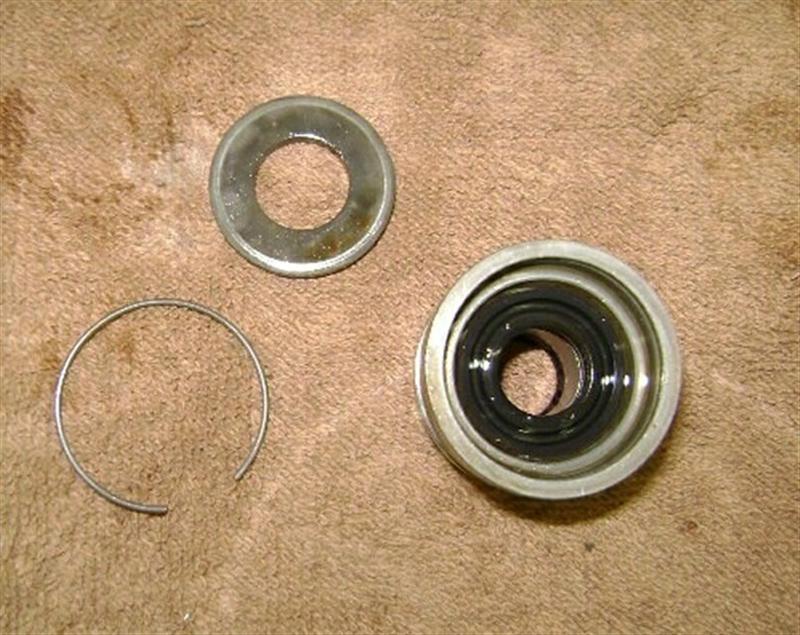

Now you remove the old seals, remove the snap ring and metal washer

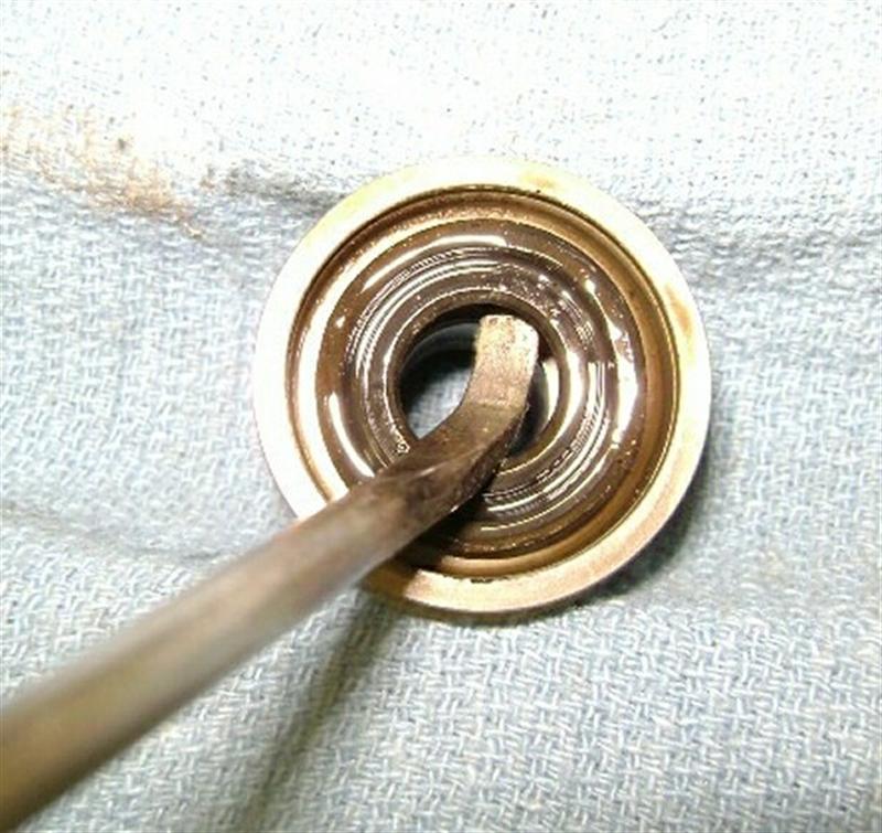

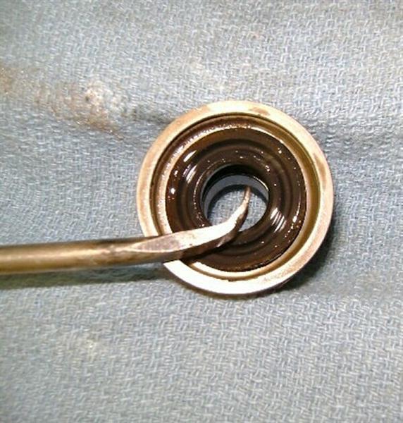

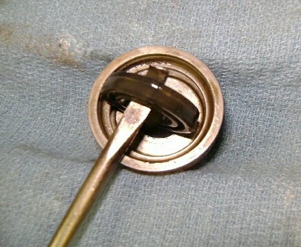

PostPosted: Wed Sep 12, 2007 5:00 pm
Using a hoserized screwdriver I pried out the old seal
