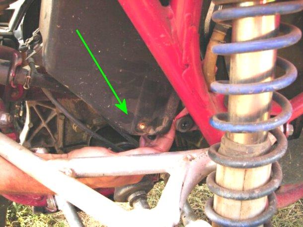

Here are some tips on adjusting the air screw on a stock Pilot,
remove the lower bolt that holds the air box in place and GENTLY
pull it back so you can access.

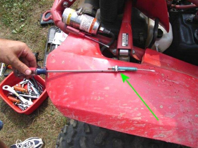

Then you need a LONG small tip screwdriver we didnt have one so made one out
of two screwdrivers (hoser-rig) and a small hose clamp.
