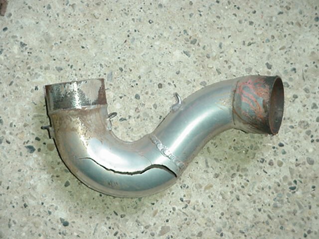

Looking for where to get HI-REV Head pipe only for Pilot.
I was out in the dunes when my Engine suddenly got louder...And louder. So I stopped to discover that the head pipe had split. Trying to find the best place to get a replacement. I might try welding it but its aweful thin. Whats worst is why did it split? I was running a little hot but that should not have done this? Thanx Bill

That is a fatigue failure you don't have the pipe mounted correctly, either the mounts are bound up not letting the vibration dissipate properly or you have it in a bind.
How are the Engine trans rubber mounts?
I could type the below all out and repost the pictures but that would defeat the purpose of building a data base on my web site all these years so excuse me if I just cut and paste and give you the links.
Tips on pipes can be found here viewtopic.php?f=109&t=13671 and here http://pilotodyssey.com/newpipe4.htm read them carefully their is alot of details their that are easily over looked, tips on sealing http://pilotodyssey.com/siliconesealer.htm
That pipe looks like a Power pro's http://www.thepowerpros.com pipe you might contact them and see if you can just buy a replacement head pipe.
If all else fails you can weld it up but you first need to remove 100% of the carbon inside the pipe if you don't the carbon will be pulled into the weld and weaken it you also would need to remove the layer of coating outside the pipe.
If I was making the repair I would weld it up and grind or sand the weld down then take a piece of steel about the same thickness of the pipe and weld a patch over the repaired area to add strength. Might not look pretty but you never see it once installed....

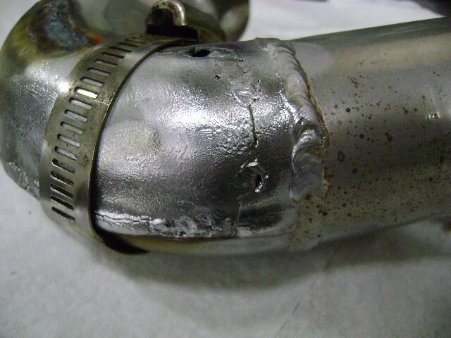

PostPosted: Sat Aug 25, 2007 5:39 pm

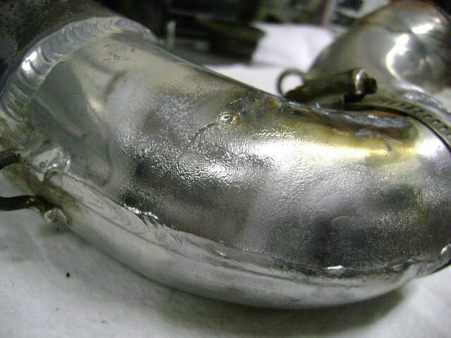

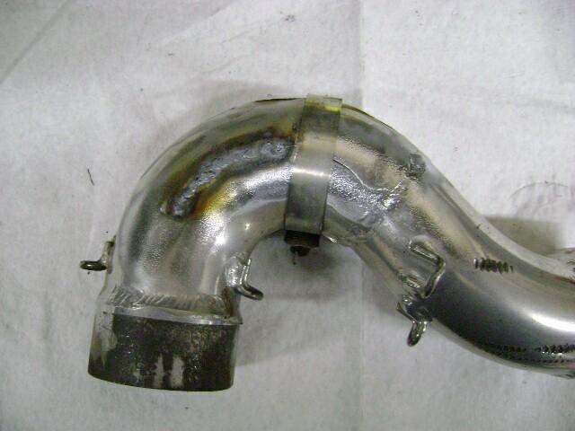

I recieved your package today and started working on the head pipe.
See the crack on the weld ?
That weld is actually braze.
Looks like you sealed with silicone then turned over or started the Engine before the silicone had a chance to fully cure and it blew it out?

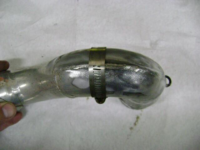

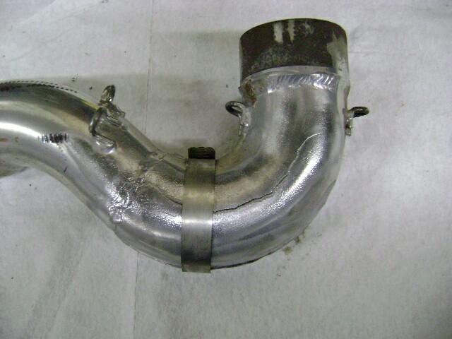

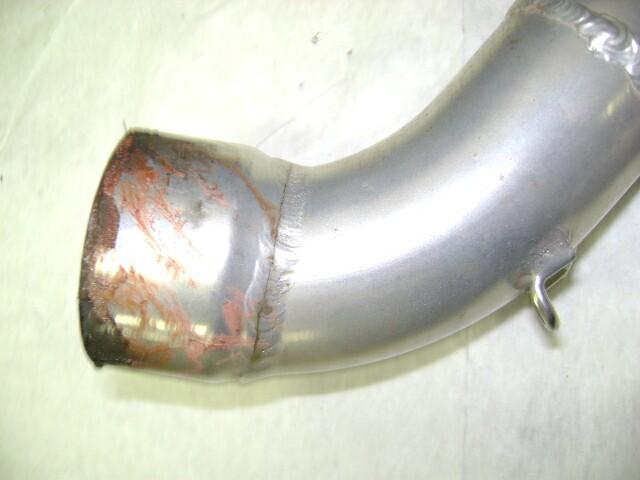

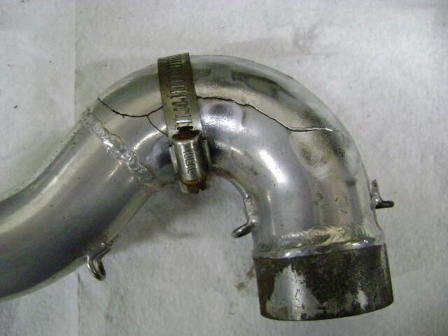

PostPosted: Sat Aug 25, 2007 5:41 pm
Hose clamp moved the metal back into place,

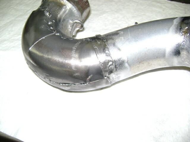

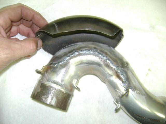

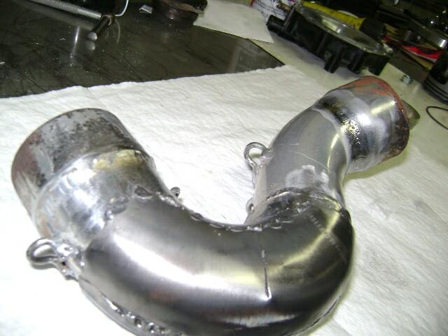

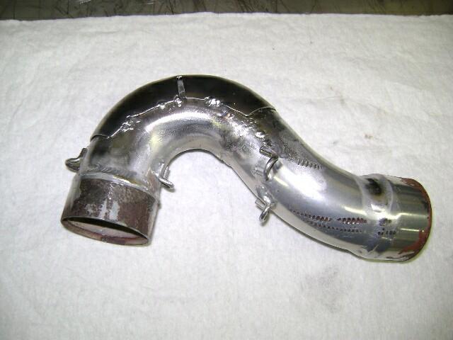

PostPosted: Sat Aug 25, 2007 5:43 pm
Once all the cracks were welded up I found a old head pipe that is slightly larger I will cut up to cover the outside to reinforce the metal.

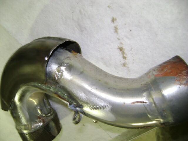

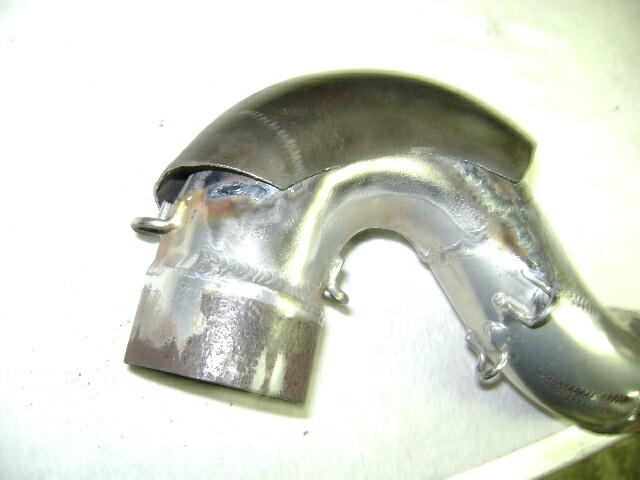

PostPosted: Sat Aug 25, 2007 5:45 pm
I had to slice it up into 2 pieces and then add 2 relief cuts to make it fit better.

I shipped your pipe today, I have more pics I took but the camera is in the shop I will post later, its not pretty but it should work, that coating is a bitch to weld around lol, next time I will sand blast it all off.

Not pretty, that coating if not 100% remove makes the weld fester up, you can wash most of it out with the weld puddle but the metal is so thin you don't have much wash time before its a hole :shock: Lucky for us its behind the seat hehe, give it a coat of high temp paint so it wont rust.
