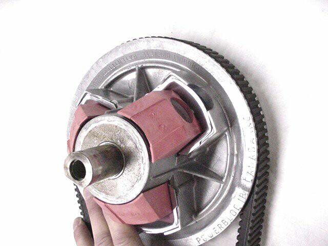

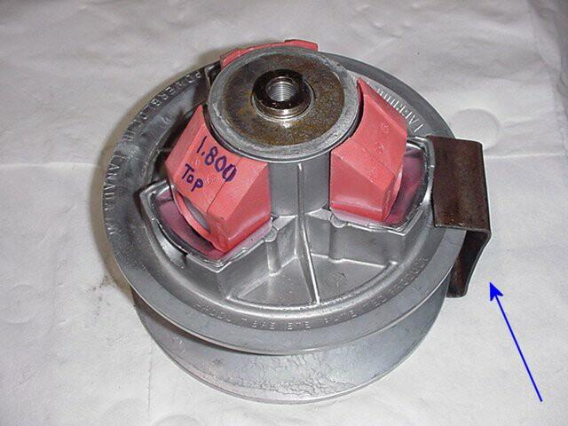

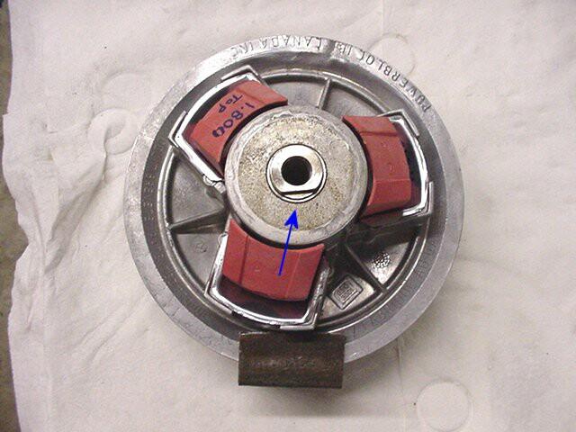

My new Power Bloc clutches came in, came without installation instructions, 2 clutches
in seperate boxes 2 sets of missing instructions, whats up with that? Pretty sure I can
figure it out I have had Power Bloc clutches for going on 9 years now, I see some design
changes requiring special orientation of a few parts during assembly anybody else notice
this? I bet the installation instructions give you the info, Ludedude has had his for 6 weeks?
Kind of surprised he has not mention any of this yet, maybe he has and I didnt see it?

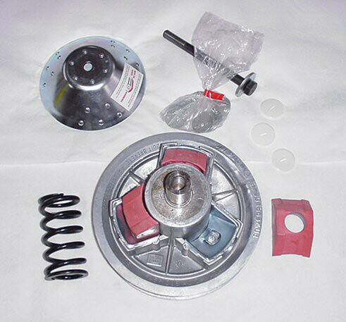

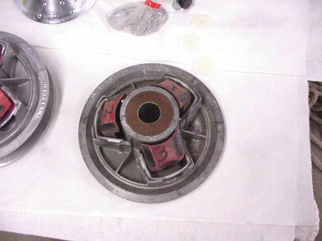

PostPosted: Mon Mar 29, 2004 5:08 pm
Weight bloc

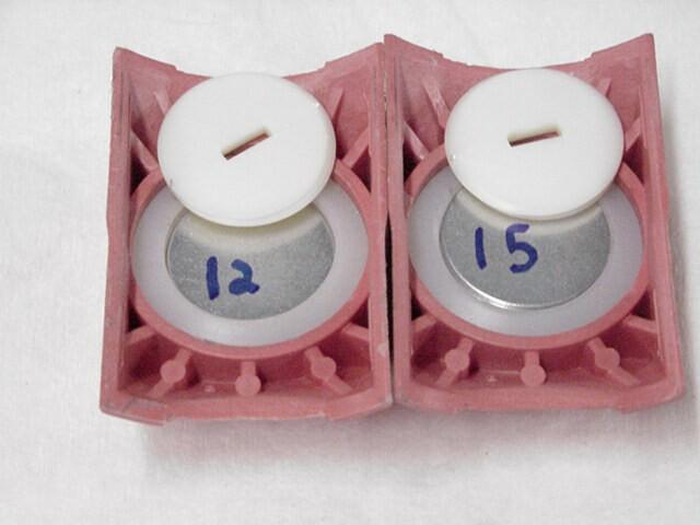

PostPosted: Mon Mar 29, 2004 5:11 pm
As MGR suggested I will number the blocks 1,2,3 and the clutch moveable face
1,2,3 so when ever I assemble the clutch the weight blocks will go back into the
same slot they were in when the clutch was 'broken in' or worn in so they will
always match and any clutch changes will not be affected by miss match weight
blocks and wear patterns

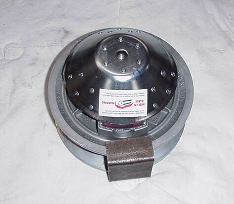

PostPosted: Mon Mar 29, 2004 5:29 pm
It has the correct belt width spacer?
I know MGR had a problem with his being the wrong width on his HRD clutch.

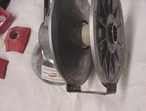

PostPosted: Mon Mar 29, 2004 5:30 pm
Looks about right .

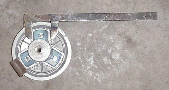

PostPosted: Mon Mar 29, 2004 7:25 pm
Here while your asking ask him why they send 15 washers and you be lucky to
get 12 washers in the holder and screw on the cap guess the 9 extra washers
are so if you loose some?
Seems to me in my old blocks I could get 14 washers in .
He has had his for 6 weeks I am sure he knows by now...

As I pointed out in the last pictures your only going to be able to install about 12 washers
into the weight blocks hopefully that will be enough I wont know until I am able to install
the clutch that wont happen until I get my Engine back together and installed, If I
were you I would install as many washers as you can into the weight blocks (same number
in each block ) and take it for a test ride, do you have a tach on your machine this will help

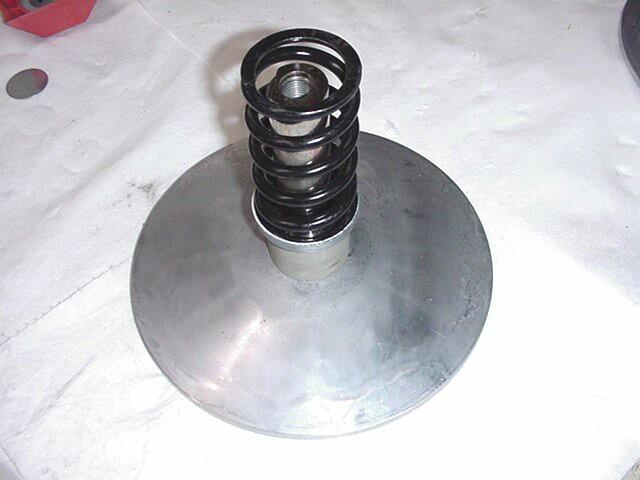

Before you spend a bunch of time on the new drive clutch look at the driven and inspect it,
a quick test is to use the clutch spreading bolt , screw it into the driven clutch and as you turn it
does the clutch separate easy or do you have a hard time screwing in the bolt to the point where
you have to excessive force to turn the wrench or are having a hard time holding the clutch as
you turn it? If so you need to take the clutch apart and make a few minor modifications to free it
up where it will work more easily.
If you havent yet go here and have a read http://pilotodyssey.com/pilotdriven1.htm
by cleaning up the rust inside the spring and by sanding down that white plastic
bushing to remove the scaring the rough rusted spring cut into the plastic you can
free up the movement of your driven clutch, don't, no need to replace the plastic
bushing unless it is broken or worn through, you want a worn out bushing here, being
almost worn out is a good thing here, once you get the clutch apart and start looking
at it and thinking about it you will see what I mean, think about spring wrap and the
way the cam rotation affects the tension on that plastic part you will be sanding down,
you also can apply a dry lube like dry slide or coment clutch lube on the outside of the
bushing.
If the driven is not working properly and moving freely on that bushing it will dramatically
affect your upshift.
File comment: Here is the parts you will be working on you probably don't want to hone the inside of the spring as I did just smooth it out, by reducing the spring tension you affect the spring tension and also the belt tension.

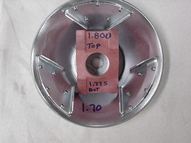

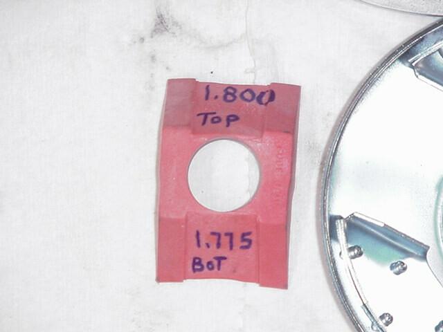

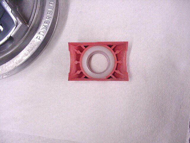

PostPosted: Tue Mar 30, 2004 1:43 pm

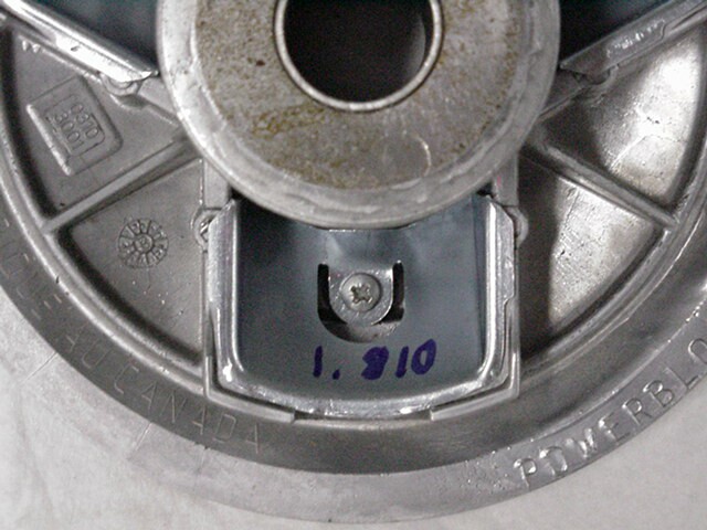

Here is something I discovered when I first open the box on this new clutch,
the blocks are a different width on each end, the older PB clutches were
not like this, the slots they fit into are also different widths, my measurements
are just general measurements and I will give them a tolerance of lets say + or
- .100 I say this because they are not a machined tight tolerance part they
mate to something that is stamped out, they have casting flash, flaws and rough
edges on them each one you measure is slightly different.
PostPosted: Tue Mar 30, 2004 1:45 pm
Here is the pocket it fits into.

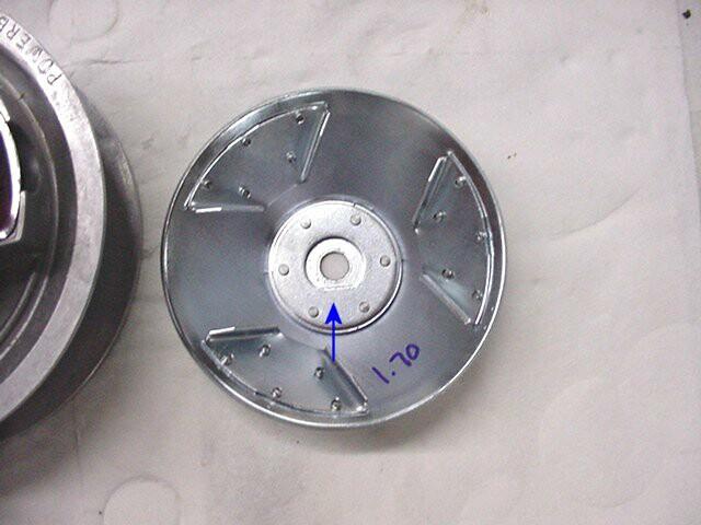

PostPosted: Tue Mar 30, 2004 1:49 pm
Here is the pocket on the cover.
1.70 on the cover was measured at the top edge of the stamped steel pieces
trying to measure at the bottom was almost imposable because of the location.
I will ASSume since I don't have the factory instructions that you will want to
match the block ends with the slot that it would fit into the best, I see no advantage
to having one end of the block fitting tight and the other end being real loose again
I have no manual and no idea why the design change.

You will want to assemble like so.
PostPosted: Tue Mar 30, 2004 2:14 pm
Using a home made clutch holding tool you want to compress the spring and
install holding tool and insert pucks.
See how the end of the shaft now sticks out?
PostPosted: Tue Mar 30, 2004 2:21 pm
The clutch shaft is keyed to the cover by using a D on the end of the shaft
and a D washer riveted to the inside of the cover, there have to match perfectly
when you install and tighten the cover, the 'feel' for it method works but still
is not 100% you must be 100% sure the key is aligned perfectly if not expect
problems and poofkaboom in the near future, this is the old design and I am
not sure why they shipped these clutches using the old design, I would have
requested the new style without the D washer setup, years ago it never had
the D washer then they went to it then found out it was a problem because
owners were not getting it together correctly and havening failures then they
stopped using it, on my first PB clutch that is now on my wifes Pilot I removed
the D washer by grinding the heads off the rivets and driving them out with
a small punch and got away from the D washer all together, I don't recall if
I used a wear washer (goes between the clutch cover and end of the shaft
on the non D washer clutches) or not when I removed the D washer. I will
find out and take pictures when I remove her clutch.

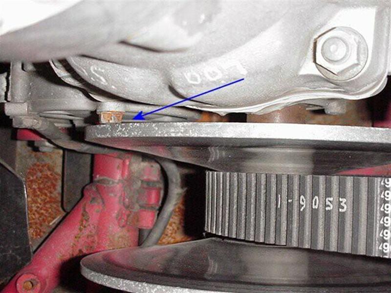

Cover on the holder tool makes it easier to put on the Pilot, now I can
carry it over as a assembly and install on the Pilot, I would put on the
end of the crank shaft and tighten the bolt thumb tight then remove the
holding tool then I would rotate the outer cover back and forth feeling to
make sure the D washer or D key was correct and seated properly as
I continue to snug and tighten the bolt, once you have it "snug" you need to
stop and rotate the clutch assembly to ensure you have clearance between
the back of the clutch and the bolts that stick out of the side covers on the
Pilots Engine, don't torque it up tight then discover it is hitting.
If it is hitting you need to remove the clutch and provide clearance by using a
file to remove part of the head of the bolts that it makes contact with and or
true up the back side of the clutch.

PostPosted: Tue Mar 30, 2004 2:29 pm
Here is another picture of the 'hoser clutch holding tool' it is a one handed
device I fabricated, the ATVR "billet" clutch holding tool is a 3 handed tool
I can fabricate you one for 29.95 including shipping and handling in the
USA
PostPosted: Tue Mar 30, 2004 2:38 pm
Here is another 'hoser clutch holding tool' you use to hold the clutch
whilst you torque the clutch holding bolt, I will take pictures in the future
showing it in action its design and length play an important part in it being a
one handed tool not 3 handed.
$19.95 including shipping in the USA
