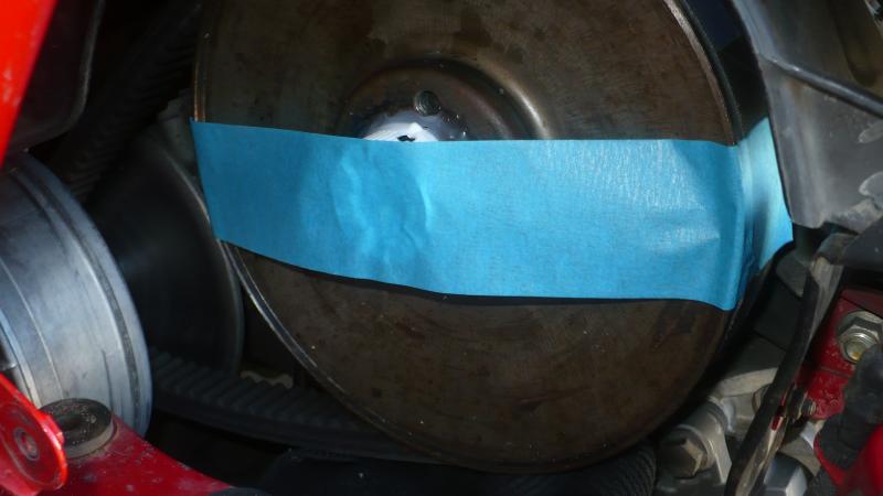

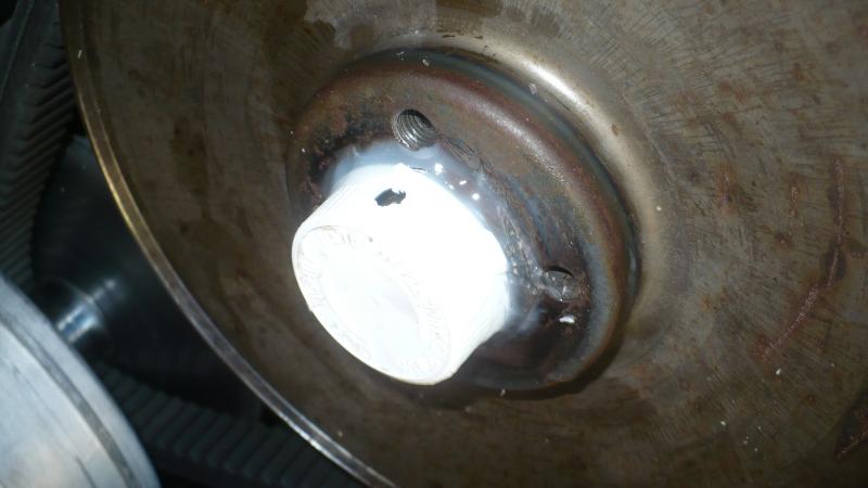

Before trying this method, I hit the driven clutch bolt for quite some time with an impact tool, also tried impact in forward(to tighten) for a second or two then back to reverse, tried lightly tapping the head of the bolt with a hammer, I also applied some heat to the head of the bolt with a torch, still wouldn't budge. I sprayed with PB Blaster and let it set for a few days and tried the process over again, still wouldn't budge.
For this skillbilly method I found an antifreeze cap, drilled a hole in it then siliconed it too the clutch to cover the bolt and let dry. I filled it will penetrating oil, let is set for 4 or 5 days. Then hit it with the impact in reverse for 5 seconds, then in forward for 1 or 2 seconds, then in reverse and after 3 or 4 seconds, wheeeeee!! It came loose, now to inspect and lube if needed my driven clutch.
