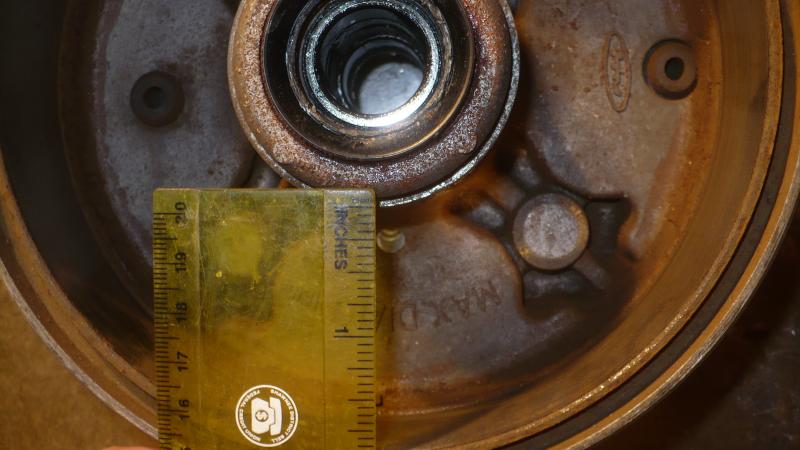

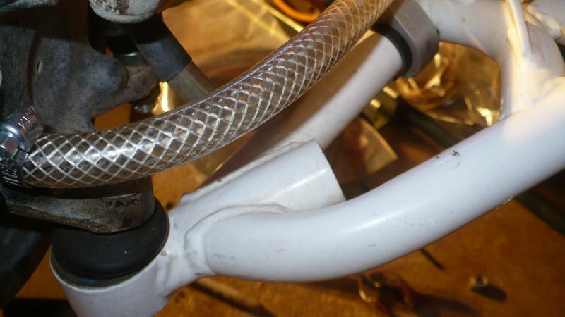

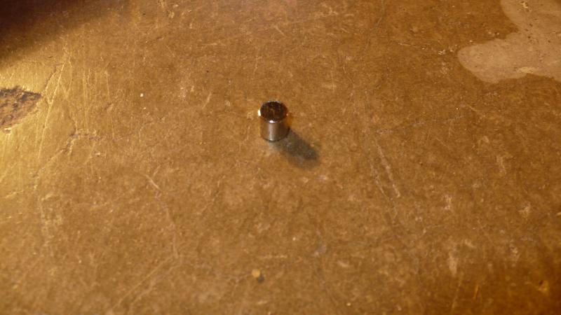

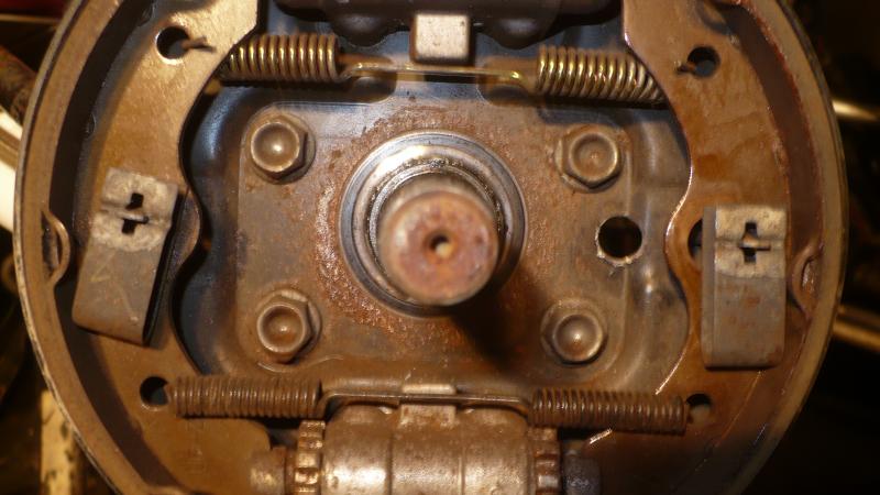

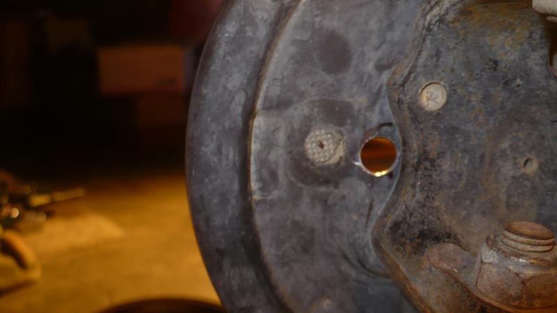

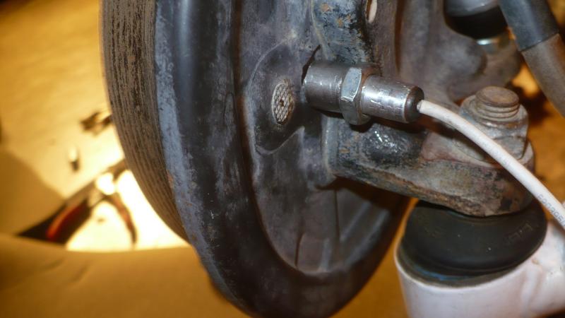

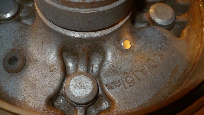

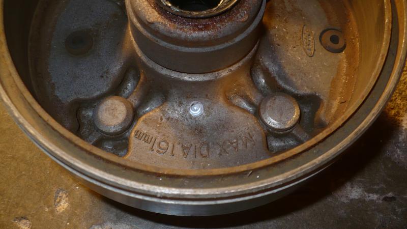

I thought I would post this installation to help anyone installing a Digatron (or equivelent) speed sensor/probe. The probe is receptive to a magnet. In this installation the magnet will be installed in the actual hub. See pics. The magnet is a 1/4" X 1/4" Neodymium high power magnet, I used the stronger magnet so I would have more play when mounting the sensor. When drilling the hole in the hub for the magnet, I undersized the hole by 1/32" about 3/16" deep into the hole. This way when I drove the 1/4" diameter magnet into the hole, the magnet would wedge itself into the hole, also a little JB Weld didnt hurt either after roughing up the magnet a bit with some sandpaper. This installation is a good guideline for anyone wanting to get thier speed from the front wheel as opposed to the rear wheel, rear wheels spins and will give false readings.

Thanks Radman and Hoser. It works but I still need to put on the wheels, make a few passes and calibrate the Digatron unit.

Stixs you have come up with a great way to mount the sensor. Few things I like about it, its mounted on the front, its mounted inside the hub, if its removed the hole can be plugged with an inspection rubber grommet, its out of site out of mind, the location of the magnet will most likely not come out.
Now if it work as expected? All I can say is Grrrrreat job and it should be nominated as mod of the year for 2013. Yea I'm jealous because I did not think of it. This is being put on your list of mods that I track.

Update, I ended up installing two magnets in the hub for better accuracy, according to the Digarton manual you can use anything metallic in place of the magnet. It works but I cant figure out how to callibrate the Digatron for my tire size, I followed the instructions but no dice. The Digatron reads about 5 mps under actual speed. Ill post a thread about proper calibration in the tech section/
