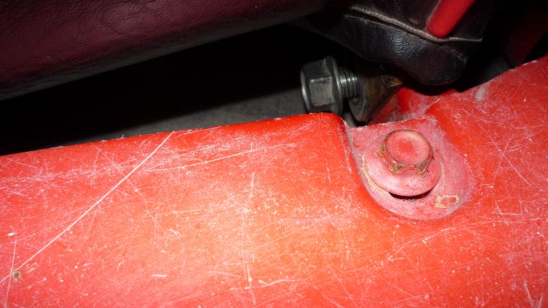

File comment: FRONT SEAT MOUNT BOLT
File comment: FRONT SEAT MOUNT NUT

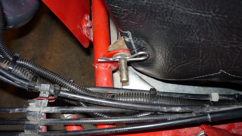

File comment: REAR SEAT PIN INSTALLED
File comment: REAR SEAT PIN AND "R" PIN UNINSTALLED

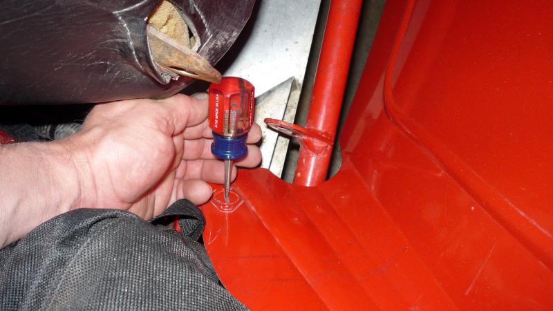

File comment: REMOVING HEAT SHIELD
