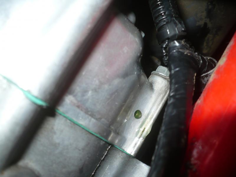

Does this look like my mechanical seal is bad. I found some coolant leaking from the weep hole. If so Ill be looking for that seal. Does anyone know if the gas tank can be removed by pulling it forward under the rollbar/net, rather than pulling it straight up or back, seems like I remember pulling it out through the seat side?? Keywords...........FL400 Pilot water pump seal, water pump seal replacement, Pilot water pump, Pilot coolant leak, antifreeze leak

PostPosted: Mon Mar 10, 2014 6:47 am
Put a paper towel on the hole for a min to soak up the liquid then head cycle the Engine again see if the coolant reappears.
You can remove the tank by removing the seat then removing the 5 bolts that holds the tank in comes out forward, only takes a few minutes to remove, don't forget to unplug the 2 wires for the low fuel light sensor.
PostPosted: Mon Mar 10, 2014 7:30 pm
I got home from work and noticed the weep hole was dry, too cool!, but then I did another heat cycle and it started leaking again, not cool. I thumbed through the manual on mechanical seal installation,i also found a post you did Hoser about the seal installation but the pics were distorted probably from that hack. Anyhow loooks like the right crankcase has to come apart. Can this be installed without removing the Engine. Do you think ill need a new crankcase gasket? Also do you have one o those seals. Im waiting for scpilot to respond I know he was selling off some parts.

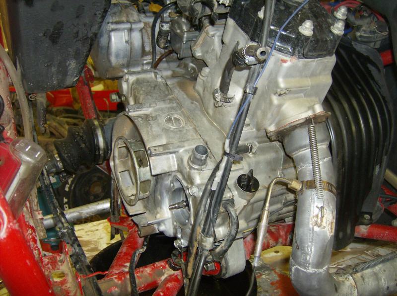

You can change the mechanical seal with out removing the Engine or case for that matter, I did mine this way 2 or 3 years ago. Just pull the water pump housing, pull start assembly, & the little impeller. i drilled a couple small holes in the old seal and inserted 2 screws and then pulled the bad seal out the front with a pair of vise grips. I tried looking for pics from when I did it but all I could find were these.. be careful when drilling as there is a lip on the inside of the case if I remember right. I just missed it when I did mine, but remember I did come close. :shock:
I hope this helps & good luck..

PostPosted: Mon Mar 10, 2014 10:28 pm
Thanks for the reply Rarerat, and the pic. Ive never installed the seal so Im trying to figure this out. It looks like the reason to pull the crankcase cover is to replace the OIL seal, correct? So if I do it like you did I would just be replacing the two mechanical seal parts. So the mechanical seal is a back up seal to keep coolant from getting to the OIL seal and into the balancer crankcase?

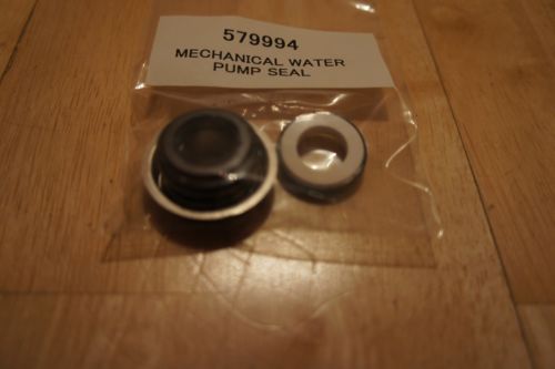

Her is a picture from an en=bay auction, of the one I purchased from the UK. I have not installed it yet, but it appears to be the same as the oem one I have. I believe he has the Honda part number in his auction.
The picture will give some idea of what Steve is talking about.

PostPosted: Tue Mar 11, 2014 11:27 am
Yeah the seal is as scpilot66 described its a spring loaded affair.
I would try what scpilot66 said with flushing if that don't work you can remove the impeller and access the seal you might try that first see if their is anything on the seal surfaces that might be causing it to leak, the only way I have ever changed one was with the case off and on the bench I also changed the bearing and the oil seal that is only accessible from the backside, I have never seen one of the bearings go bad or the oil seal leak its a really reliable seal system.
