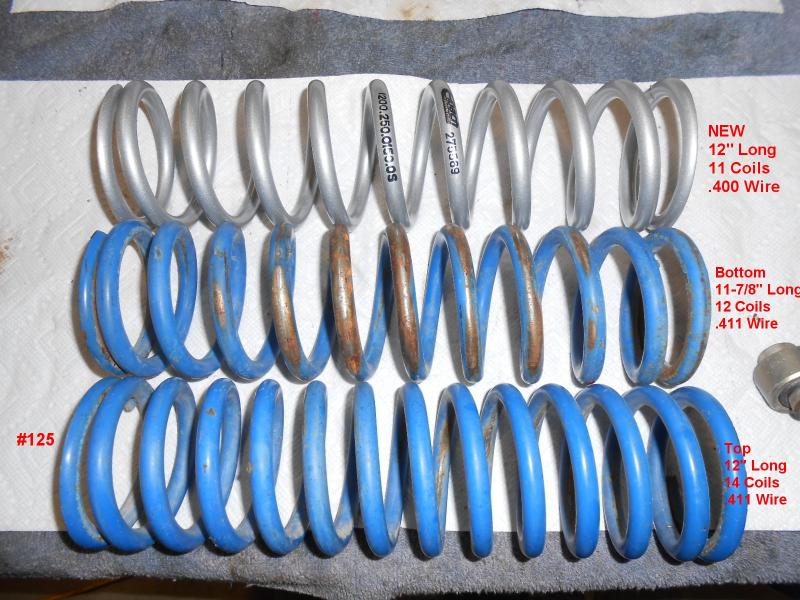

Next is the springs themselves, the top spring is the NEW spring that came with the Pilot its 12" long has 11 coils, wire is .400 the numbers on the spring are 275569 1200.250.0150.0S
The middle spring in the pic is the spring that was on the bottom when installed on the shock, its 11-78" long 12 coils, wire is .411
The bottom spring in the pic is the spring that was on the top when installed on the shock, its 12" long 14 coils wire is .411 has #125 stamped on it.
