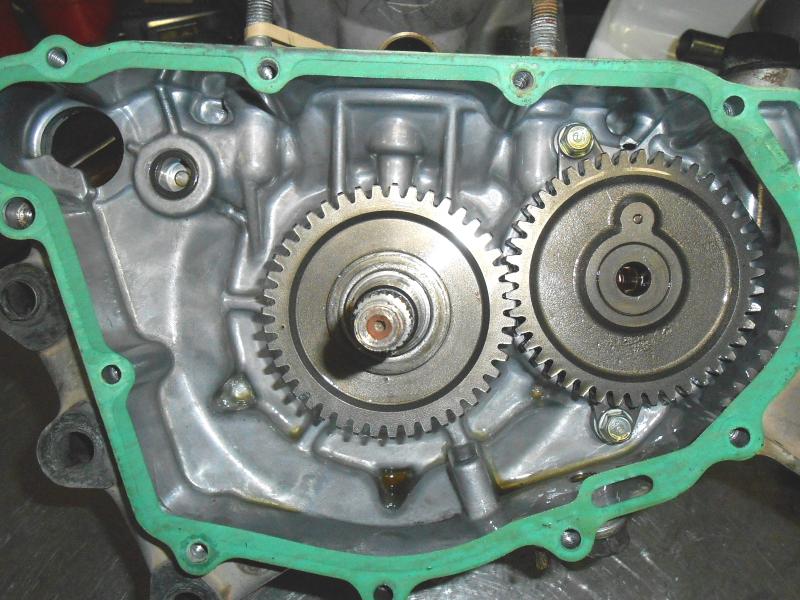

Nothing abnormal found inside the case, nice and clean inside.

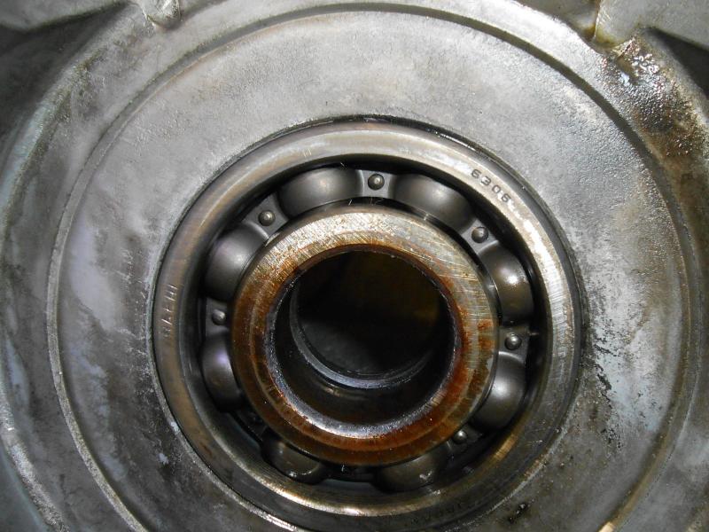

No shortage of dust inside the Engine and bearings, the clutch side bearing has the usual signs of rust, moisture gets in the seal I have made it a practice of changing the clutch side seal once per season while I have the clutch off being serviced .

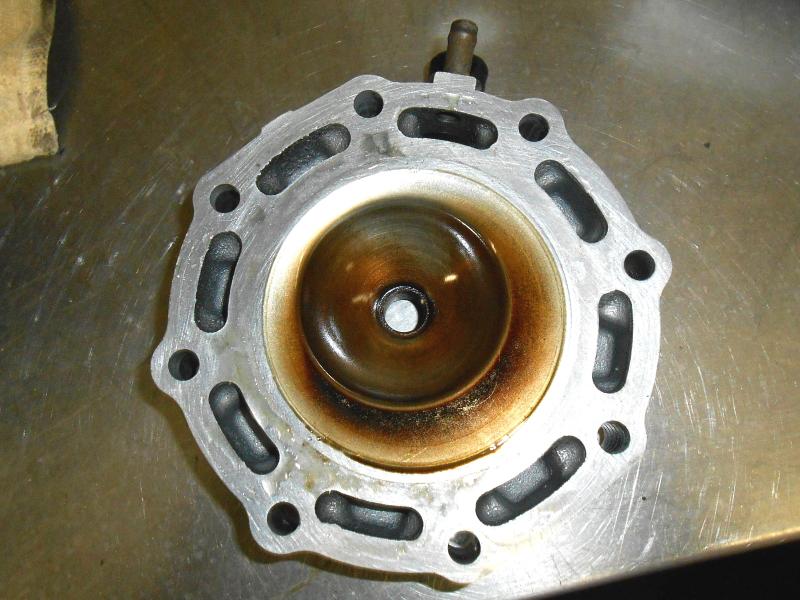

The head will be lapped to see if its flat then cc'd to see where its at I will hoserize so its safe on 91-93 pump gas and 49cc this will give the user about 165 psi at 500' elevation.

From memory,should'nt that clutch side bearing be a C3 spec/clearance rating?
