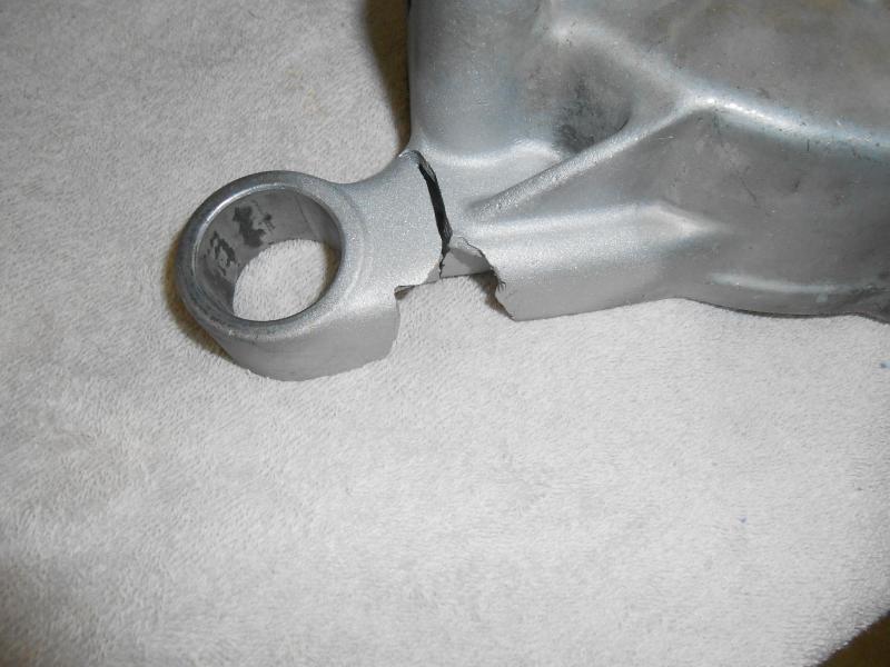

I removed the transmission from the frame so the lower transmission mount can be repaired, their was no problem removing the trans the stud shafts for the axles even came out easily and were well lubricated, the splines are in great shape.
I will come back and edit this post and add pictures.
Once out I took the trans apart I wanted to see inside and do a full inspection, nothing abnormal found inside, I cleaned up all the parts but did not scrutinize them at this time just a quick look I will look them over in great detial before reinstalling, I wanted to focus on the torque clutch pack measurements and doing the weld repair on the cases first.

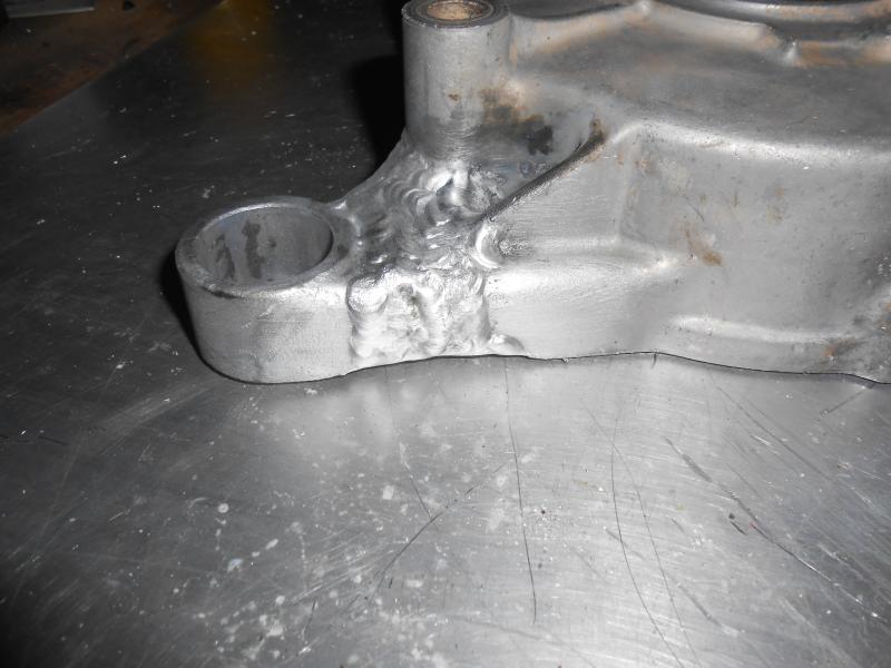

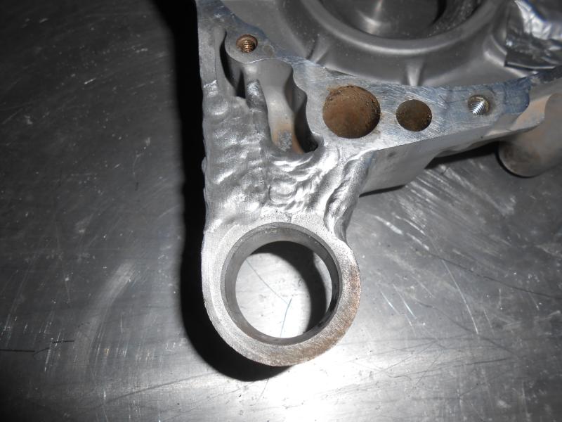

Update, I had my son weld up the broken case mount turned out pretty good I had him build it up more than just a repair to act as a gusset and give it more strength, I don't see it breaking again in the future.
Took the trans apart cleaned the cases then give it a quick sand blast to clean up the outer layer of aluminum.
Clamped it down so it could not move while being tacked together.
Let the welding begin!

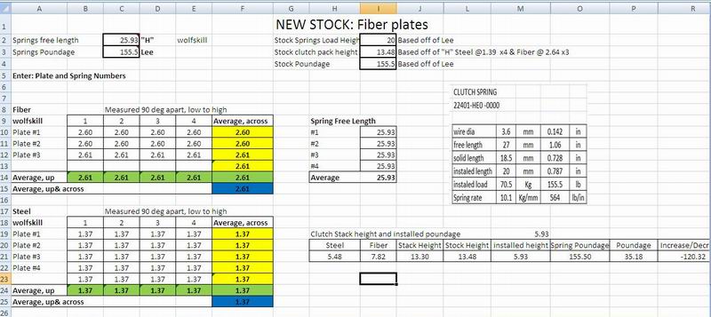

"H", I would say they are a replacement set from another machine. There is a lot of bikes that Honda made that run the same design of plate with the only diff being thickness. One can buy a thicker plate and machine down to a desired thickness to fit there pack based off of available replacement parts and wear on the drive and driven ( the two aluminum pieces inside the trans and part of the pack assembly). The book calls them the CLUTCH CENTER and PRESSURE PLATE. The pressure plate can be bought however the clutch center can not.
I mention these two parts because the wear on these change the poundage upon the pack via the springs installed height.
I inserted your numbers into a work sheet and found right now you at 120.32 lbs based upon stock numbers and NO WEAR on the drive and driven. The work sheet needs this number to be accurate. Based off of wear number I have taken you can be between 105 to 117 lbs of load per spring on the pack. The installed height or installed load need to be with range of the stock spring. If not you could over stress the spring and it will continue to take more set. The big question would be what would be the minimum poundage with out wear the pack can take.
I offer this for thought, not proven just a hacker way of thinking.
Lets look at the dry weight of the machine 600 pounds. leaving out rider and fluids
spring load at 155 pounds each with four springs. 155 x 4 = 620 lbs.
At 120 lbs per spring or 480 pounds the diff is 140 pounds.
I do have more thought on this just not the time. I will try to do more later.

That would make sense then someone replaced the steels in the past and used some that were from a different application and never verified the thickness of them, I was unaware they came in different thicknesses.
How about I put a spacer under the spring to make up the difference in plate thickness and call it good for now unless you know a part number to get the correct thickness steels?
Let me know when you get your new springs sorted out I still want at least one set.
