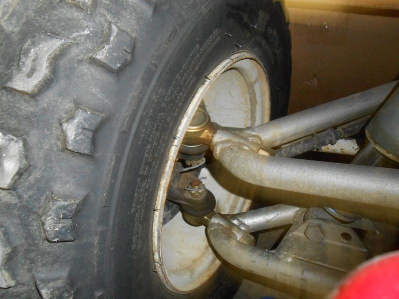

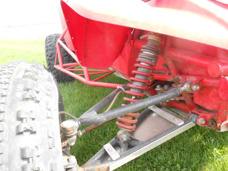

With shock covers off.

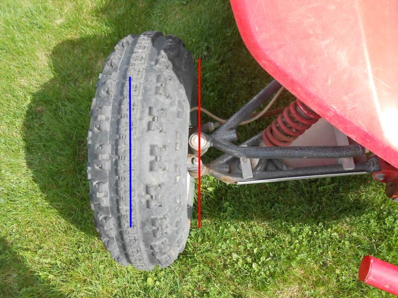

People ask what the offset of the front rims are I have no idea other than its the WRONG offset if someone can tell me the correct way to measure offset I will measure it.
All I know is the center of the tire (blue line) is suppose to be over the center of the ball joint (red line) if its not then its HARD to steer the Pilot because the LEVERAGE is working against you and every little bump the front tires hit it tries to rip the steering yoke out of your hands, if you had a handle bars like on a quad then you could at least have a little chance at fighting the leverage working against you.
EDIT
Added a picture of a stock rim on the front notice the offset difference you cant see the ball joint.

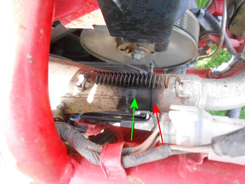

The silencer not only has no packing its not even installed correctly, looks like its not even slid on half way.

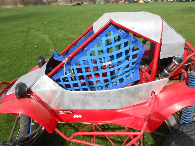

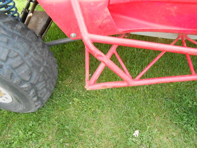

Who ever fabricated the top cage and the body work did a nice job.

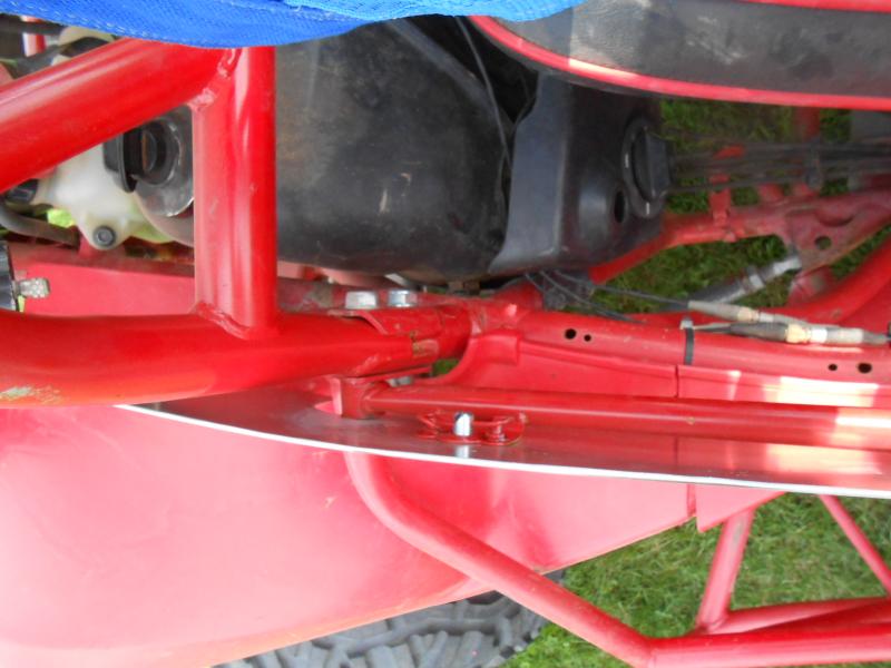

It all just bolts on.

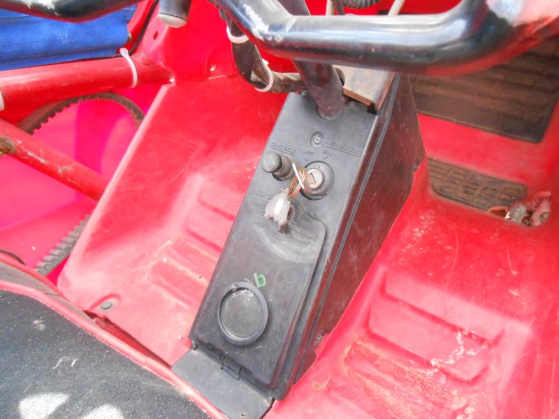

PostPosted: Tue Apr 22, 2014 6:01 pm
Key in the ignition and one key left in the gas cap have not checked to see if they are keyed the same.

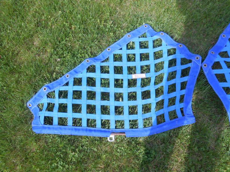

PostPosted: Tue Apr 22, 2014 6:02 pm

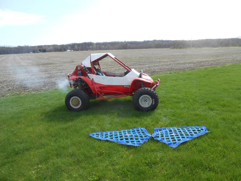

Before I drive it into the shop those nets has to go.

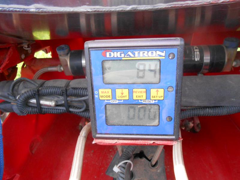

PostPosted: Tue Apr 22, 2014 6:03 pm
Not sure what model the digitron is looks like its only CHT and RPM?

 Post subject: Re: Wolfskill LT Pilot
PostPosted: Wed Apr 23, 2014 1:51 pm
your thinking of scrub radius. once you have that figured out then you can determine what offset wheels are needed
PostPosted: Wed Apr 23, 2014 3:39 pm
Call it what ever you want all I know is the closer you keep the front wheel offset to the OEM specs the better, faster and easier all Pilots will steer, those who run the wrong offset end up with drivers fatigue and spending more money trying to correct this problem like installing a bump steer kit and or the steering stabilizer thing.

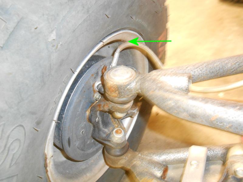

I was just looking at the LT Pilot and it looks like if I install a stock rim on this ATV Racing LT Pilot that their brake lines will rub on the rims? Is it possible that someone installed the brake lines wrong like upside down and that is why they are sticking up like that?
Here is the stock rim on my Pilot with the +2 arms you cant even see the brake line haha
PostPosted: Wed Apr 23, 2014 4:43 pm
your the one always trying to teach everyone the proper terminology for things, example motor (( Internal Combustion Engine ? )), vs Engine. well this is just an example. go to any site where they are building buggies and this one of the things you learn about building a a-arm suspension
i am sure that if you measured a stock pilot you would be close the measurement required, within that 1" in board. so measure where your scrub radius is and you can figure out what off set wheels you need.
PostPosted: Wed Apr 23, 2014 6:09 pm
your the one always trying to teach everyone the proper terminology for things, example motor (( Internal Combustion Engine ? )) ((Internal Combustion Engine?)), vs Engine. well this is just an example. go to any site where they are building buggies and this one of the things you learn about building a a-arm suspension
I will be installing OEM Honda Pilot wheels so no measurements are required?
FYI I never tried to argue with you or tell you your wrong like others have with the motor (( Internal Combustion Engine ? )) thing I am not really sure why your your trying to make this connection if you have a axe to grind spit it out don't beat around the bush with chicken shit comments , if your doing like others past trying to take pokes at me because you don't agree its probably best for everybody if you leave this site never come back save everybody the trouble of me ending up banning you in the end I realize many losers can not deal with the FACTS about the motor (( Internal Combustion Engine ? )) thing they also cant purge their brain of stupidity, I said call it what you want because I simply don't know and have no idea if your terminology is correct or not, I have no time to research it to verify your right, I will no longer waste time chasing down suspension crapola I wasted days of my life reading about suspension stuff by such experts as Moskito on the minibuggy site only to find out he is dumber than I am about the subject, need proof look at ALL his past projects where he messed with the suspension and or steering, same goes with all the other buggy projects on that site havent seen one work right yet, does not make them bad people it just makes their projects look really stupid, anyways I no longer waste my time reading about shit that don't work, I am no longer amused by failed projects, its irrelevant really, because I am installing the factory rims whether they are a 99" offset or just 1/4" off set that's what will be installed and used whilst I am the owner, the bead locks will be sold to other owners who like them or the scrap guy.
I am not sure I understand what your "1" in board" reference too?
