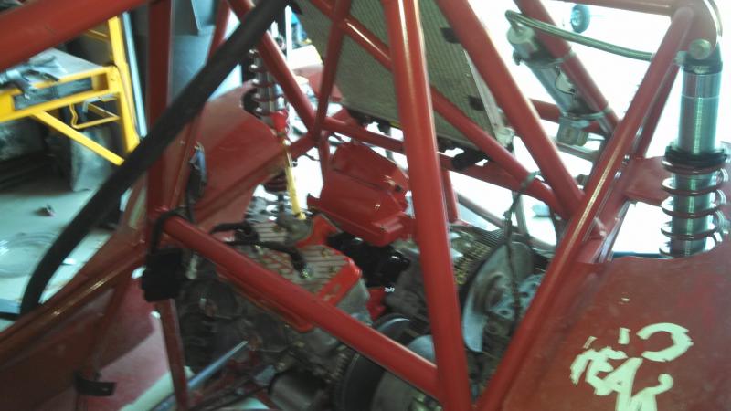

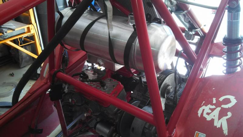

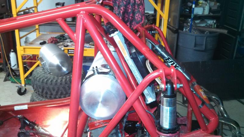

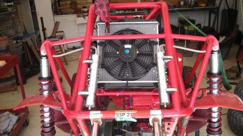

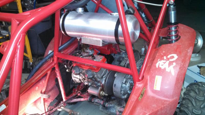

Ok so i got a little work done on my pilot this weekend after finishing Steve Wheels 583 swap. Mine is somewhat more fab work with the new cage that Dave-co built but is coming along. What do you guys think?

 Post subject: Re: 583 swap
PostPosted: Tue Feb 18, 2014 12:00 am
looks amazing
PostPosted: Tue Feb 18, 2014 12:06 am
Posts: 550
Looks great with the cage painted chris
PostPosted: Tue Feb 18, 2014 12:12 am
Posts: 266
That thing looks badass great job!!
