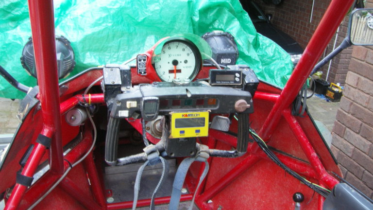

I used the Howe 2:1 Stealth SQ,it ends up the same lock turns as the Pilot yoke setup, if not an ant's fart quicker.
The 1.5:1 will turn a bit farther than this.
I would be going the 2:1 Stealth model if I was EWE :shock: :-)
PostPosted: Mon Apr 29, 2013 2:05 am

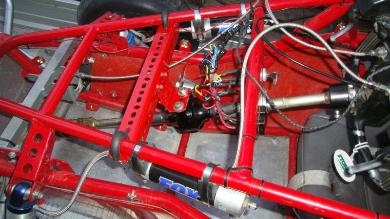

Here's some early pics I found when moding the 02 Drak.
Later because of the harder steering input,I then added the Unisteer PS unit.
Another reason for the Howe Stealth model is that it's much shorter than the ol style 1.5 :1 model.
You need all the available shaft length(no jokes) you can get inorder to fit both the Howe SQ + EPS.
The Howe SQ,now sits directly off the rack and pinion,then the necessary U joints directly onto the Unisteer PS unit.
I made up a Z bracket that attaches to the Drak's ol brake pedal bars for the SQ.
