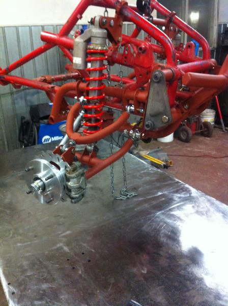

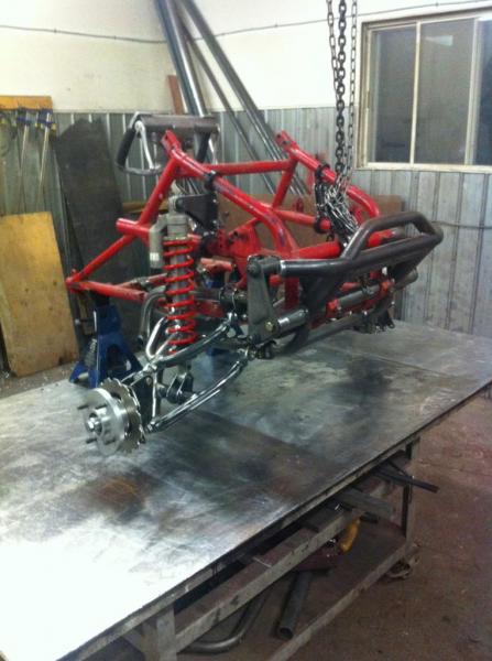

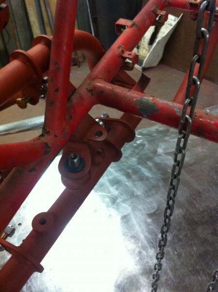

This project got put on hold for a while but it is back on full time. It's looking sweet

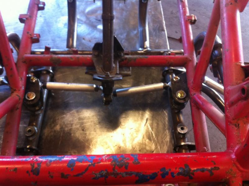

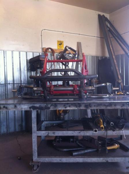

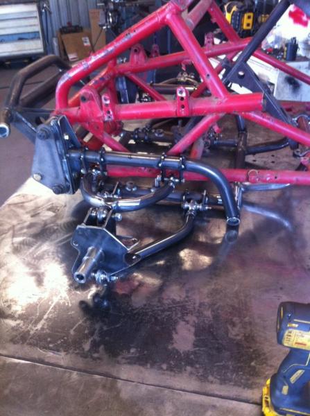

It's almost done!!!
PostPosted: Sat Sep 05, 2015 1:17 pm
Posts: 835
Location: corona
when he started building this setup he asked me how wide I wanted to go on the front end and I said I didn't want to go much wider than the back end. I'll have to go back through the notes and see how wide this thing is I kind of remember 52 inches but I'll look to make sure. With it set up with the 450 Shox and keeping the Shox under the fenders it's only getting about 7 inches of travel. With 10 available. We had a choice of moving the lower shock mount down or pushing the upper shock mount through the fenders
PostPosted: Sat Sep 05, 2015 3:30 pm
Are going to be able to use the stock foot tub ??
That picture of the steering linkage may be a bit deceiving as it looks like it might interfere with the foot tub.
PostPosted: Sun Sep 06, 2015 2:50 pm
Posts: 835
Location: corona
Yup, the stock foot tub will fit

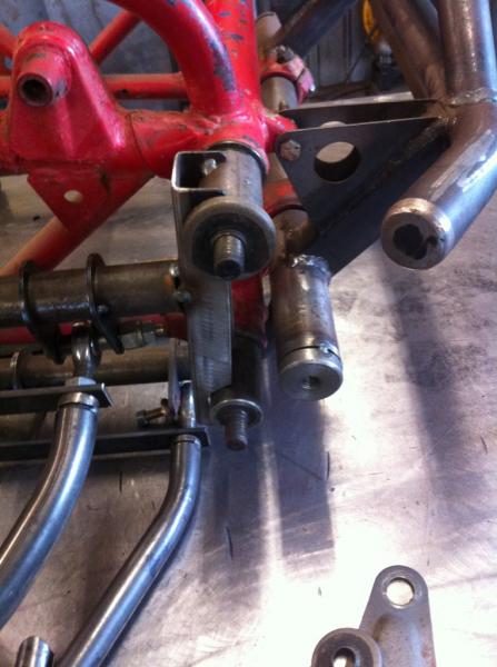

Ended up with 9"of wheel travel
PostPosted: Thu Sep 10, 2015 12:51 pm
you'll be cutting the fender and the foot tube with those upper shock mounts. and they don't look like they would be very sturdy.
PostPosted: Thu Sep 10, 2015 2:12 pm
Assume job, cant wait for a ride report. The increased lever ratio on the stock 450 shock should soften them up.
PostPosted: Thu Sep 10, 2015 5:16 pm
Joined: Mon Aug 05, 2013 12:19 am
Posts: 71
Im going to be offering two styles of upper shock mounts, one with a shock tower on the suspension itself with no mods to the fenders or like in the picture but there will be a brace from side to side in the production model. Price on these kits is 1200 usd for everything but the shocks.
PostPosted: Fri Sep 11, 2015 12:00 pm
Posts: 341
Location: North San Diego
Awesome job
I hate to be an armchair Qb , but it might help to make the shock mounts with a larger surface area clamp, especially the upper
Spread the load out a little better

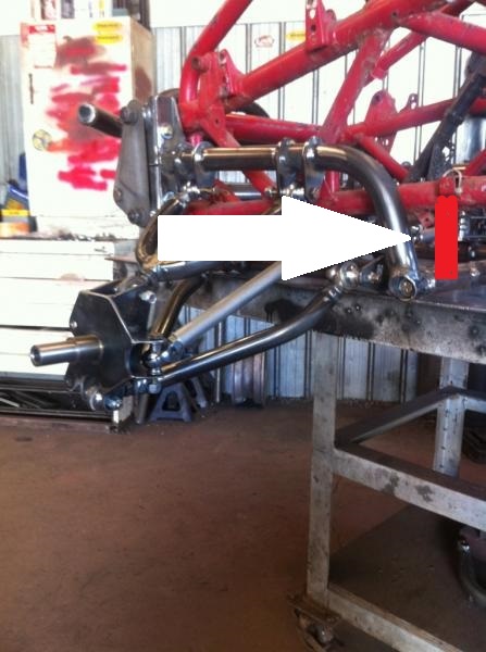

I was having a closer look at the pics
I would it be a option to add a brace @ the rear of the sub frame to meet up
the the main oddy frame as it would add to your mounting points and remove
some flex
Just a suggestion
see pic

Good eye on the foot tub, the bolt for the antibumpsteer was just touching the tub, I had forgotten how much it dropped down. I modified the bracket to get the clearance. I also added a brace in the back but I am going to do a little stronger brace now that im going to put the shock mount on the suspension itself that way there will be no mods to the plastics. I also made the bumper bolt onto the subframe

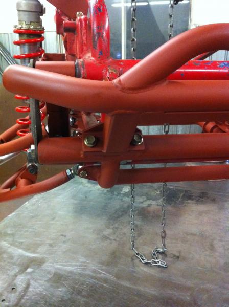

PostPosted: Wed Sep 23, 2015 7:24 pm
Posts: 71
What do you guys think of me putting together a set of plans so people can fabricate what they want and being able to buy the parts they don't want to make or cant, I know money is tight especially for toys for a lot of people so this might be a good option
Nice very nice.
On a negative note I don't like that mickey mouse rigging. Looking at 015jpg if that hoist chain slips past the mouse on the hook your gona lose a finger or break your arm. Wrap that chain around the hook one time or better yet use a sling. JMO.

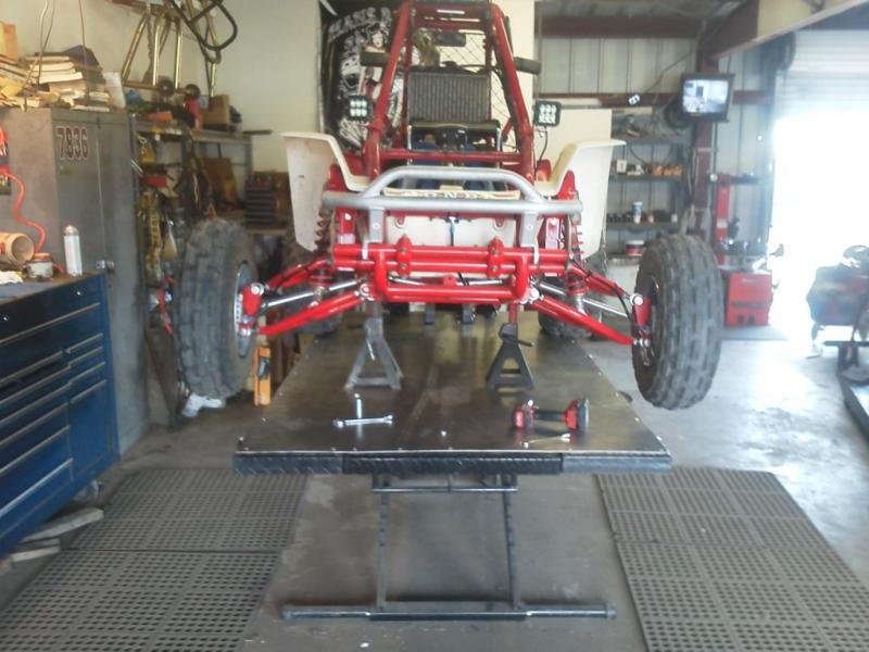

This front end kit came out beautiful. And the rear end kit looks like it's coming along really nice. Farr Offroad. Com
PostPosted: Sun Apr 10, 2016 7:46 pm
is this finally back at your place, can't believe it has taken this long that is crazy.
those axles look pretty dam long
PostPosted: Sun Apr 10, 2016 7:59 pm
I agree, mine for my project are way shorter, what is the part from? Polaris UTV?
PostPosted: Sun Apr 10, 2016 8:07 pm
Halfway to being ready for an airing out.... The front fenders in their current perch will be rendered useless, real men don't need fenders.
Love it!
PostPosted: Mon Apr 11, 2016 1:34 am
Posts: 835
Location: corona
I believe he was working with rzr 800 axles
