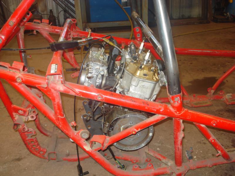

Im really thinking about it. And the more i think the more i want it.

You won't regret it. After driving my Briggs with the Polaris 700 twin, I can tell you that you will never look back.

well you already have it in the frame might as well finish..
the one that AK built was really nice, and ripped but its down under now lol

This is still at Farr-offroad

Better have lots of slipper clutch rebuilds on hand. My 670 likes to eat them. Only way I'd go more power than I have now is with a more stout trans.

I bet it rips the rear pulley right out of the case. don't be a fool Chris, 160 or what ever HP it is is just plain stupid in a pilot. The cool factor is not there, its just plain dumb. As thin as the pilot is made you are playing with your life! Its not worth it. Put something like that in your drakart maybe but not a paper thin pilot....THINK!!!

that's the problem. all of it is discontinued and the only piece of it aftermarket is the fiber disks. but i can almost bet 100% that your springs are past their service limit and the plates themselves are past the limit. I got lucky and just reused my plates and have had good luck. havent had it eat another set. But i also upped my spring pressure with an extra washer on each spring. EBC makes a set of fiber plates as well as Ferodo. I am running the Ferodo ones currently and they are working great. I just bought them to test to see if they would hold up.
My advice... keep the 670 OR get a fuel injected etech 600. same power more reliable and fuel efficient. that's the route i plan to go with my next build. just gotta find a decent deal on a donor sled.

Sell the Pilot trans, driven clutch, axles, rear hubs and buy a RPM trans or a Team Moto trans viewtopic.php?f=2&t=6639
Skip all the wasted time and money trying to keep a drive-line that is discontinued parts and that was designed for 40hp together.
