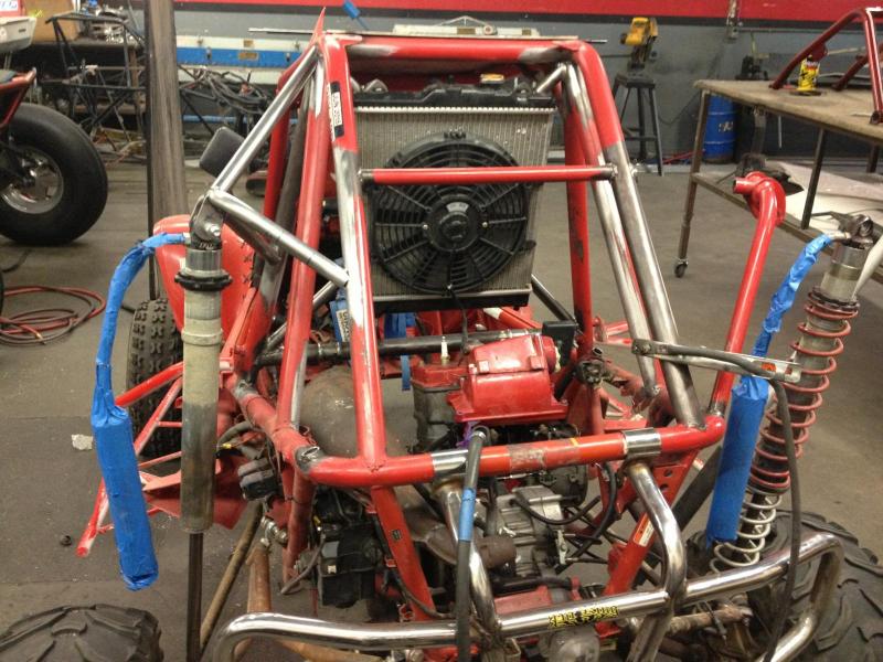

PostPosted: Wed Jan 28, 2015 2:15 am
Posts: 835
Location: corona

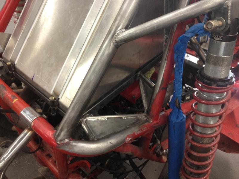

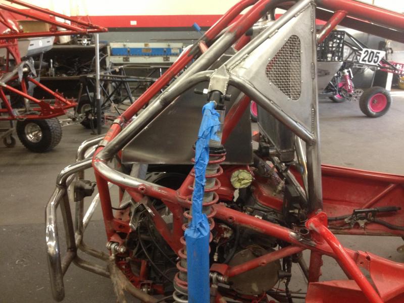

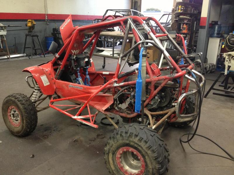

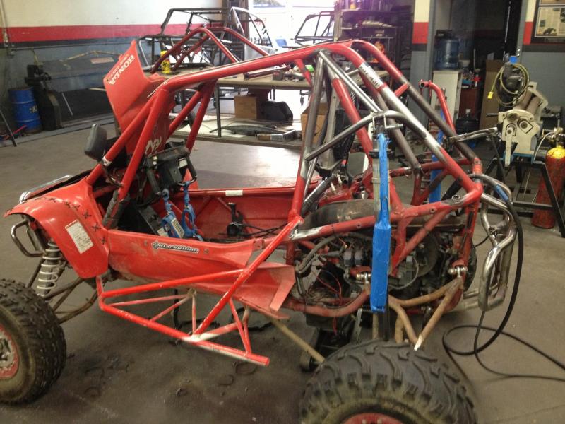

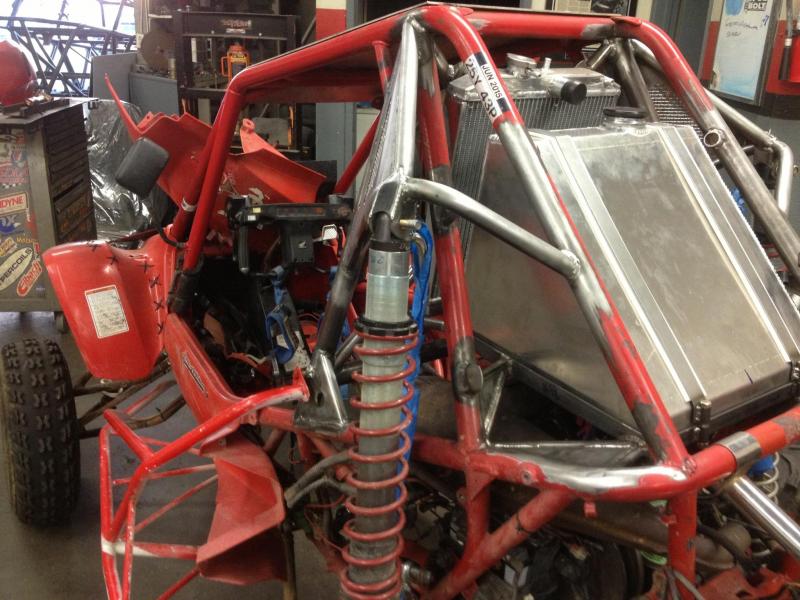

what ya think

 Post subject: Re: Time for a remodel
PostPosted: Wed Jan 28, 2015 4:40 am
I like your shop.
It's big and has lots of stuff --- welders -- sheet metal bender -- rolling machine -- chop saw -- ??.
PostPosted: Wed Jan 28, 2015 11:37 am
Posts: 835
Location: corona

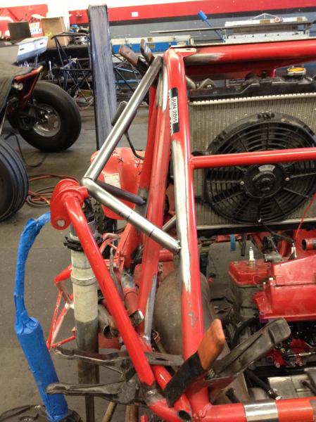

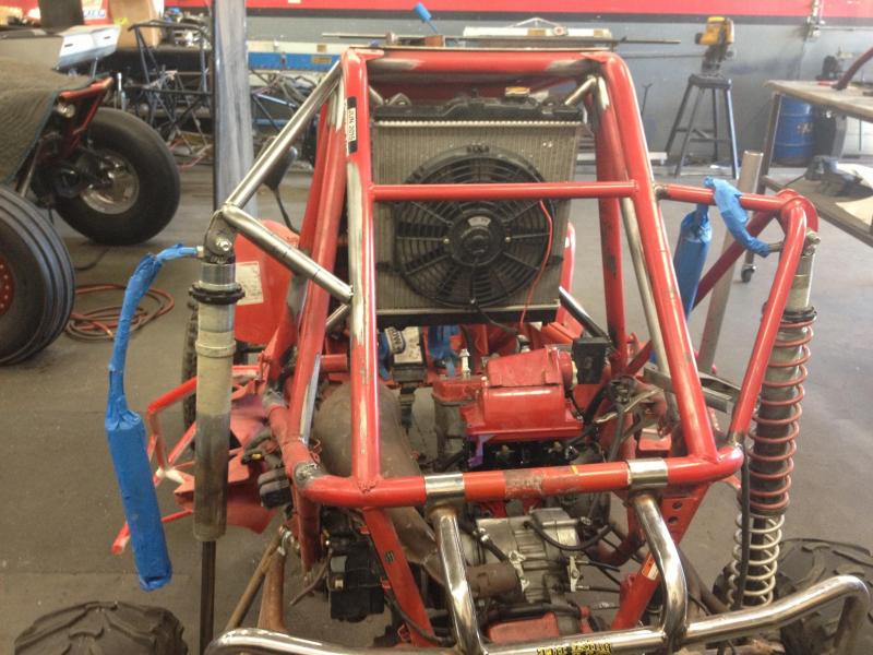

this shop belongs to a friend of mine that I race with. jones fabrication in Upland California
PostPosted: Wed Jan 28, 2015 2:41 pm

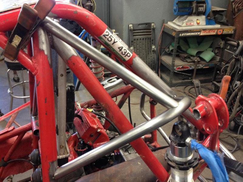

Did you bend the old hoops? What's the reason behind moving them
PostPosted: Wed Jan 28, 2015 4:19 pm
Posts: 835
Location: corona
They were out to far and I almost had to cut off the back of my fenders

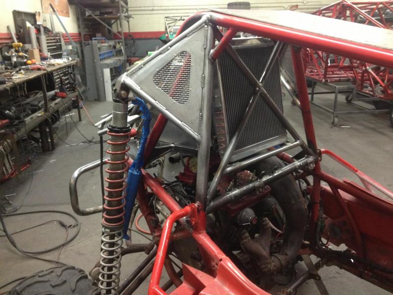

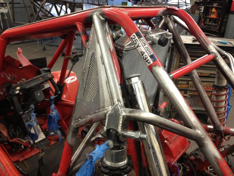

PostPosted: Wed Feb 04, 2015 12:14 am

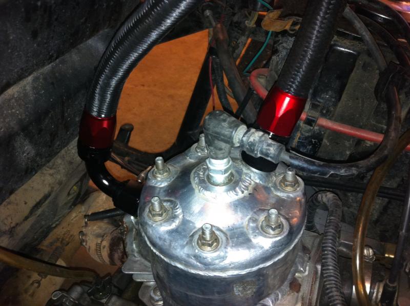

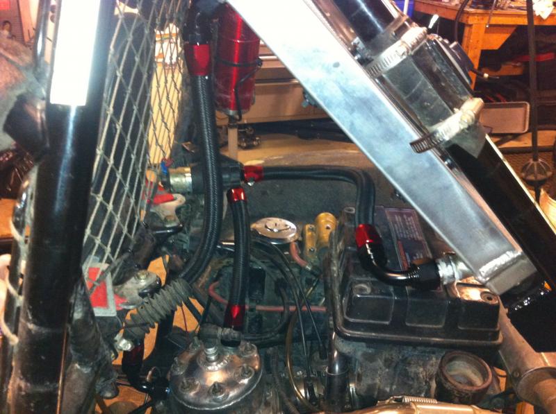

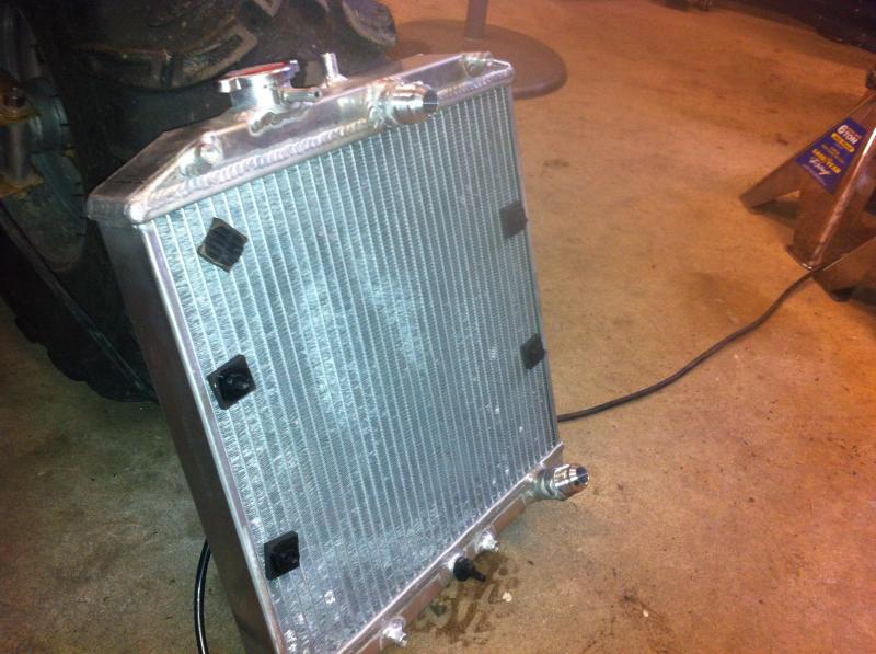

looking good..how you going to run. your top coolant lines. i am running the same rad and i welded AN fitting on it. looks a lot cleaner and looks much better as well
PostPosted: Wed Feb 04, 2015 12:28 am
Posts: 835
Location: corona
Going to do the same. I wont know till i get it back tomorrow. Building the wing roght now.

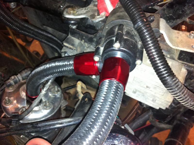

Here's a couple pics
PostPosted: Wed Feb 04, 2015 12:41 am
Posts: 835
Location: corona
Cool looks good, I need 1" fittings for mine. We may just put a 90 on it
PostPosted: Wed Feb 04, 2015 1:17 am
Yeah believe that's what these are -12 which works out to be one inch.
PostPosted: Wed Feb 04, 2015 9:56 am

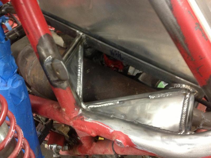

Good lookin' work, indeed! That rig just looks fun. Period.
I need send you some parts to weld for me. Would love to get to solid/pretty welds like those - that's ART! I still have to abuse my metabo and the air grinder to clean some of mine up, lol.
PostPosted: Wed Feb 04, 2015 4:33 pm
actually the - numbers are in 1/16s so -4 =4/16 or 1/4" -12= 12/16 or 3/4", -16 is 1"
PostPosted: Wed Feb 04, 2015 7:32 pm
good to know...i am pretty sure i ordered -12. and it worked out perfect on the bosch pump..so makes sense that they are 3/4".
thanks for clearing that up. never really understood how it worked

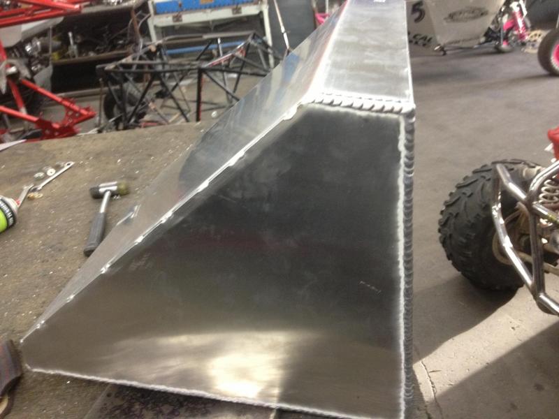

PostPosted: Thu Feb 05, 2015 1:31 am
Posts: 835
Location: corona

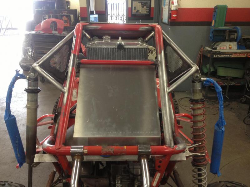

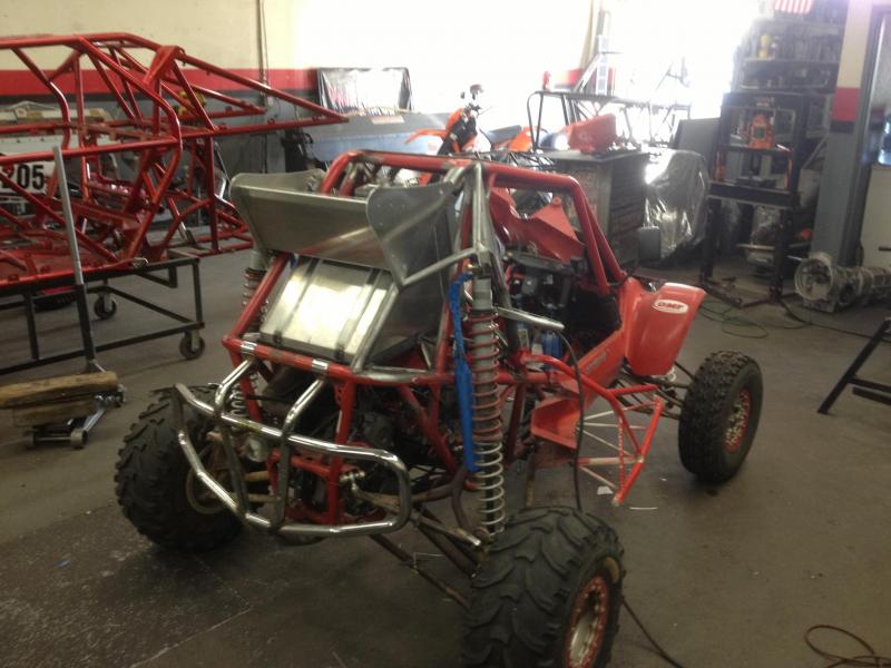

Made my number plates into a wing

looks mean!!
the tank design looks familiar :)
PostPosted: Thu Feb 05, 2015 12:17 pm
BEEFY! :-)

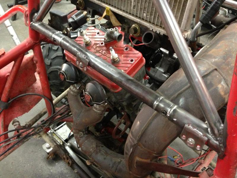

PostPosted: Thu Feb 05, 2015 3:43 pm

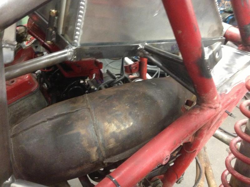

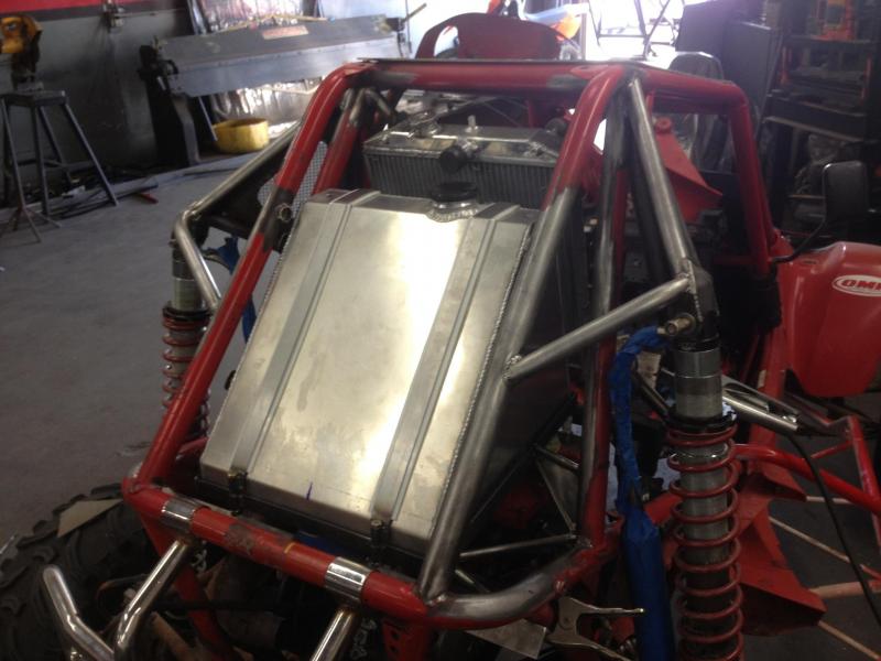

Man if you ever have to get that Engine outa there it's gona be a hack n wack show LOL.
Just joking. Nice work.
PostPosted: Thu Feb 05, 2015 5:52 pm
Posts: 835
Location: corona

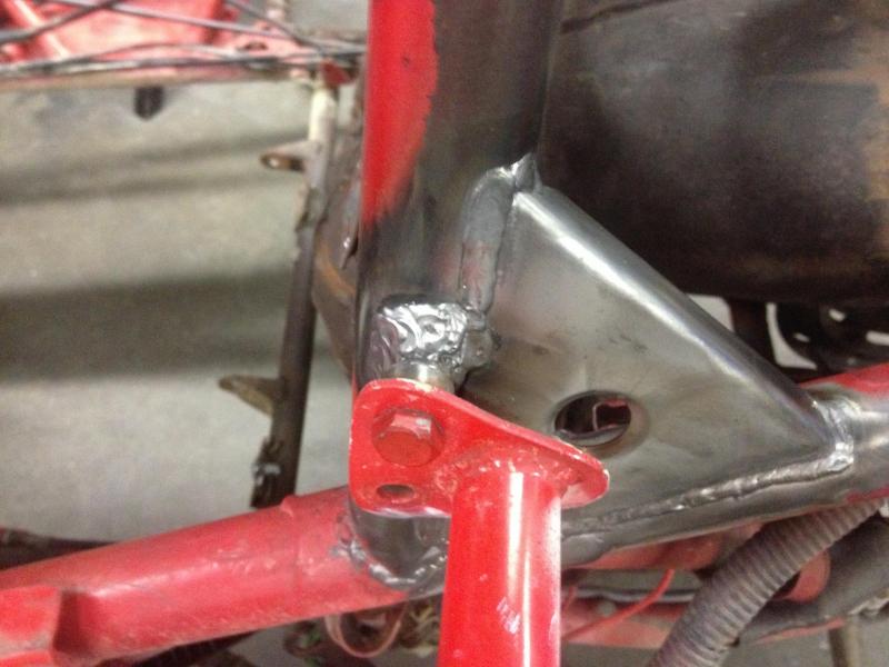

if you look closely at the spreader bar behind the seat you will see that we installed connectors so that the bar will come right out allowing easy access to remove the motor (( Internal Combustion Engine ? ))
