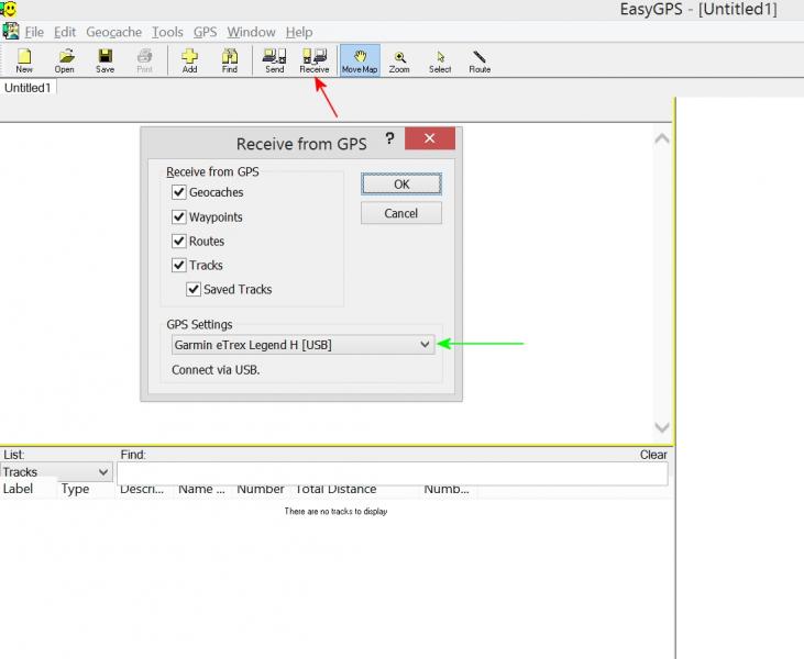

First I start up EasyGPS (see this link viewtopic.php?f=135&t=15708) and then on the menu bar click Receive (Red Arrow) a box will open up you will need to find your GPS model on the Device List for this tutorial I used my Garmin eTrex Legend H (Green Arrow) once you find your device click Ok it will download all the data off your GPS, I check all the boxes so it will download everything.

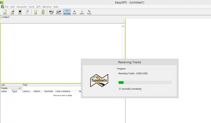

After you select Ok you should see a box popup saying its Receiving Tracks like in the pic below.

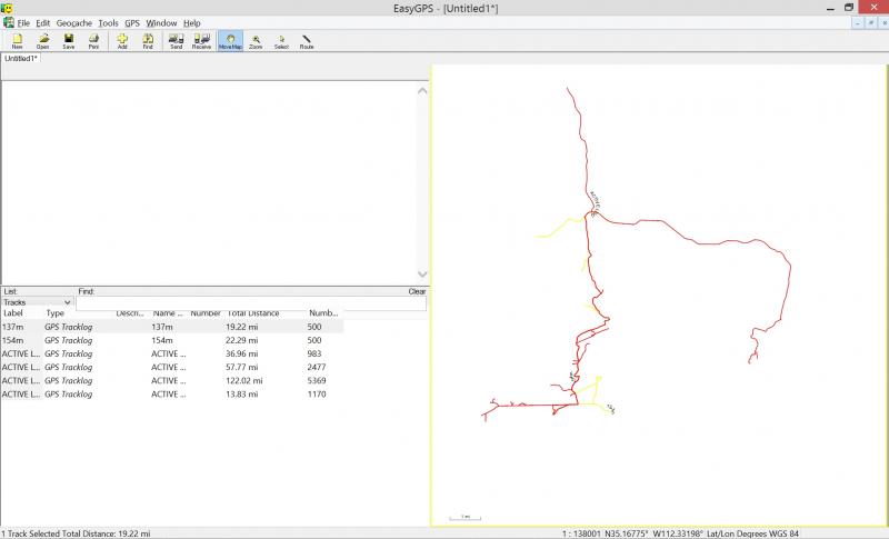

Now like any other Windows program you can use the Save As thing and save your data as a GPX format (GPS Exchange File) think of GPX as the PDF of GPS data...

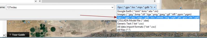

Start Up Google Earth then click on File then Open and navigate to the GPX file you saved in EasyGPS you will have to select the GPS format before it will recognize the GPX format your looking for see the pic below.
