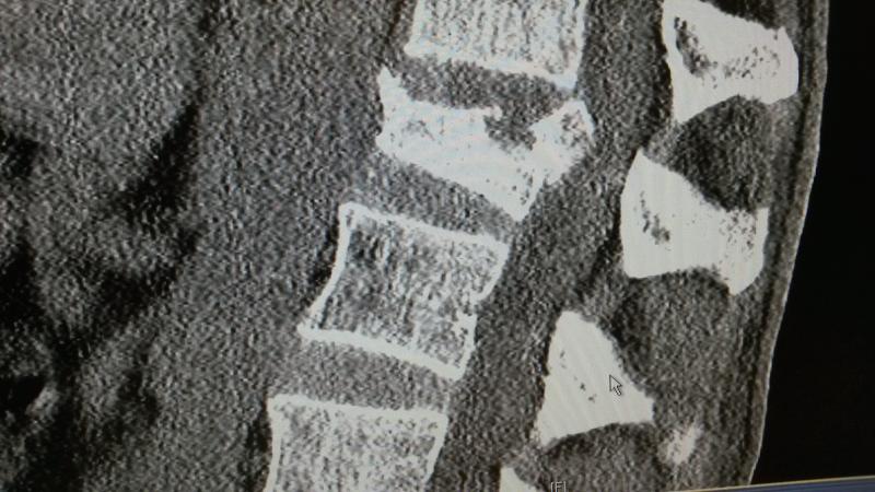

We just got back from my visit to the back specialist. We discussed my latest CT scan.
I told him I want to go back to work. He said if I feel that good then I don't need physio, work will be the physio. He said if it hurts don't do it. Also told me that in 6 months I can oddy again -- hurrrray!! He said eventually the three vertebra may fuse. There is intrusion into my spinal cannel (the bit you see) but it is very slight and my spinal cannel is quite wide so no problem. I do feel good but if I bend forward and try to touch my toes it isn't happening. Close but not quite.

What is that a nasa picture of some moon formation? :-)

LOL Yeah I think some of my brain cells look like that too.

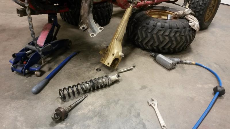

Just started stripping down the death machine for the good parts.
Man nothing surprises me anymore about this thing. When taking the rear suspension apart for the good bits the shock just fell apart in my hand. The back end of the shock rod got pulled right off in the crash, rear swing arm is bent and the rod end is bent at a 45' angle.

Naw it's not that bad..... that shit'll buff right out!

Frame has a 2" twist in it, top rear shock mount bent up 1/4", top cage junk, rear swing arm toast, busted steering rod, bent rear suspension tie rod, shifter got hit and cracked cable slot, also some hard points for down tubes are slightly bent.
Will try to straighten the frame at work, some time this summer.
Will do a rebuild next winter.

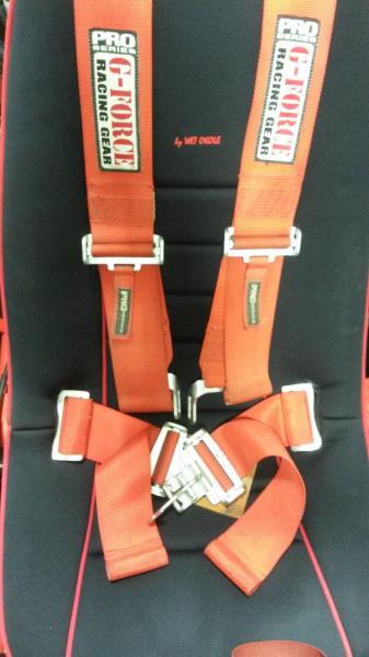

The pic below shows the belts with the new seat cover.
I had no padding or neck collar. In my opinion a neck collar would have done nothing for me, but the padding would have helped I bet. In the pic I didn't want to post there are two cuts on my hip. One on the hip bone area and one in the groin area from the lap belt.

Actually in the crash my head hit the ground.
There are a few reasons for this. 1) the top cage crushed a bit 2) the angle of the impact 3) A Honda boo boo in my opinion -- the seat belts are level with my shoulders. I am a small man 5'5" tall 130lbs and with those seat belts level with my shoulders they do not hold me down in the seat. Seat belts should be a few inches below your shoulders to hold you into the seat. I think they would be ok for a six footer but for a small person, not so good.

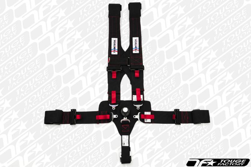

When I was racing at Northam Speedway in ex Neil's ATVRLT500Pilot,it came with the Teamtech wide racing belts,and padded sternum strap.
I absolutely loved it.Took a bit to get used to and adjusted,BUT you could feel the difference from std over the shoulder only belts.
Once adjusted,TRYING to move the body forward and other directions felt really secure,none of that split feeling of only shoulder types.
In the Pilot pic,you can see one half of the sternum pad/belt flipped over.I highly recomend them.

Those belts look awesome.
I think they would be the answer for a small guy. I do not have broad shoulders and one time we had to move the mounting points in our race car during a new build. I often thought about making some kind of strap with Velcro to hold the belts closer together. Your belts are the answer. You would still have to mount the top straps below your shoulders a bit or they wouldn't hold you down.
