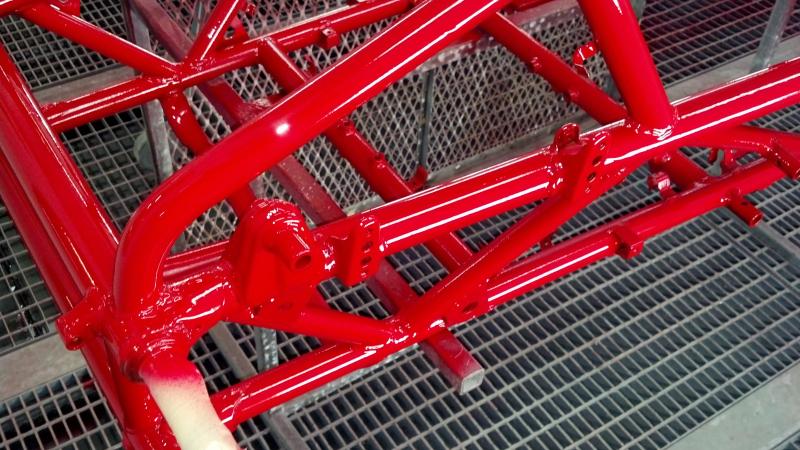

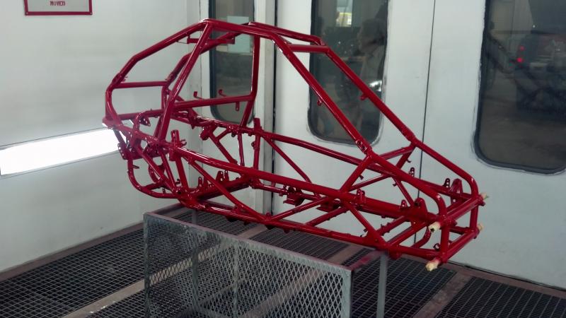

Some of you may have heard of POR15 and some of you may not. I got a lot of experience using this product so I wanted to start a thread. I also think it would be a great way to get a tough paint job without paying for big money for PC. Another thing about most this thread is about por15 hardnose paint and not the regular por15 black most associate with por15.
I guess I will start by why I think por15 would be good for Ody’s and pilots.
1-You brush it on. You can spray it as well but I have never done it. By being able to brush it on you do not need the spray painting tools and room. Anyone can brush and por15 self levels and you will see no brush marks.
2- its supper tough paint that IMO is harder to chip than powder coat. Next time you’re at a big car show and you see the por15 booth take a step up to it. They will hand you a screwdriver and a chunk of por15 painted metal and ask you to scratch it or chip it. It’s that tough and must be done right do get those results.
3- Repair factor. If you do need to weld on your frame after paint for repairs reasons. It’s easy to repaint the spot with por15.
4- Price. I have not done a pilot frame but look to spend about $125 for all stuff needed. A quart would be more then enough to do a frame and all the red parts. Por15 goes a long way. I can paint a FL250 with a pint. To get the legendary por15 bond I am recommending por15 black. And then por15 hardnose red on top of that. It’s not needed but well worth it. (I will go over the two-step method later) You can paint all black parts with por15 black starter kit.
4- Colors. I never painted with the por15 red. But from what I seen it may look well. Also the black parts can be painted with por15 black. Por15 black is legendary as it is. This will save you lots of money not having all the black parts PC. Por15 black is perfect for your gas tank as well. A $20 por15 black starter kit would paint all the black on your buggy. For the pilot guys you can paint your wheels with por15 Whitcote. Whitcote is the same as Hardnose but they call it Whitcote for it’s sold to the Marine trade under that name for some reason. I do not see any gold por15 though. They may have some in the caliper painting or Engine painting lines. They have por15 silver in a $20 starter kit. But it’s weird stuff that I will go over later.
5- Chemical resistant. Gas, brake fluid, and even paint stripper will not have any effect on por15. Spill all the gas you like with no worries. The reason paint stripper will not effect it is for it’s incredibly nonporous it will not let the stripper’s chemicals to penetrate it. For this reason it makes cleaning simple. Dirt and grime wash off like it was dirt in your kitchen sink.
5- Humid areas. Por15 is moister cured. So painting in humid or rainy days is best.

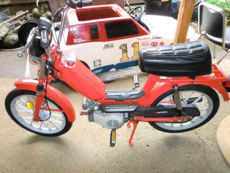

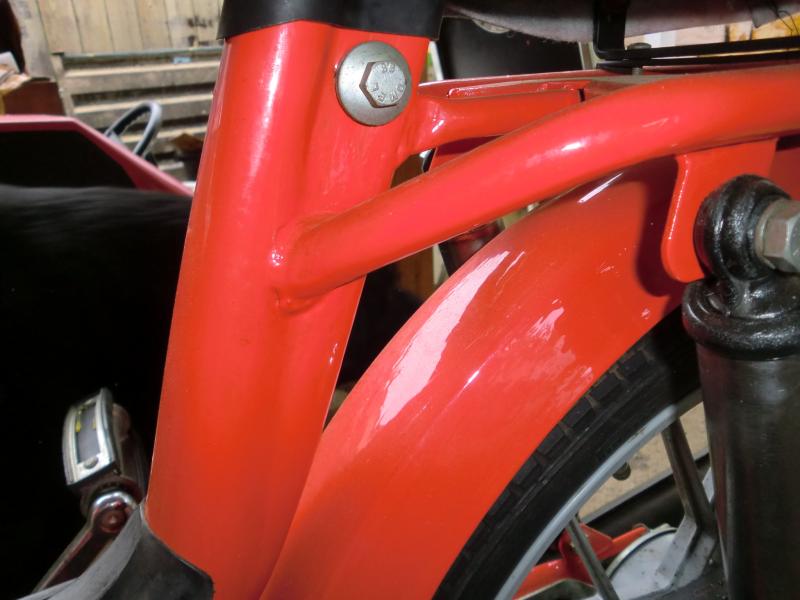

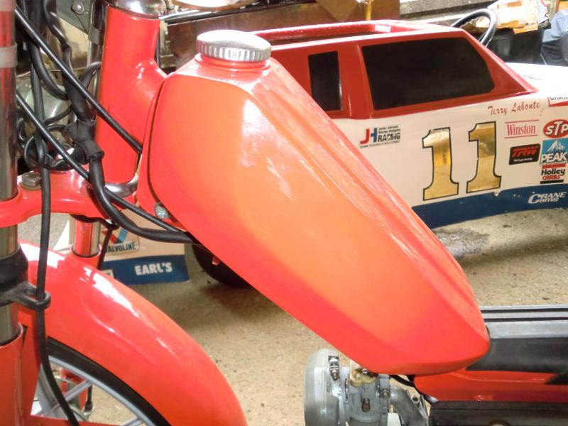

I painted a vintage moped with hardnose. I picked this stuff for the moped would get gas spilled on the tank. Also the moped rides on the front bumper of a motor (( Internal Combustion Engine ? )) home. So I wanted a paint job that would take the abuse of ridding on the front bumper. Here are some pics of the moped that por15 wash brushed on.

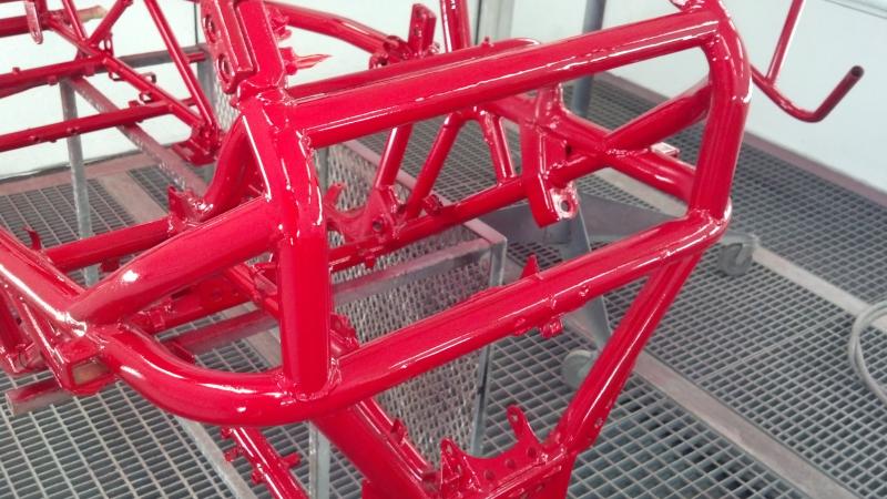

Here are some pics of the hardnose red on a mower deck. Not sure how it matches to Honda Red.

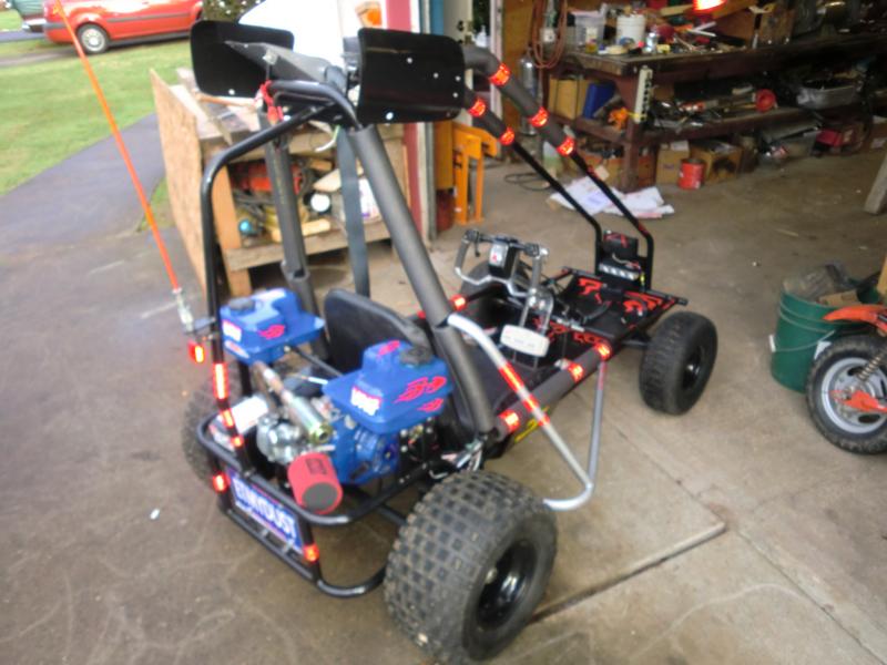

Yah gokarts are my other huge hobby.
I also like the pedal mopeds and 70's and 80's smaller enduros.

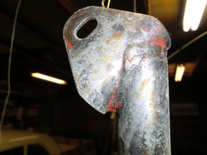

Here is a pic of the chalky looking look you get after you use medal ready. People call this the etching part. But whats really going on is it turned my rust to a zink phos. coating.
These parts were cleaned and let rust for a week in weather. So on super rusty parts this chalky white is even more that's what looks in my pic below.
I posted this for some people skip this Medal Ready part. Also the por15 Marine Clean degreaser is the best by far I ever used. It is water based which is another magor part on the bond process. I can go on few hours of how well marine clean works. But I will spare you guys all that stuff. I will say when cleaning old grimmy fl250 parts and Engine it will save me hours in cleaning/scrubbing time.

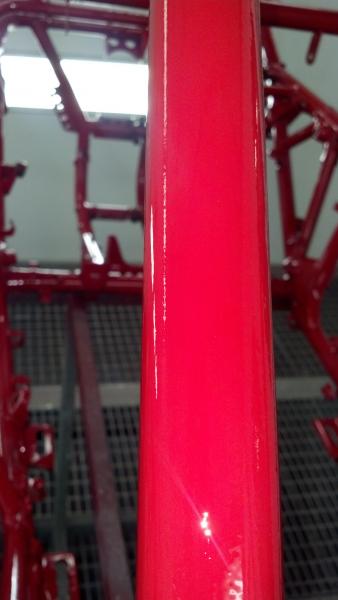

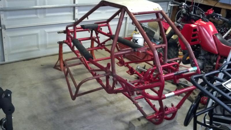

PostPosted: Thu May 02, 2013 11:25 pm
Posts: 2243
OK guys, I did a quick sanding to smooth out any flaking paint or rust and sanded off the stickers. I decided to spray the stuff with a hvlp gun and did 2 coats. Lots of wasted overspray but went on quicker than brushing...i think lol.Overall looks pretty good, I have a little left over for touch ups later. It is self leveling and takes several days to cure fully. I will add more pics later when totally dried.
Gary

PostPosted: Fri May 03, 2013 8:57 pm
looks pretty good..so did you do the metal ready thing to it, or just spray it. i have been wanting to do the fl450r when its done. i want to do black but i also want the uv protection.
what happens if its not protected from uv. will it start to flake?? or just color fade
PostPosted: Fri May 03, 2013 9:11 pm
Posts: 2243
Out in the sun the color looks really pretty n glossy but it needs at least 2 more coats in my opinion. Places that I only have one coat you can see light n dark spots thru the color. Nerfs had lots of chips and only one coat so looks bumpy, no runs. I also made tie down prints in the paint when I brought it home. I will spray it again after some warmer weather sets in. News said we has 15 inches of snow weds.
I did not use the etch stuff prior to painting. I have some rust converter from my dodge charger body work, maybe should of used some but didn't think it was nessisary. Guess time will tell. Lol
They make black with the UV stuff I think. Maybe the hardener as the uv stuff in it? Maybe check out the website. I have the original black somewhere.
Gary
PostPosted: Fri Aug 23, 2013 4:05 pm
Any updates on your frame, Nuke Em?
PostPosted: Fri Aug 23, 2013 11:12 pm
Posts: 2243
Nope, have not done anything with it. I am still waiting to finish some other projects and "honey do" list stuff.
