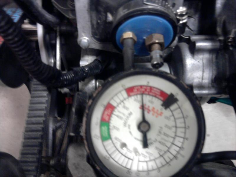

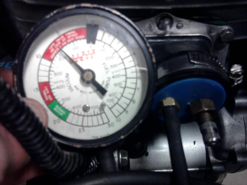

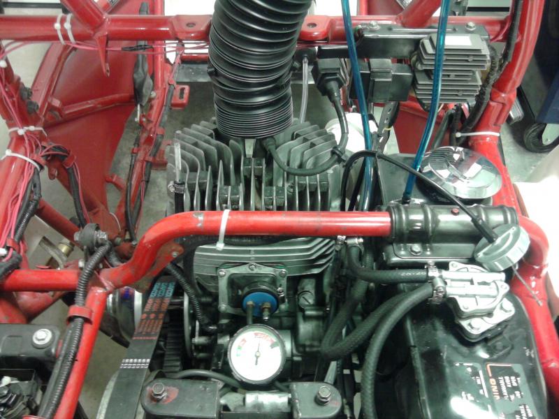

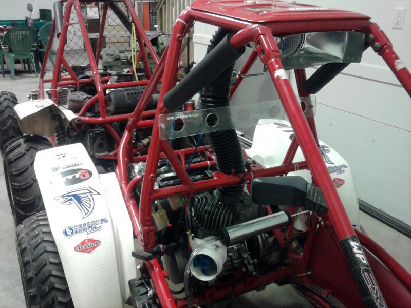

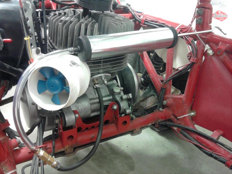

Need a bit of help here. Any opinions,suggestions,solutions are valued.
I have two FL350 and one with an Engine issue that I can't figure out.
The Engine starts fine and it idles fine. After it warms up and you rev it a bit it will take off at high rpm. This is a clear sign of an air leak. It will hold positive pressure for a week and it holds vaccum of 6-7 in/Hg for half hour plus. WTF???? Running out of ideas here. Pics enclosed.

Now I feel stupid and I cant even lie about it because of the pictures. I just figured it out. Just needed a coffee and lunch break. If you look at the pics you will notice my canuck hillbilly rigging. The vaccum gauge is on the intake and the siphon tube with check valve is on the exhaust. When I pulled vaccum and got 8 in/hg on guage the reeds closed after I stopped pulling vaccum. They held the pressure on the gauge because reeds closed. I just put a small tie wrap in one reed to hold it open and I did test again. I lost 5 in/hg in 3 min. It's all over but the crying now. Rebuild.
Conclusion: The positive pressure test is no good to test your crank seals because this test sets the lip seals tight on crank. It is a good test with soap and water to check for leaks on head gasket,cyl and case gaskets. The vaccum test is good for testing the crank seals. It seems clear to me now that a motor (( Internal Combustion Engine ? )) MUST pass BOTH tests and you must complete BOTH tests.
