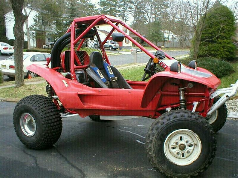

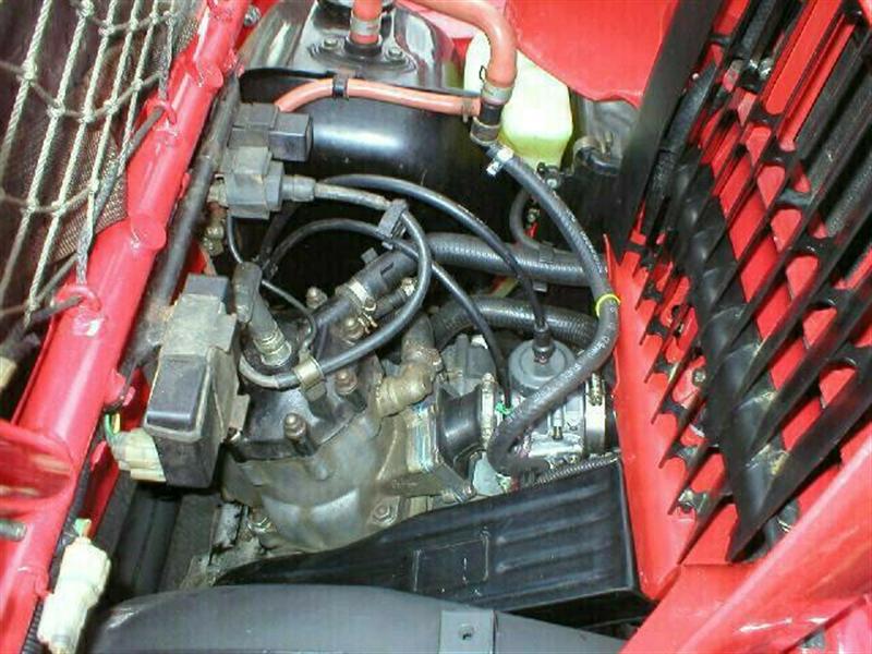

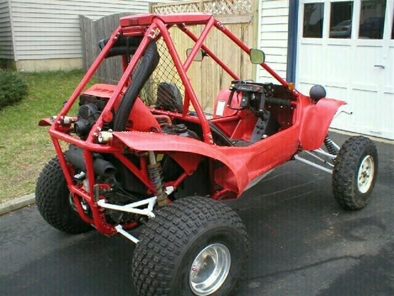

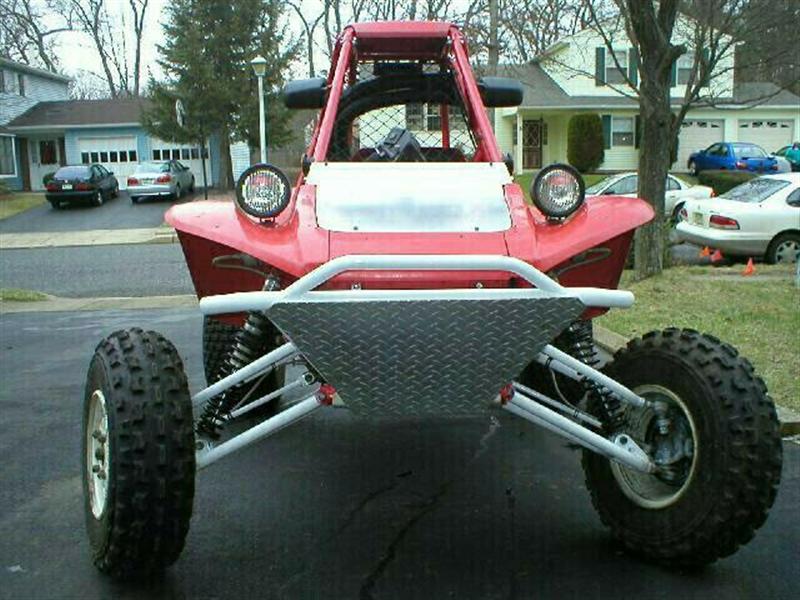

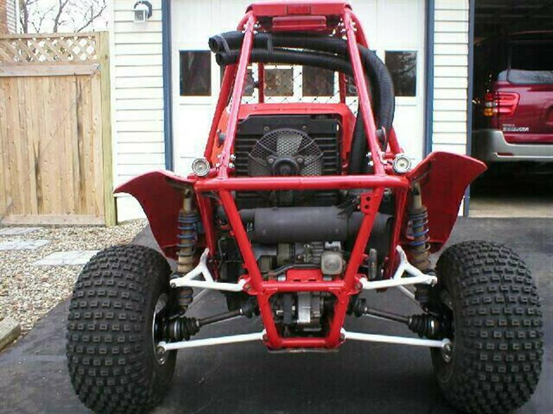

Part 2

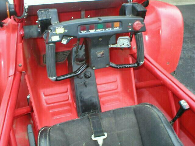

PostPosted: Mon Jan 05, 2004 9:30 pm
What happened to the hand controls?Looks great,does Wheelman still own it ?Great work, nicely done.

Actually this machine has changed hands twice since Wheelman owned it back in '01. I am the current owner. The hand controlls have long since been removed - holes in the thumb throttle and brake levers are the only evidence of the conversion. Since I picked it up this past November it has been:
1. Painted frame (Rustoleum Sunrise Red)
2. New Rear Disc (EBC) and pads (repaired parking brake to working order)
3. New final shaft and trans seals
4. Replaced both axle inboard stubs (had to replace one boot and 3 bands in the process)
5. Replace right rear knuckle
6. New rear wheel bearings, seals, ball joints, A arm bushings
7. New Keihin 39mm PWK carb
8. Dual intake airbox mod
9. New rear aluminum rims and tires (Thanks PMan!)
10. Disassemble starter, clean, inspect
11. Disassemble driven clutch, clean inspect
12. Disassemble steering column, clean inspect
13. Lube all cables
14. etc., etc., etc....
Next on the "to get" list:
1. Uni Filter
2. Dual Pre Filter set up
3. Power Bloc Clutch
4. Pipe
5. Works Shocks (rear)
6. Engine skid
I'll post some "before" pics shortly

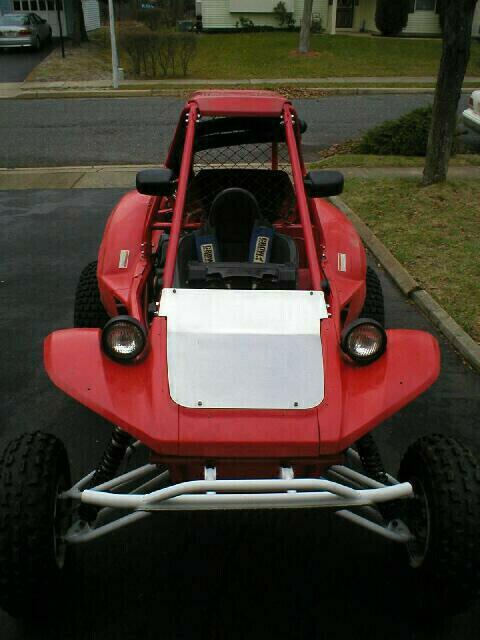

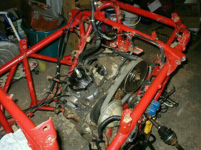

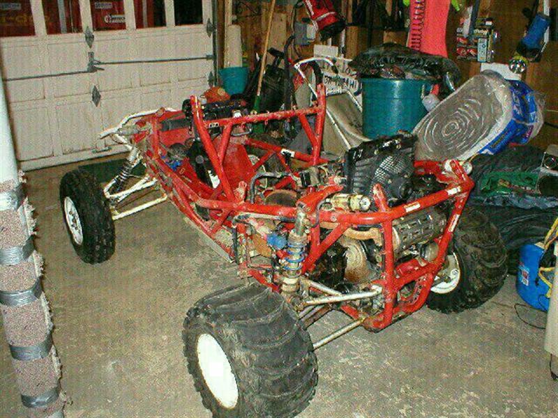

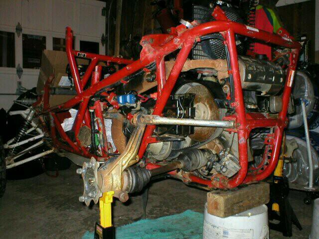

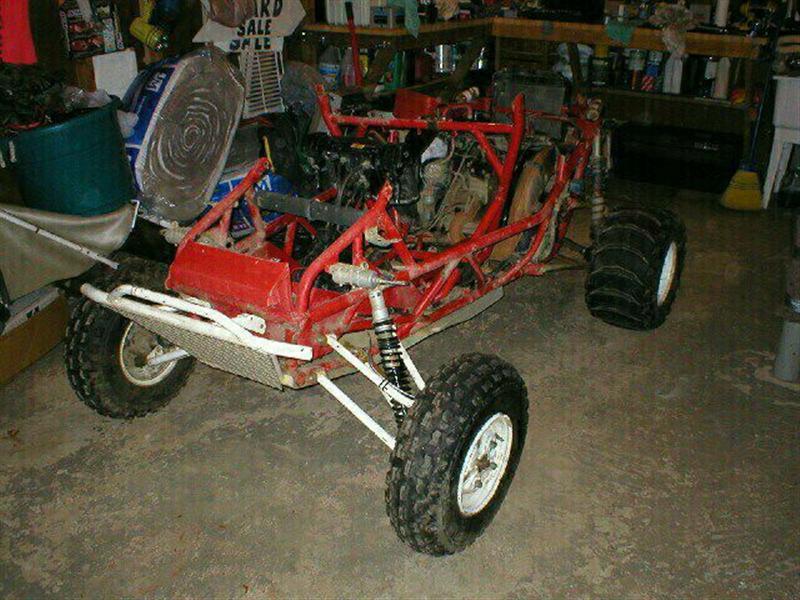

before

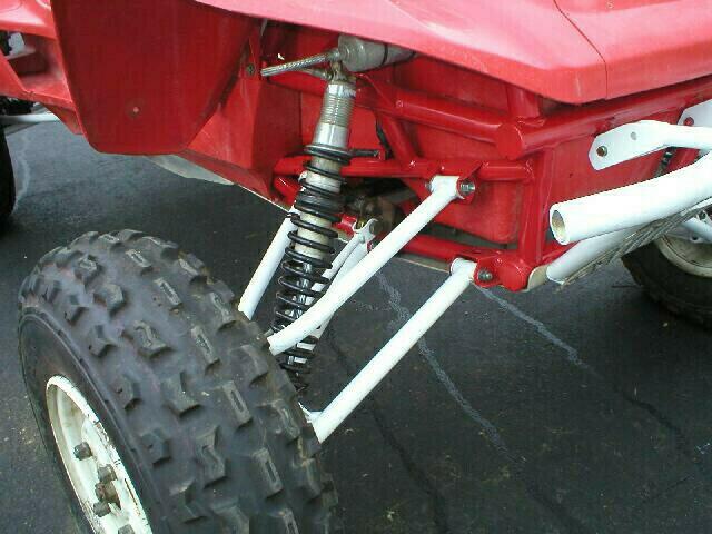

Side Views
