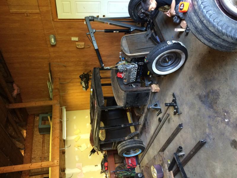

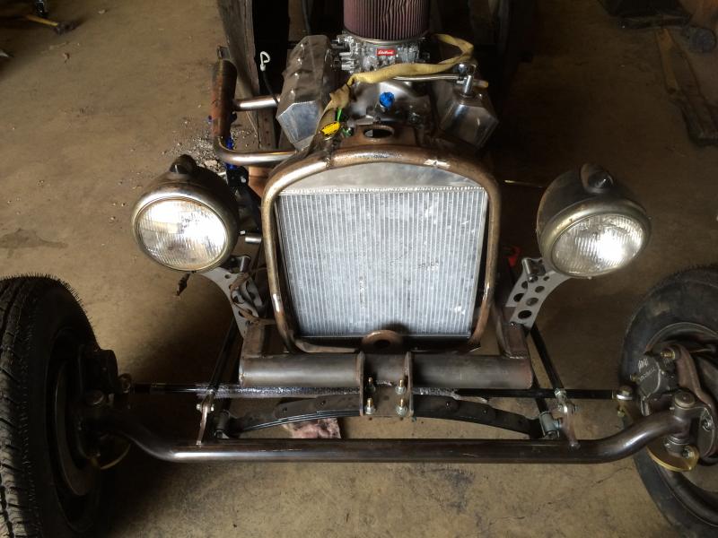

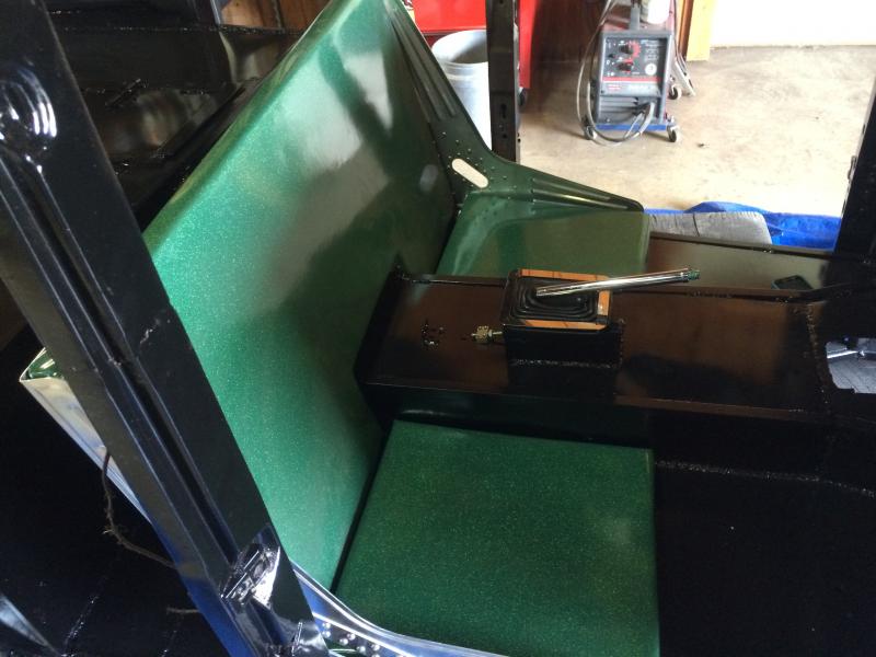

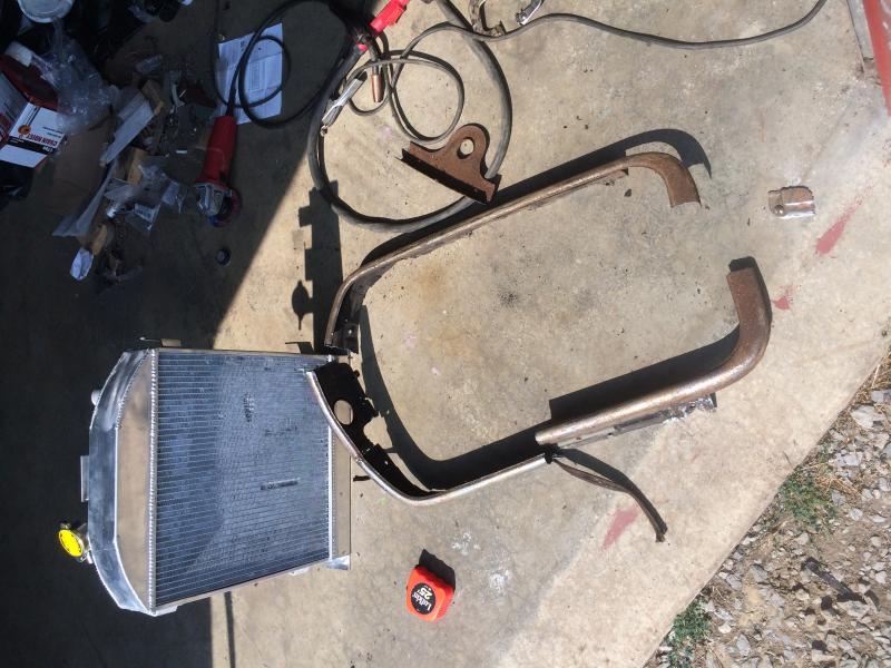

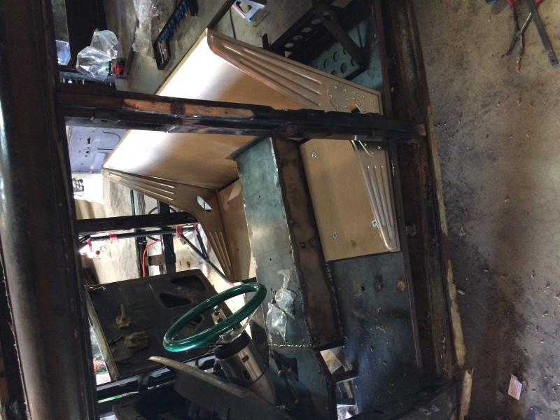

Hey guys, been awhile and life after divorce, custody, etc has been rough but things have settled down finally so I'll show ya what I been up too the last year. With dad as a gear head my whole life, we've restored and drag races cars my whole life, so wanted a project for me and my boy. Well here is it. With some pics from start to finish. Found a complete torn apart 1930 Plymouth 4 door, rot free and perfect for a rat/street rod. Should be finished up this weekend and off for the maiden voyage!! Here's some pics in order of build. 100% new and build from scratch!

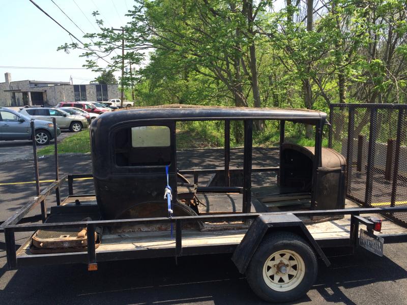

File comment: Day I brought home

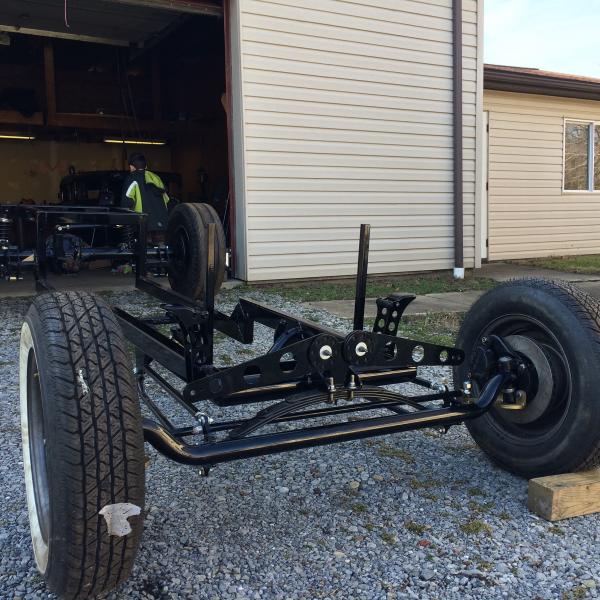

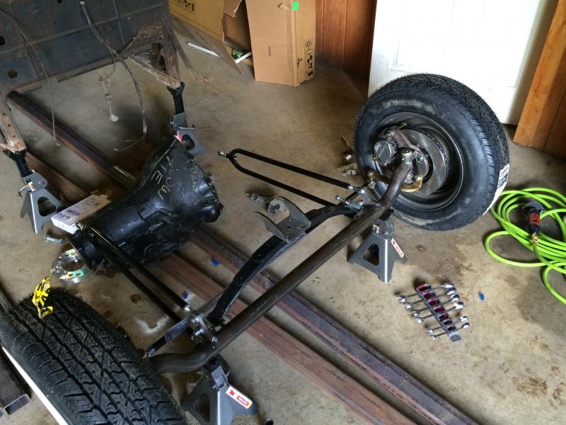

File comment: 4" lowered spring behind front end

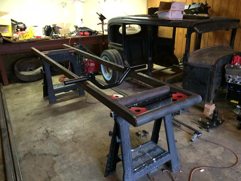

File comment: Starting of frame

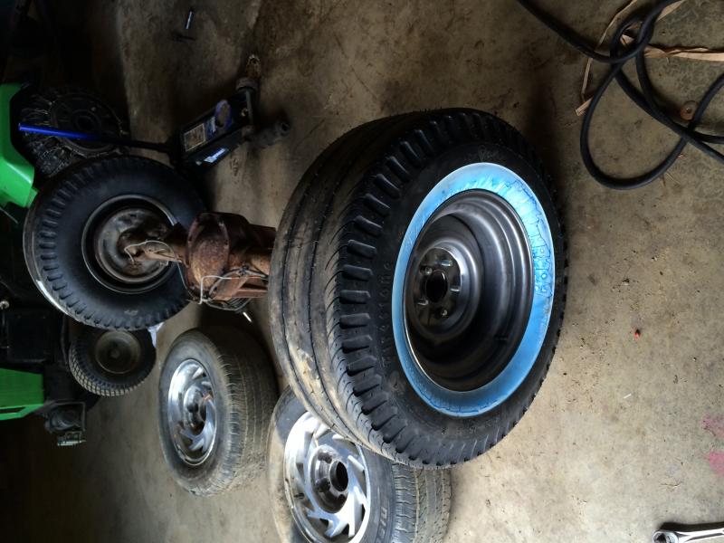

File comment: Widest rear I could find out if ford van 8.8" now posi with 4.11's

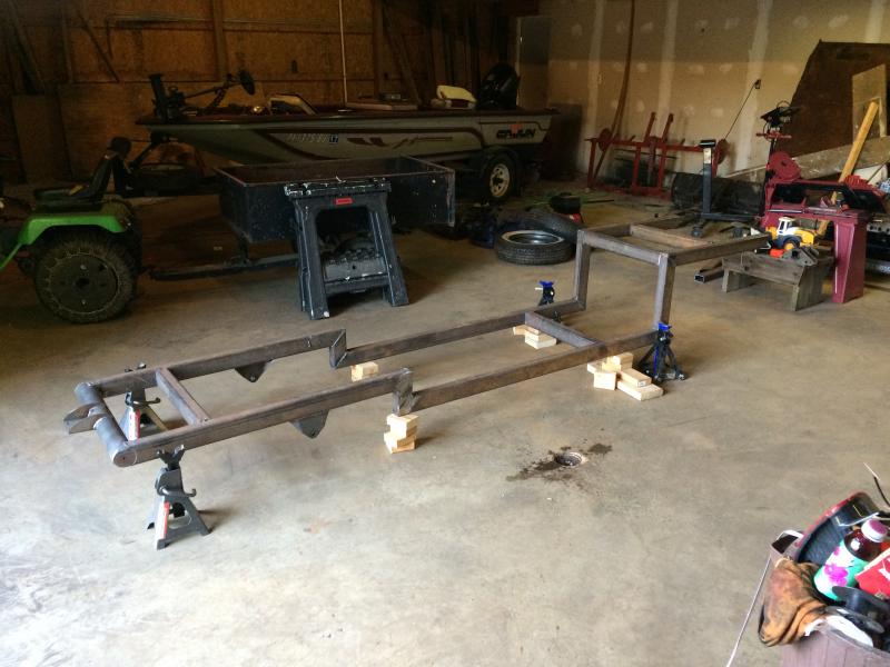

File comment: Frame almost done with 5" z in front and 14" in rear for 4 link

File comment: Mocking body over frame (channeled 4")

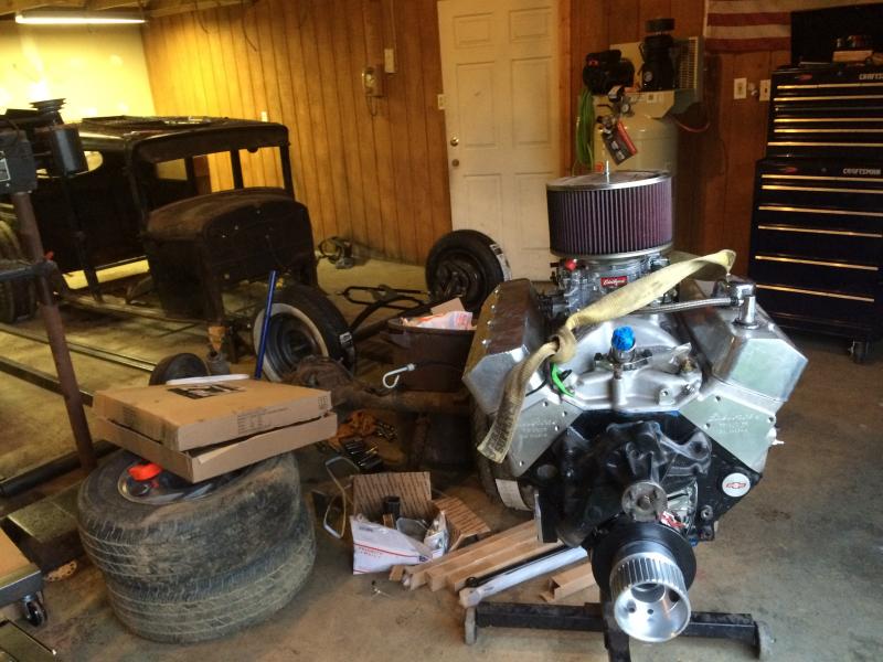

File comment: Ohhhh shit 355 with alumnin heads.....score of craigslist, never fired s d dirt cheap

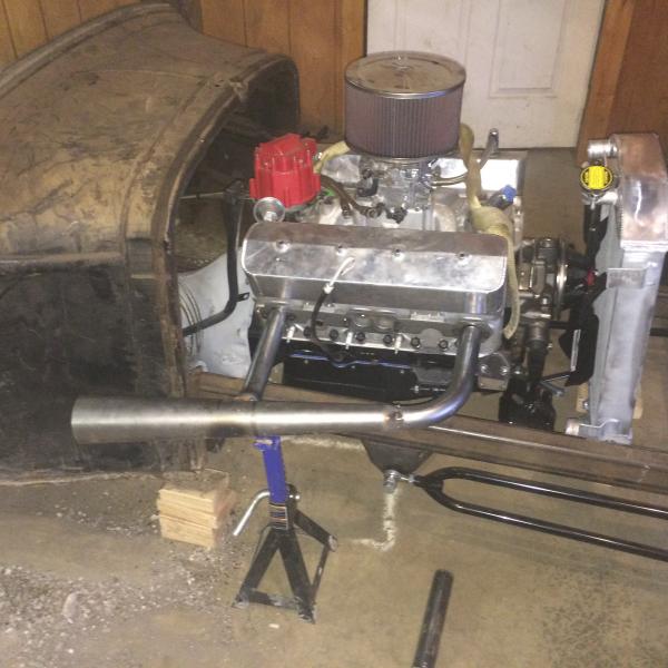

File comment: Building pipes
File comment: Cutting down grill

File comment: Mocked up before chop

File comment: Floor almost done and making of seat

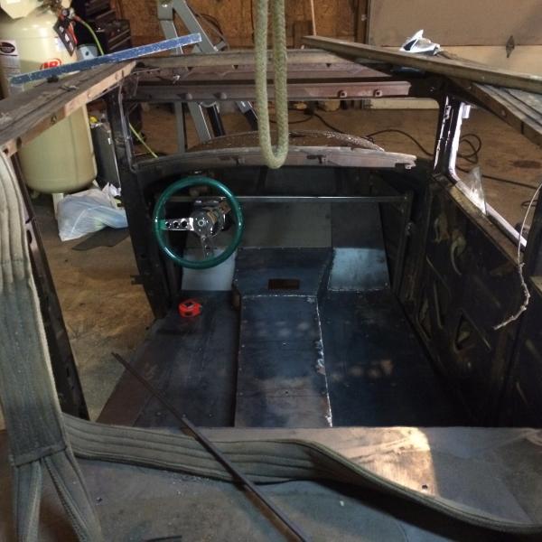

File comment: Floor done and painted, son wanted green sparkles and he got it

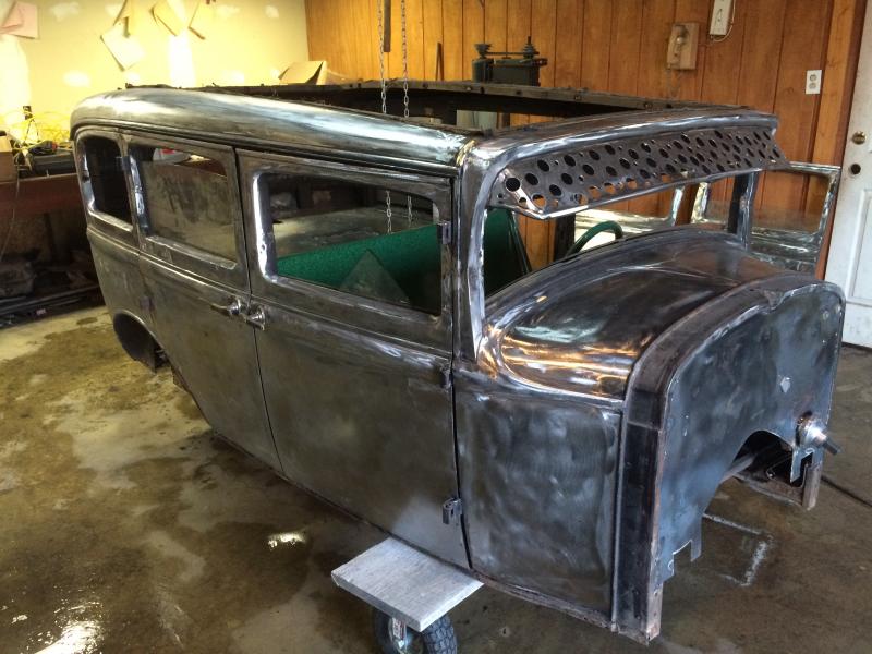

File comment: Roof chopped, Swiss cheesed the visor and bare metal

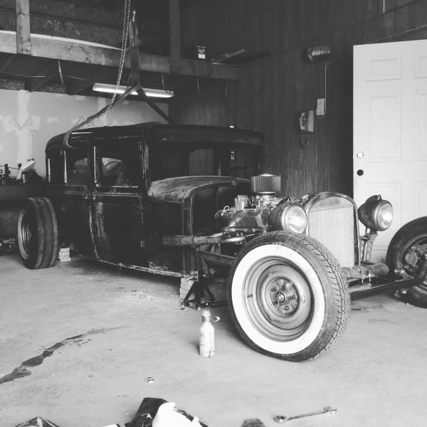

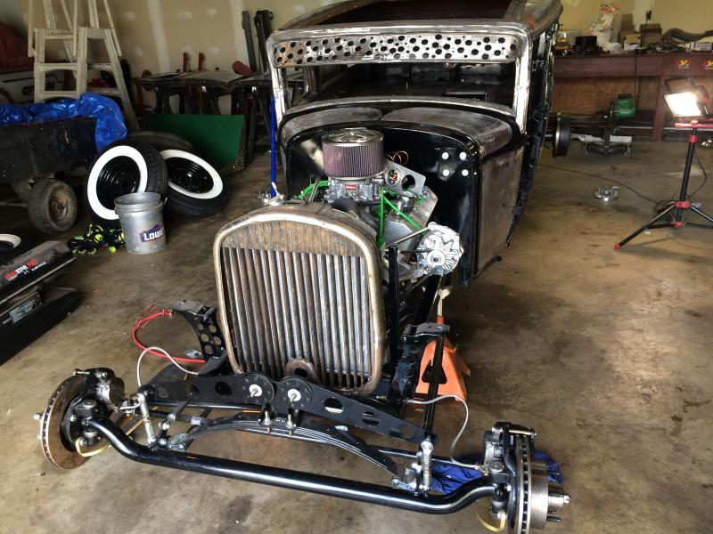

File comment: As it sets today! Wired and ready to roll this weekend hopefully!
