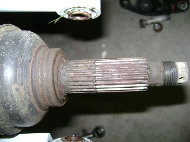

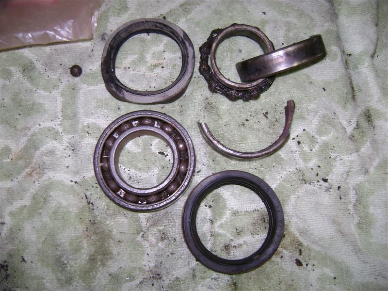

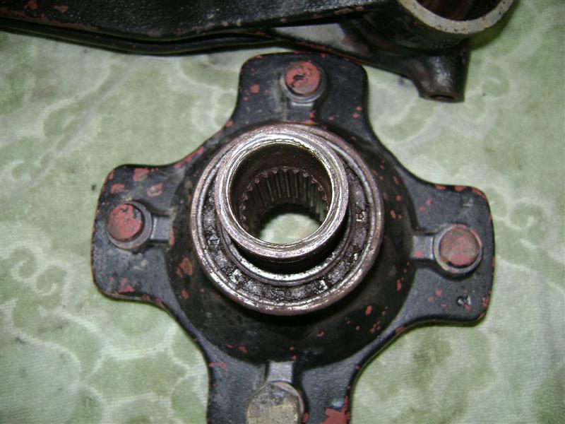

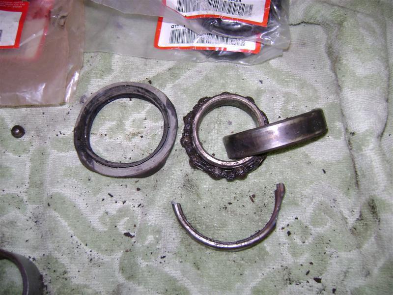

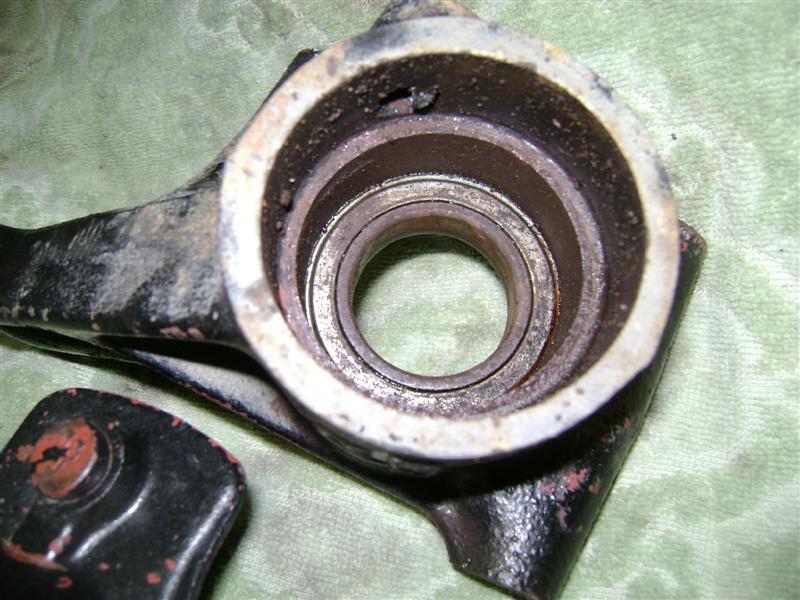

Rear right axle bearings were bad, had to grind one bearing down and break it off the hub it was so rusted on.

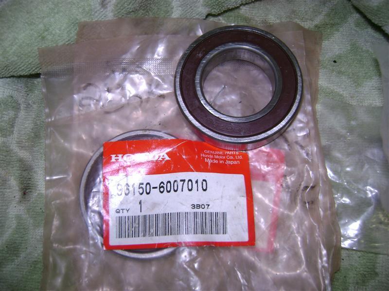

New Honda bearings and seals

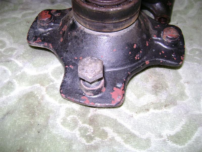

One stud is actually a bolt, I tack welded the head to the hub

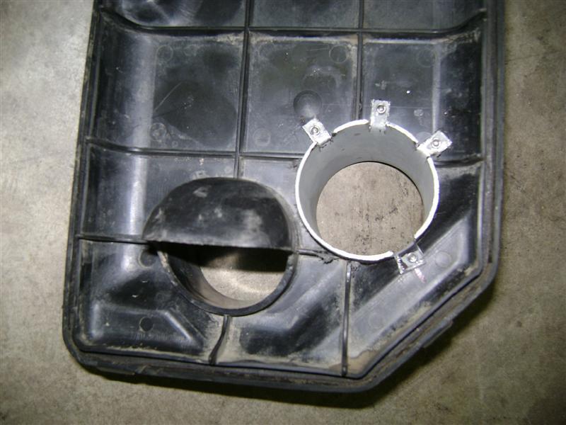

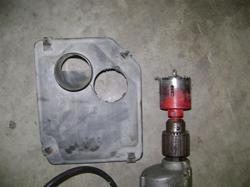

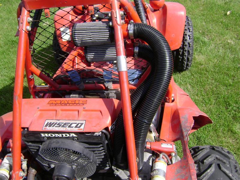

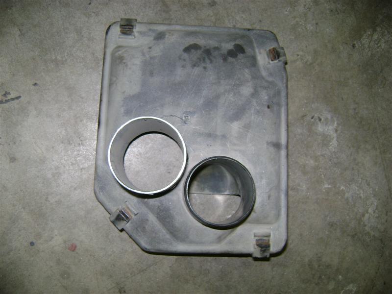

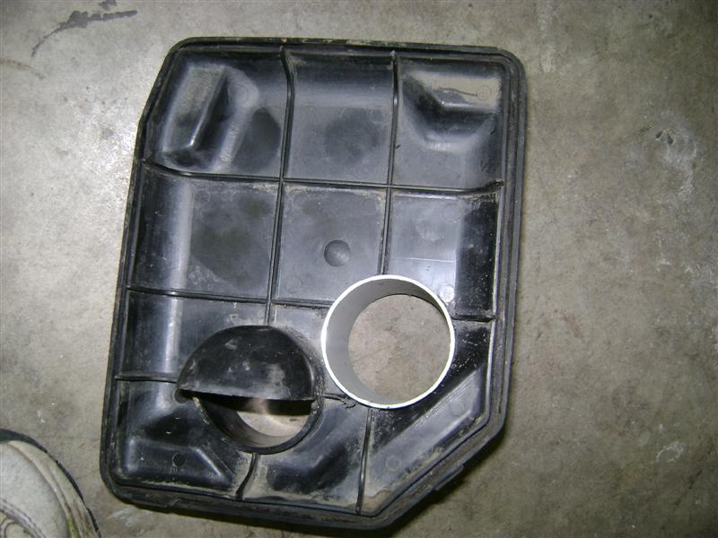

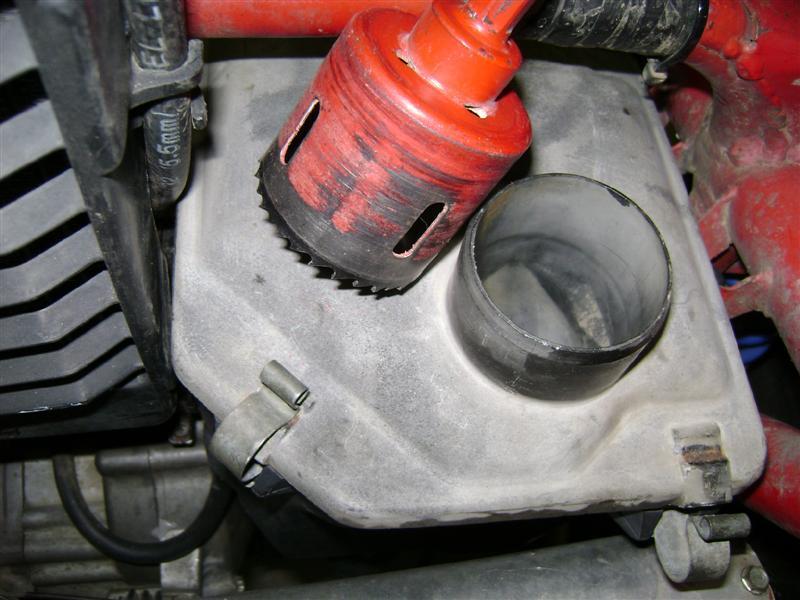

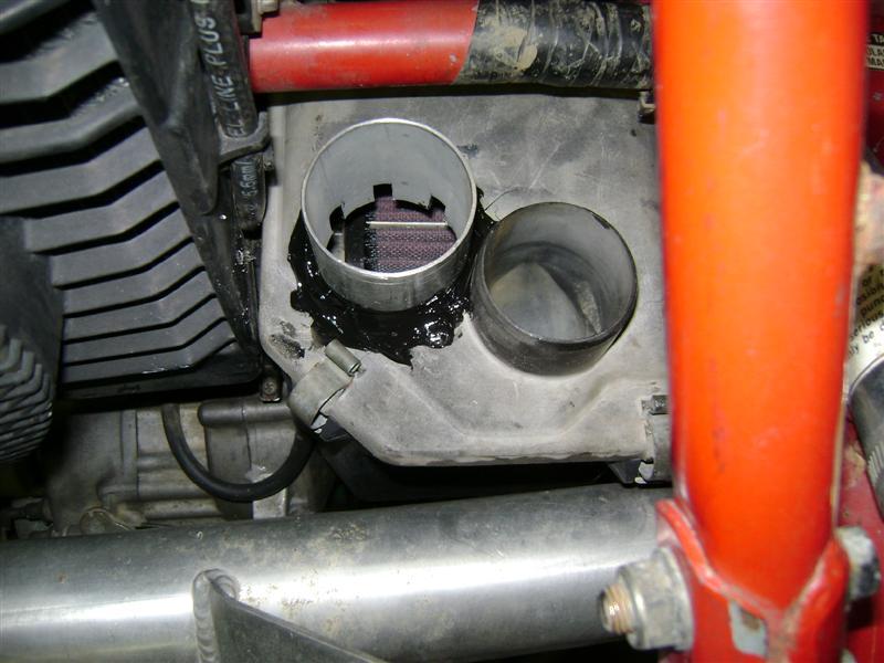

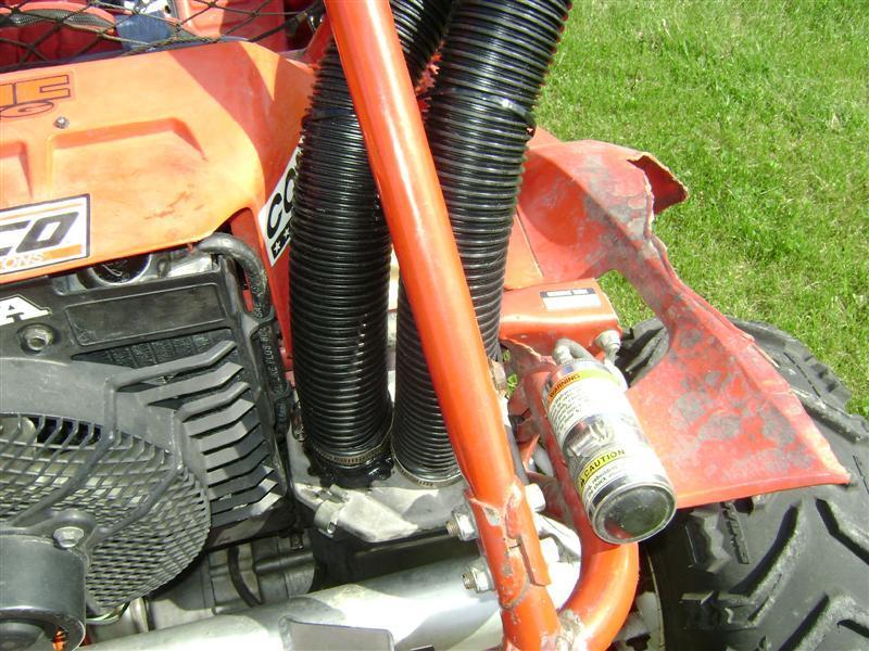

This Pilot is used in nasty dusty trails, coal dust is a killer to combat this it gets hoserized, I installed the dual intake mod and pre filters.

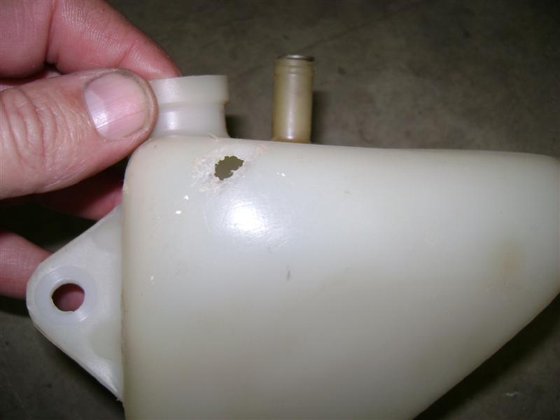

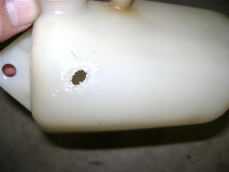

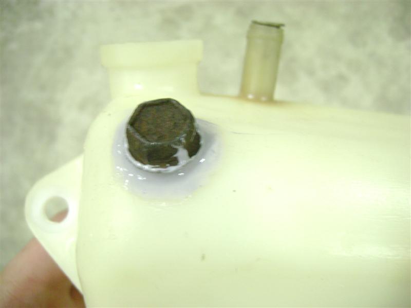

Hare's coolant over flow bottle has a crack in the bottom someone tried to repair it but it leaked out, he never sent a new one but I got a loaner that will get him by, this one has a hole on top, a mouse tried to chew through, I took a 5/16 bolt and some yamabond and threaded it into the hole by hand, its not under pressure so it will hold and seal the only time it will be in contact with coolant will be from it splashing, under normal riding it will not be a problem if he rolls over it might weep a few drops out? Doubt it the bolt threaded in tight and it seems to be sealed.
I still see a K&N filter in the airbox??? Lower pic'????
PostPosted: Wed May 06, 2009 1:03 pm
Yup sure do, cleaned, oiled, only used around the grass yard, pretty much no dirt can ride without glasses or goggles air is so clean, riding by myself so their is no chance of dust from the guy in front of me, don't worry it will be w UNI foam filter and their will be pre filters installed before it sees 1/2 gallon of gas used :-) the filter in the box will be used as a pre filter on another project so it will no longer harm engines.

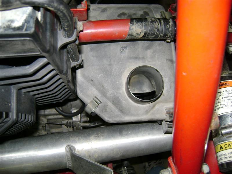

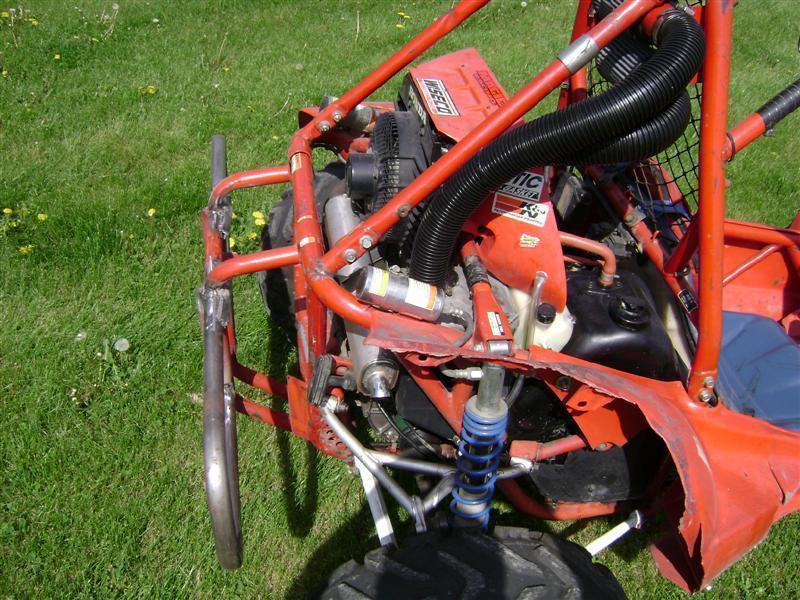

Went to homedepot looking for the vac cleaner hose they didnt have the size I needed so went to menards and I found some hose that fits nice for 18 bux its 8' long MADE IN THE USA
You should never see any more filters looking like this in the air box....

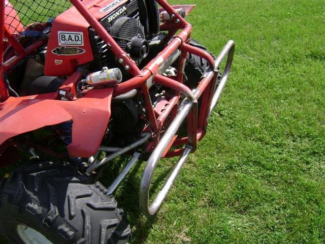

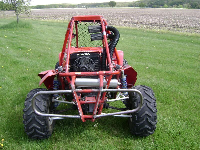

Found one of my old rear bumpers and rebuilt it again this sucker has been rebuilt 4-5 times and is well tested, its ugly but will work perfectly for GNCC bashing you wont even flinch when someone runs into it and bends it up lol it looks rough mainly because I set a 2 hr time limit on the bumper project, that includes going into the attic looking for it all repairs and painting lol

Hoser is the rear bumper to wide? meaning will it rub the tire if it gets bent in or is it just a optical illusion from the pic?

Dunno Joe can decide that when he sees it in person, I would take care of the ramming thing at the riders meeting and make sure all the UTV guys understand if their was ramming I would put the Pilot sideways in the trail blocking the trail so they could not get by then get out of the Pilot and take care of the guy that was ramming me, their is NO NEED or NO EXCUSE for ANYBODY to be ramming others, their is no need for even slight bumping or "rubbing" to let another know you want to pass they make HORNS just for this.
