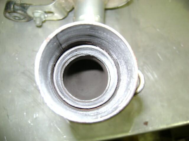

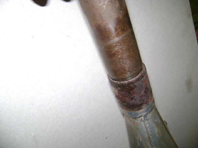

You see the inside of your silencer where the pipe connects?
Its a huge restriction.
Search words pipe fix, pipe porting
PostPosted: Sat Sep 01, 2007 2:43 pm

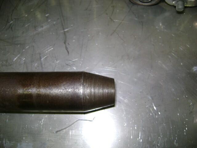

I was going to cut a taper on my lathe to flare it out but the belt busted so in my search around the shop I found my home made clutch alinement tool that has a taper and used it and a hammer to flare out your pipe.
The pics suck and don't really show the problem and the fix well when you get the pipe back you will see what I mean.

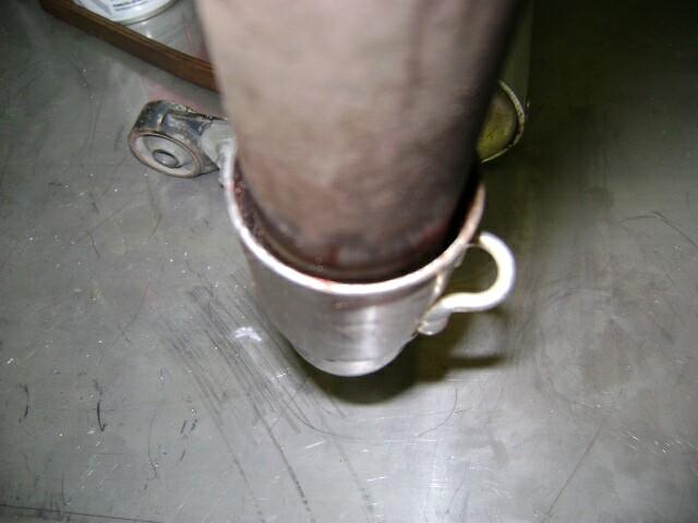

PostPosted: Sat Sep 01, 2007 2:44 pm
Here it is sticking in the male part of the pipe its almost big enough I wish it was a little bigger.
PostPosted: Sat Sep 01, 2007 2:45 pm

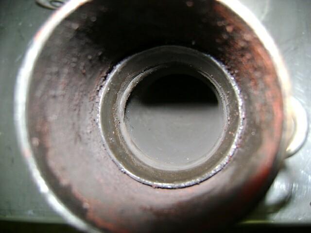

Inside the silencer where it needs flared out.
PostPosted: Sat Sep 01, 2007 2:47 pm
Flared out, now it will flow as intended, this is why some run a little better than others I wish the pipe builder would do better .

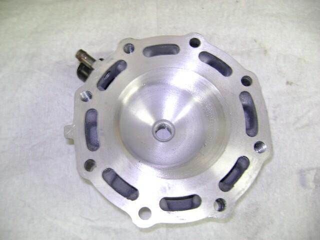

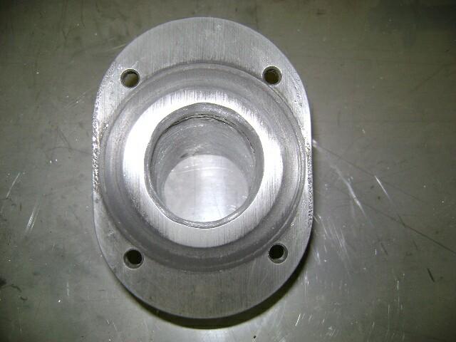

I shipped all your parts back, you need to clean all the parts before installing, I put a light coat of oil on the cylinder wall.
I remove all the cylinder studs and lapped the top of the cylinder, reinstalled the studs, I repaired the damage to the head by machining.
I installed a new exhaust manifold gasket and tighten up the bolts you will not need to change the gasket, I bolted the reed cage back on and snug the bolts I was not sure what your going to do, replace the cage or just the reed petals, I would upgrade to another reed cage rather than install new reed petals on the old cage..
The head is installed without a gasket and the nuts just snug for shipping.
The cylinder was bored and honed to fit the piston you sent.

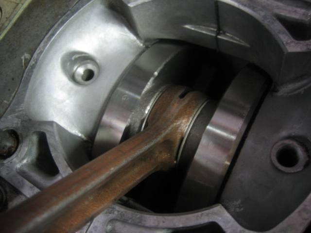

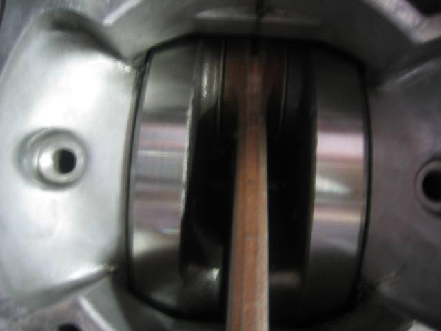

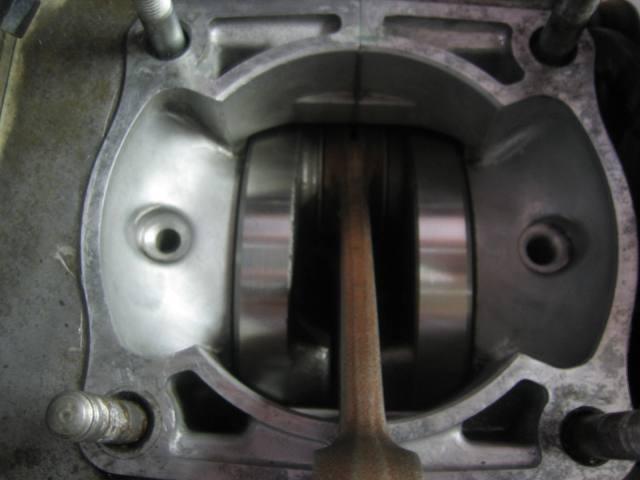

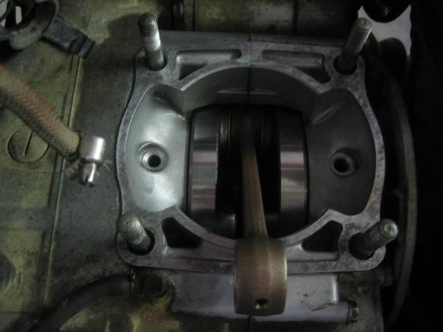

PostPosted: Sun Sep 02, 2007 4:53 pm
Can you take some detial pics of your bottom end in its current condition?
PostPosted: Mon Sep 03, 2007 9:18 am
Posts: 631
Location: Fredon,NJ
yes - I was planning on doin the rag thing today and draining out the case oil to inspect it.
I will take the pics when doin that.
PostPosted: Mon Sep 03, 2007 6:21 pm
Posts: 631
Location: Fredon,NJ
I drained the oil - looks good - no particals - also sweeped through a cloth and found nothing.
Here are pics of how it is currently.,

PostPosted: Mon Sep 03, 2007 7:26 pm
You have the cylinder nuts?
