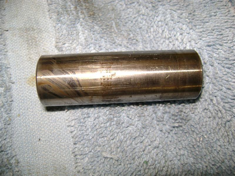

PostPosted: Sat Apr 19, 2008 4:34 pm
Wrist pin is RUSTED :shock:
More on this CSI later as I take the bottom end apart.

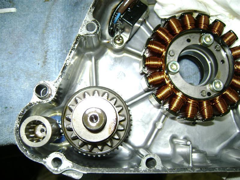

PostPosted: Sun Apr 20, 2008 3:49 pm
Removing the side cover is the first step in splitting the cases, I don't get it, they didnt scrape all the old gasket off before assembling.

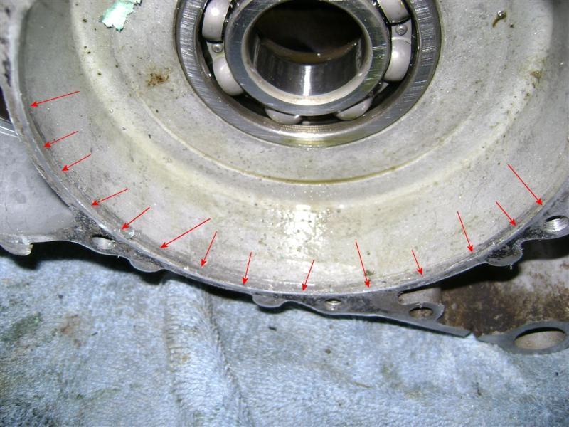

PostPosted: Sun Apr 20, 2008 3:58 pm

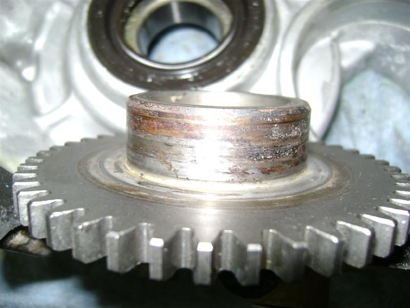

PostPosted: Sun Apr 20, 2008 3:59 pm
Here is with the grease washed off, I will have to polish this up to see if it can even be reused looks like their is too much pitting on the seal surface for it to ever seal.
How could you in your right mind pick up that rusted part as you see in the pics GREASE and INSTALL it ? What was the intentions here?

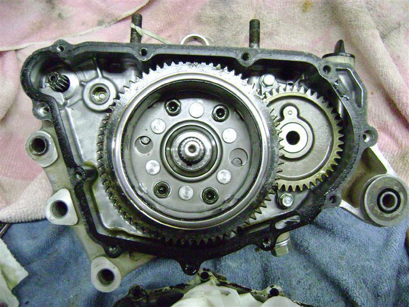

PostPosted: Sun Apr 20, 2008 4:13 pm
Here is the case with the OLD gasket completely REMOVED then files then lapped, it came out nice their is one spot that is still slightly low between the arrows, I will wait until I press out the crank shaft from the other case (tomorrow) then clean off the OLD gasket and give it a quick lapping, once that is done I can bolt the cases together and see how they mate up together.

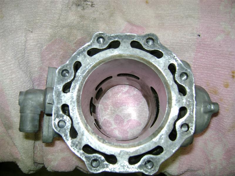

the piston to cylinder clearance measures .0038 its a little tight for a wiseco, I been told to set them at .0045
Their is a bunch of scratches on the cylinder wall no doubt damage from the last piston failure, I am only worried about the scratches above the exhaust port since that is where the rings seal, their is only 2 scratches you can even feel with the finger nail, I will hone the cylinder out to .0045 and see if they go away.
