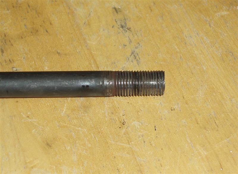

The head of the clutch bolt is a bit recessed. I had to use a C clamp to get at it. The bolt didn't come out very easily. I thought the threads may have been damaged but, they look okay.

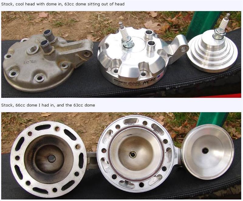

Have you thought about using a cool Head?
http://cgi.ebay.com/ebaymotors/Honda-CR ... tsupported

I've thought about it. But... What do I do about the two coolant inlets? My head only has one.

I cleaned-up the bolt and put a good light on it. The threads are flattened off. I'll have to look for a replacement.

We used a 5/8 heater hose T and springs that we got from a local parts store you can see the results on this post.
http://pilotodyssey.com/PO/viewtopic.ph ... c&start=60

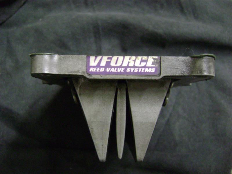

PostPosted: Sun Jun 07, 2009 5:45 pm

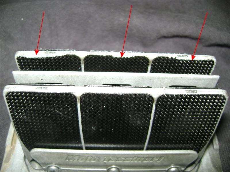

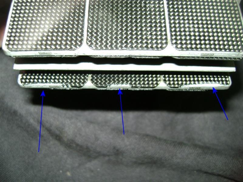

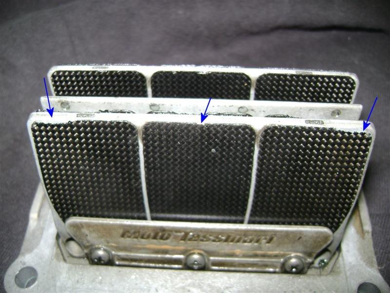

Add reed petals to your list, actually I will go back and add it for you.
The reed petals are toast. vforce bad reeds
Looks like the first generation Vforce cage?

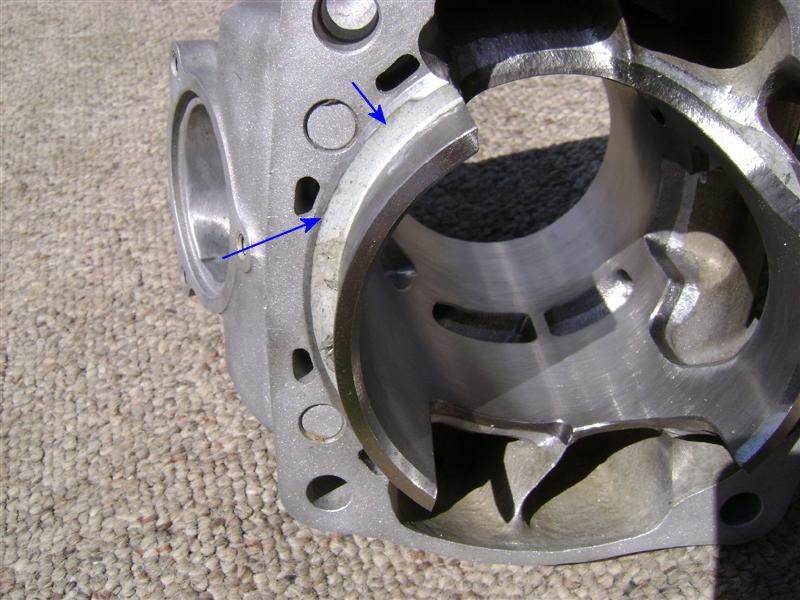

PostPosted: Sun Jun 07, 2009 5:47 pm

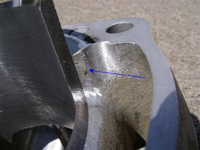

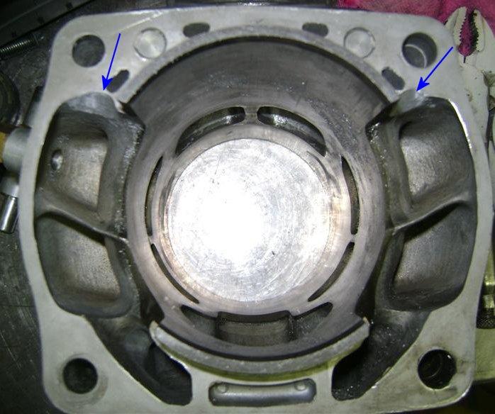

Your cylinder to crank case matching has the same problem Afastcars CR500 had, I will match it up for you .
ATVR porting miss match

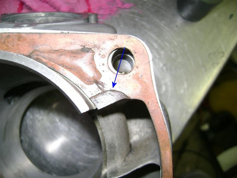

PostPosted: Sun Jun 07, 2009 5:49 pm
Its hard to believe they could miss this when you look at the old gasket their is a huge red flag, you can see the impression in the gasket showing things don't match.
Never heard anything bad about LA Sleeve installations let me know where to ship..

I'm thinking about the Cool Head more and more.
I hijacked the attached pictures from another message board.
I wonder how much compression I'll get with the 63cc dome?

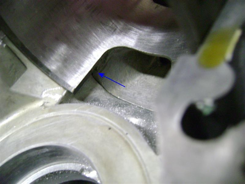

PostPosted: Fri Jul 17, 2009 12:08 pm

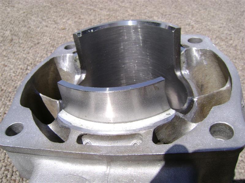

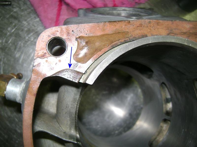

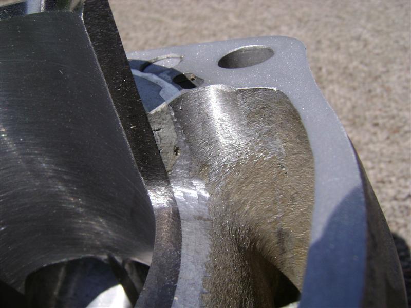

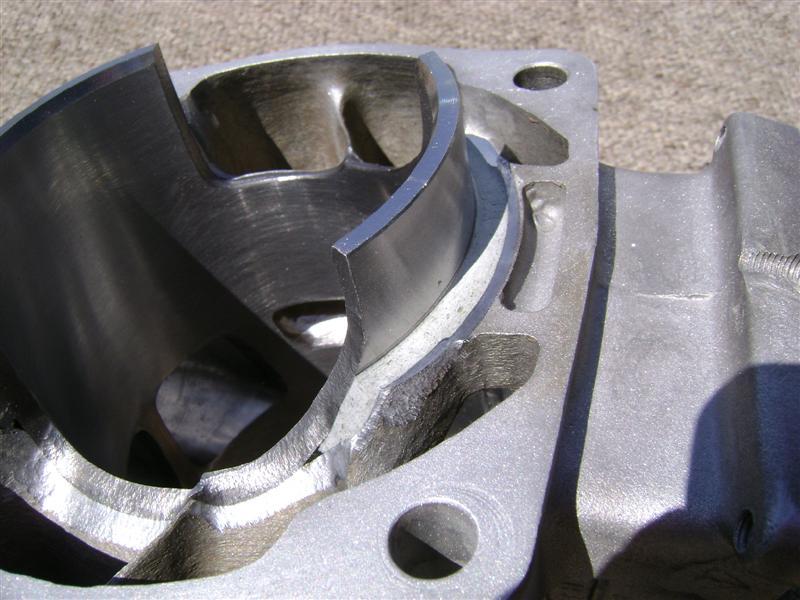

Your Engine is rebuilt and done except for installing the head reed cage and intake.
The cylinder is back from the sleeve guy and looks good, they did some epoxy work on the bottom of the sleeve and I am not sure why, was their a snafu when they machined the old cylinder out or was it done intentionally so they could lock the sleeve in the cylinder so it cant move, I guess you would (and should) call and ask them.
The exhaust bridge was relieved by the sleeve guy but the lube holes were not drilled so I located and drilled them for you.
PostPosted: Fri Jul 17, 2009 12:12 pm
I put some blue arrows where the epoxy filler is.

Thanks Hoser!
I called Northwest sleeve. They said that it's normal to have a gap between the bottom of the sleeve and the cylinder for CR500s, Banshees, and a few others. Supposedly, the epoxy is there for purely cosmetic reasons. The lady I spoke with mentioned that some of their competitors don't even bother fill the space with epoxy. They do it simply because it "looks better". She promised me that if anything had gone wrong with the machining process, I would have received a phone call.
Sounds good I am glad you called them.
