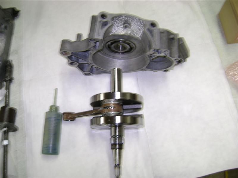

PostPosted: Sun Jan 13, 2008 6:26 pm

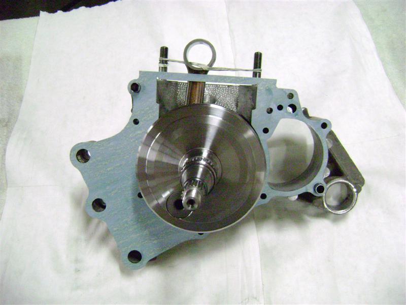

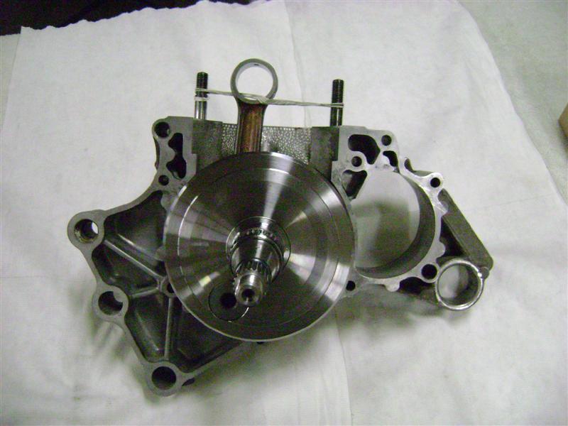

New crank gets washed before oiled and installed, all new cranks are nasty dirty even though they are new.

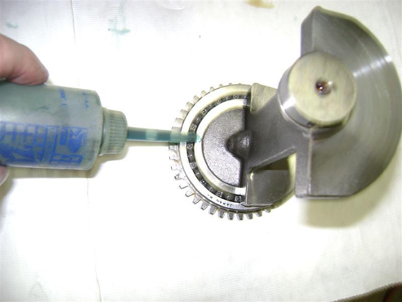

Everything gets oiled before and during assembly.

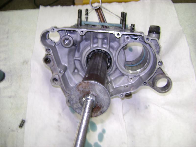

PostPosted: Sun Jan 13, 2008 6:29 pm

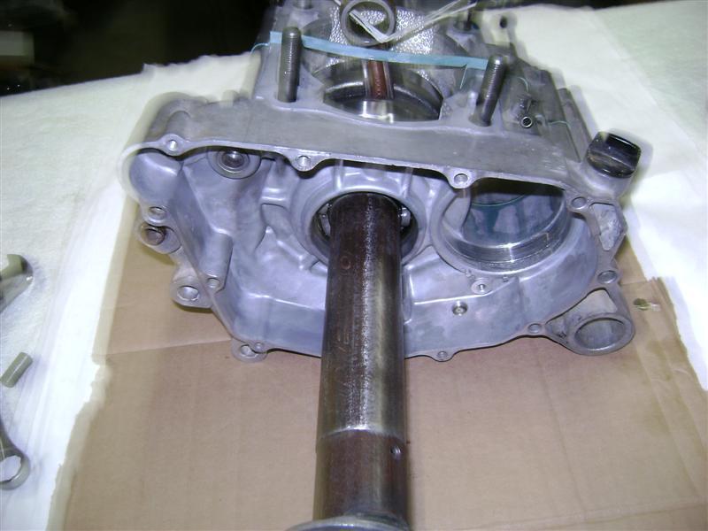

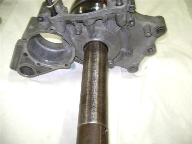

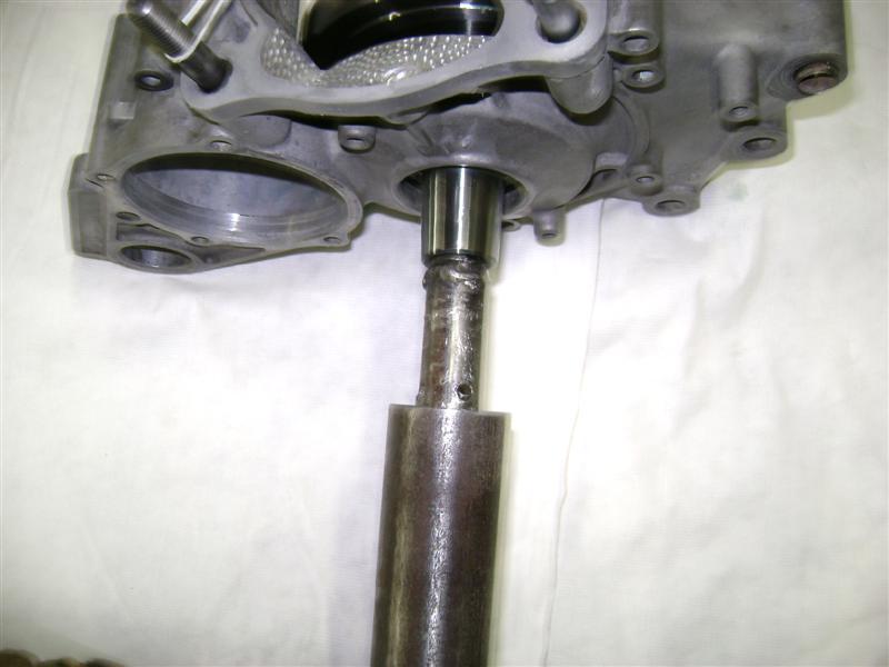

Once the puller is assembled and ready to pull the crank into the bearing the crank is oiled so no galling can occur.

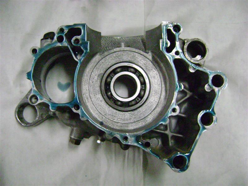

PostPosted: Sun Jan 13, 2008 6:30 pm

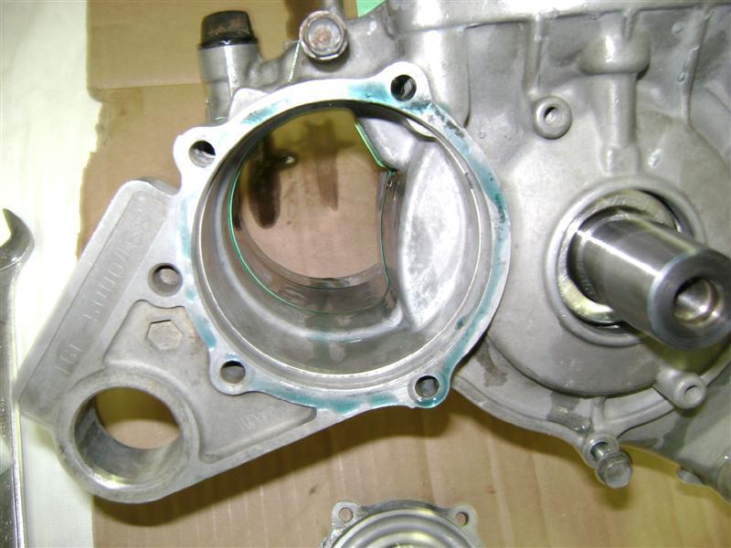

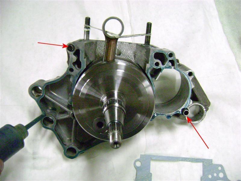

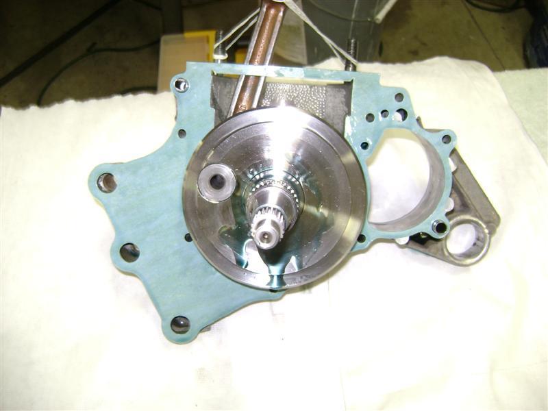

Once the crank is pulled into the clutch side of the crank case its time to prep the gasket and install the dowel pins

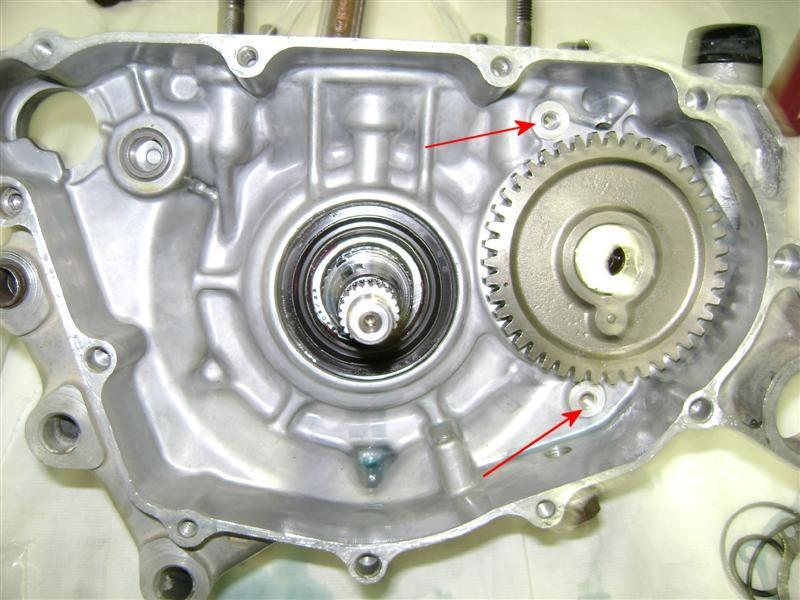

PostPosted: Sun Jan 13, 2008 6:32 pm
See the two dowel pins?
I first install them then take 2 stroke oil and coat the cases

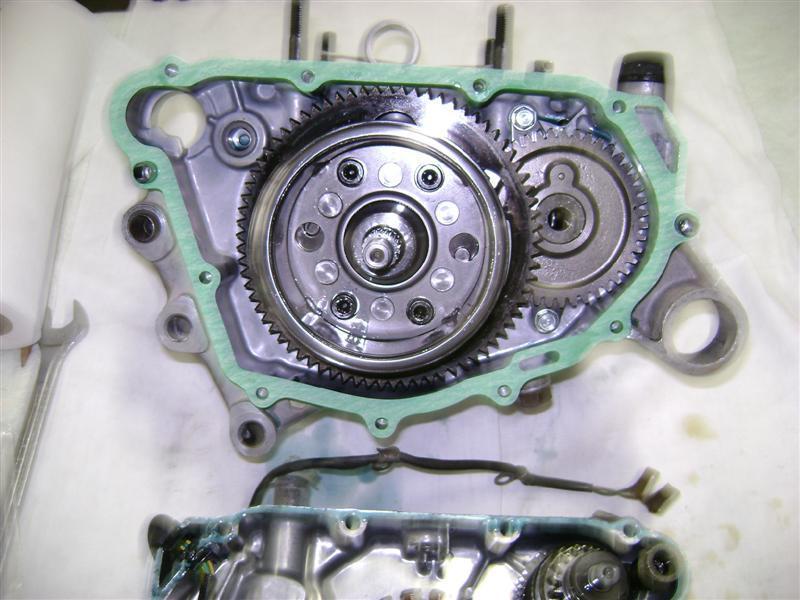

PostPosted: Sun Jan 13, 2008 6:33 pm
Once oiled install the gasket into the oil
PostPosted: Sun Jan 13, 2008 6:34 pm
Then oil the gasket surface on the other case.
PostPosted: Sun Jan 13, 2008 6:35 pm
Take the gasket off the other case and lay it in the oil

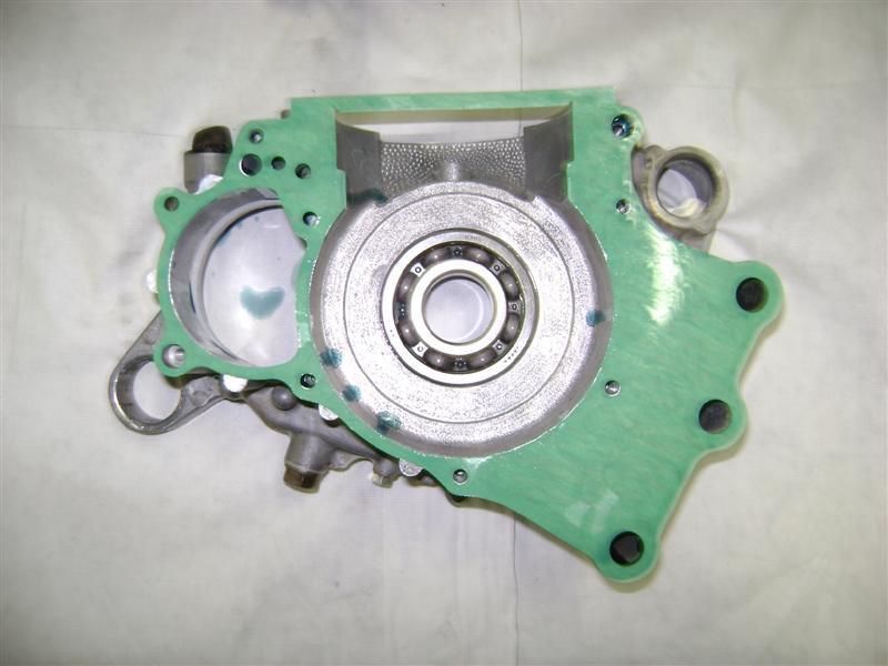

The flip side, use your fingers make sure both sides of the gasket is well oiled.
PostPosted: Sun Jan 13, 2008 6:37 pm

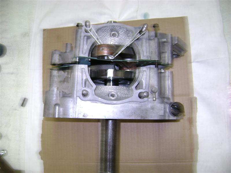

Put the gasket back on the dowels now its well oiled on both sides and the gasket surfaces are well oiled its time to install the other case.

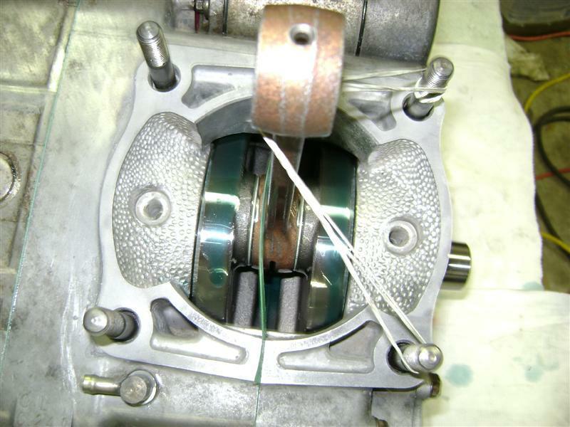

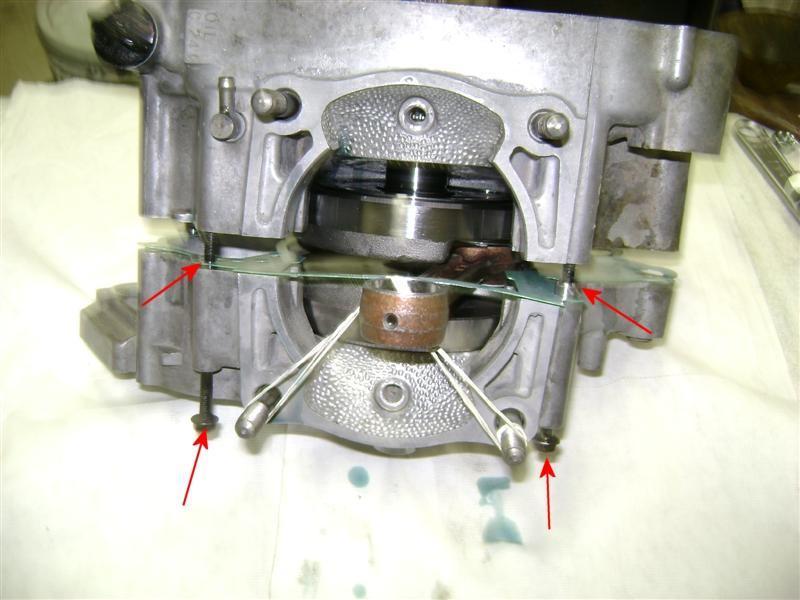

PostPosted: Sun Jan 13, 2008 6:39 pm

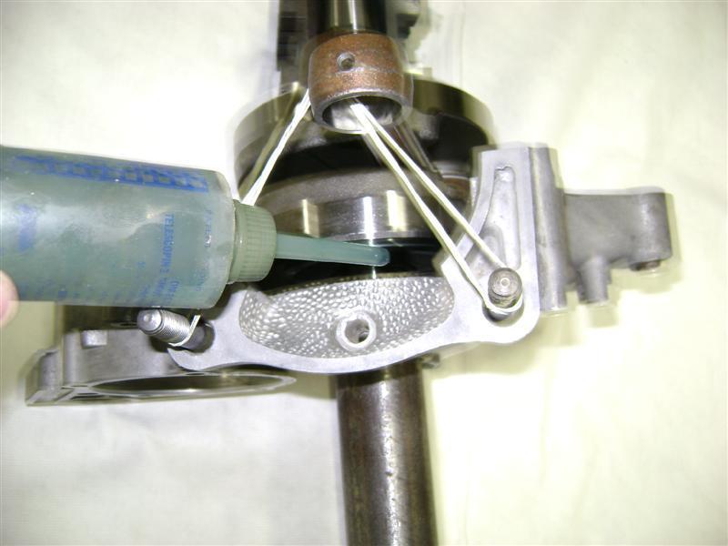

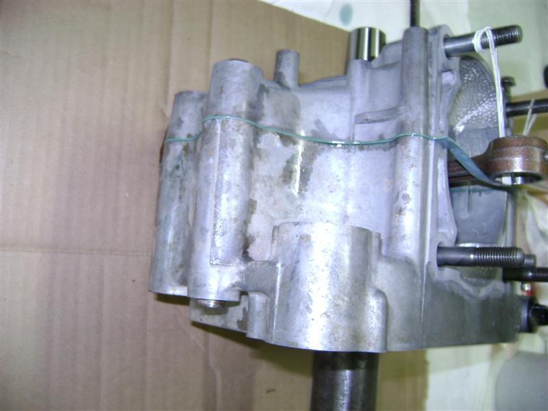

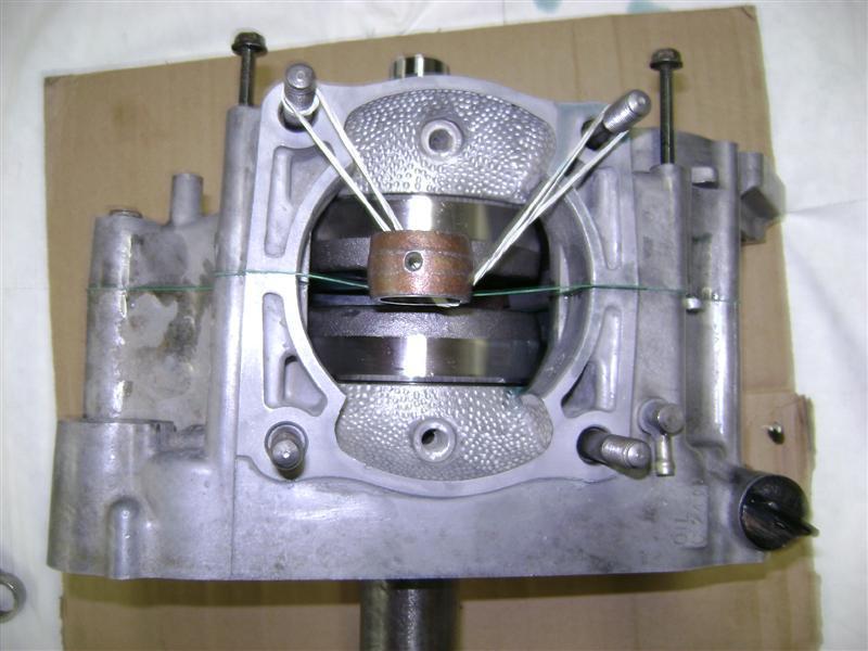

Slide the other case on a little ways gravity will work against you here and the case will self level like seen in the pics, I use TWO of the longest case screws to hold the cases and line them up whilst using the case puller to pull the crank in the bearing, sorta like the rubber bands keep the rod in place.

PostPosted: Sun Jan 13, 2008 6:40 pm
Ready to install the crank puller.

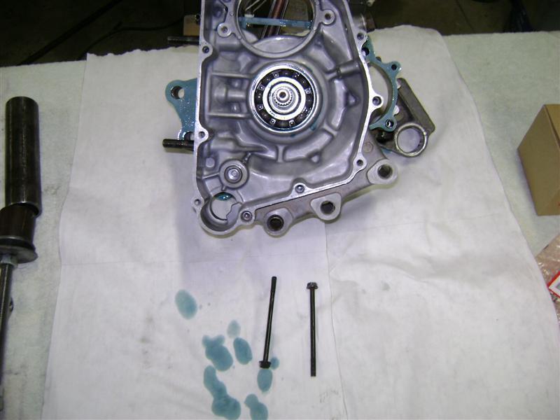

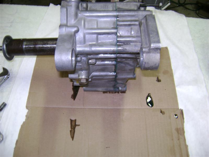

PostPosted: Sun Jan 13, 2008 6:45 pm
Pulled together.
NEVER even think of trying to pull the cases together using the case bolts, if you did your putting thrust loads on the balls of the bearings damaging them AGAIN the TWO bolts you seen in the pics were only to help line up the cases until they were close enough together the dowel pins took over and lined up the cases.
When using 2 of the long bolts their is not even and reason for the heads of the bolts to touch the cases.

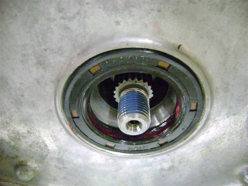

The seal behind the recoil is greased before installing, the end of the crank gets thread locker so the nut cant fall off.
