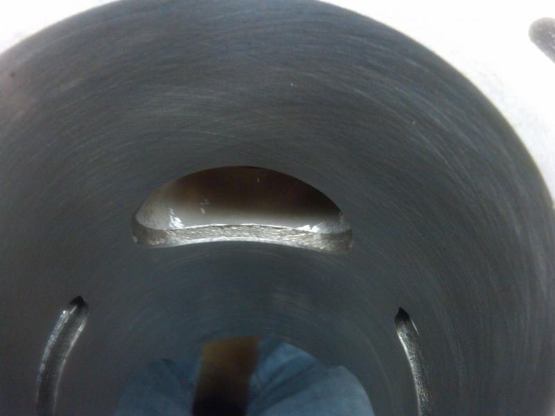

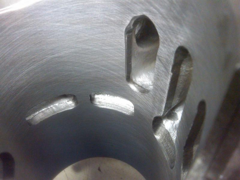

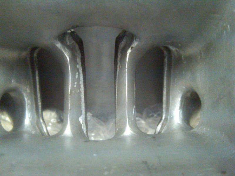

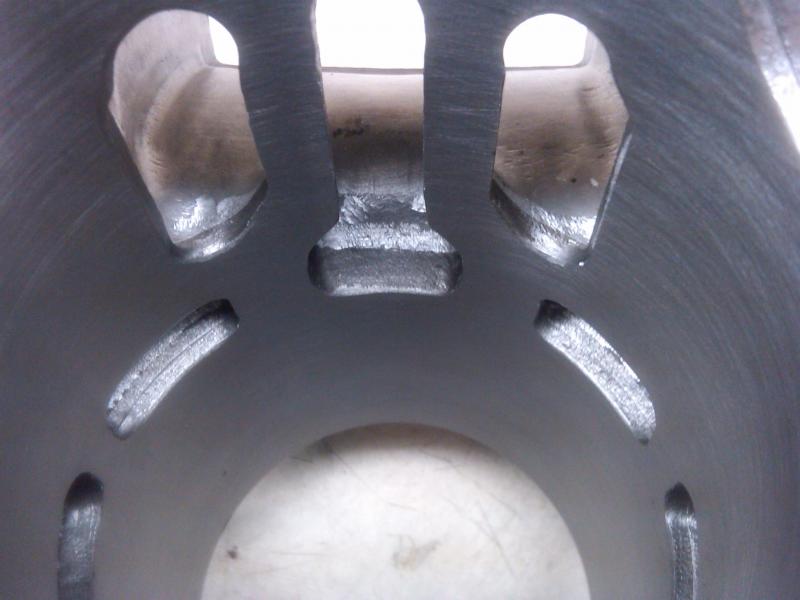

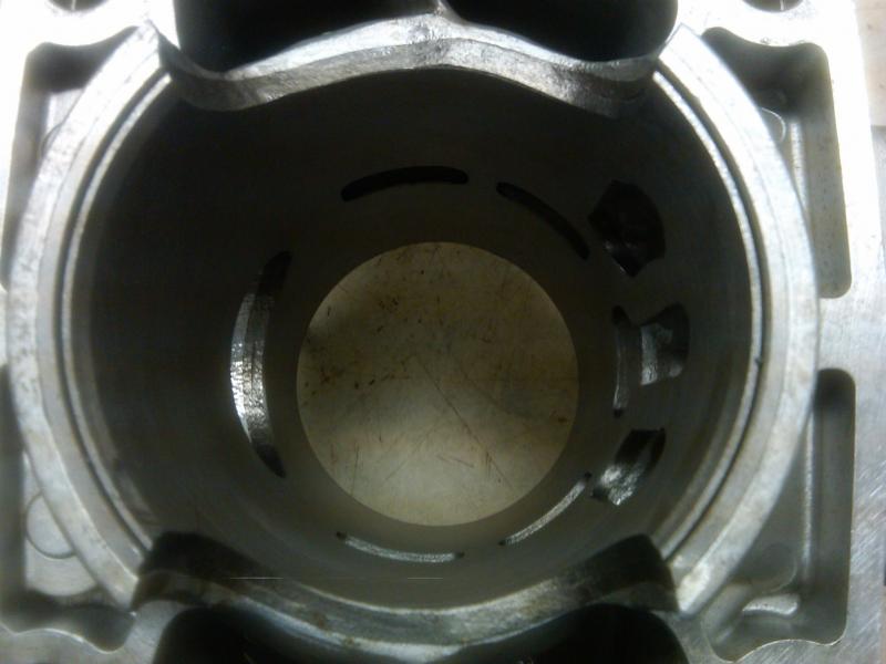

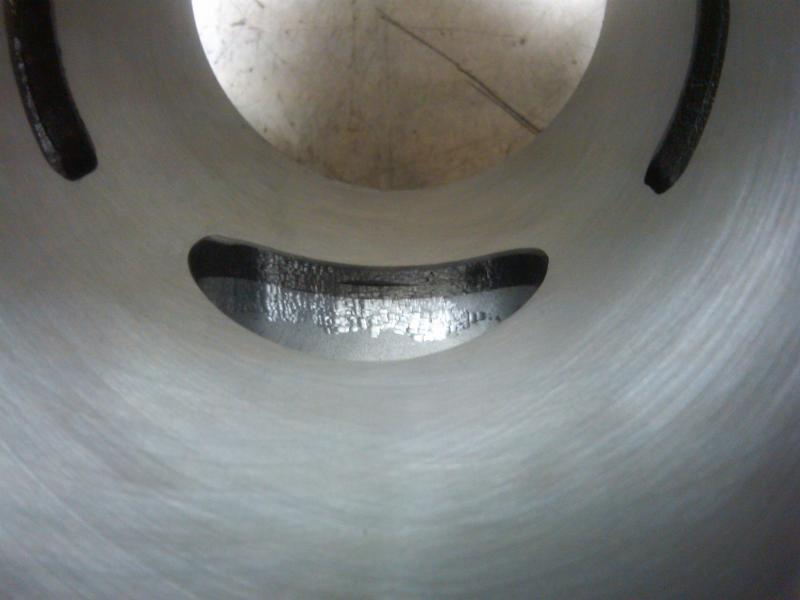

Here you go ADNOH. Fresh LA SLEEVE 80MM with piston kit. Now, in the pictures you see on the intake side the sleeve needs to be cleaned up to match existing porting. How do you personally perform this task? Dremel with what grade bit?

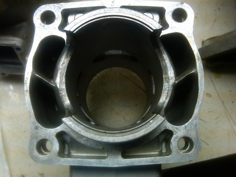

PostPosted: Sun Mar 11, 2012 8:08 pm
More pictures:

PostPosted: Sun Mar 11, 2012 10:03 pm
Thanks for the pics. I use an air gridder with poritng bit.I post up a pic when I get back to the garage. Heres a pic of a Ex port on a cylinder I just altered today. Just started on the intake. post ya some pics when I get done.

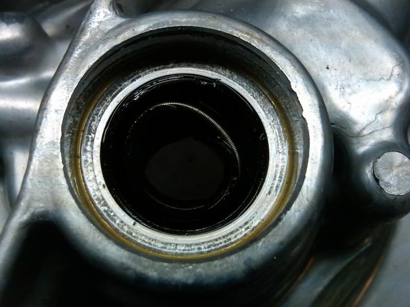

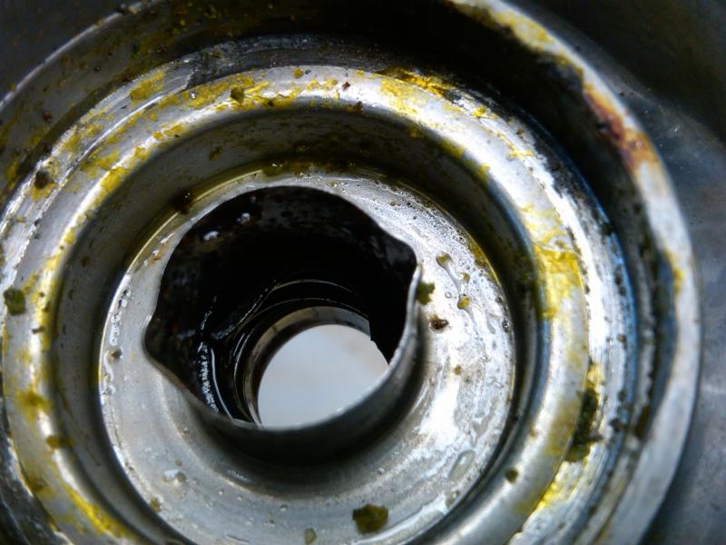

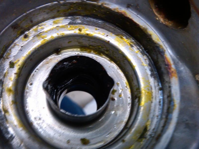

Went into the water pump side case tonight to just double check everything. After a close look I discovered the water pump impellar shaft seal appeared to be leaking. Also noticed the fins on the impellar were not in good shape as well. After removal of the water pump impellar, shaft I was correct in my discovery, there was damage to the shafts seal on the oil side of the case. My worry now is that this seal is discontinued. I'll post some pictures later tonight. I think I might have an alternative seal as this seal I removed looks identical to my Tecate impellar shaft seal for a 85 T-3 Tecate 3 wheeler Engine. More to come.
EDIT: More detailed FL400 Pilot water pump info found here viewtopic.php?f=1&t=8912

File comment: Are these seals still available?

File comment: Here is good view of damaged seal. I did not do this during the bearing removal.

PostPosted: Thu May 03, 2012 9:33 pm
Service Honda order to be placed:
19217-PA5-000 Nut
19215-KA30710 Impeller
90201-413-000 Nut
90441-KA4-000 Washer
90454-KA4-003 Bearing
91201-148-003 Oil Seal
I am ordered 2 of each for stock, etc.
UPDATE everything still available but the impellar from Honda. I oredered 2 of everything listed and will look into ADNOH's advice in regards to a new impellar
PostPosted: Thu May 03, 2012 10:10 pm
Those seals should still be availible. I believe they still use them on some newer quads.

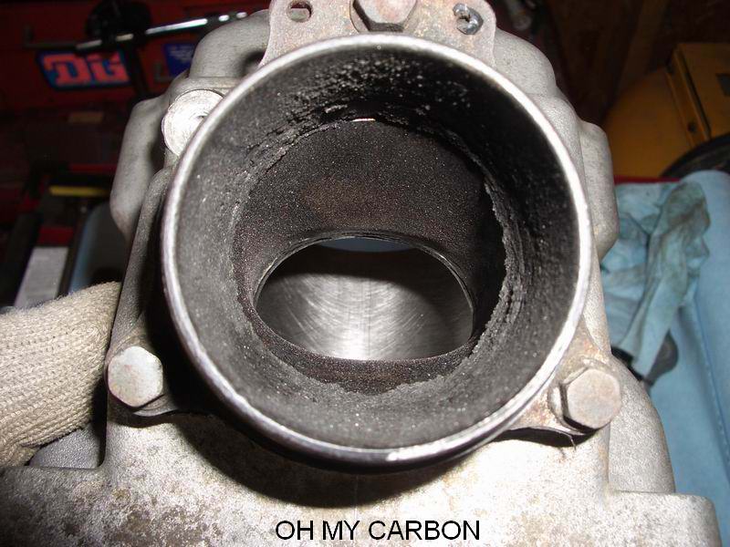

Looks like you found your wet line, the carbon buildup is one of the things you address annually when you remove the top end for an inspection, where does all that carbon go as it builds up and then flakes off or during a long wide open run when it gets a steady huge blast of heat and little parts of it starts to blister from the heat and flake off? spark arrestor catches some of it what about the stuff that is stuffed back into the Engine? http://pilotodyssey.com/PO/viewtopic.ph ... t=wet+line see the affects of the reverse pulse of the pipe....

Yep, that cylinder pic of the carbon is one I was working on that was in need of a rebuild from a stock machine. In order to clean up mudds post you can delete it if you or mudd wishes. However the info is good.
