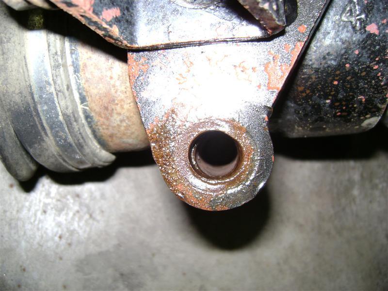

Only took 45 minutes of beating and running the impact gun on these bolts to get them out heh
Its hard to see in the pictures but both bolts are bent and need replaced, the holes where they pass through are also worn some, cant tell how much until I get new bolts to feel for slack.

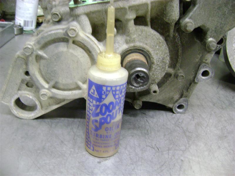

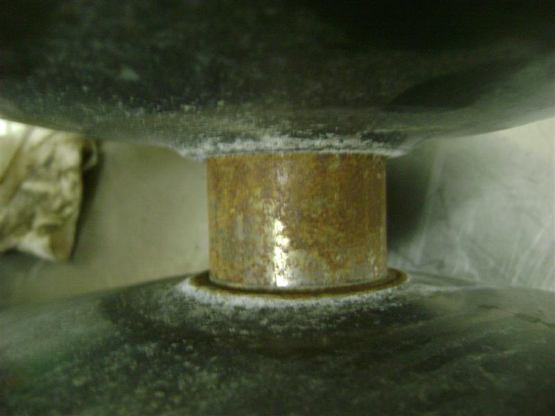

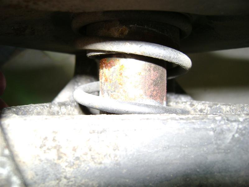

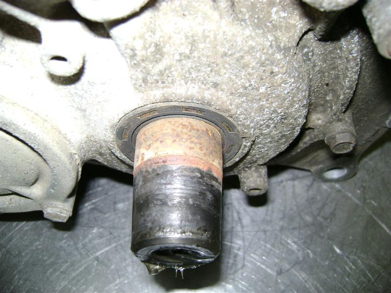

Plenty of rust on the crank, we ALL need to start lubricating this area with oil after each ride trip, the rust creeps into the clutch taper and under the crank seal

A ZOOM spout oiler does the trick they are cheap, think the last ones I bought were 2 bux each you can refill with your favorite oil they last years have 100 uses everybody should have a few, act now and I will include bla bla bla OH just get one or more they make great stocking stuffers! http://www.zoomspoutoiler.com/pricing.htm

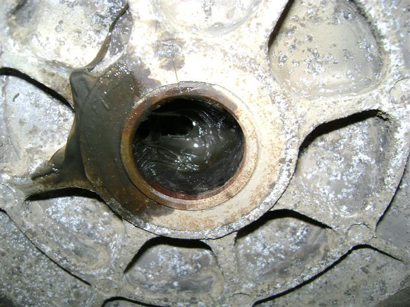

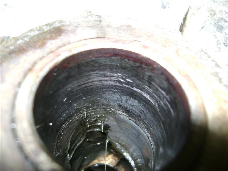

Inside the clutch taper

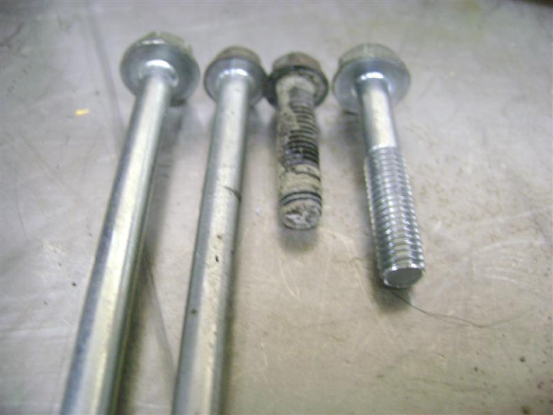

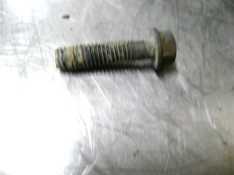

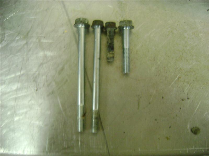

Now the clutch is off I can remove the starter but look they used the wrong bolts to install the starter, more Pilot molestation this has to be the most molested Pilot I have seen yet, oh and it don't get any better.. Read on.
File comment: ONLY 2 threads were used on the one starter bolt
File comment: The wrong bolts are in the middle
File comment: See the head diameter differences, clamping force is important that's why the correct bolt heads are larger.

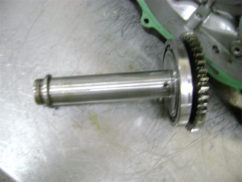

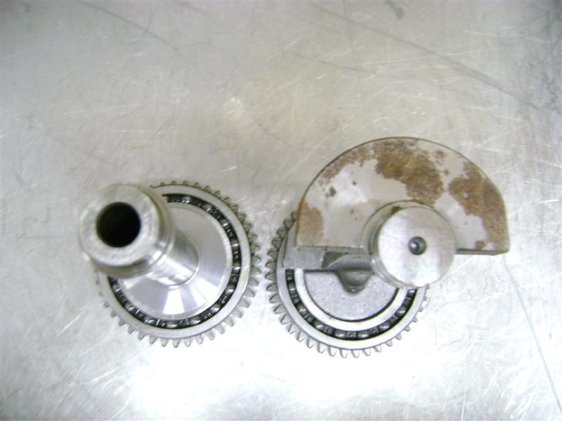

Here is the balancer, whats wrong with this picture?

All I see is a shaft, what balancer?
Disclaimer: I have yet to have a reason to be inside one of our pilot engines.........

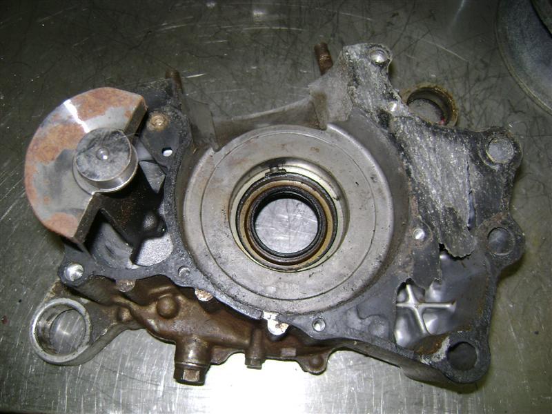

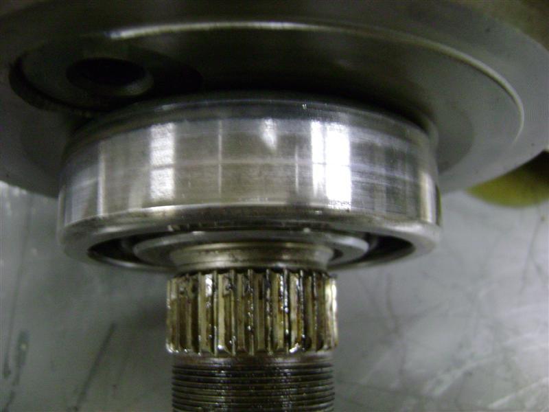

Split the cases, no effort required, both bearings came out of the cases real easy, not a suprise that is why you could slide the crank in and out so easily.
You can see where the bearings been spinning in the cases,,, but why? Figure it out yet? I already gave you the answer well I post pics of the answer...

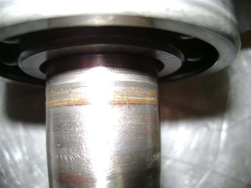

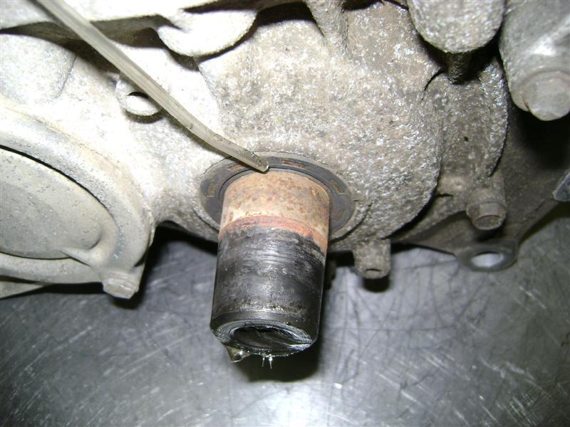

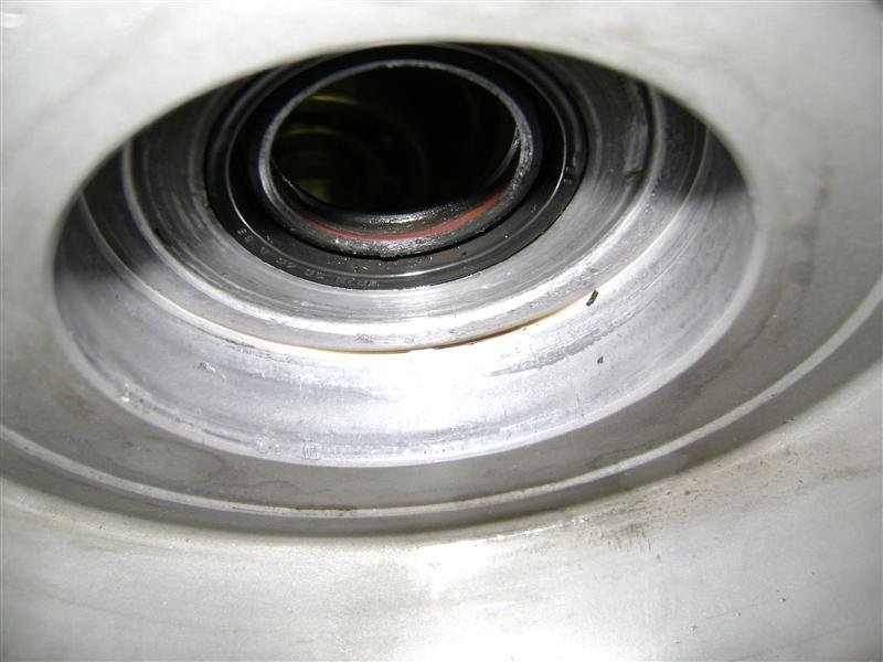

Close up of seal surface, see the RUST, that rust was under the crank seal, it was between the outer and inner seal lips, ever look close at a crank seal it has two sealing lips, the outer is like a dust seal to protect the inner seal that actually seals your crankshaft, if you use the zoom spout oiler and oil outside the seal it cant rust, using thin oil like 5w will allow an film of oil to remain on the crank but not enough to attract large amounts of dirt.

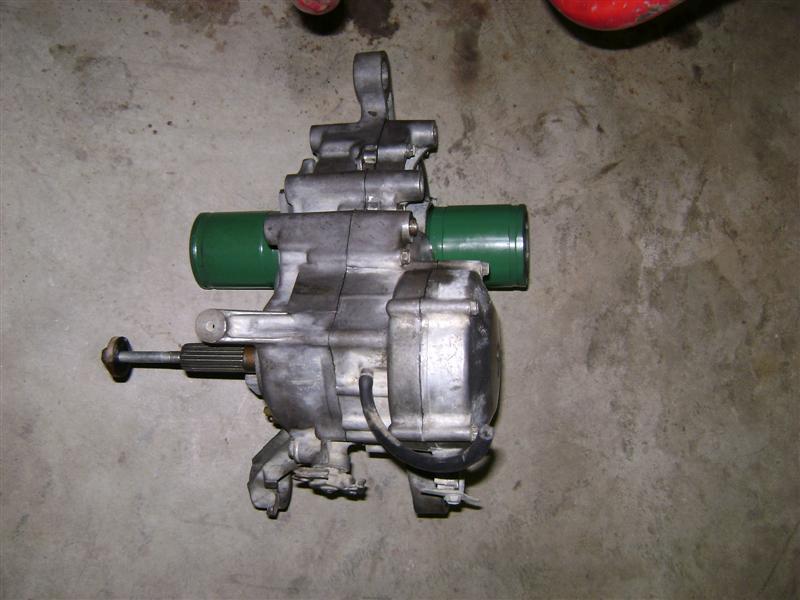

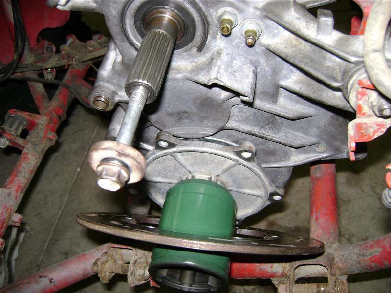

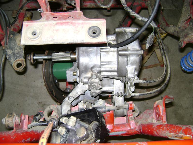

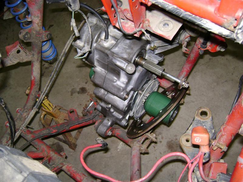

Trans completed and reinstalled.
New final shaft, new final shaft seals, reused old case gaskets, new stub shafts...

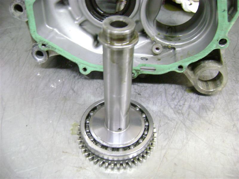

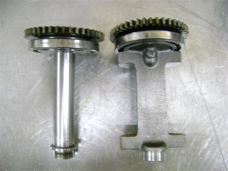

Ok after digging around for a while I found your spare balancer, it looks ok I will clean off that surface rust.
See the difference?
Anybody want to buy a "billet" "racing" Pilot balancer shaft? Not the route I would take I would just remove the whole balancer and use a electric water pump.

Ever think the guy just could not see the alignment marks. Wonder how much vibration was created. Some one did not do there piston speed math. How does the Engine mounts look no cracks, or did the mains take all the abuse. I would defenty use new crank now. If you scrap those case halfs I 'll buy them for prototype mock up cases.
Ody_Stable, what you said makes since to me.
PostPosted: Sun Jan 11, 2009 10:56 am
Look at the balancer, they took the stock one apart and made a new shaft without balancer lobes on it, no alignment marks necessary assume to reduce weight, need to see if I can get it to the post office to see how much weight they saved.
PostPosted: Sun Jan 11, 2009 11:21 am
I was making a joke. bad atempt. I believe they removed it so it would rev quicker and at a higher rpm. By doing so it would vibrate and the harmincs would effect the crank train which effect the bearings setting loose in there journels. Something must take up the shock load force. These forcesare traslated to the the motor (( Internal Combustion Engine ? )) mounts and transmisson and mounts. Tryin to rev past the max piston speed just makes it worst. If you kept it tight one could run with out balancer but why. In this case the engineers know best. I would check the fly wheel weight.

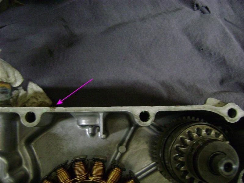

Putting the bottom end back together you can see where some JACKASS took a screwdriver and a hammer to split the cases, WTF was this person thinking? How can someone be this dumb? HONDA CAST bosses into the cases where you can take a hammer and brass pin and TAP the cases apart the guy that used the screwdriver like a caveman must have either been really really STUPID or blind!
PostPosted: Sat Jan 17, 2009 3:31 pm
Matching DAMAGE on other case.
