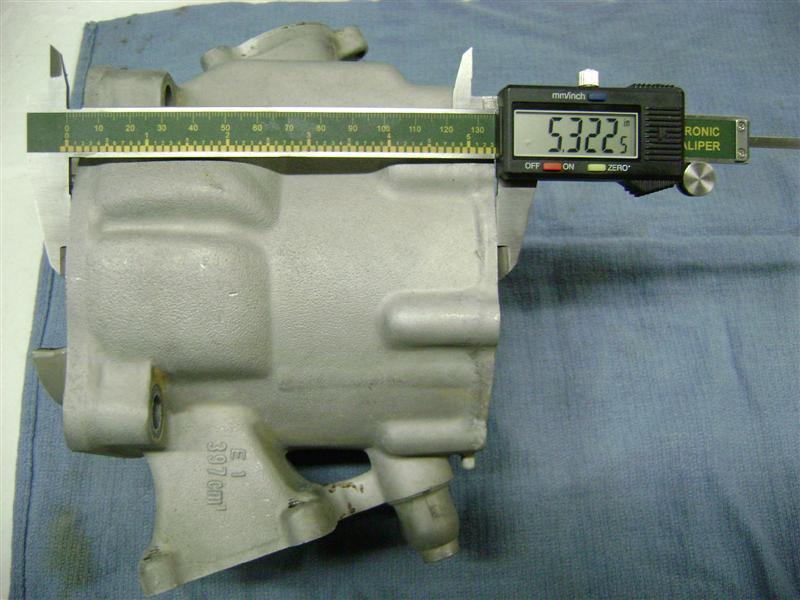

Cylinder is back, I measured its height before sending and after it came back since they usually deck it after installing the sleeve I wanted to see how much they took off.
File comment: BEFORE
File comment: AFTER

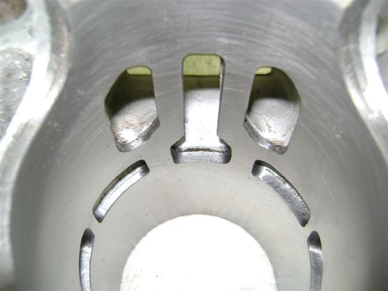

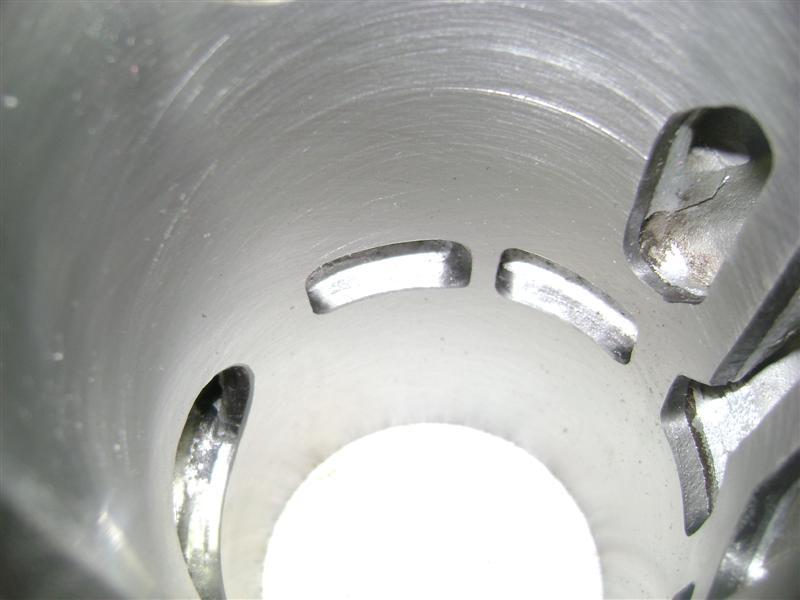

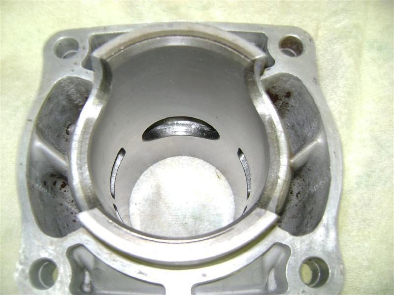

PostPosted: Thu Feb 26, 2009 9:09 pm
All looks ok to me time will tell, what can go wrong is the liner can shift or move when the Engine is running.
PostPosted: Thu Feb 26, 2009 10:10 pm
looks good cant wait to see what it runs like after the Hoserising and port job.
PostPosted: Thu Feb 26, 2009 10:12 pm
Posts: 1037
Location: CT
You ever see one move? They should have cut a counterbore at the top of the deck to allow for the liner to fit into the cylinder. Between a press fit of the liner and cylinder; and the head clamping down on the top of the liner to squeeze the counterbore it should be fine. But like you said, time will tell.
PostPosted: Fri Feb 27, 2009 2:28 am
It looks really good. I like how its hard to tell. All the edges match up great.
PostPosted: Fri Feb 27, 2009 3:04 am
Yes I have, stoneman had one done at a local shop to him, it dropped down, can only assume they cut the counter bore too deep and when it heat cycled a few times it dropped down a little causing the head gasket to leak, he had to remove the cylinder and have it decked.
We need to get Speedchaser doing these, from what I have read its not that hard, bore it out until their is a .002 to .003 interference fit then chill the liner and warm the cylinder, press it in keep tension on it until the temps equalize, deck the top of the bore to ensure its flat, match all the port openings, not sure if Speedchaser would want to tool up to match all the ports, I think I have two Pilot cylinders that need a sleeve I would match the ports myself so that part would not be an issue.
