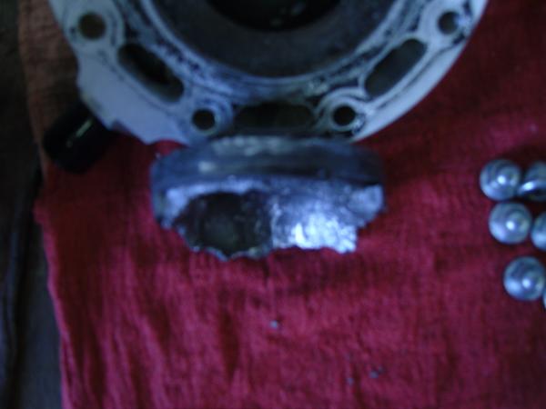

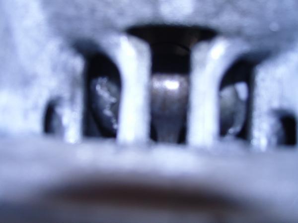

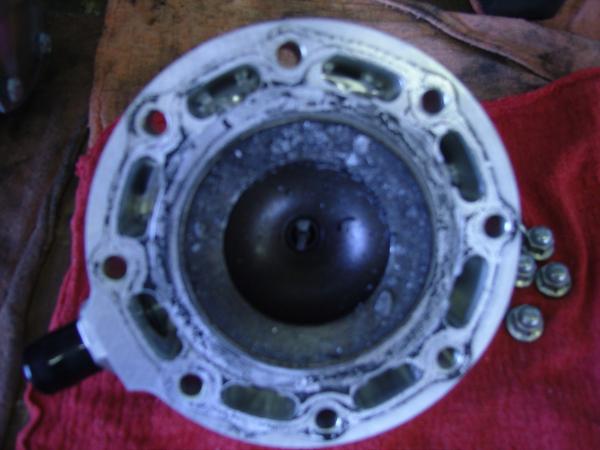

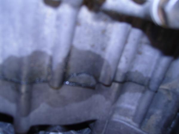

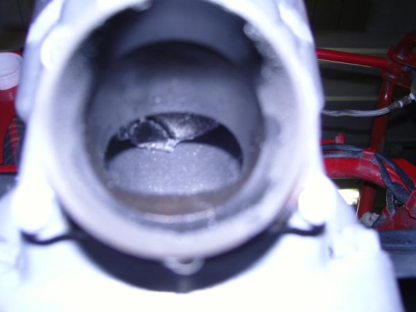

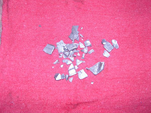

Hey guys, well I toasted the Engine in my long travel.
File comment: This is what I poured out of the exhaust.

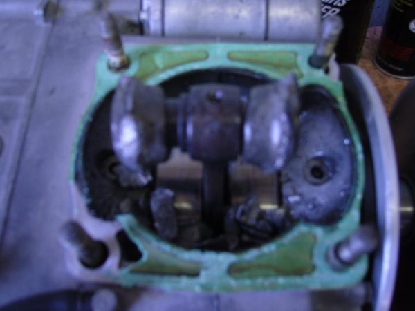

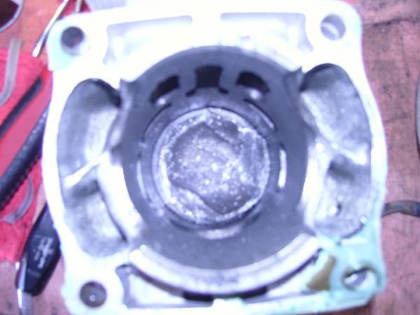

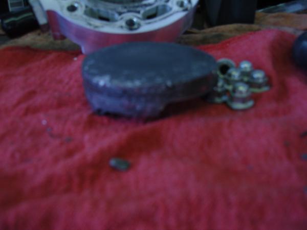

File comment: Top half of the piston.

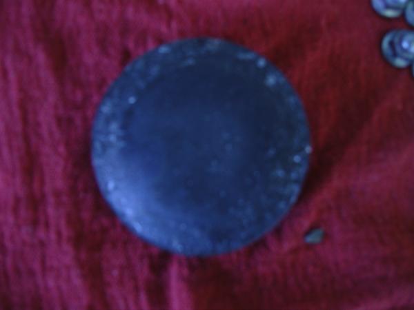

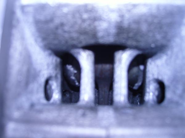

File comment: My new 1990 reeds, torn petal.

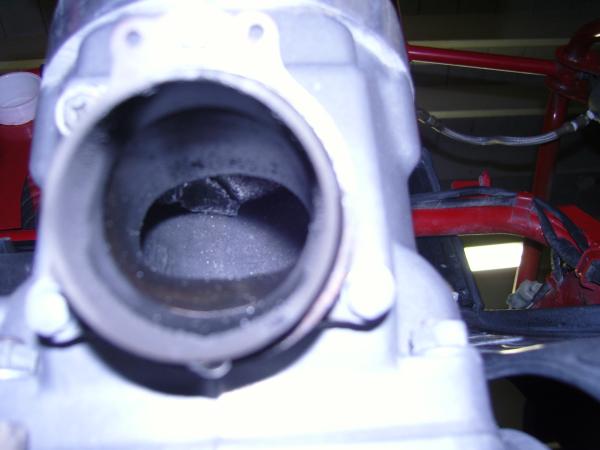

PostPosted: Sun Dec 09, 2012 9:01 pm
Posts: 1090

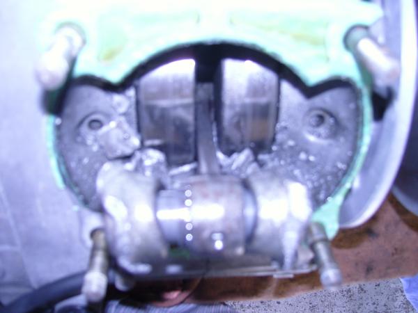

Couple more pics.
File comment: Bottom half of the piston still attached to the rod.

Cant really tell in the pics but I bet that hole in the crank cases can be welded up and repaired I have seen this type damage before.

The piston broke?
How many hours on the piston?
How many RPMs were you running?
What a mess.
Howdy Sir, yep the piston broke good. I am not to sure how many hours were on the piston, I do know that the previous owner had replaced it about 2 years before I bought it. My RPM gauge was not working, I do have a no rev. limiter CDI (Capacitor Discharge Ignition).
Mess, yup that's the word. My wife keeps asking me why I am smiling when talking about this, she does not realize that the smile is covering up the tears. LOL!!!
Do you think Speedchaser is who I should contact about repairing the case if it's repairable and rebuilding the crank.
Here are some more pics.

WTF never seen a piston that bad on a single cylinder 2 stroke before I have seen them that bad on a multi cylinder where the other cylinder kept dragging the bad piston until it locked up.
Also seen a 400EX piston that bad after it quit running the owner towed it about 5 miles trying to start it until it locked up.
After its running again I would like to see what RPM its running.
After I get it apart and see the damage will let you know on welding the cases I bought a new welder and can weld aluminum now just don't know if the gasket surface will need machined or not, pretty sure their is no welding that piston :-)

Hoser a few of us were kinda hoping to hear your csi Engine analysis.
I mean was there something in particular that killed it? seal leak? lack of oil?
PostPosted: Tue Dec 11, 2012 10:37 am
Usually when a piston skirt does that its because of too many hours then gets work harden then brittle then cracks then breaks up just thought it would have lost compression or spark and quit running before getting that bad.

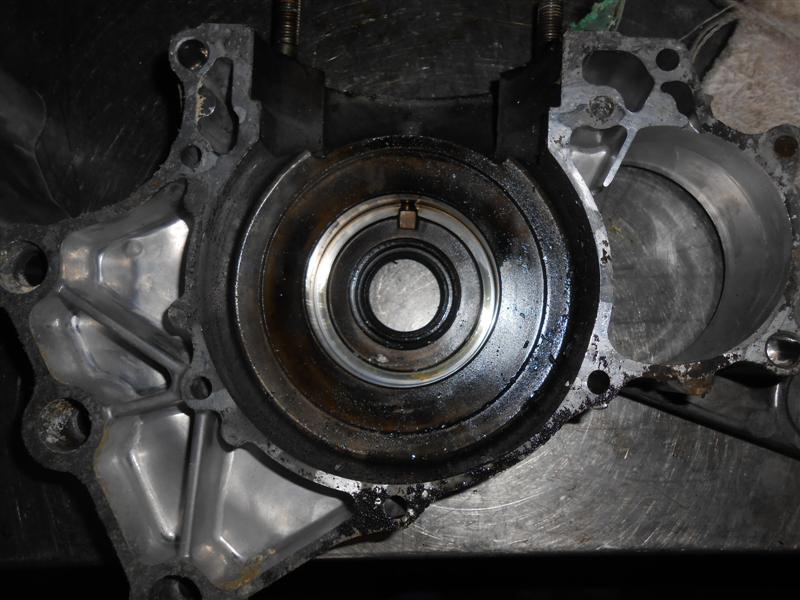

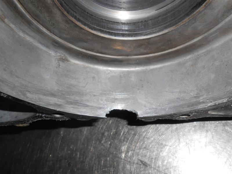

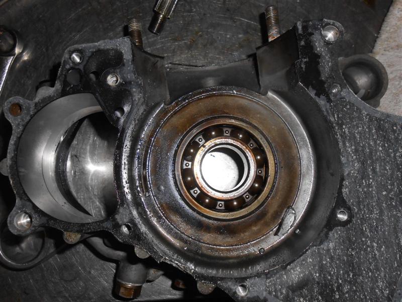

Picked up Steves Engine while I was in town brought home for a rebuilding, mag side case has a chunk broke out the clutch side case has a crack both will get welded.
