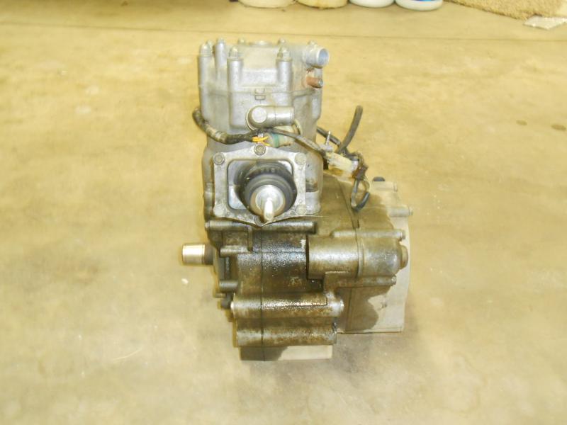

mr2angry2 sent me his Pilot Engine for a CSI and rebuild.
Bunch of my pics didnt turn out for crap will have to take some more tomorrow to replace these lol

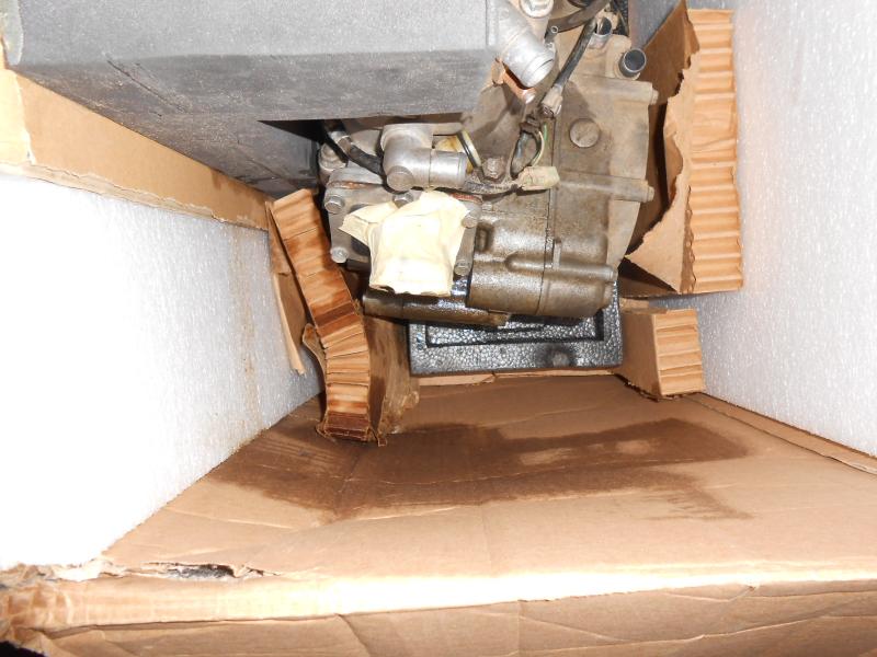

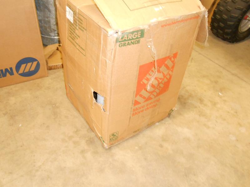

Engine came well packed but the box had some damage as the UPS mutts must have tried to beat it to death on the way.
No damage done to the Engine.

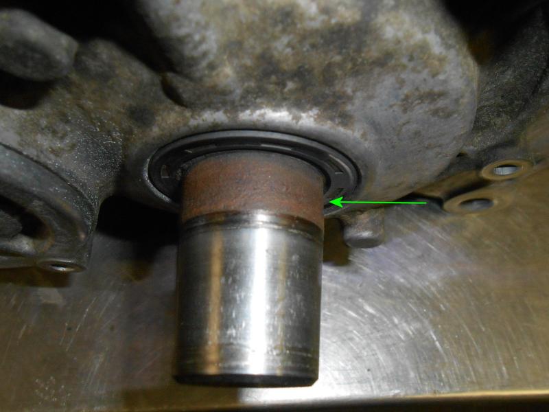

No shortage of rust on the crankshaft between the clutch and the Engine, was sanded off smooth so the Engine can come apart and so the bearing can be removed.

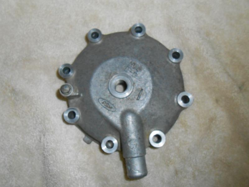

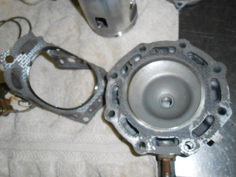

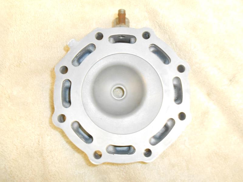

PostPosted: Sat Nov 23, 2013 3:53 pm

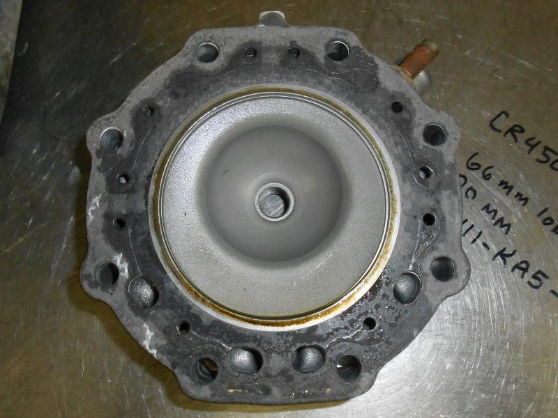

Head removed no carbon build up looks like its running plenty rich.
Had to use a visegrips to pull the old head gasket off the head.
Once I scraped off the residue lapped the head to ensure it was flat.

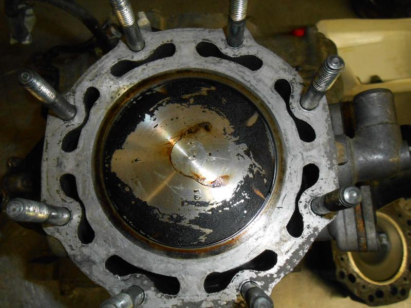

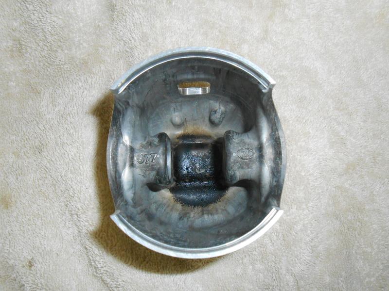

PostPosted: Sat Nov 23, 2013 3:58 pm
Never seen a burn pattern like this on the top of the piston before.
Usually the carbon pattern is the other way around carbon in the middle then bare on the outside usually you don't see carbon washed off in the middle, almost like this piston was partially cleaned in the past?
Not sure what that residue is in the middle but its not part of the products of combustion.
The whole inside of the Engine smells like gas that has turned into varnish mr2angry2 you need to smell the inside of your gas tank if your tank is fouled you need to flush and clean your whole fuel system really good.
Has this Engine and or Pilot been setting for a long time?

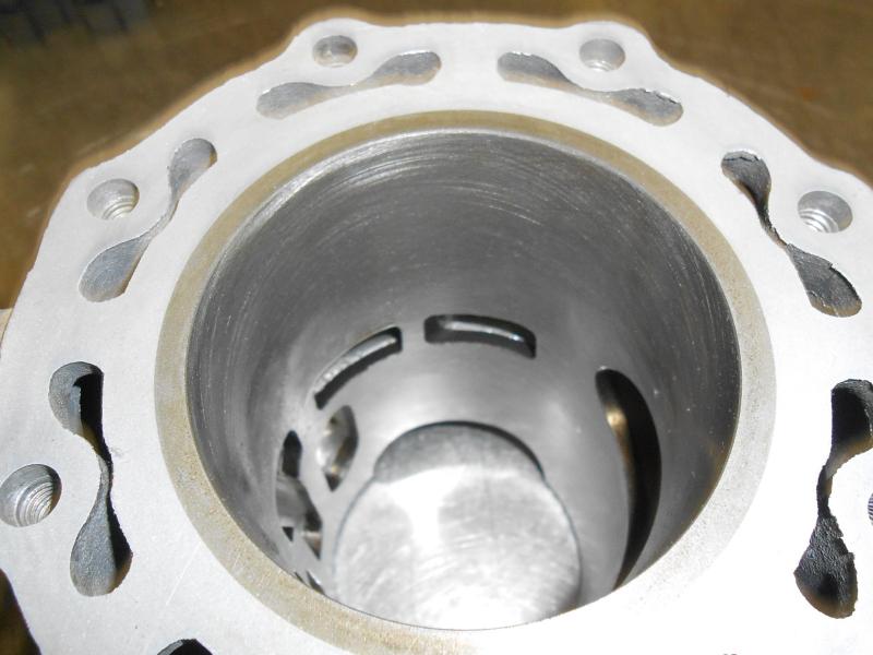

PostPosted: Sun Nov 24, 2013 4:25 pm

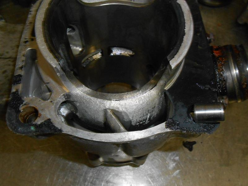

Removed all the studs scraped off all the gasket residue then lapped the top of the cylinder to ensure its flat, put a light hone on the cylinder its nice a straight, minor scuffing on the exhaust side now gone.

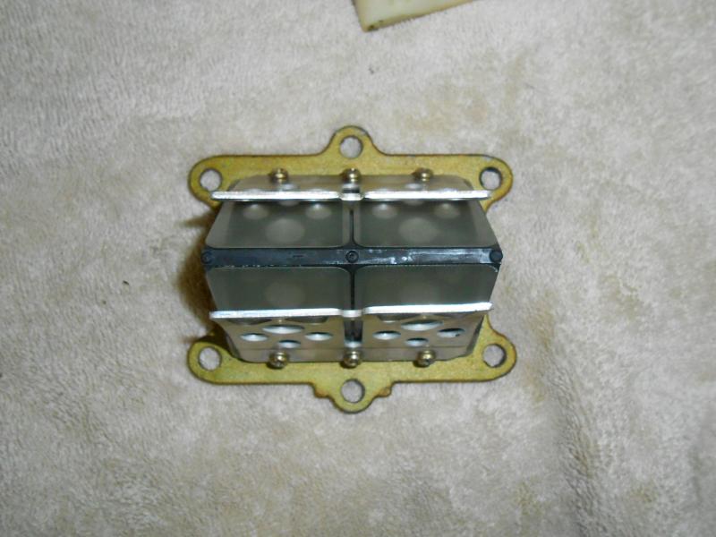

Stock 1990 Pilot reed cage and reeds, reeds look really good and don't need replaced.

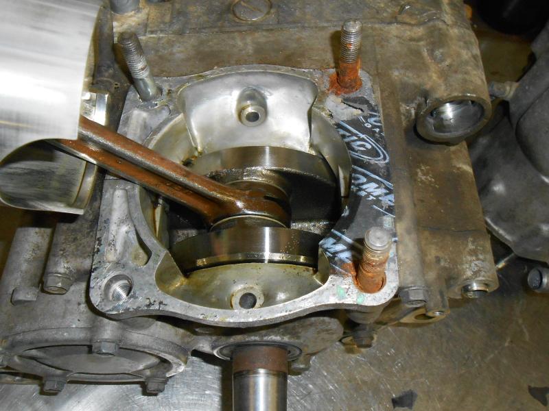

PostPosted: Sun Nov 24, 2013 4:33 pm
Studs all rusted to hell never seen this before, one the stud came out when I removed the nut on the cylinder.

PostPosted: Sun Nov 24, 2013 4:36 pm
Who ever replaced the top end last didnt clean all the old gasket material off :shock:

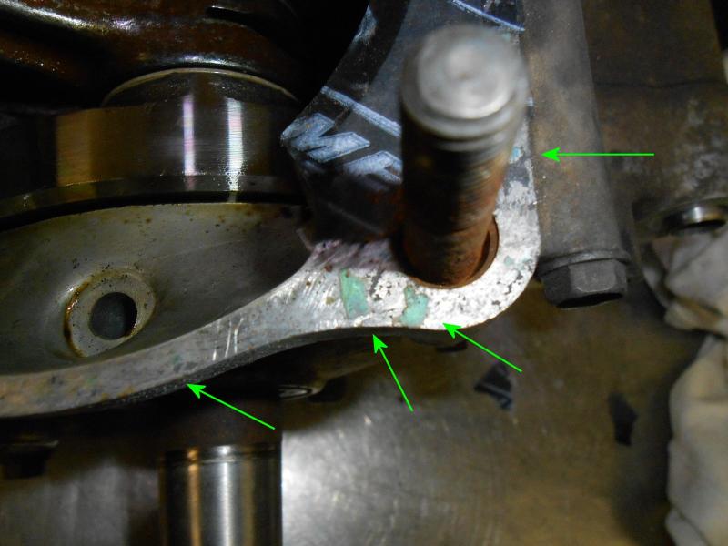

PostPosted: Sun Nov 24, 2013 4:40 pm

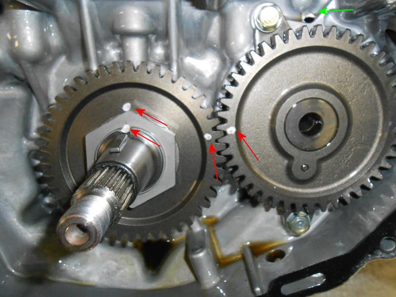

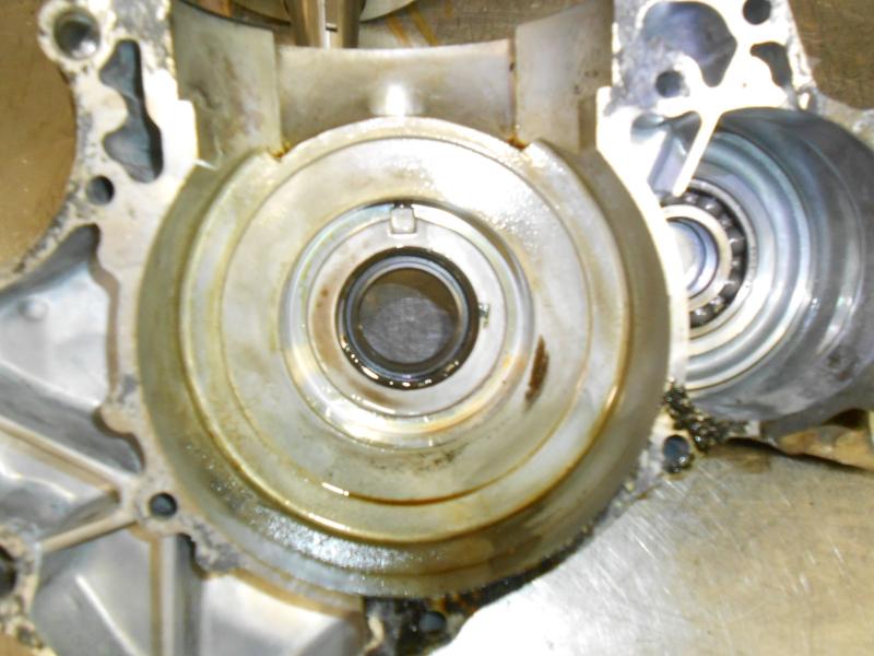

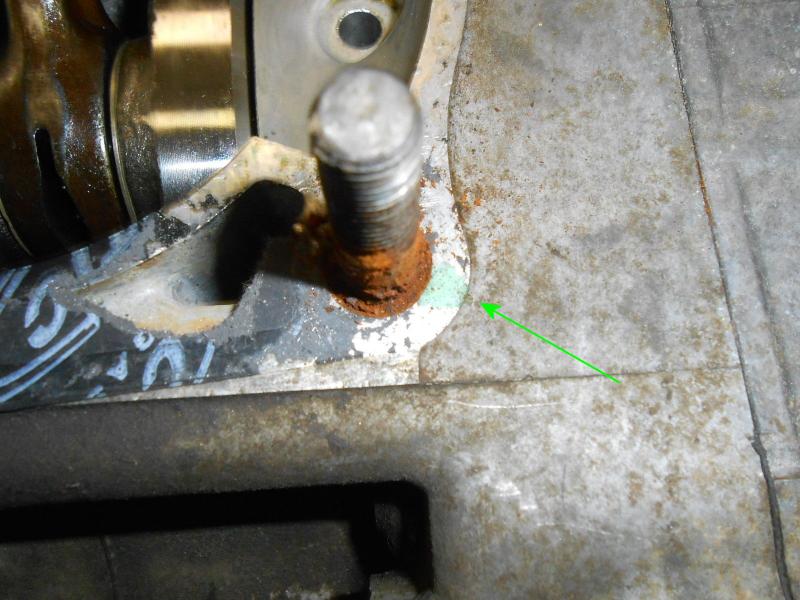

Never seen all the timing marks all marked in white paint maybe this was for the 1990 engines?
Green arrow shows where the case will be modified for better oil flow.

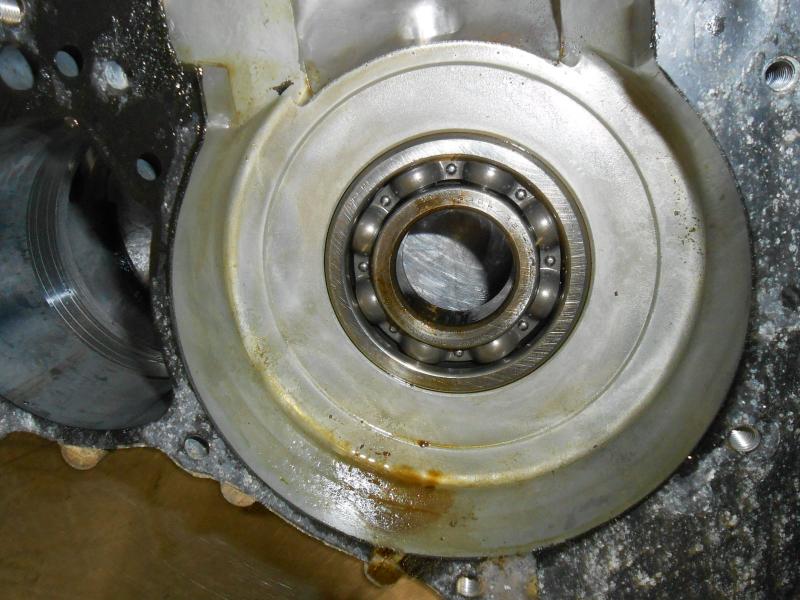

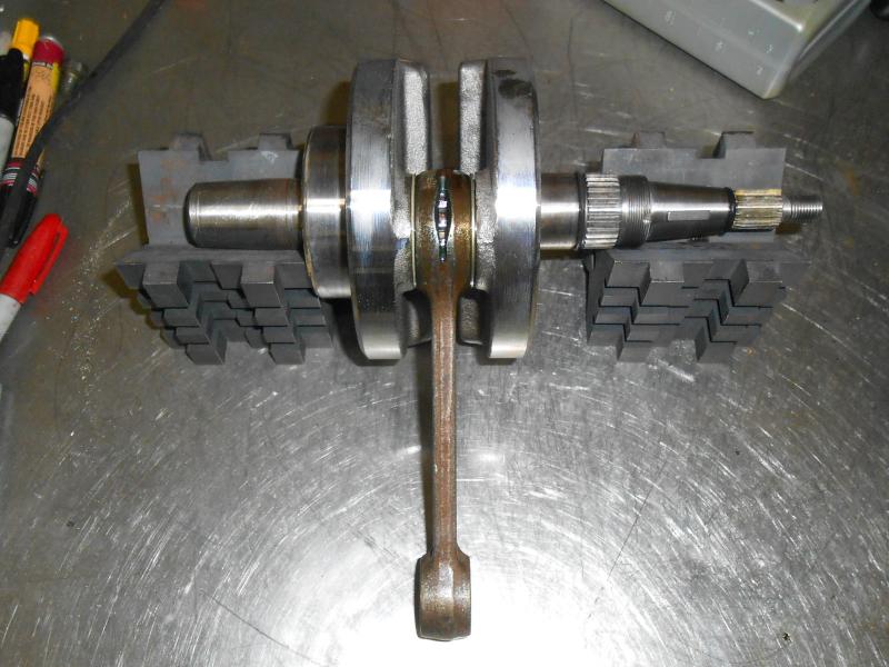

PostPosted: Sun Nov 24, 2013 4:42 pm
Cases split crank out
PostPosted: Sun Nov 24, 2013 4:43 pm
Bearing came out stuck to crank will take it to my buddys and use his bearing puller tomorrow.

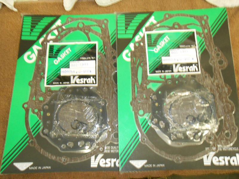

PostPosted: Wed Dec 04, 2013 12:03 pm
Your gasket sets are here .

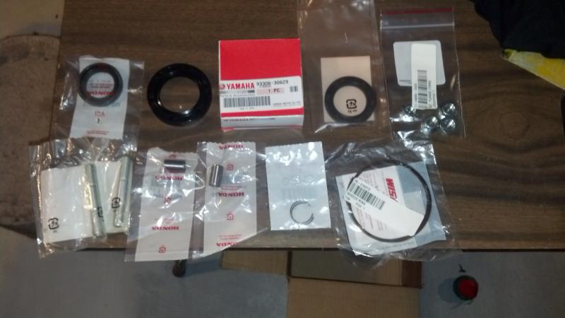

PostPosted: Wed Dec 04, 2013 12:04 pm
Your two clutch side crank bearings are here (blue boxes) did you order the Yamaha bearings like seen in the red boxes for the mag side crank bearings? If so I will start to assemble your bottom end using my mag side bearing while I wait on yours to show up.
