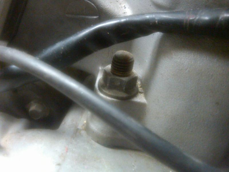

Rear studs on jug either not screwed into the cases fully or wrong studs.

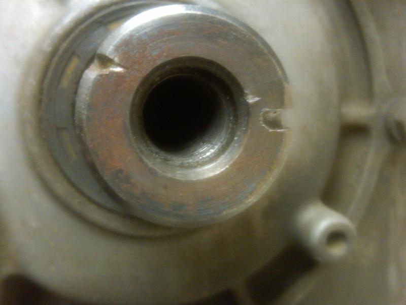

Crank has grooves in it probably from a skill billy clutch removal session gone bad.

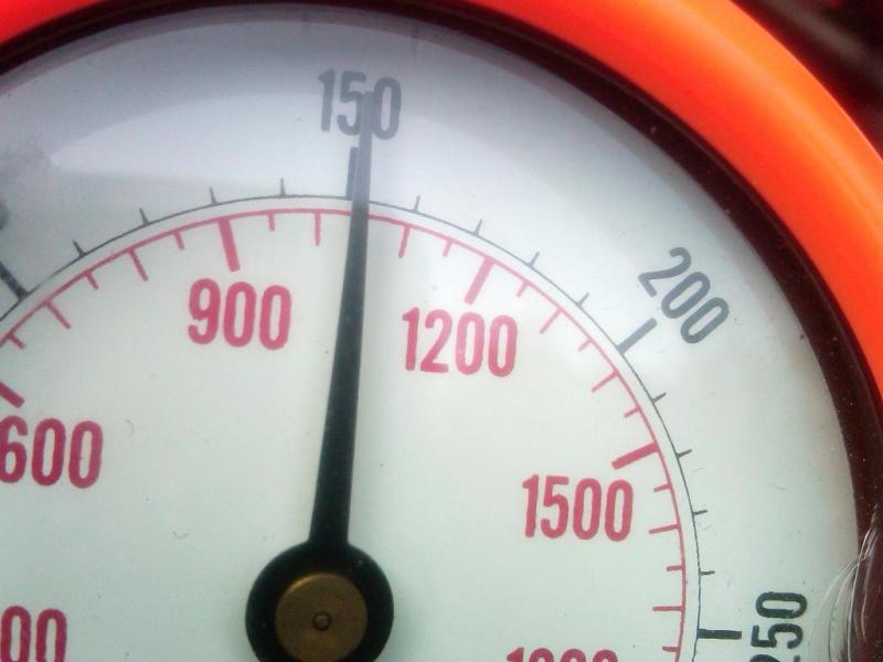

PostPosted: Sun Feb 05, 2012 10:40 am
Old owner told me he had the top end recently done by local shop. He had documentation for 82mm Wiseco, bore,reeds and labor.

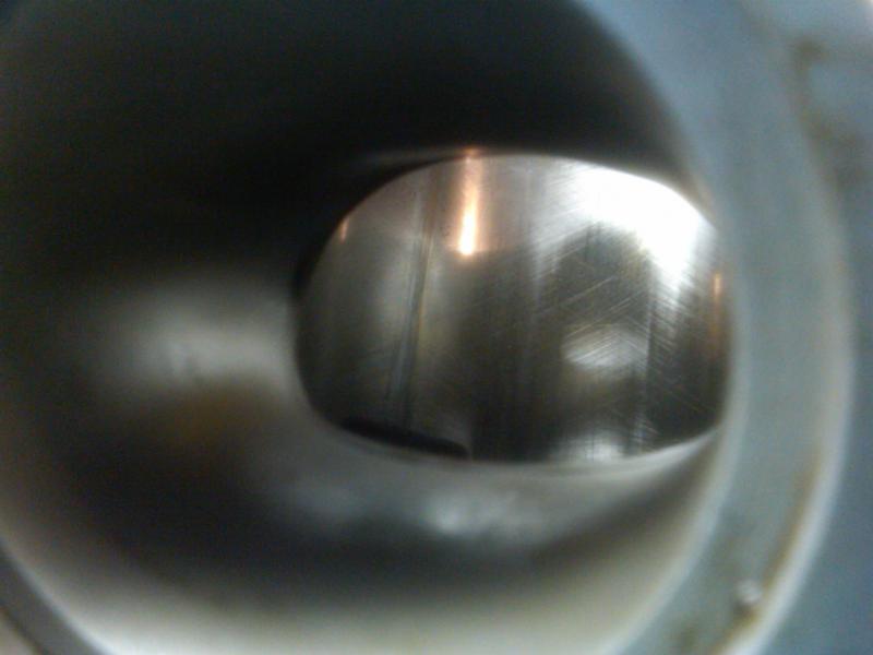

First, the compression tells me something is amiss at the 150 psi warm with a 82mm IMO that's low. I took the pipe off and looked into the cylinder. No good, can see gouges. Took the stock OEM head off and here is what I saw. He was right brand new Wiseco 82mm Piston.
Cool deal. At least I know the old owner was telling me the truth.

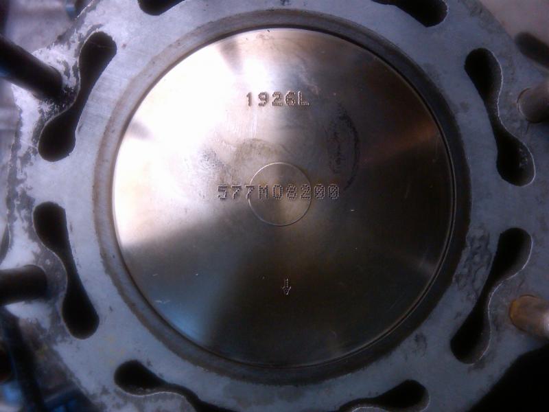

PostPosted: Sun Feb 05, 2012 10:42 am

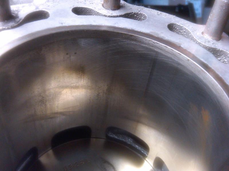

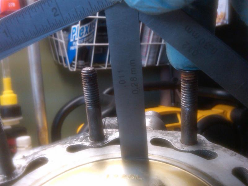

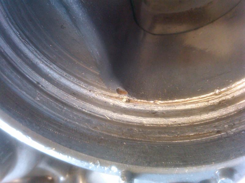

But as we progress along with the piston CSI and the jug we see this:
Piston is way loose in the jug and a quick check you can see the numbers. Way too much clearance.

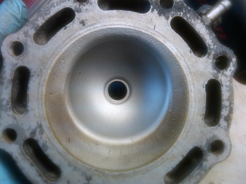

PostPosted: Sun Feb 05, 2012 10:43 am
Head gasket was not leaking and the top of the jug and the head is in good shape,can be reused.

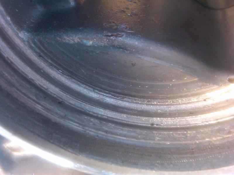

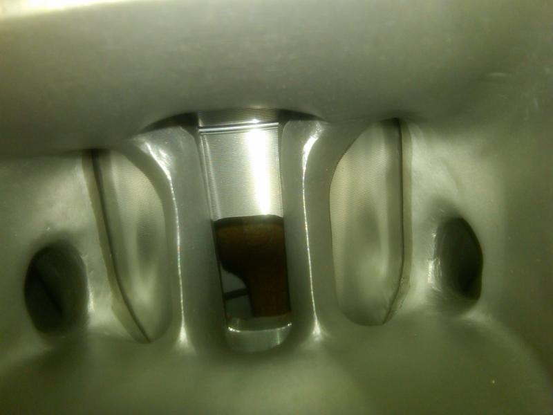

PostPosted: Sun Feb 05, 2012 10:54 am

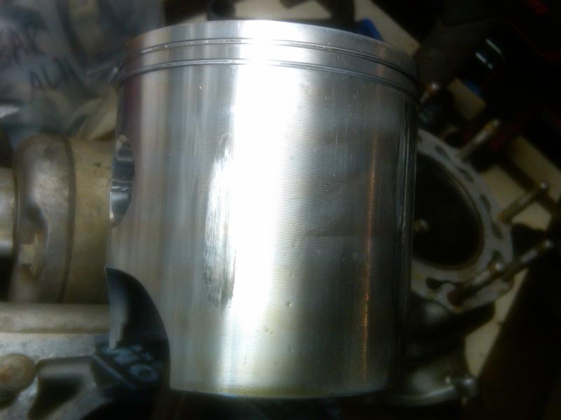

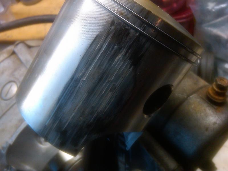

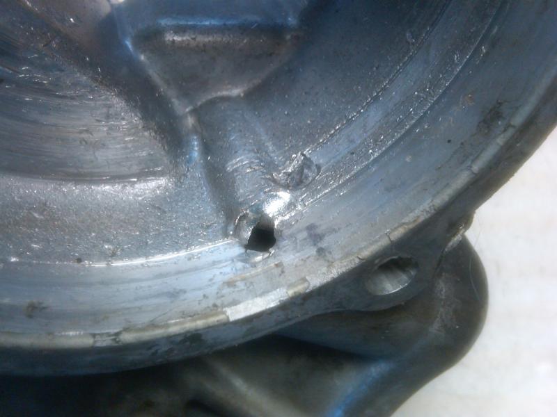

Jug off and the damage is pretty bad. This piston is brand new-it has no hrs on it at all, probably never ran it after the rebuild by local shop.
I am trying to figure out what happened here. Perhaps a piece of old ring was left in or around the bottom end and was pushed up? Perhaps improper lubrication on the new piston when installed? The aluminum is exterior on this piston, it can be scraped off. Your thoughts please.
There was no piston prep what so ever-the piston pin has to be hammered into the piston-the skirts are sharp and there are gouges in the wristpin holes from a skill billy. A quick measure of the bore on top is 81.63mm but there is gouging on all sides on it.

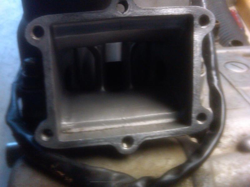

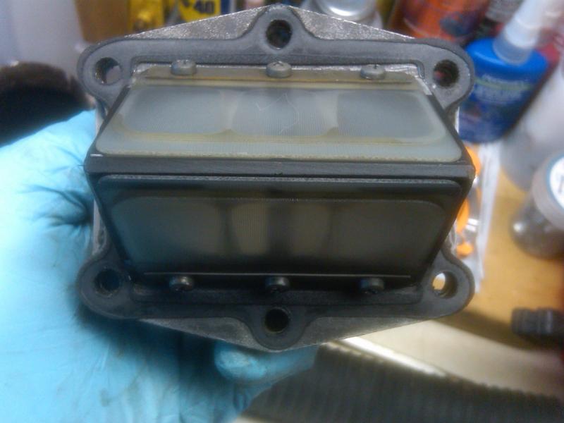

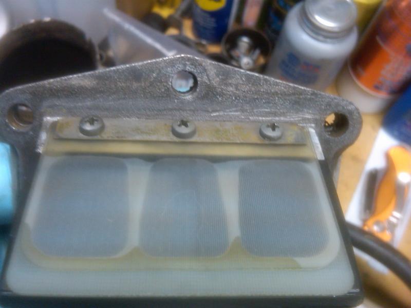

PostPosted: Sun Feb 05, 2012 10:57 am
Reed cage removed.Not 1 ounce of sealer on it at all. Nothing. Unreal. Must have leaked like a air hose with no fitting in it.

Pictures of the piston.

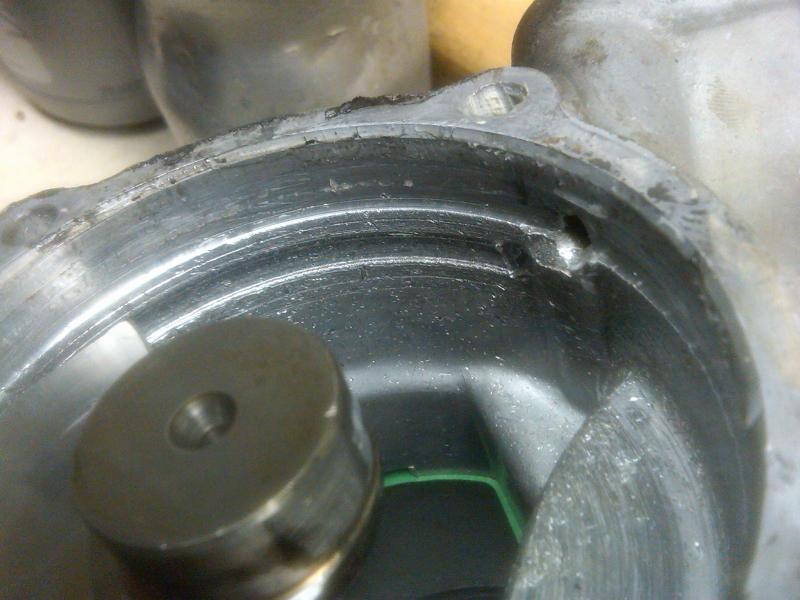

Both side cases off, starter removed,flywheel pulled, balancer out, mag and associated case internals removed.I have damage by the balancer inside the cases. See pictures. Is this a common issue with these to have scratches like that? Please remember this is my first Pilot internal combustion Engine. Also the side case plate which houses the bearing for the balancer has damage as well, it was heavily silicon ed.

PostPosted: Sun Feb 05, 2012 11:09 am
Will split the cases today more to come!! I will with Speed's consent send the crank over to him to see if those gouges can be fixed and perhaps a new CR 500 ROD KIT installed. I must make sure the runout on this crank is well too.
I have checked the bearings removed so far for retainer issues as we have documented with the crank bearings and have found none to date. The side cases mag side appears fine, no issues. The internal damage especially by the balancer is a worry to me.

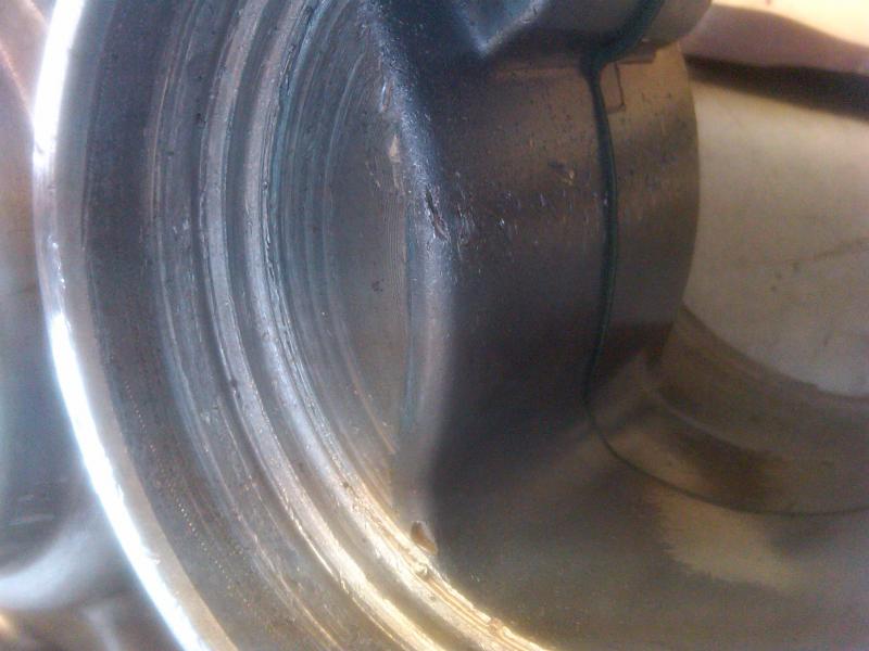

Cases split. Noticed some area of concern, especially in the balancer race area.There are as shown in the pictures so deep gouges. The balancer itself is damage free, so I assume the Engine has been split before and a bearing spun in the area pictured.

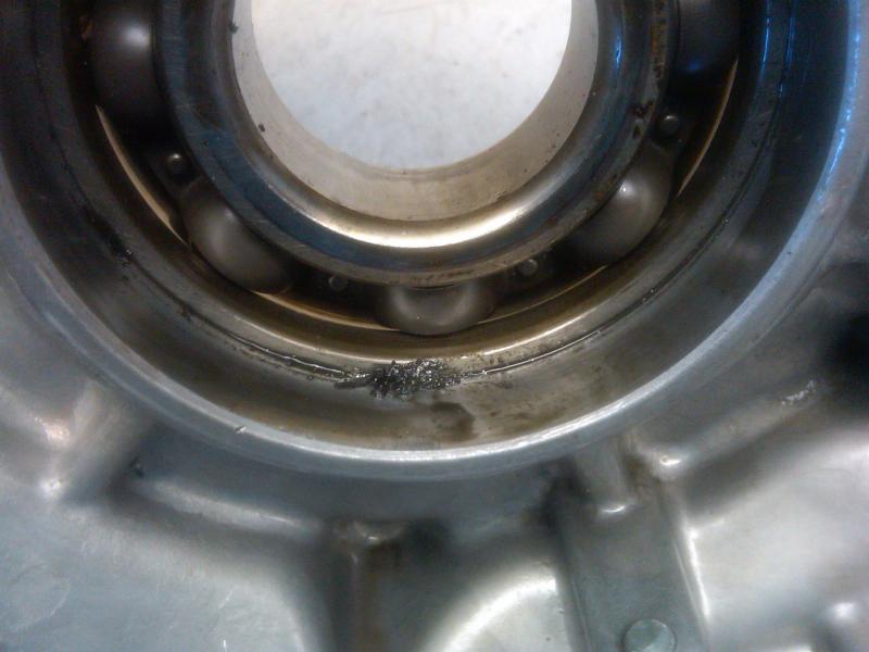

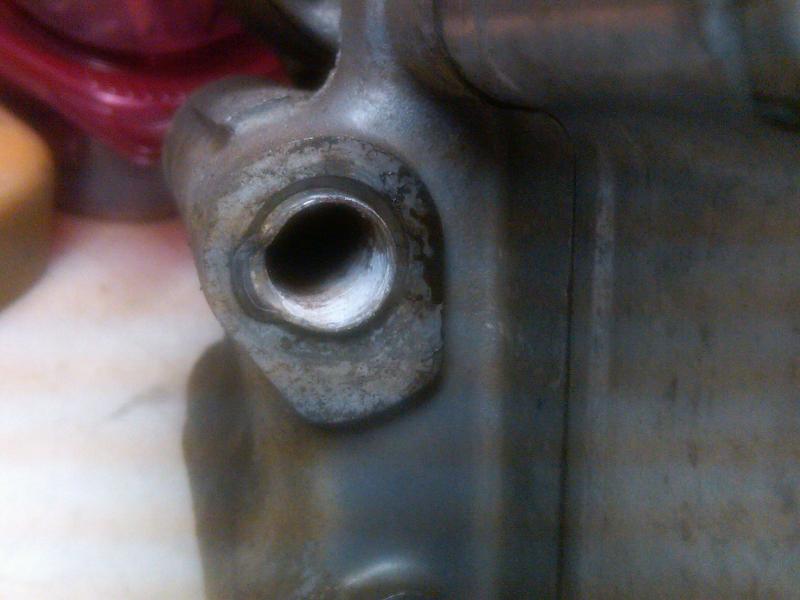

PostPosted: Sun Feb 05, 2012 3:00 pm

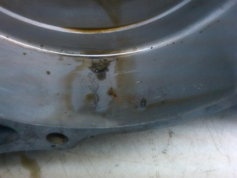

Damaged area just below the cylinder stud. I cannot see how the stud was not leaking air in this case. Any thoughts? I am going to have to see if Speed has time to weld this, or would a simple JB WELD in the area pictured be good enough?
Also the reason for the studs being higher in the back of the cylinder was due to skill billy workmanship, they were not tightened all the way into the cases. Stupid stuff by some skill billy.
File comment: This is directly below the rear stud on the case itself. I had to turn it upside down for the picture.

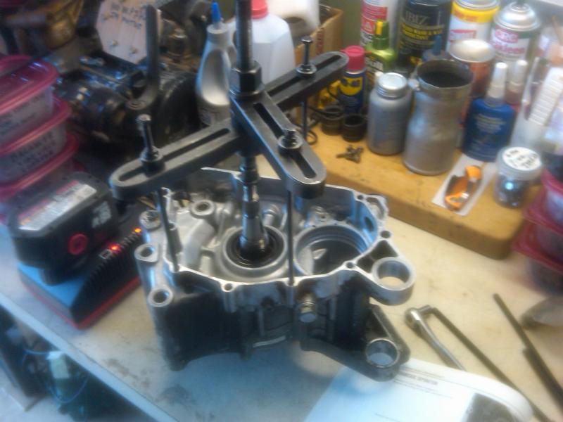

PostPosted: Sun Feb 05, 2012 3:04 pm
Case split with my TUSK universal tool. Thing was a great tool to pick up!

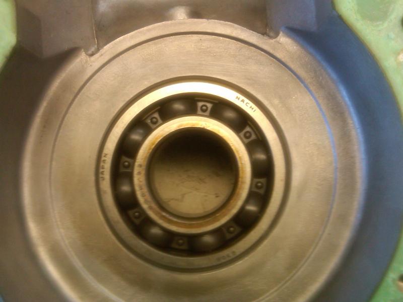

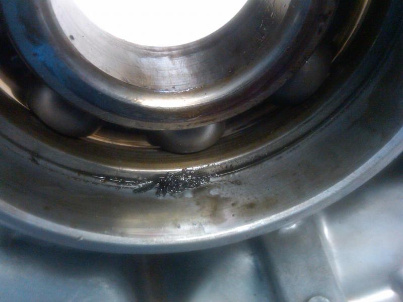

PostPosted: Sun Feb 05, 2012 3:08 pm

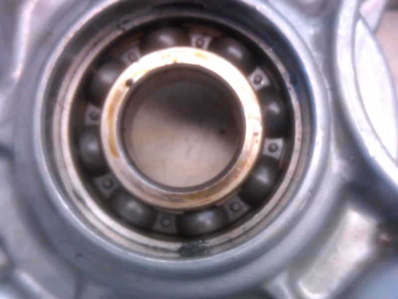

Bearing pictures as is right after the cases were split. Ever wonder where that metal goes when you smoke a piston? Look closely and you'll see it. It was as is pictured after I removed the seal. Glad I took this thing apart.
File comment: see that metal, it was just laying in there behind the seal
PostPosted: Sun Feb 05, 2012 3:11 pm

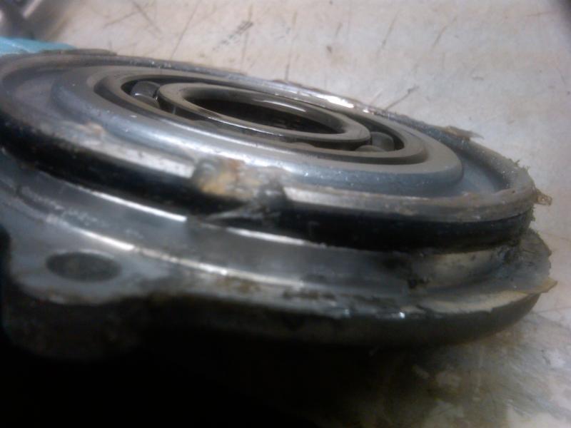

More. I checked the retainers on both bearings and they are still in place. A quick spin of the bearings and they feel ok but at this point they are going to be replaced.
Now back to the seal issues. The right side seal is double lipped for sure.

With an 82mm piston, what were you expecting the compression psi to be at? Not being condescending but I'm just curious to know..
PostPosted: Sat Feb 25, 2012 9:27 pm
Hello! No harm asking! I expected it to be around 165+ since stock is around 149 on a 80mm. Most of my 81mm + with speed heads run around 172psi give or take. I also took the exhaust off and looked quickly up the port and noticed the gouges on the piston surfaces. Of coarse psi varies with each jug.
