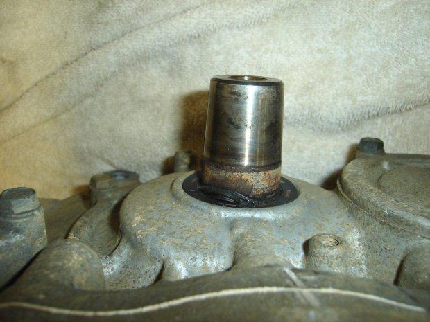

PostPosted: Mon Oct 23, 2006 6:15 pm

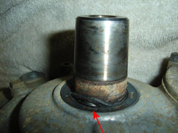

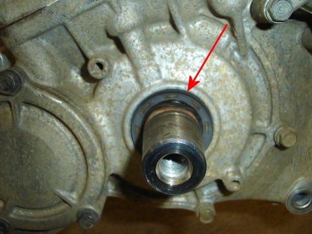

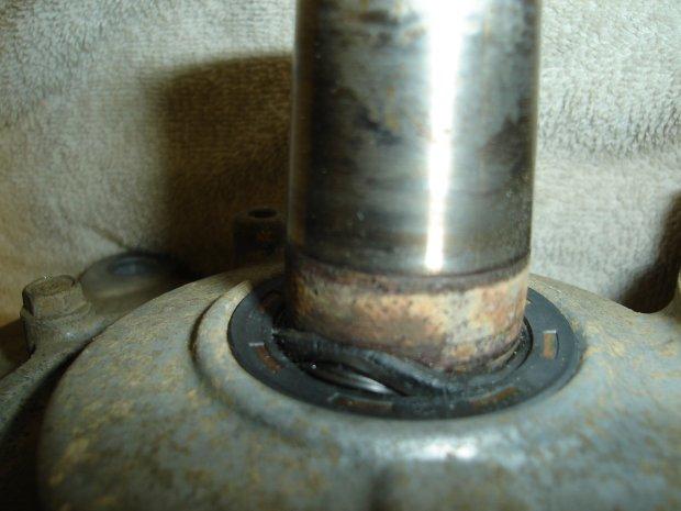

I see the crank seal sticking out my guess is the bearing retainer has balled up inside like Wiggens bearing did.
http://pilotodyssey.com/PO/viewtopic.php?t=1974
PostPosted: Mon Oct 23, 2006 6:16 pm
More pics of the seal

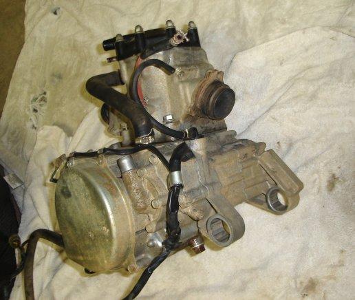

PostPosted: Mon Oct 23, 2006 6:18 pm
Just more over all pics I will be looking at these later for reference on the wire routing.
He did a killer nice job cleaning the Engine !!!

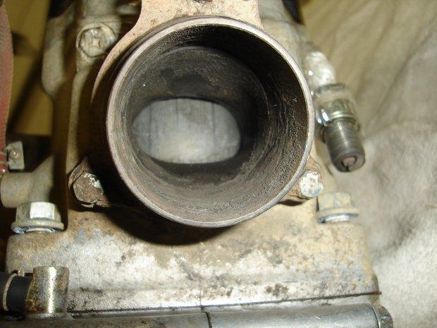

PostPosted: Mon Oct 23, 2006 6:20 pm

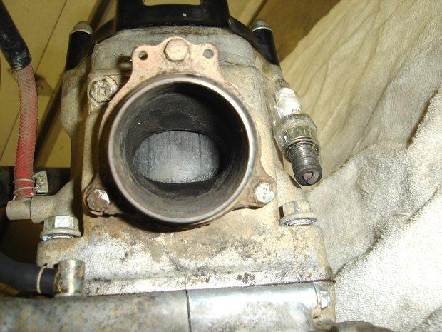

Looking in the exhaust, no major scuffing like a piston seizure stopped the Engine from rotating.

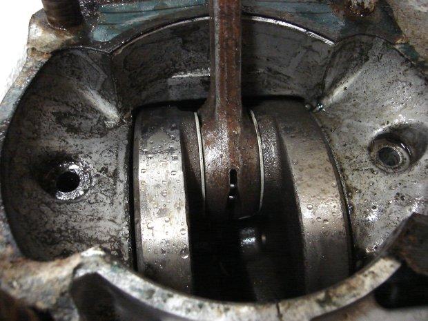

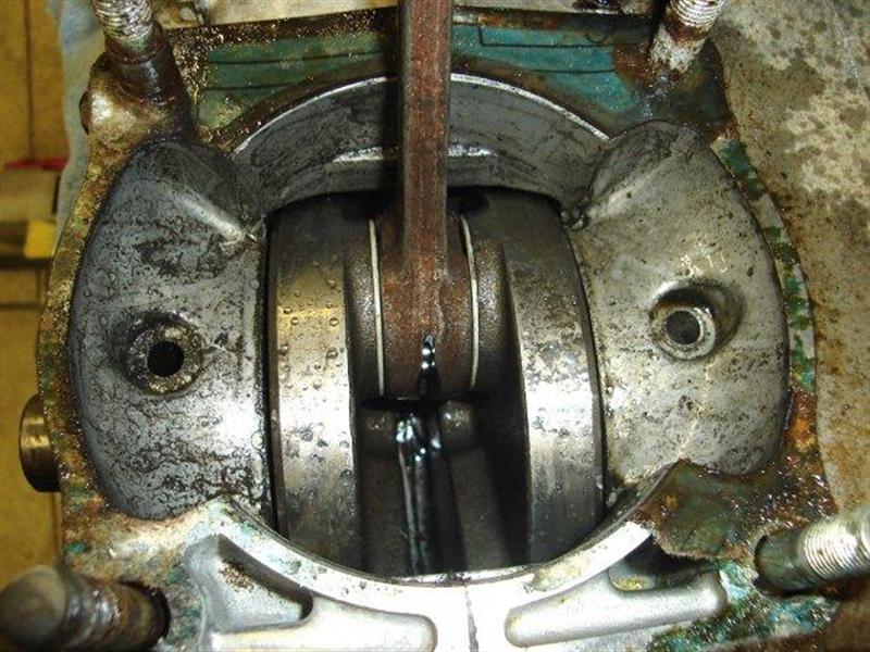

PostPosted: Tue Oct 24, 2006 2:19 pm
Nasty crap inside, plenty of oil just mixed with crap

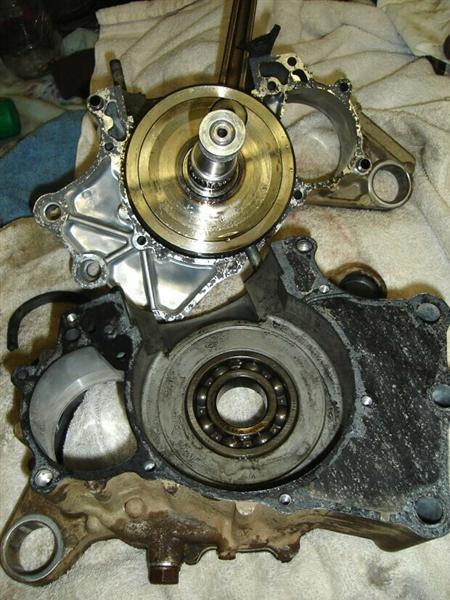

PostPosted: Tue Oct 24, 2006 2:20 pm

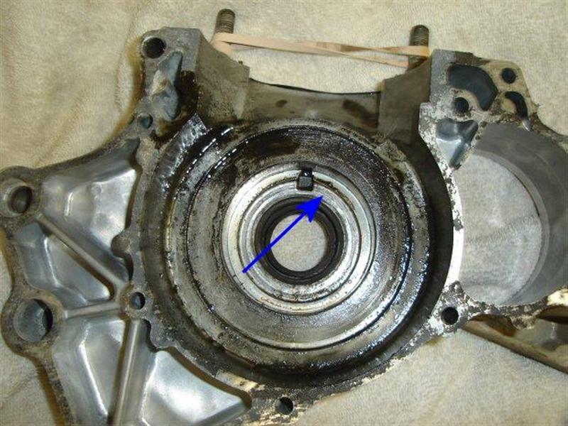

Cases split.

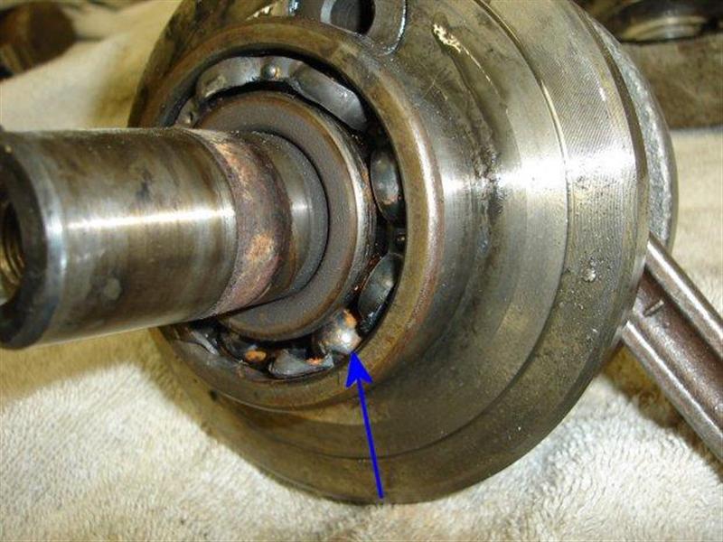

PostPosted: Tue Oct 24, 2006 2:21 pm
After pressing the other 1/2 out of the crank cases.

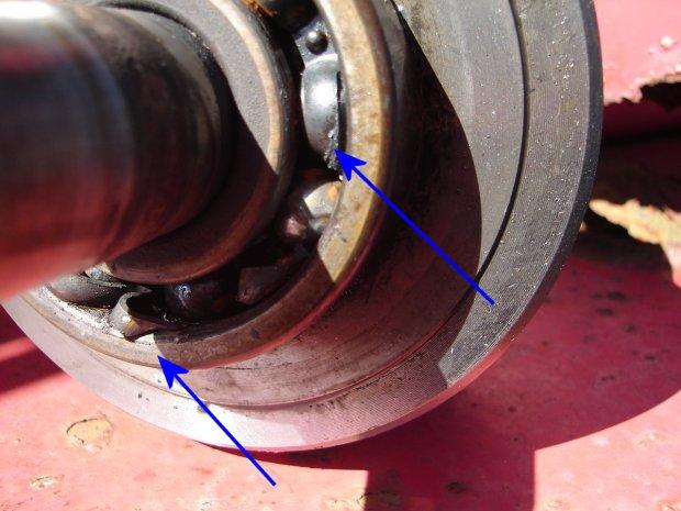

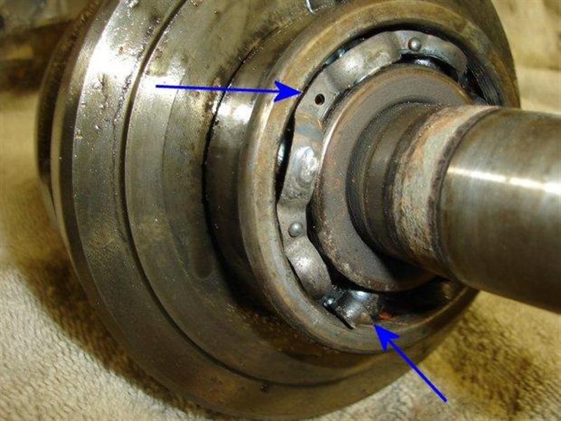

Clutch side bearing that failed.
PostPosted: Tue Oct 24, 2006 2:22 pm
Part of the bearing ball retainer or ball seperator rubbing on the cases, no real damage I can smooth it out.

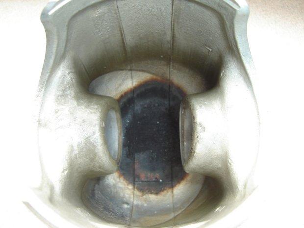

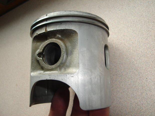

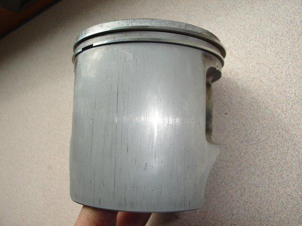

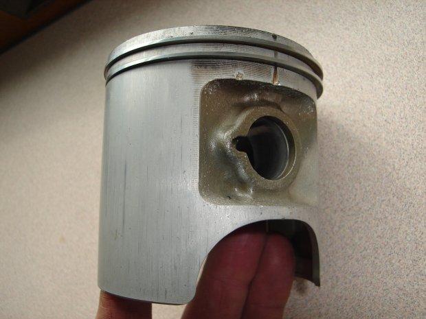

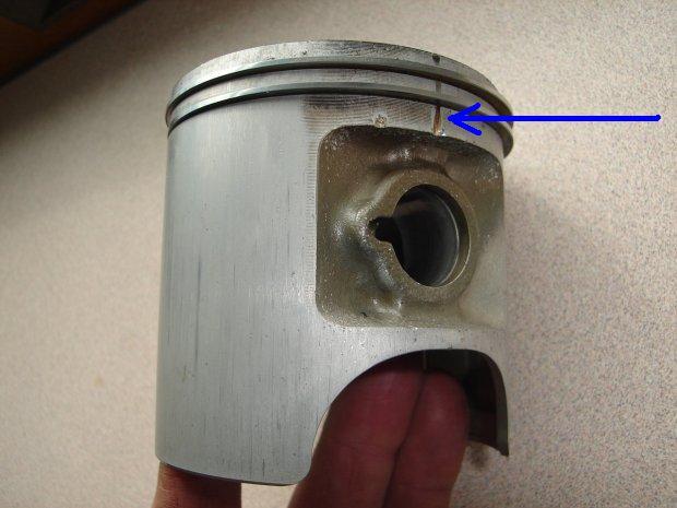

The piston was well worn.
File comment: Nice burn pattern jetting was good.
File comment: Crown has nice burn pattern

Being this was the clutch side bearing - can we confirm the
" powerbloc syndrome" was the cause?
PostPosted: Tue Oct 24, 2006 6:37 pm
cafercr35 wrote:
Thanks Hoser!
It's like I got front row seat to my Engine rebuild.
Is there an extra cost for the illustration and text? LOL
The " powerbloc syndrome" IMO is a knee jerk reaction, rumor, some arm chair keyboard caper threw out their into the mix of bearing failures, I wont buy it without some sort of proof that is the problem, the day this was brought up by a darkside member I asked why Rudedude has not contacted the MFG. and asked if the clutches are balanced or not and if it is possible a batch left the factory unbalanced, I got no reply other than he cant contact them, I find that answer pretty much bullshit how can someone buy thousands of dollars of parts from a well known long time established manufacturing company but not get any questions answered, I sent a bunch of emails to the company with no reply, I tried calling on the phone but person on the other end didn't speak English.
I have to assume that Rudedude took our money and RAN and their will be no customer service !
Maybe we can find someone that lives in Canada and speaks French to call them and see what IBC. says about the possibility of them being the problem.
Is it possible the clutch is the problem, you bet your sweet ass it can be but you gotta prove it to me before I buy an off the cuff remark made by someone that don't have a clue, I found your Engine to have a bunch of grit inside that I cant account for, it didnt pass through the intake tract because the reeds are spotless, I have no idea if it was sucked in through a leaking exhaust because I didnt take the Engine apart, it could have been sucked in through a bad crank seal directly through the failed bearing but I seen no grease around the crank seal that would indicate the seal was leaking, usually if the seal is leaking it will leak both directions not just suck in.
Their has been alot written about the clutch side bearing failures, the most logical theory I believe in is the bearing is not strong enough, the same size bearing is used on the FL250 clutch side crank, they didn't last long on modified engines, the fix was to add a bearing support and another bearing to the case doubling the bearing surface area on that side of the Engine, Marv at 4x4 Tuff.com made super cases for the FL250 that had provisions for 2 bearings built in.
If you feel or suspect the clutch is the or a problem I suggest you don't use it.

Is that groove where something went through there?

PostPosted: Tue Oct 24, 2006 7:53 pm
Yup.. chunk of metal something, no big marks on the head, no marks on the cylinder .
